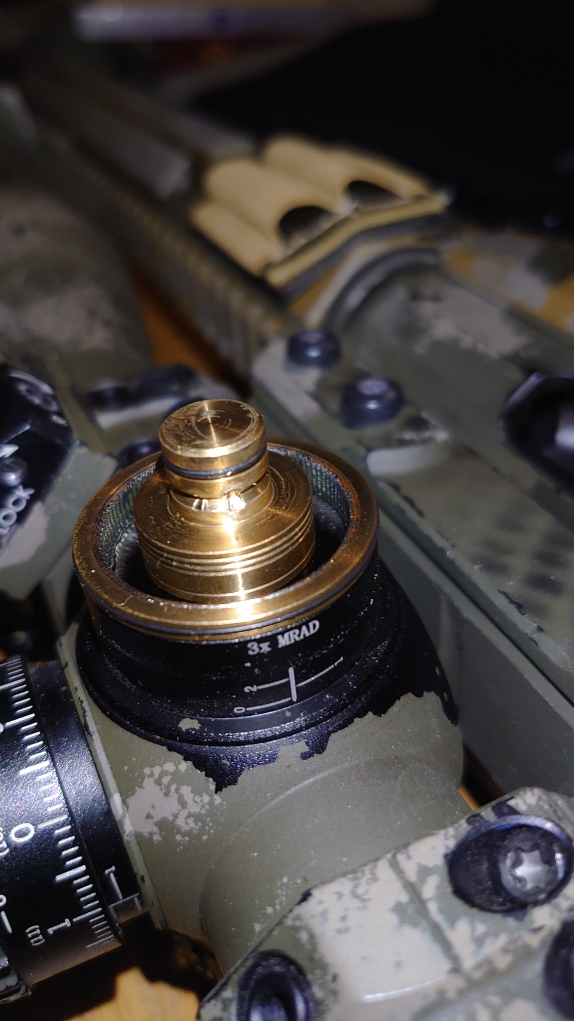

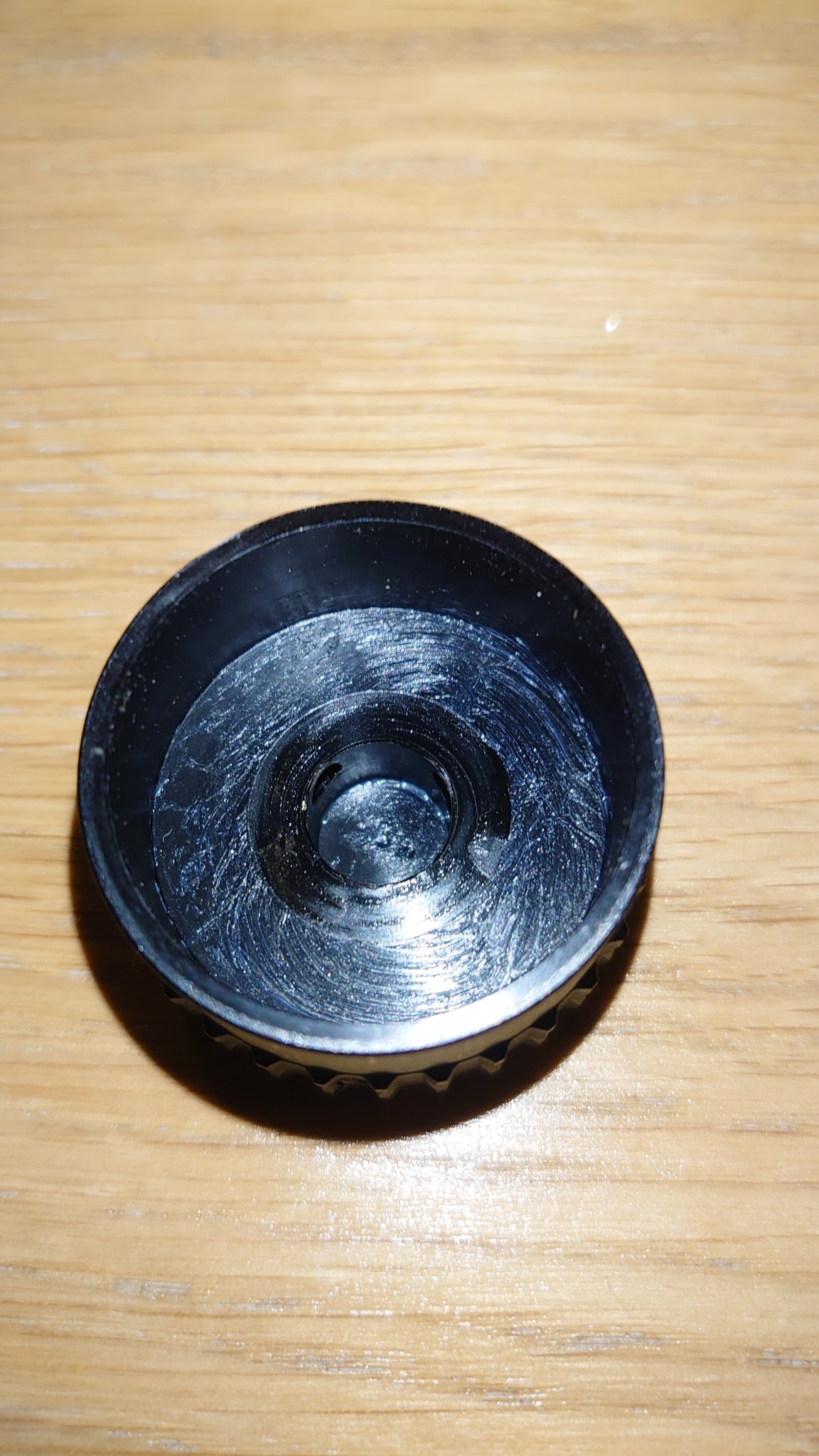

On a positive note - I was able to get the turret cap off using some tools.
That thing is buggered all to hell. How tight did you torque those screws?!
+1 that is the only thing I don't like about that design (on any scope). I like that you can always get things lined up, but some folks get a bit ape fisted, which is likely where the problem arose, that displaced metal has to go somewhere, it displaced into the easiest spot, the groove.
I always fear that I'm tightening too much.
