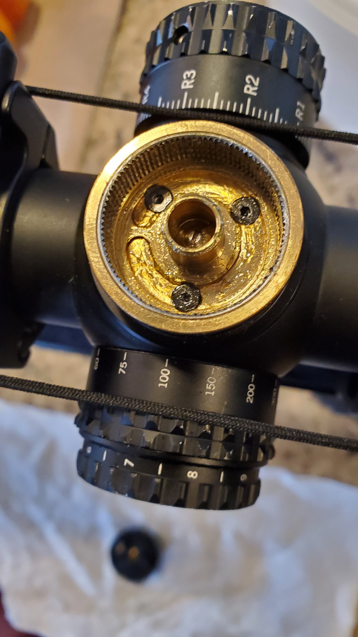

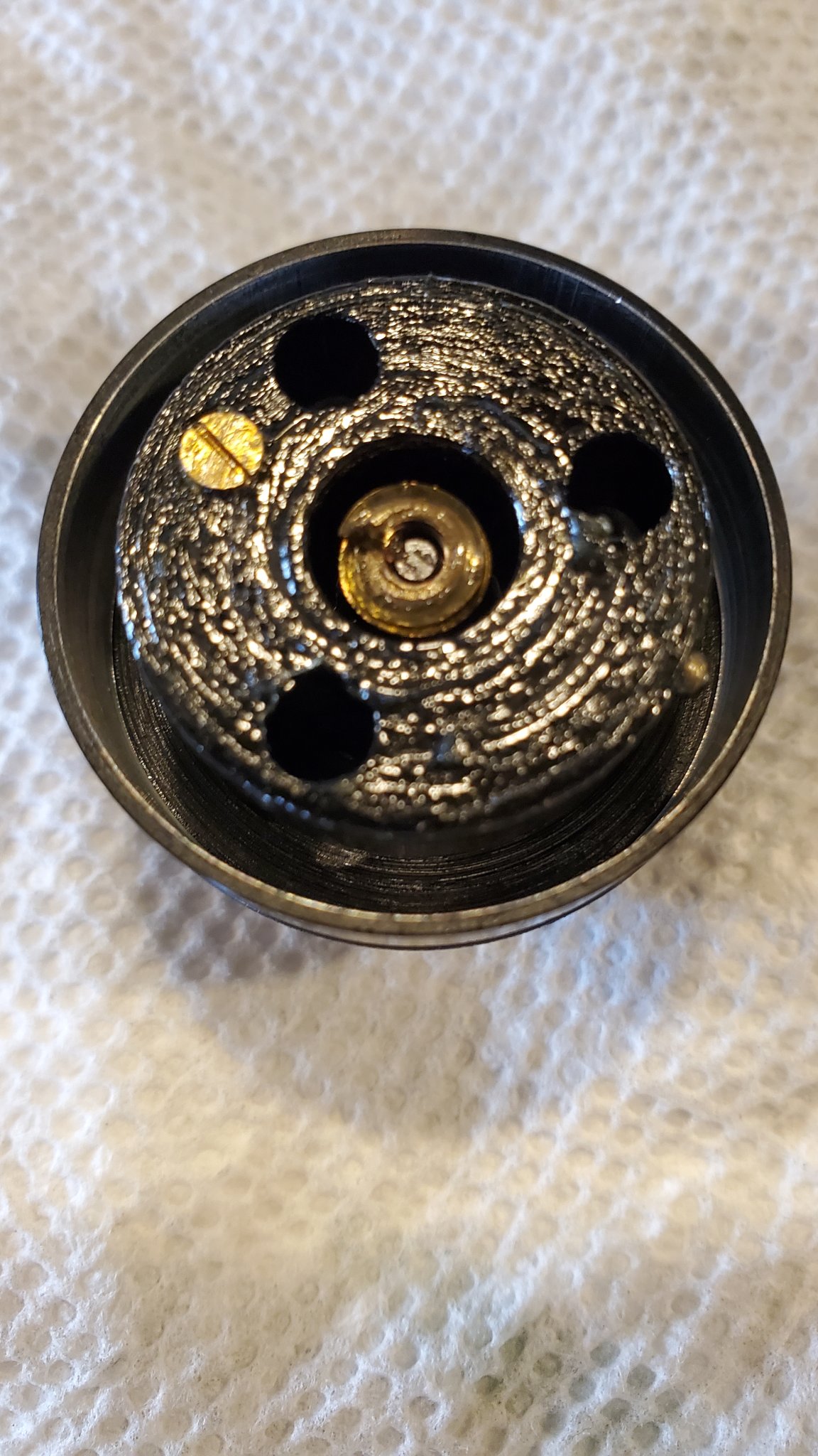

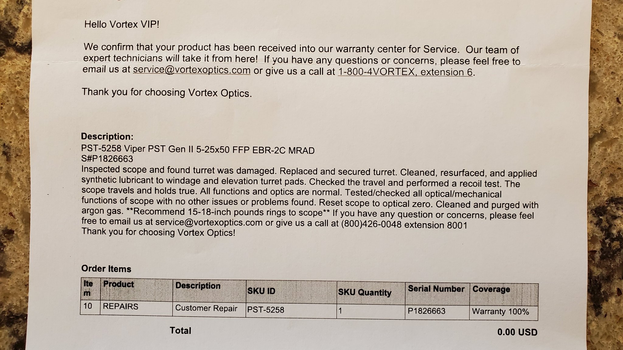

Just got off the phone with Vortex Customer Service. Great experience. They took all my info and emailed the service request form (filled out) and a prepaid shipping label to me. They said currently about 5-6 day turnaround time from when the receive the scope. Still curious how/when it failed.

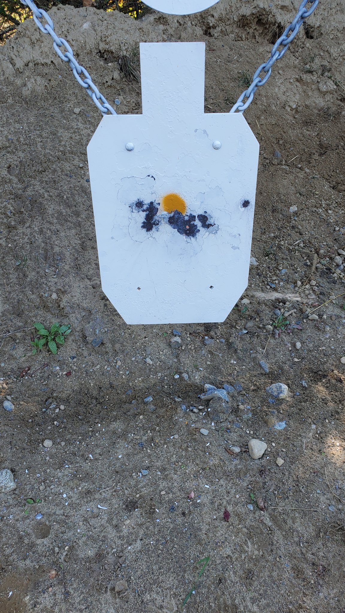

Last time out, two weeks ago, I put 10 rounds on a std IPSC target at 430 yds then moved out to 835. I missed 5 rounds in a row, but chalked it up to my skill, or lack thereof, and a pretty stiff breeze. I never saw the misses and thinking about it, I usually do if I'm reasonably close. Now I'm really wondering when it failed.

Thats the 4th Gen II PST I've seen do that. There's a design flaw there..
I wouldn’t jump so far out there to say a design flaw…. Maybe a batch of out of spec materials or even scopes that were not properly assembled from the beginning and took a while to surface. At the end of the day haters gonna hate and players gonna play.

Let us know what Vortex did to fix it, I would be interested to know what failed, so I can keep an eye on mine.

Like I said, I've seen four of them now that did that. Two of them at PRS matches, one of them at the range, and now our OP. Name an optic where you've seen this happen even once, let alone four times on the same optic. And four times is all that I'm personally aware of.
Here's a pic I took of the first time I saw it happen at a PRS match. This is two years ago, its not the same batch.. This guy in my squad traveled 6 hours to shoot a Pro Series match and only got through two stages.
So you can call me a hater for stating facts, or bury your head in the sand, it doesn't matter to me. Its a design flaw.

When I explained it to the CS rep on the phone, she said she had not heard of that happening before. I think, "hmm, that's a new one" were her exact words.
That's because they didn't know how to make this issue fit their standard customer service response "You over-torqued the scope rings" whenever something goes wrong.....Regardless, it will get replaced.

To close out the original topic of discussion, I mounted the scope yesterday and went out back to my range today. I dialed down to the zero stop from what they set as optical zero and took three shots at 100 yds and was .4 mil high and 1.7 mil left, but the group was very tight, even with the cold bore shot. Adjusted and the next three shot group was about 0.5 MOA and on target. The turrets are much tighter than they were before I sent it in for repair. The clicks are solid and the accuracy is same as it ever was. I didn't have time to shoot at distance, but will next weekend. I don't expect any issues but I'll post an update if I find anything. I don't know what other companies offer for warranties, but I can swear by the Vortex warranty. When it's time to upgrade, I will be getting a Razor.
