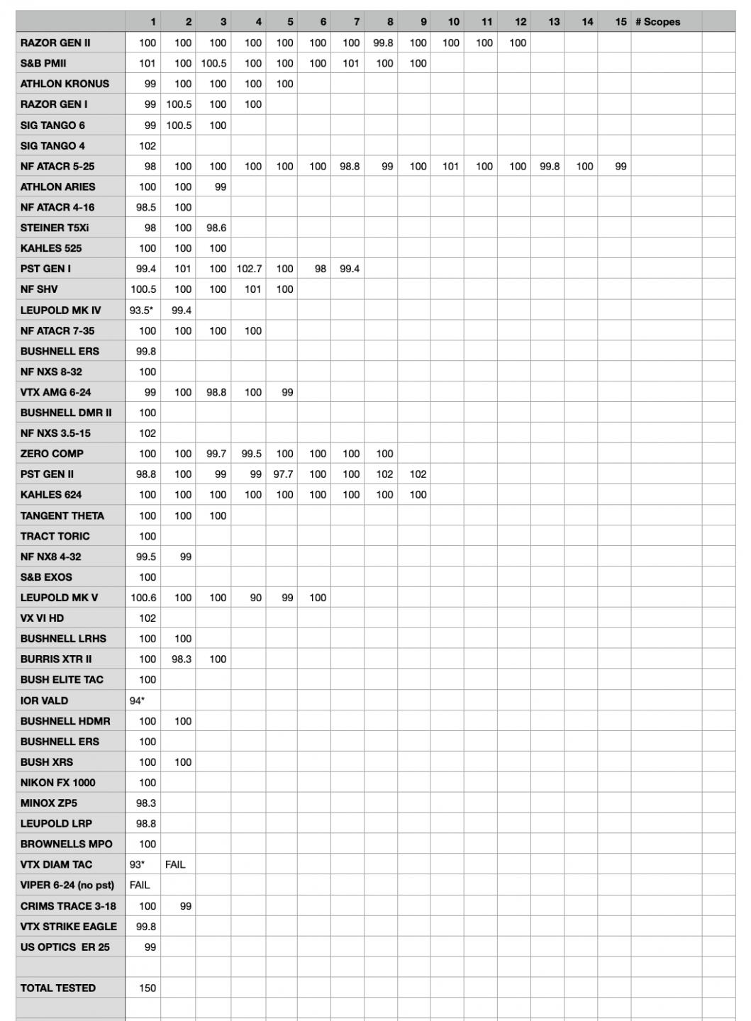

On the fence between a Nightforce NX8 4-32X50 and a Vortex razor hd 4.5-27x56. I've had lots of (positive) experience with Vortex but have yet to own a NF, this is going on my new .308 build. Leaning towards the NF after handling them both in person but I just can't get over the warranty Vortex provides, whereas NF only covers manufacture defects etc. Id like to hear your first hand positive and negative experiences with both!
The warrenty is a big part of why I got the razor. Scope is amazing. Check out the chart lowlight did on tracking.

The Razor, even though its a pretty old design these days, is a much nicer, more well-rounded optic.
The NX8 suffers from some rather well documented short comings. There are better options at the $2k price point.
Edit; I should add the caveat that usage plays into this decision. On a hunting rifle the weight difference would play a pretty big factor, and the issues with the NX8 are less glaring when you can focus on a single target at a single distance.. For target usage, the Razor is the clear winner. The eyebox, and parallax issues with the NX8 make it a poor choice for transitioning between various targets at different ranges.
NF warranty is better than mentioned. I have returned a heavily used NF for repair and it was quickly returned refurbished at no cost. The NX8 is smaller and lighter. I will say my NX8 is no match to my ATACR. You say you have handled both so go with your gut.
At that price point, I would watch the PX for a used ATACR 4-16 F1. I have one (as well as an ATACR 5-25 F1 and older NXS F1), so I might be a bit biased lol. Their CS team is top notch and will most definitely help you out with work/repairs as long as you (or anyone) owns it.
The NX8 isn’t worth it if your in the price range of a used ATACR.
Agreed ^^
Owned a handful of both vortex and NF. Vortex has a great warranty and I got to use it several times. Haven’t had to test the NF one yet
So my vote is NF
Agreed ^^
So my vote is NF
And I agree with you about the Vortex warranty. They seem to take little consideration of durability and reliability. They've gained so many fan boys through their customer service.
However, the Razor line up has been solid. Its essentially a LOW scope, which is always pretty solid.
I'm disappointed to have heard their Razor binos are now being manufactured in China. Not sure if it true or not. But disappointing if it is, to take a successful and well-made optic and go the cheap route to increase profit margin.
Reactions: BurtG and Rob01
Love my NX8 4-32. No parallax issues for me. FOV @ 4 is outstanding and having the option of 32x is nice. Hard to beat the 8x erector bu it certainly will have some drawbacks. The MIL-XT is a great reticle.
I have no experience with the Razor.
I feel the same. I have a 7-35X ATACR on its way and that was a big part of why I reason I chose it (it was either that or a ZCO - either would fit the bill I'm sure)
Reticles are VERY personal so take that into account when deciding.
Which Vortex? Razor IIs with issues?
Mine were the PST line. The Razor came out after I gave up on the Vortex. I’m sure the Razors are great as most of the Japanese scopes are. However the $900 pst line I tried wouldn’t hold a candle in reliability to the Burris xtr or Sightron SIII
For that reason I vote NF (I’ve owned the NXS, Competition and ATACR line in the NF)
