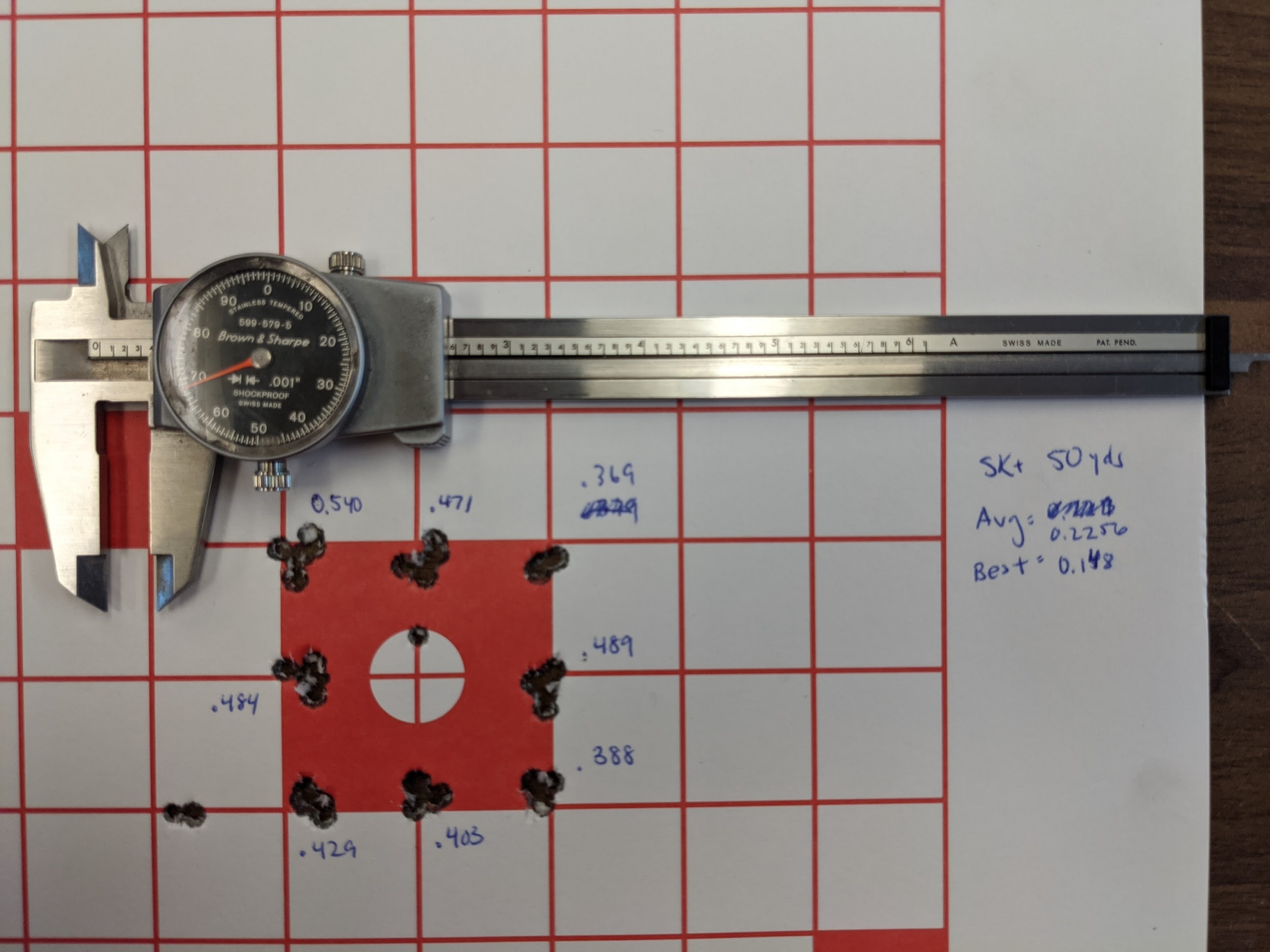

These were my first few shots with SK+. E-E so I subtracted .221 for final group sizes. Rifle doesn't disappoint.
