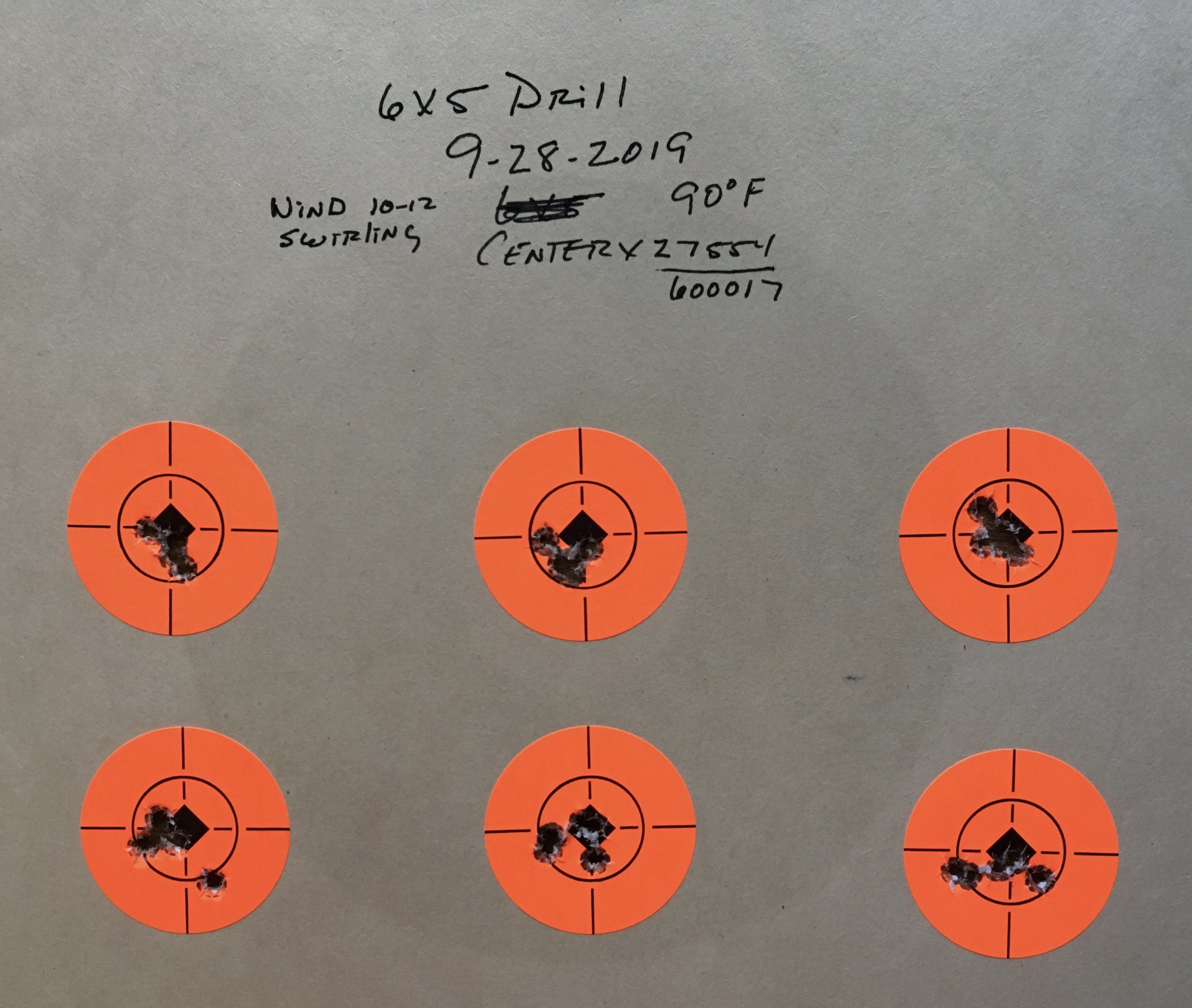

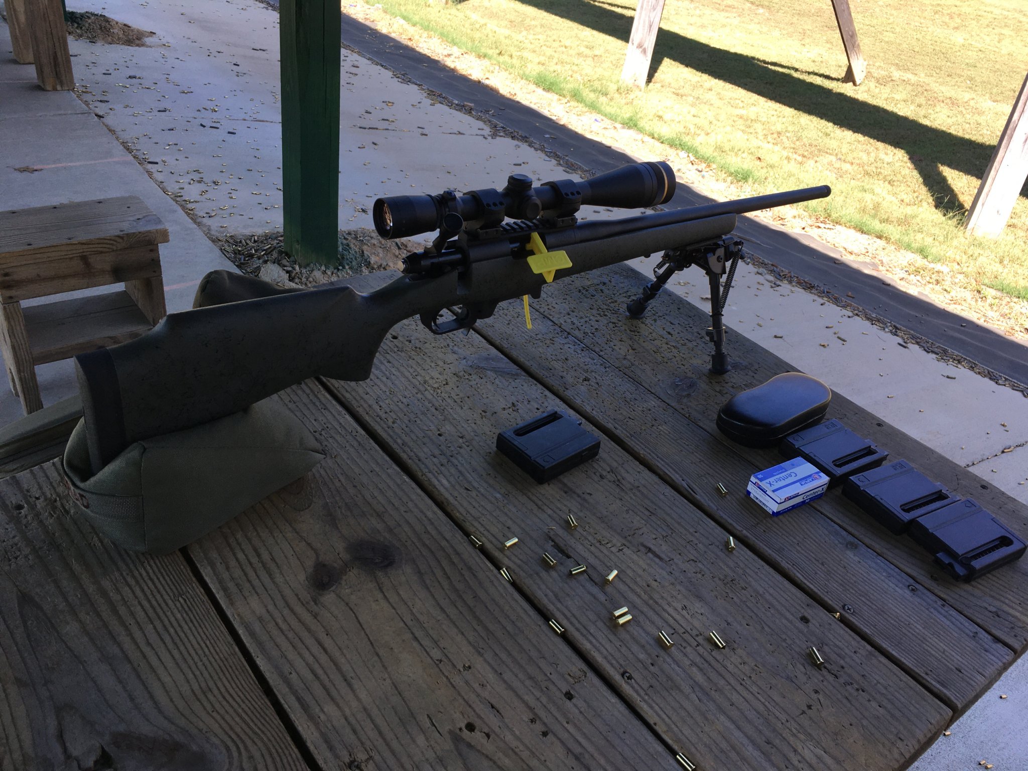

I figured with all the noise I was making re ordering a Vudoo, I'd post a couple of pics. While the 6 groups of 5 shots each of Center X are a bit disappointing, before I start trying different ammo, I will do these things first: lighten the TT trigger, use a more solid rear rest and better focus on the fundamentals.

The first thing I got from shooting my Vudoo was some harsh feedback on my gun handling. Your groups look mostly very good and even the famed CX will throw a shot now and then.
I had mine out to the range this morning too. My home range has a 22 Sniper Match each month. It is 60 steel targets at distances of 50, 75, 100, 125, 150 and 200 yards. the smallest is 1" wide by 1.5" tall and largest is 5". My first assigned targets were the tiny 50 yard ones. I center punched the first five in a row but shot about 1/8" over #6 and 8 of 10. Tightened up on the nut behind the trigger and ran up a 58 target total score.
BTW, I was shooting SK Long Range Match which appears to me to be the same components as CX with a touch more powder.
Reactions: J Scott
I posted my write-up in the big Vudoo V-22 thread, but here's the link - https://www.ocabj.net/precision-rifle-project-series-vudoo-gun-works-v-22/
I've got several photos of groups (all 10-round strings), with three variants of Lapua, three of SK, and CCI Standard Velocity.
I think your groups are fine so far. I'm not the best benchrest shooter, either, so I understand the pains of paper shooting.
Reactions: J Scott
-Adjusted the TT Diamond trigger down
-Check all screws: action and scope rail
-Replaced scope with a Leupold Mark 5 HD 3.6-18x44
-Cleaned barrel
-Used a more rigid rear rest and braced bipod
-Focus on fundamentals
Overall, a little better, maybe. Seems like the first groups at the beginning of each row/far left is where I'm doing something noticeably wrong. The second and third group in each row are better. Still not smiling. I'll keep at it.

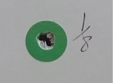

My Vudoo grouped new out of the box would group 5 shots at 50 yards of center X inside a dime and some others real close to that. I now have 400 rounds down range and my groups have tightened up. I have run a couple dry patches through the barrel after a hundred rounds. The rounds mine really likes is the center X and Eley Tenex
Well I either bought a dud or I need to learn to shoot like you! Great shooting, Steve! I'll keep practicing :)
I started shooting mine with the old Lapua made Wolf that I have a case of and it loved it from the start. It shoots Center X almost as good but I haven’t got it to like the SK stuff yet.

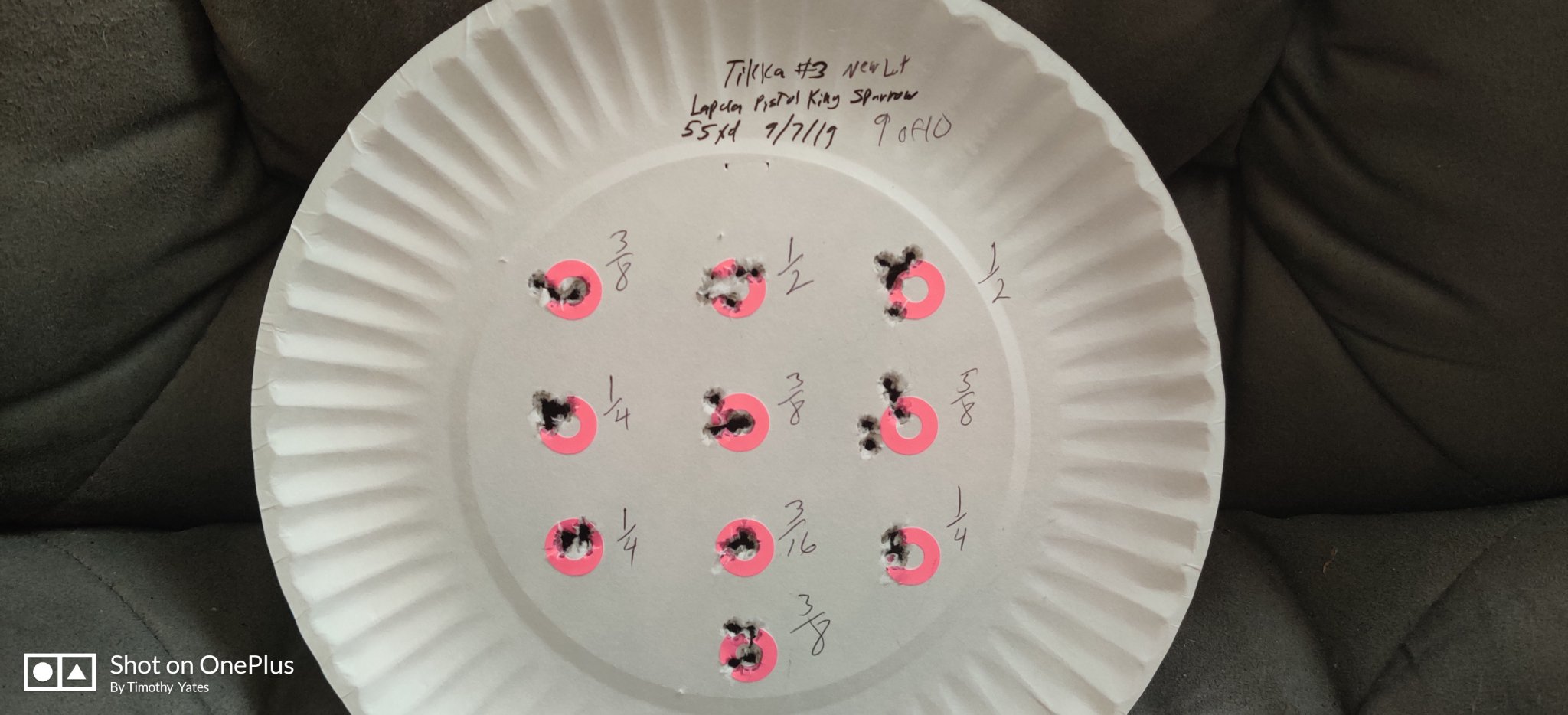

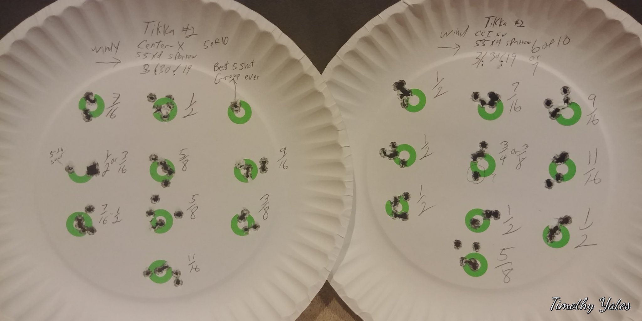

What did you do, shoot those two and go home? To give an accurate display of your rifles ability I would recommend showing more than one group for a particular ammo like J Scott did or I did in post #7. For example I could cherry pick the target below for one of the ten 5 shot groups but as you see the overall groups were not that great. They are not really bad but if I only showed that one group people might think that rifle did it all the time. Or, even if I said the rifle shot most groups "real close to that" would not be a true statement.
Cherry picked.
The rest of the ten 5-shot groups.
I'm not trying to cause any trouble or start something but to just point out that showing a single group is not a true indicator of how a rifle actually performs in the overall picture. I realize you didn't say it did but to post a single target and forget it would indicate you would want others to believe it does. I also realize you posted two photos but with different ammo but again, same logic applies. Your Vudoo may shoot that way all the time but I'd want to see at a minimum five 5-shot groups with the same ammo on the same target. If several people posted that about a Vudoo I'd be getting my vudoo started today.
Again, not trying to cause any trouble but offering advice to improve credibility.
Cherry picked.
As I stated above my rifle grouped inside of a dime at 50 yards right of the box. The groups have tightened up in 400 rounds. The two photos I showed are the best two groups out of the last 50 rounds of each ammo I tested Eley Tenex and Center X
Sorry for any confusion
Steve, no confusion at all. I was worried about sounding like a dickhead but a person can only word things the best he knows how. I just wish someone with a Vudoo would post several targets showing ten 5-shot groups (full box of 50). In all honesty I'm not so sure a Vudoo is any better than the Tikka #3 I have. For that matter I'm not even sure the IBI barrel I have coming for another Tikka T1x will be any better either.

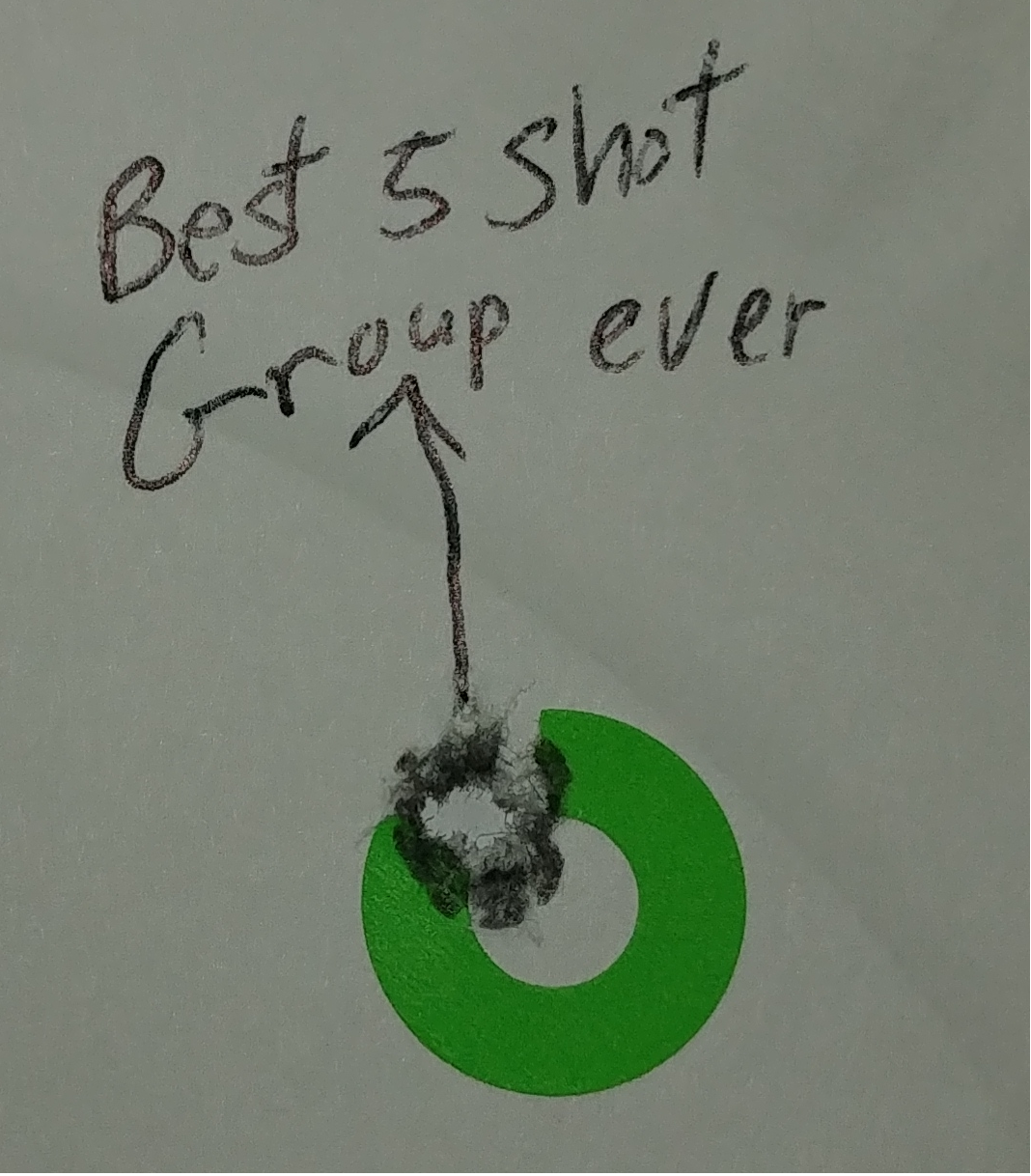

Just wanted to show off one more miraculous 5 shots at 55 yards group. And yes, there are really 5 shots there. Sad thing is I don't even remember what rifle shot it. This one come after the one above.

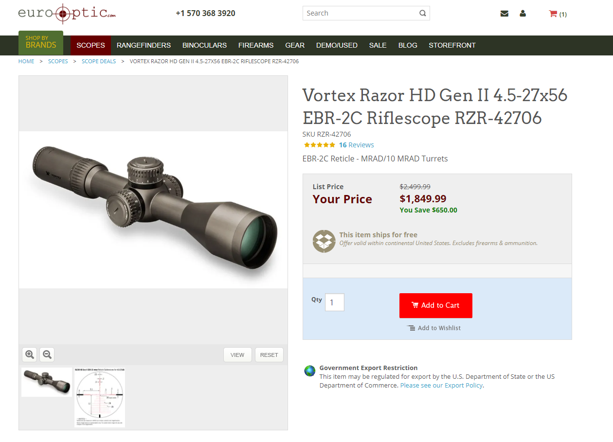

I have also seen some huge discounts on the Vortex Razor HD GEN II in 3-18 and 4.5-27. Both those are magnificent scopes. Umm, yeah, I have those too. I can't recommend something I haven't used myself. But, no one wants to read another book about scopes on here but if you want to pick my brain for specifics PM me and ask away.
