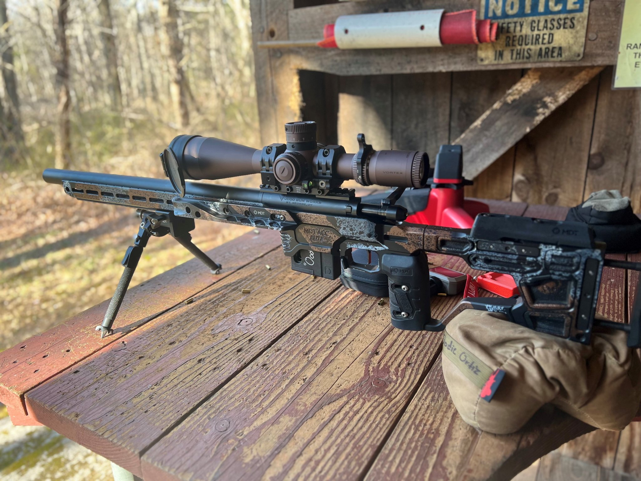

Do you have a pic of this barrel and setup?
Not a Bartlein but its a 24" Mullerworks by DPG.
That exact setup has 60moa rail, and 6001 0 MOA scope mount. Zero is at 50yds and I can go 500yds without holding.
I have a duplicate setup using a 40Moa rail, and a 6602 20moa scope mount. This is a little taller.
