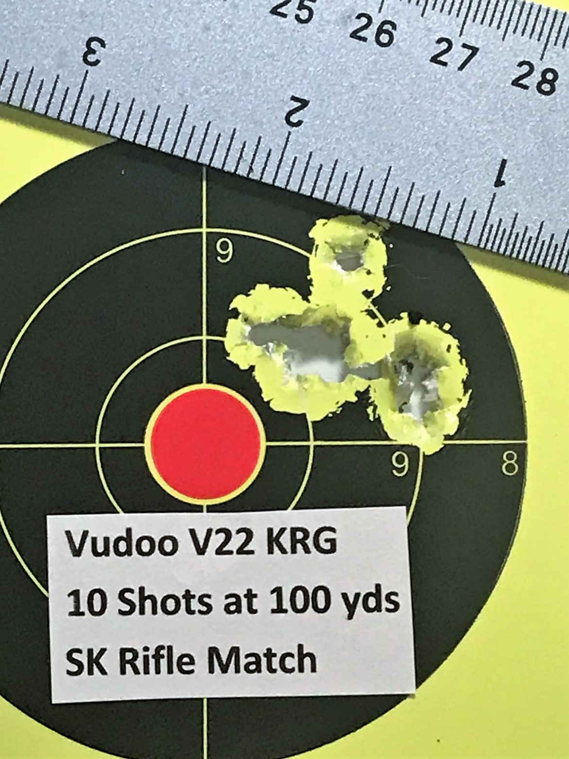

I chose the KRG stock with 20 inch Ace barrel with a Kukri profile. Why? I dunno, I guess it was a compromise. I wanted to shoot informal benchrest competition but didn't want a dedicated rifle for this purpose. I could have bought a Bartlein for the same price. After talking with the sales person, she really couldn't say which one would be any better and I'm sure Mike wouldn't market the Ace barrels if it weren't so. So far, I'm happy with it. If I were to do it over again, I might get an 18 inch barrel to lighten it up a bit, but that's academic. The proof is in the shooting. Velocity? I never checked, but does it matter?
