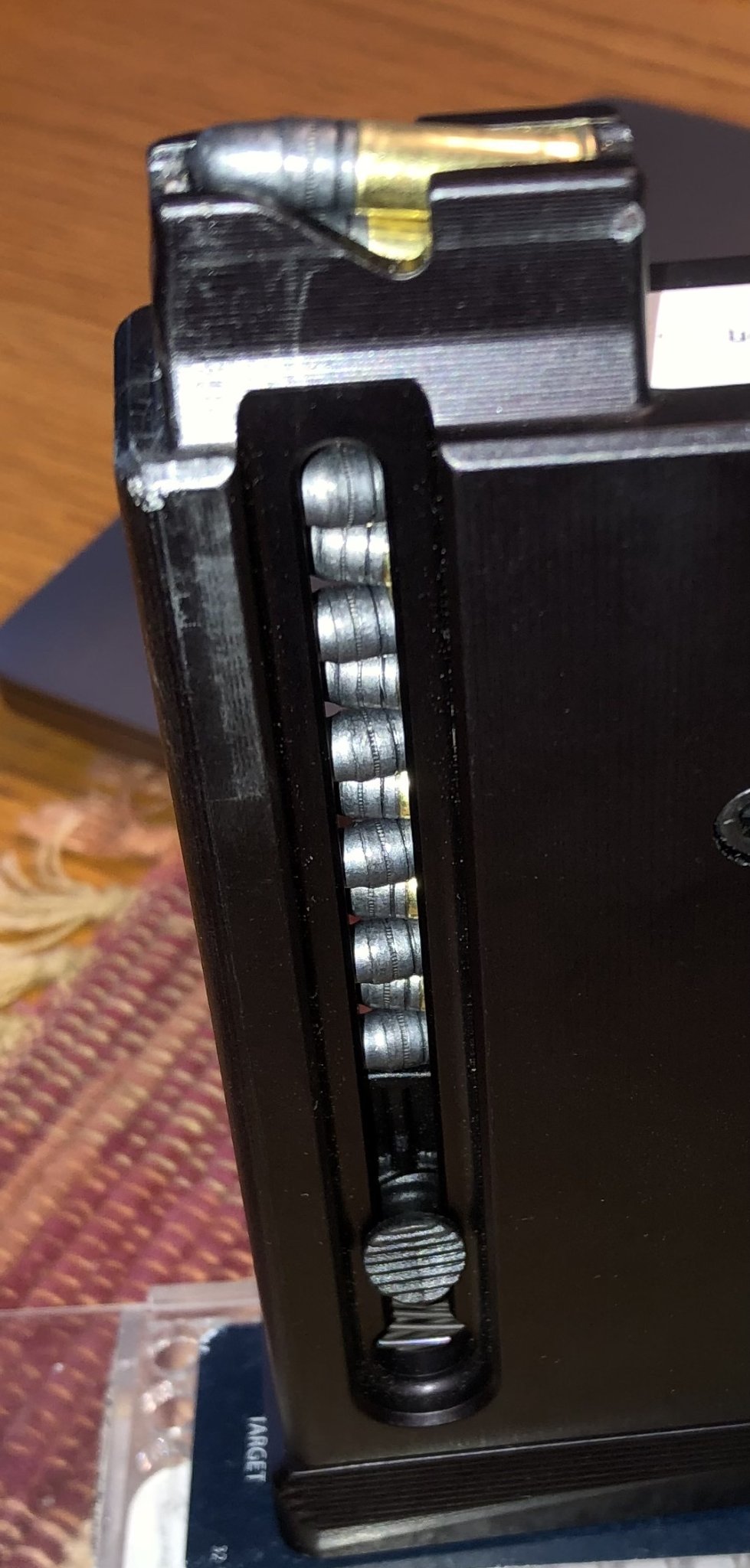

  • Wrt loading the magazine: People often assume you can just push the follower button down and drop in cartridges. Nope. I haven't had a misfeed now in a few years and several thousand rounds, even with the discontinued 15-round aluminum mags. Secret is to push the follower down Just.Far.Enough to slide a cartridge in, then, release the follower. The cartridge should push up into the nose-up position as described in Paul's video here. If not, I use a fingernail to pull back on the cartridge rim; this usually pops the round into correct position pretty easily.
    When fully loaded, the cartridge stack should have the bullets alternating as shown in the photo. The 15-round mag makes the alternation very obvious; ten-rounders won't be as clear but will still show the pattern. I can pretty much guarantee a misfeed by intentionally misaligning a couple of rounds. Misalignment most often happens when pushing the follower all the way down and just dumping cartridges in.

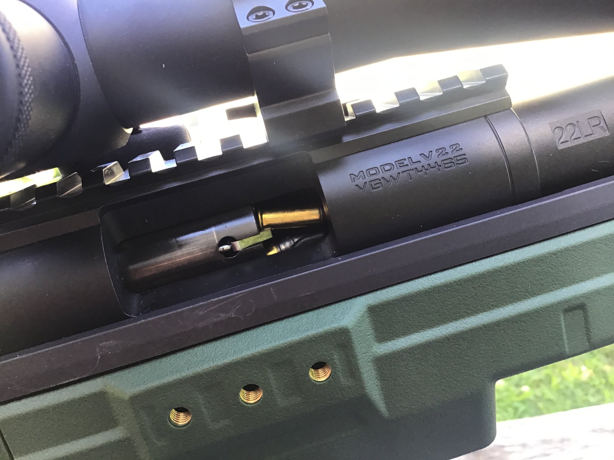

I set up outside and ran some live rounds through the magazine (stagger inspected).
This what I get.
Edited to add, looking closer I see I was mistaken, it’s an extractor with a tensioner/ holder not twin extractors, which makes sense when it’s time to kick out the empty.
It seems like the base of the fresh cartridge can get past the upper arched lip of the bolt face at times. The bullet appears well started in the chamber and when inspected it shows no scraping of lead. Unlike when I tried it in the KRG Bravo as it came out of the box.
Edited again.....it’s the slower bolt close that seems to let the jump happen. If I keep up a certain bolt speed it doesn’t seem to happen. At least that’s what happened in five fully loaded magazines cycled just now on the picnic table out back. Not firing, just cycling the ammo through the gun and ejecting the rounds on a towel.

Well at your suggestion I sent off an email to VGW with the same photo and explanation. Mr. Roman was quick to answer me. His diagnosis is likely weak extractor spring(s). He was kind enough to offer to send new springs and extractors or a call tag so that they could put hands on it. I chose the parts, it looks 10/22 simple to swap them. Nice folks.
Now that I think about it, Vudoo sent me a new spring/extractor kit when my rifle was new and we were working on my feed issue.
