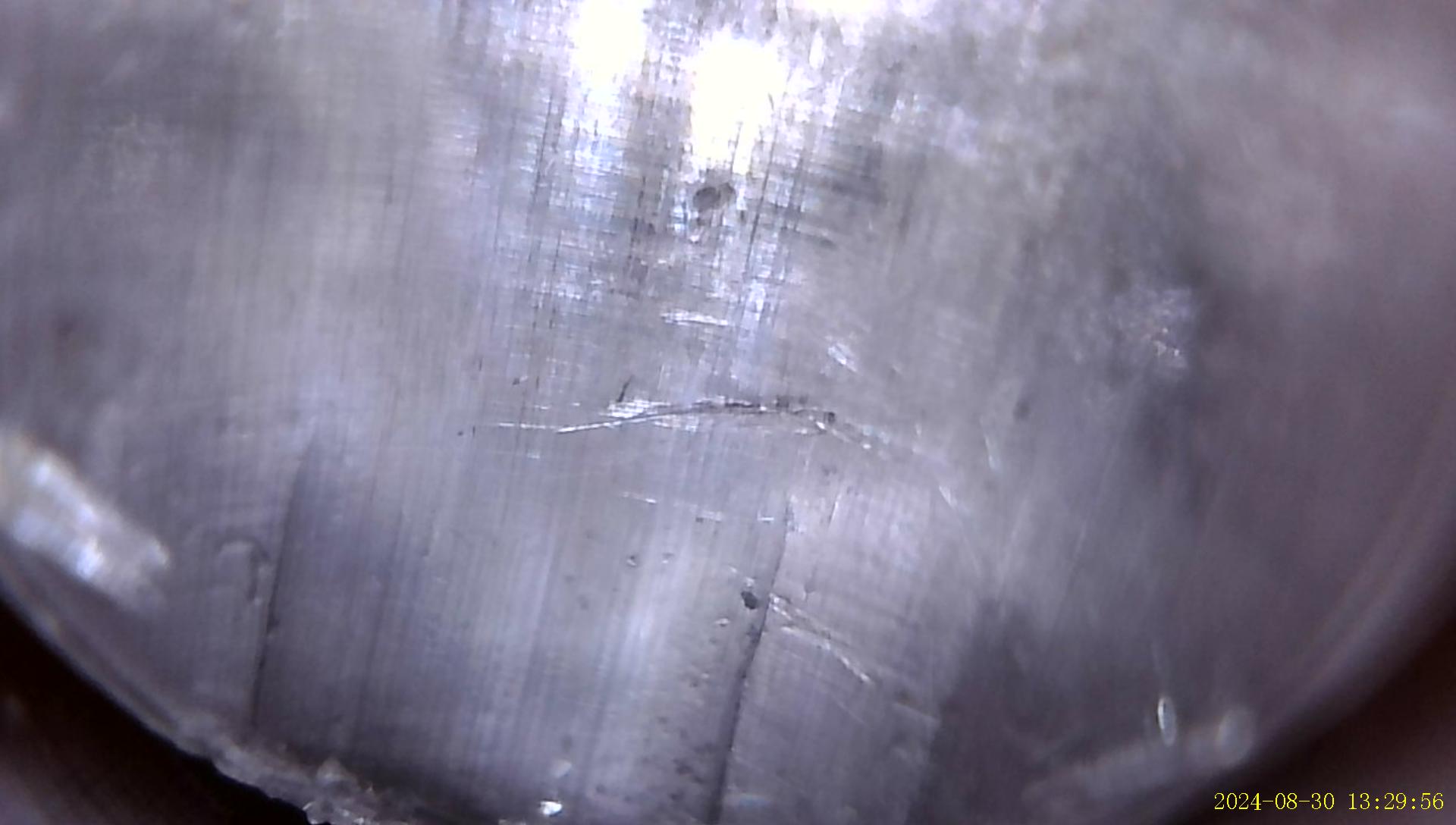

UPDATE 8/30/24 with some borescope video and a pic:
Video shows entering the chamber up to the lands and circled around. Looks like a small carbon ring. Not sure about all the other cracking / etc.

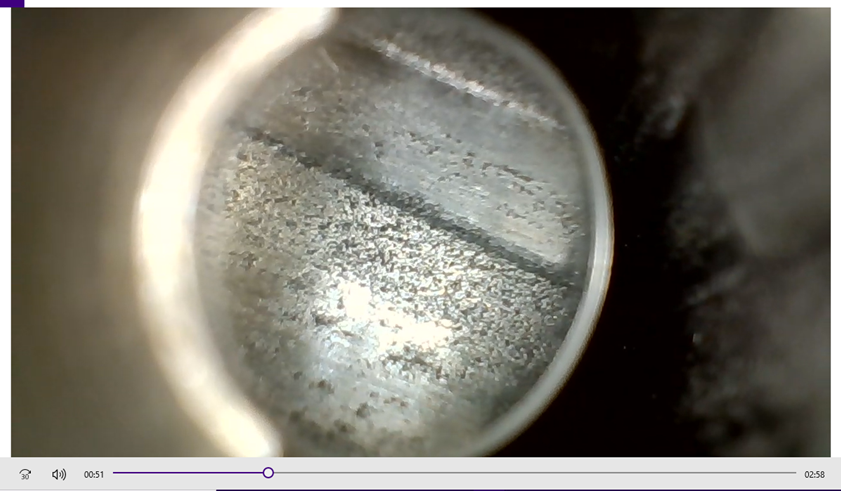

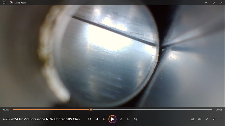

I'd suggest a Teslong borescope. There are many types, depends on which you prefer - for phone, tablet laptop or 'comes-with' its own screen. All are on Amazon. I've had one for ca 10 years, an NTG100 that cost ca $100 CDN back then, and which back then came with an additional 50" cable along with the 45" that is all that's listed now. Should be ca $60-75 USD now, be sure to get one small enuf for .22cal !! I mostly connect to my 15" laptop so the pics are quite detailed. Here's the bore of my '51 Tula SKS and my "New" unfired 1980 Norinco SKS.
I ordered the one you can focus and folds for more compact storage. . . this is NOT good for my OCD and I've fought the urge to get one... the not extracting live rounds has me wondering.
The cable on mine is ca 10 feet total, and I just hang it on the wall of my workshop across a couple pegs a foot apart. It came coiled in a flat box about 1" x 10" x 10", but that made me nervous so I just hang it.
Reactions: USMC22

You will get over the borescope/OCD issue with time. Every little defect in the bore will make you wonder about the barrel and it's continued ability to sling lead. Just look at the target, and say, "everything is ok". Very very few bores are "perfect". Brand name barrels have those imperfections that you can see with the borescope, but usually shoot better than the shooter.
lol thanks. I should print this and tape it to the outside of the bore scope box when it gets here
If you have kids, you’ll likely remember the sonograms. Nothing looked like anything, but the physician could point out all the interesting bits. A bore scope is similar. Remember, you are not a barrel maker, and that you don’t know what you are looking at.
Well shit. I bought another thing that’s going to make me look dumb and drive me nuts.
