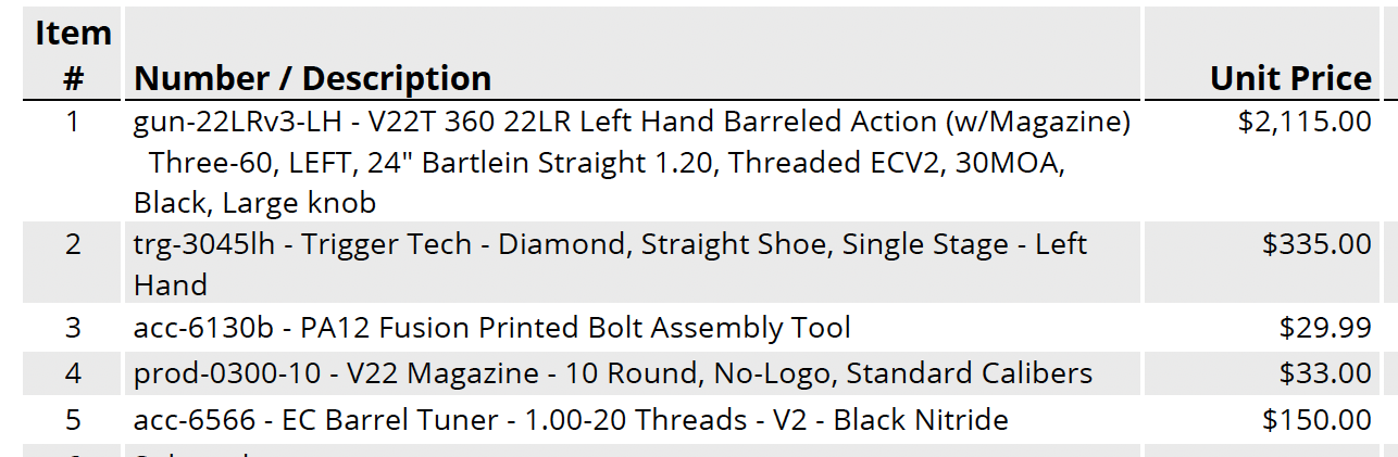

If you were having a Vudoo 360 built out for PRS Rimfire and overall fun range gun. . . would you put an EC V2 Tuner on it or no and why?
I've never used a tuner before, but understand the theory of harmonics and trying to find a node. I've heard some say the barrel is too thick / heavy while others say there is still a benefit.

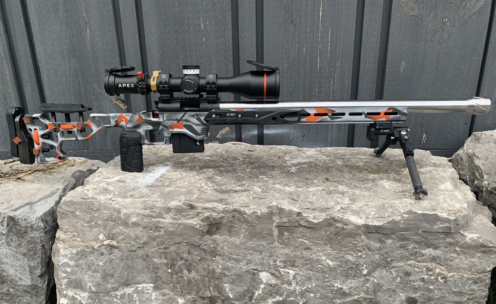

here’s a 26” 1.250 straight with a direct thread to a spearhead tuner. I have a thread protector as well incase I don’t want to use it or don’t need it.
Reactions: USMC22

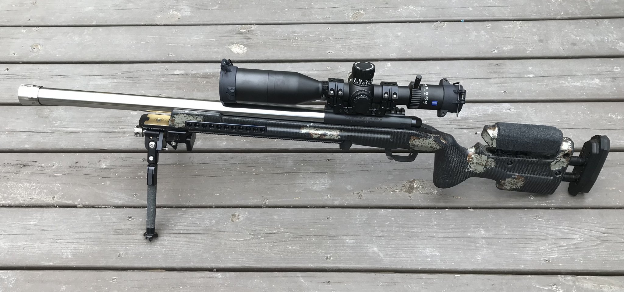

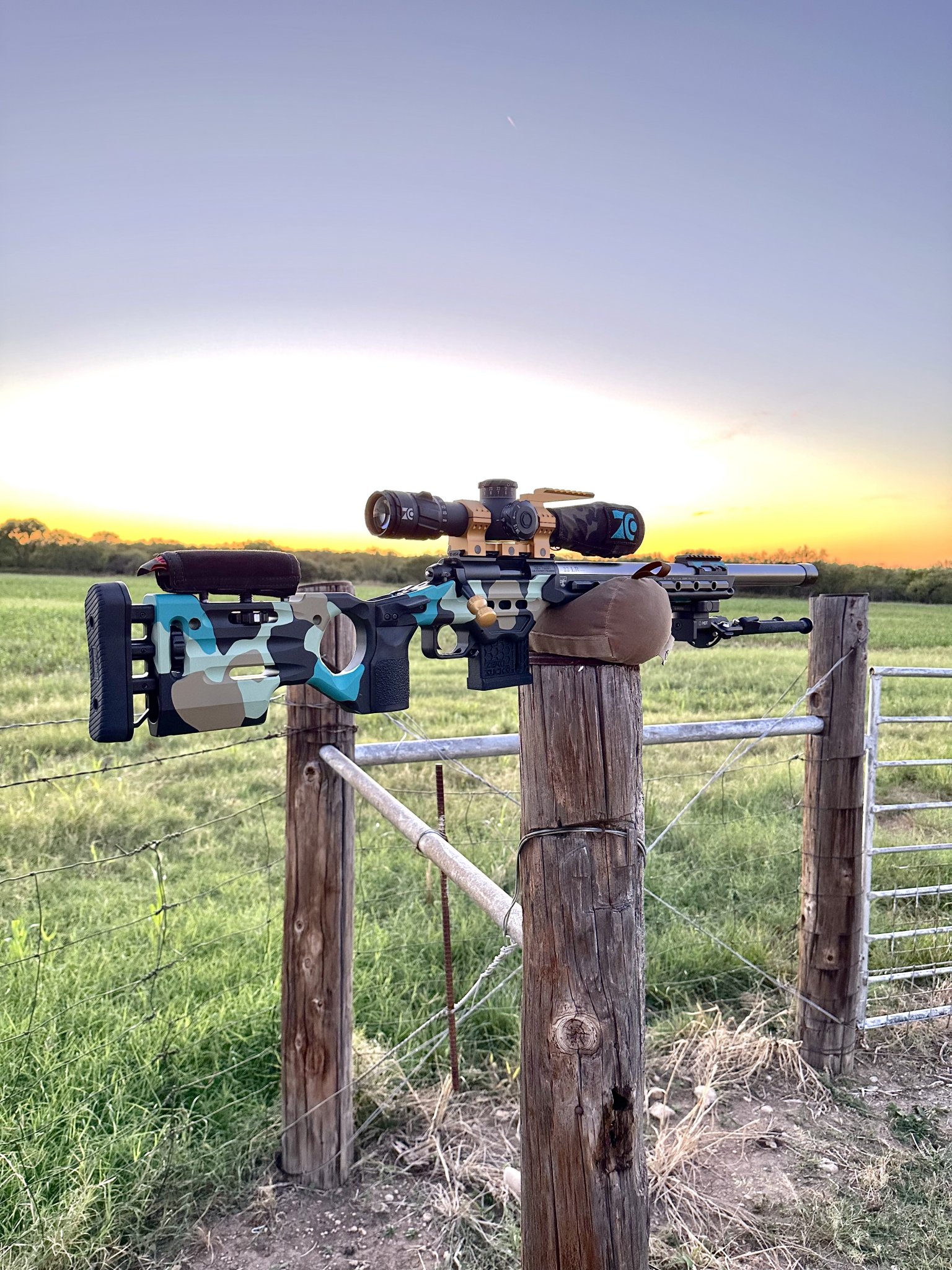

And since we are showing cool pics...
You forgot to say ...just sayin'. LOL

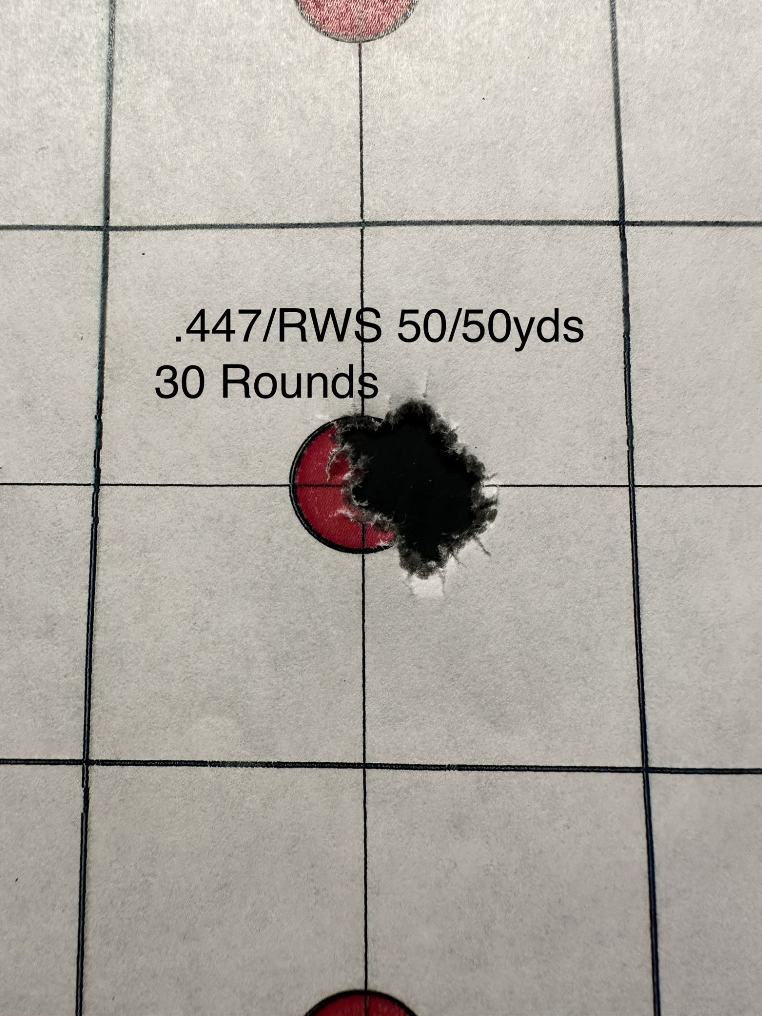

Barrel length has very little if any effect on 22lr accuracy. This has been proven time and time again. If you want the most accuracy you can get from a barrel you don't just pick a length and cut and crown. Bore diameter is far more important than barrel length. Have the barrel slugged to determine the tight spot and cut and crown at that point. Length being what it winds up being. If you're dead set on a particular length barrel then you need to have it taper lapped to put the restriction at the crown.
