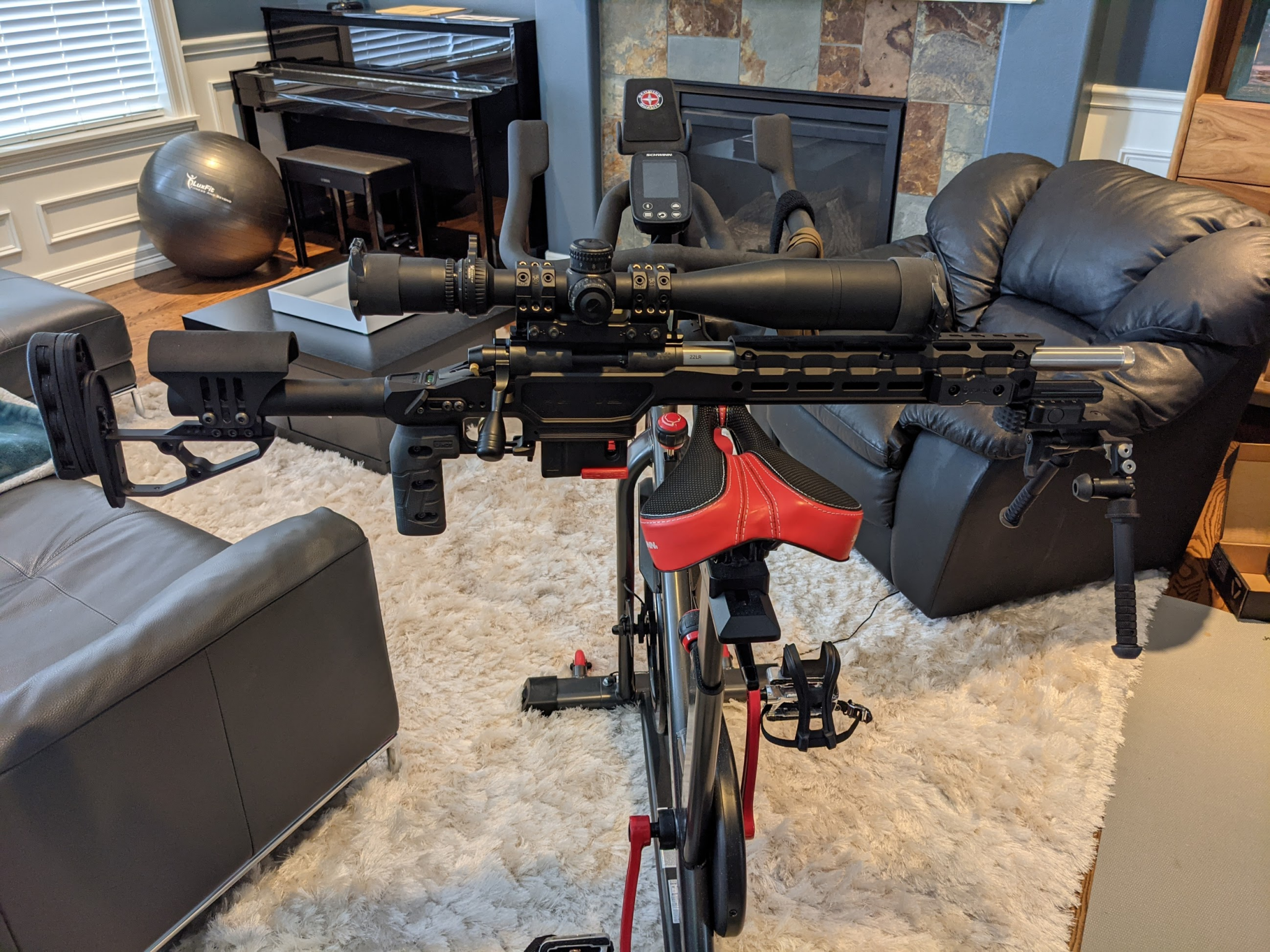

Does anyone have any experience with a Vudoo in the XLR Envy Chassis? I am looking for recommendations on what contour and length balances the best with adding the least amount of weight to the chassis. Kukri or MTU in 18” or 20”? I like a balance point right in front of the magwell.
Got one with 20" MTU barrel.
Been playing around with weights on the forend. Pictured here it has the internal and external weights.

Need to go back to the bench and play around with it some more, looking for perfect balance and less weight...
On the other hand, i do like them heavy
