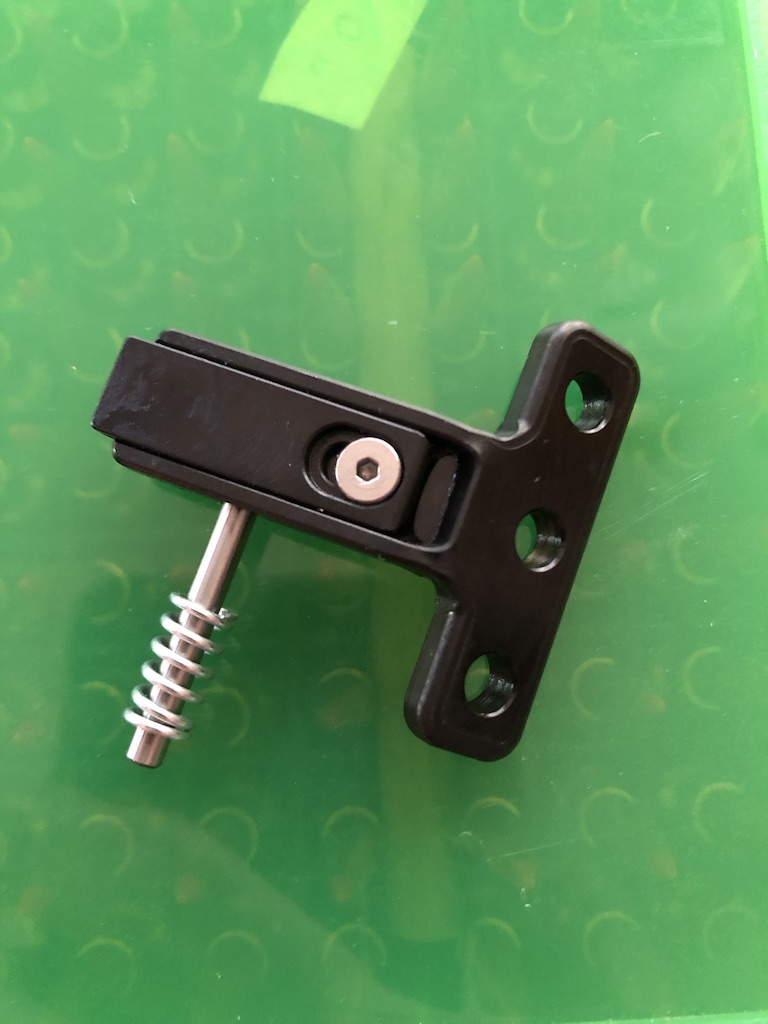

Here's a close-up of the adjustable latch. I had an occasional failure to feed the last round in a magazine. Once installed, it took maybe 2 minutes to tinker with and adjust the latch. Haven't touched it since and haven't had a last-round failure to feed since.
Reactions: ehaleyjr86
This is genius. I really don't know why other stock and chassis manufacturers don't make an adjustable version of their mag latches. Or at the very least an oversized version that can be purchased so users can fit for their individual needs.

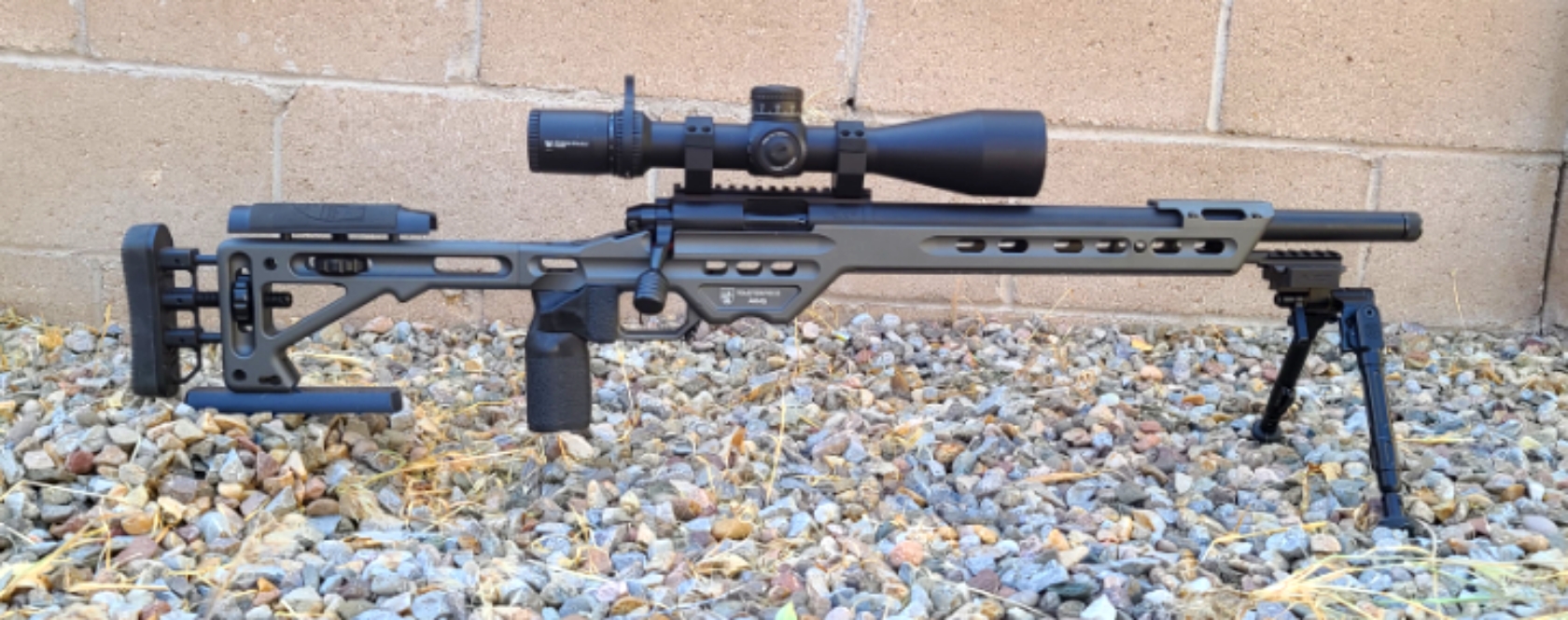

I love my MPA-chassis'ed Vudoo (I've posted this photo a couple of times in the V22 forum). With that said, imo the adjustable latch is a necessity. I have a buddy who have the exact same setup as mine. When I was having the problem, I found that my mags would feed perfectly in his rifle and his would fail in mine.
Not surprised that you find the aluminum mags are different (for better or worse) than the polymer ones. With my rifle adjusted for the latter, the former are a small fraction of a millimeter tight. The aluminum ones feed ok but, were I to use them exclusively, I would loosen the latch an almost imperceptible amount. Keep in mind the polymer mags have seen a lotta'rounds through them while the alum-ium ones are new.

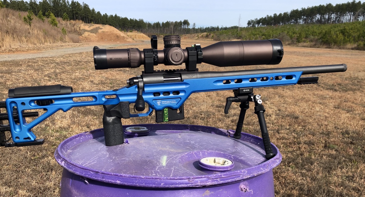

Downhill, my Vudoo is now in a Blue MPA Chassis as well. Very nice piece of equipment. I have played with the height of the mag catch. I think I finally have it close to right. Greg at Vudoo says the mag needs to be TIGHT up against the bottom of the action. Mine had too much Viggaldy. It is tight now. Next match should tell the tale. Works good shucking rounds in and out on my desk at home... But that is not the same as a match... The adjustable Mag catch is indeed Golden. I would not have bought the stock without it. I do appreciate your assistance and input in the effort. 4Certain

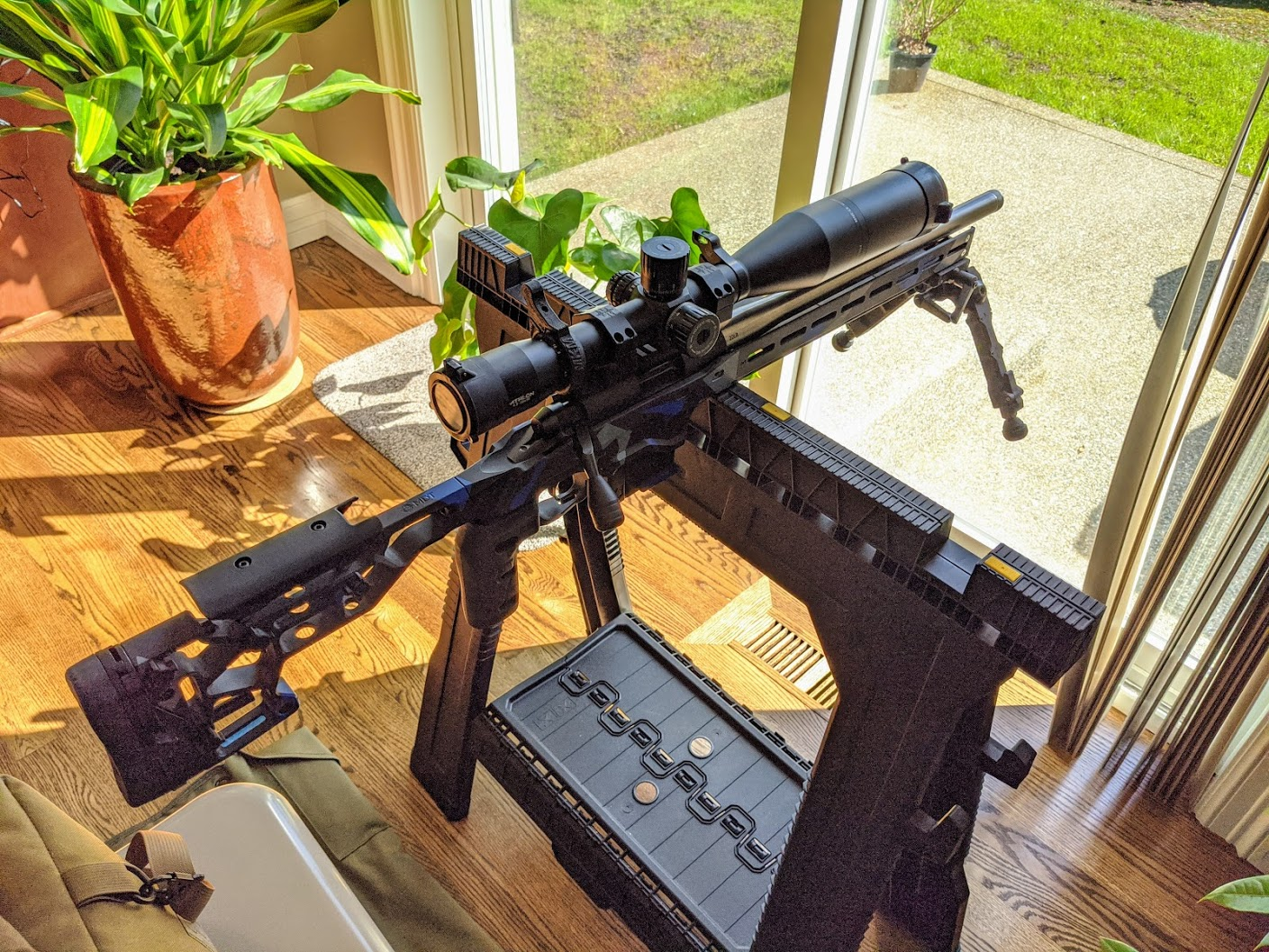

I actually tore down my .223 trainer to build my Vudoo. It sits in an XLR Carbon chassis and sports a Jewel trigger. Below is a picture of the setup. I’ve only had issues feeding CCI SV ammo but have since switched to SK, and all feeding issues have gone away. The rifle now wears a S&B PMII 5-25. It’s my favorite rifle and gets shot often.
