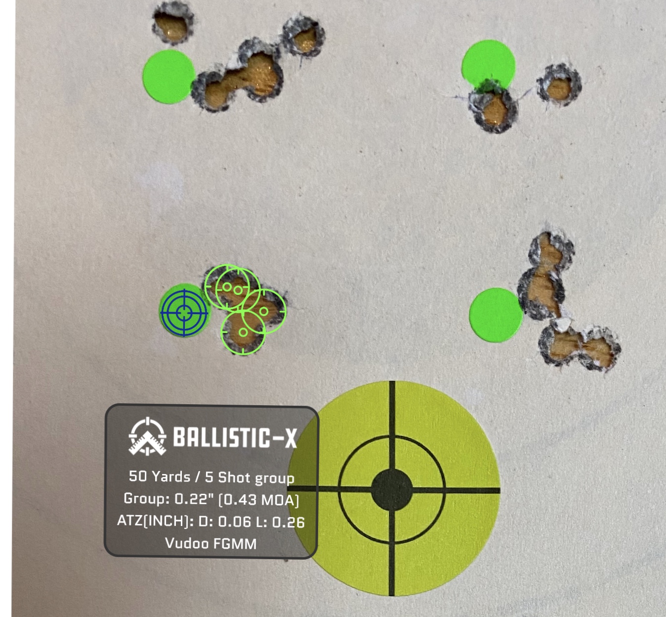

No criticism implied - was just trying to help :) If you are referring to the picture in post 5043 ? i cant see how close the sensor is to the flight path. My experience is that you want to try and get it to be only a few mm ( max 1/8th" ? ) from the bullet flight path.
None taken. I'm completely open to more information that helps me understand better. (y)

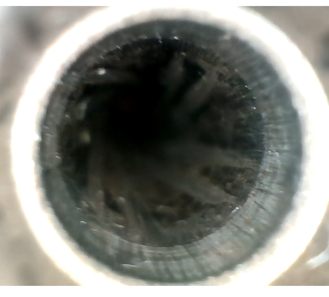

Question regarding cleaning... the Vudoo bore guide states it will accept rods up to .187 diameter. I have a ProShot 20 cal rod, which is exactly .187 diameter. Is that perfect then, or should I get a rod slightly smaller?
They use the MTX rod with a diameter of .160. I was just curious if I should buy a new rod or if my .187 rod is suitable.
Basically generic question - should my rod be smaller than the bore guide, or is an exact fit okay?
Do you guys just mildly clean when accuracy starts to fall off or what? My plan of attack for cleaning is running a patch worm with wet patches soaked in rem oil and then dry patches until no more black shit comes out.
When accuracy falls off. I generally super clean it, and then re-season it. Different schools of thought though... some people say never clean the 22 barrel and only clean the chamber (length of the round) to get rid of the carbon ring/fouling at the chamber. To do that I take a larger patch, soak it in Boretech rimfire cleaner, and let it sit in the chamber for 30-40min. Then I take a 22 brush and scrub only the 1" of the chamber to get rid of the carbon ring and wax/lube build up. Then I just push some dry patches through.
If I do a full clean... I push in 3 wet patches of Boretech Rimfire cleaner, and let it sit for 30min. Then I'll come back and dry patch it till it's clean.
Are you using nylon brush?
Yes. Though I asked a smith and said it shouldn't matter as brass bruss isn't going to scratch your barrel.
That's correct. The only time I use a nylon brush it when I want/need to change directions with the brush still inside the barrel. My common use would be to try and remove a very light carbon ring. Most of the time it doesn't work anyway and I get the JB with felt cleaners out.

It’s not always the accuracy that falls off. For example, I basically wasted $500+ on the Rifles Only brawl this year because I didn’t clean at regularly scheduled maintenance. The rifle shot fine. Made first round impacts on a stage at 1k, 9, 8, 7 in high winds with 10 or 12” plates. Accuracy never fell off.
By the 4th stage bolt lift was sticky. By next day I was beating the bolt open and had lost so many points from that + the beating open, I stopped shooting with 3 stages left.
Between diagnosing with different methods and eventually a bore scope, the problem was a carbon ring so bad that it had turned my .020” jump into a jam. See the pic below.
So, wait for a problem to start (accuracy degradation is a problem) before you clean and see what happens to you.

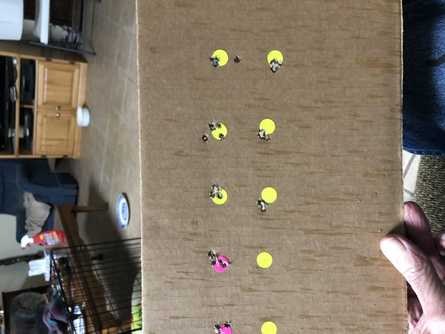

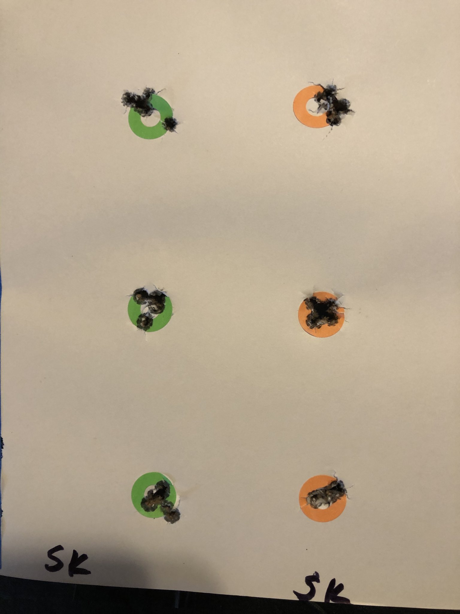

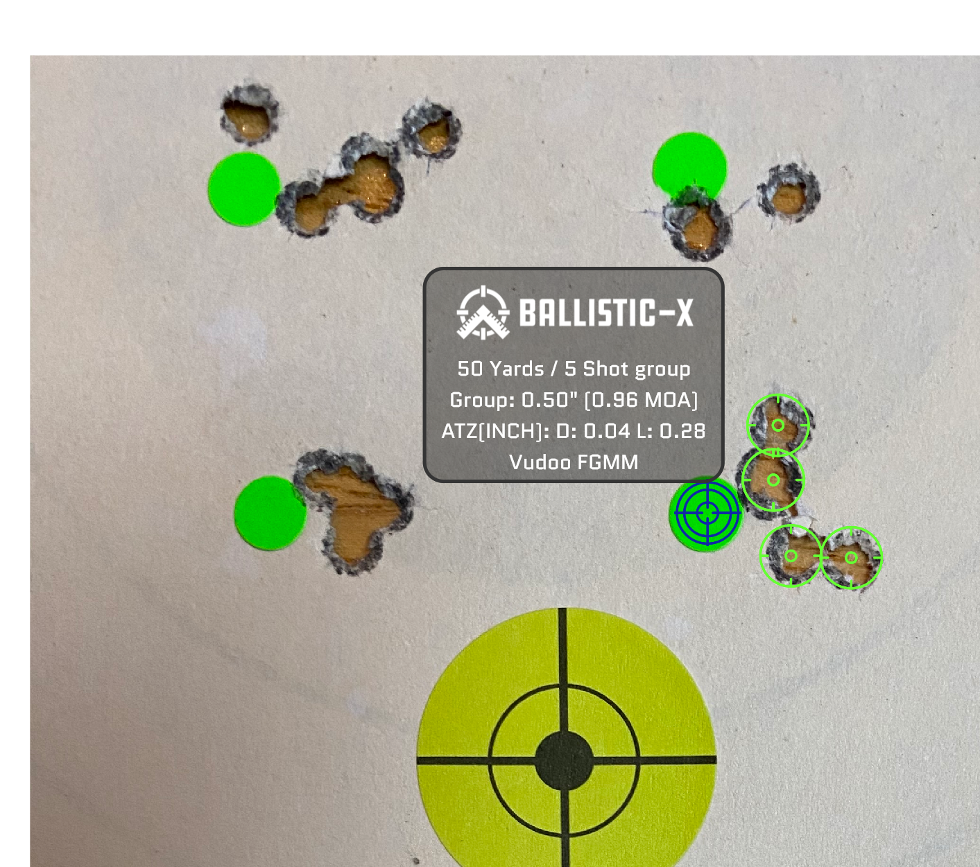

Got my silencer today. Top left and right 3 are without silencer, left except very top one are with silencer. I hate it but it looks like silencer is going back in box.

My suppressor is detrimental to accuracy in my rifle as well. I'm trying a 45 cal Quiet Bore to see if it effects accy the way my dedicated rimfire can does
i have two savage - bartlein 6.5’s that omega 300 seem to help, certianly don’t hurt. Yester day was first time i tried it on 22, i’m not giving up yet. The 22 is very quiet.
