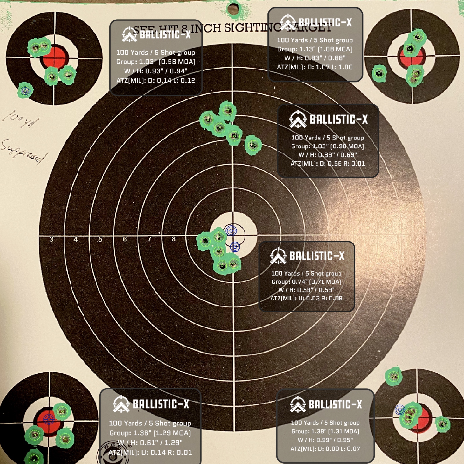

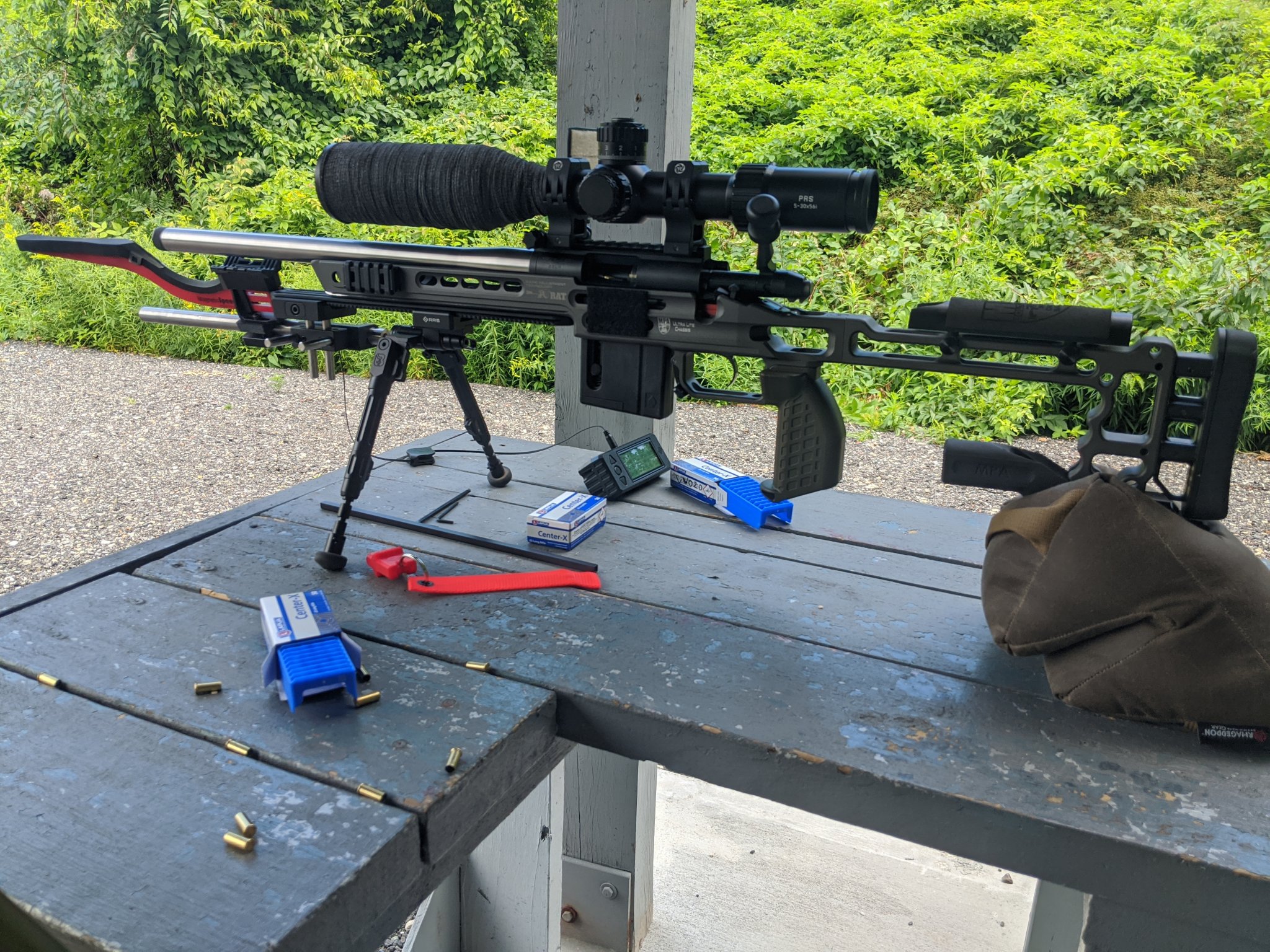

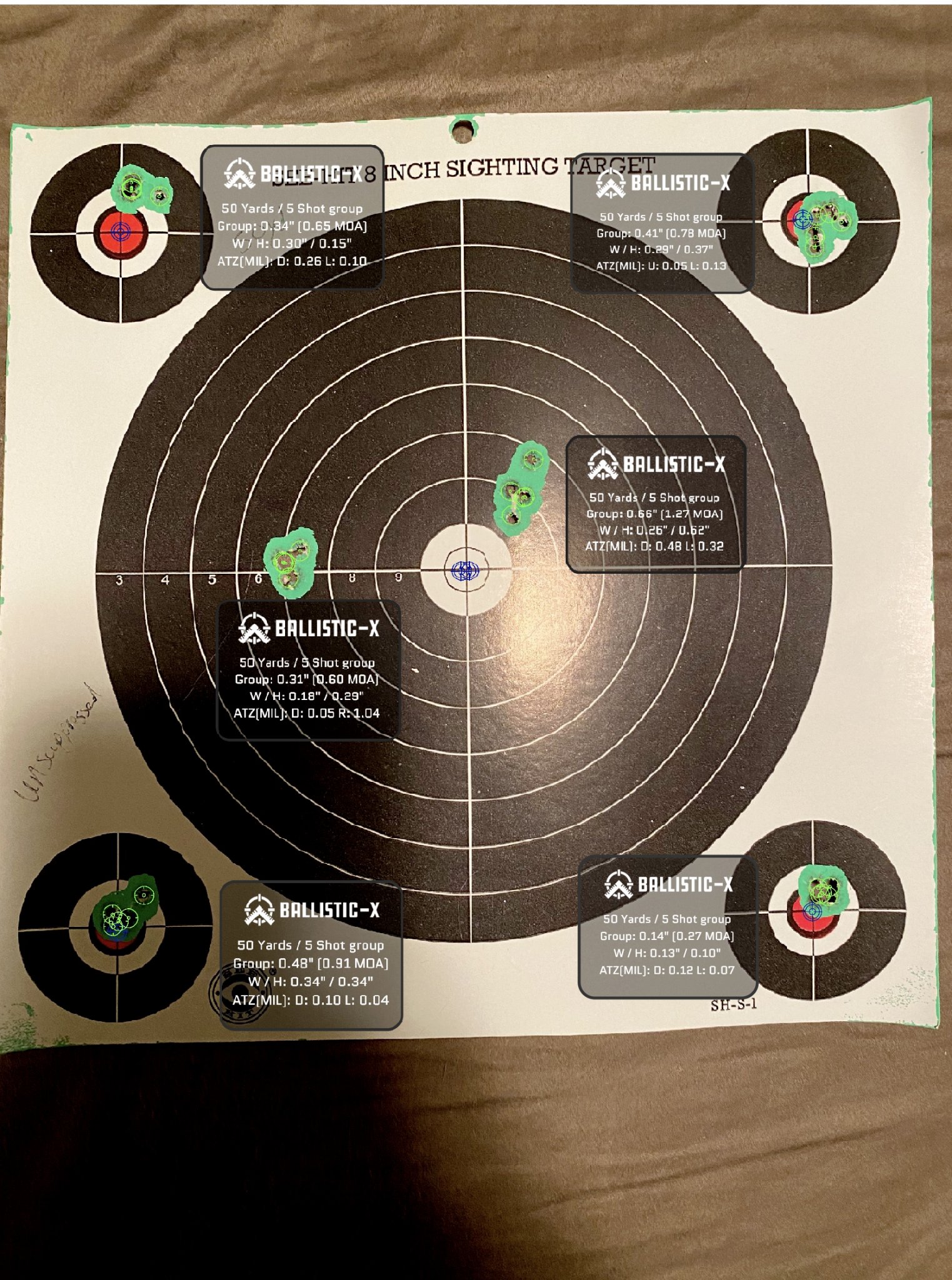

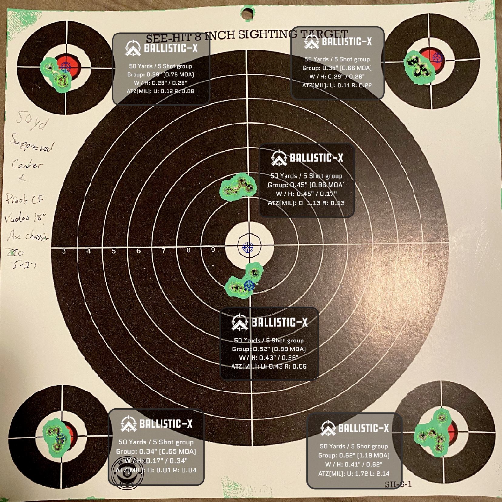

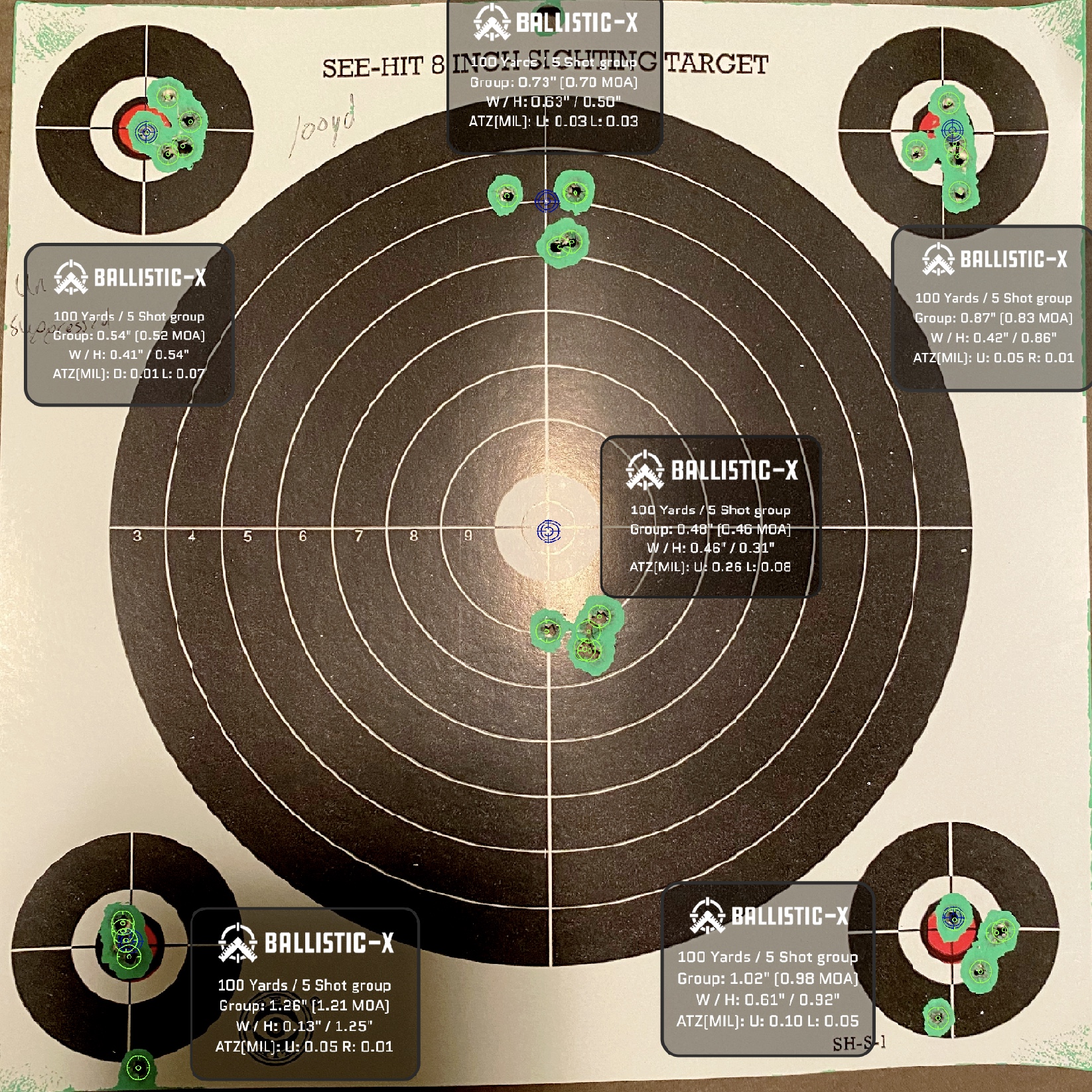

50 and 100yd 6x5’s from tonight both suppressed and unsuppressed. Unsuppressed definitely did better over all, but suppressed is still good enough for the girls I go with 😁 Didn’t help I had AR’s blasting next to me in an indoor range
AVG group size unsuppressed 50yd target: 0.74moa with the smallest being 0.27moa
AVG group size unsuppressed 100yd target: 0.78moa with the smallest being 0.48moa
AVG group size suppressed 50yd target: 0.85moa with the smallest being 0.65moa
AVG group size suppressed 100yd target: 1.05moa with the smallest group being 0.71moa.
View attachment 7361210View attachment 7361211View attachment 7361212View attachment 7361213
Proof carbon fiber 18” barrel
Thunderbeast 22TD for the suppressed shots
Lapua Center X
aiax chassis
ZCO 5-27
Atlas PSR bipod
TT diamond single stage (for now)
Great shooting Krob! Any idea why those groups opened up a tad when using the can?
Reactions: Krob95
Thanks man!!! As far as the groups opening up, it could be a slight change in barrel harmonics (though the smallest group I’ve ever shot ever at 100yds was shot with this rifle and can combo), or the fact that I was a little irritated by the fellas three benches down blasting away with braked AR’s on an indoor range. Everything else stayed constant as it was all shot in the same sitting.
10-4. Harmonics came to mind but I've never compared any of mine with then without. Maybe a cold cerveza might of helped.
If you have a can, it’s worth it to establish a reference of what to expect. Next time I go I think I’m gonna do 6x10’s (6groups 10rounds) with can and without to see how much more it opens up

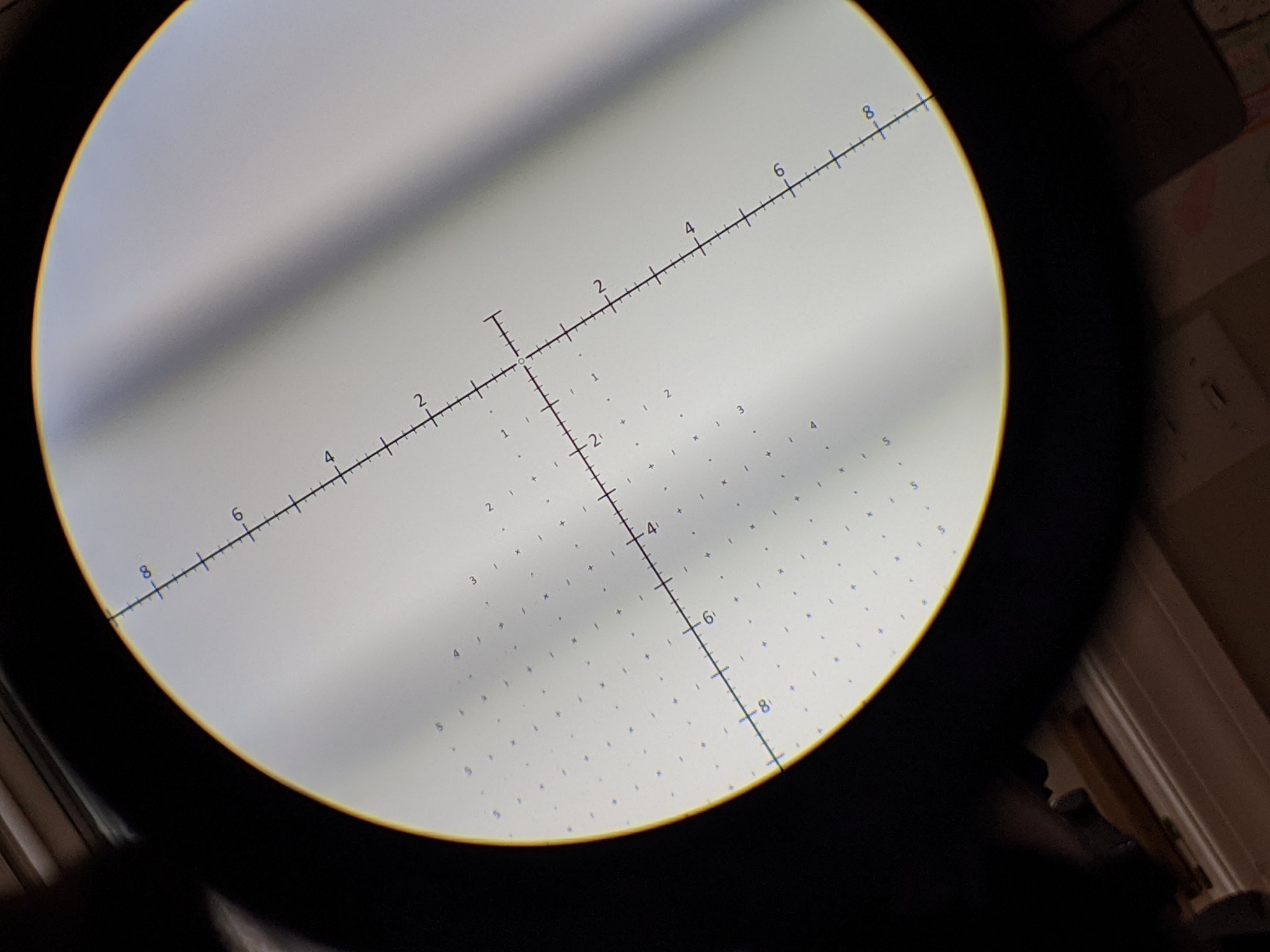

Ok Vudooers, I have a NRL22X match coming up in late-August out to 500yds! 😬
I have the 20moa rail, and about 17 mils of dialable elevation in a Leica PRS scope with a 50y zero.
500y is @ 28 mils for me. And i don't want to dial to max at 17mils and try to hold 11mils, with wind and all outside my X-mas tree.
What moa rail should I get? Thinking the 30, but not sure about the 40...
Also, when you swap your rails, do you have a preferred method--do you locktite the screws?
What torque value on those rail screws are you using? I know those values are for dry threads! I once had a badger rail shoot loose on a Rem700, so I'm paranoid about non-integral scope rails.
TIA HIDE!

I have a 40 MOA rail and 22.5 MILS of dial available and I still can't dial to 500. 425-435, depending on temps, is my max dial. I'd suggest a 50-60 MOA and you still need to check that you'll be able to zero it without bottoming out the erectors.
Edit: NX8 4.5-32 for reference. 50 MOA would be no. problem for me, 60 I would have to actually mount it and cross my fingers to see. It's too close to spec it w/o mounting it.

Gonna get a 40 and hopefully that'll keep me in my Tree at 500.
Or, considering an ERATAC adjustable mount... $$$
I have the 40, and I run out around 440-450 of dial with a Nightforce NX8, I have heard that folks with 50 moa bases can still dial 25yards, and I believe that would get you to the big 500.

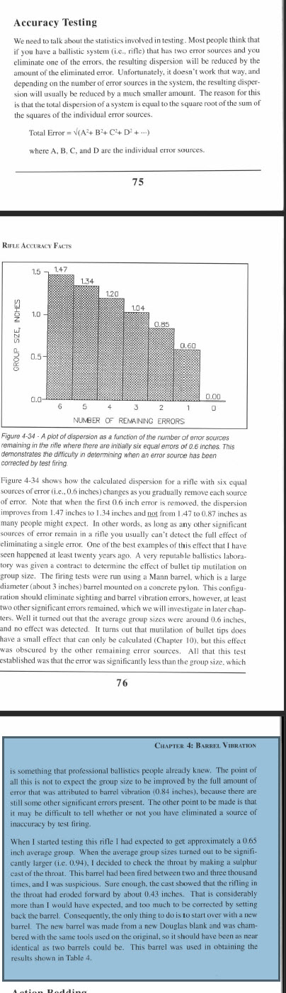

HB:
Several pages from Vaughn's "Rifle Accuracy Facts". You probability know this but in case not uppermost. And Vaughn does not justify the formula so take with a small tater.
Conclusion is taters do add up but not in an obvious way.
My Ballistic Program I use says you would need 100 MOA to go to 500 Yards. Quite a bit...

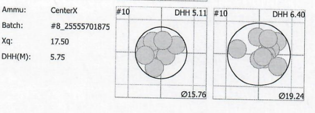

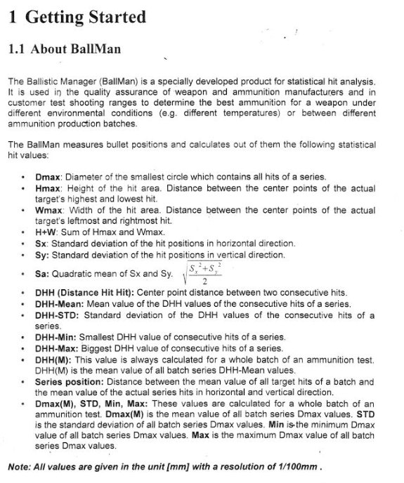

I just got my results back from the Lapua Testing Center. I believe my Rifle has about 3000 rounds through it. I had them test Midas+ and Center-X. The first day they focused mainly on Midas+ with only a little Center-X testing. I asked them about how I thought some Center-X might be doing equally well and they retested with Center-X more thoroughly the 2nd day of testing.
In general they said they found that 20" barrels did better than the 16-18" barrels and my Vudoo performed about the same as the other Vudoos they have tested. I guess nothing to write home about... A 6x5 is very different then doing 10 shots in a row is what I learned. My 10 shot groups at the testing center were a lot larger than I thought they'd be! I ended up ordering 2 cases of the Center-X xx...1282 lots, though the Center-X xx...1733 also performed very close.
I sent in my SK+ and my PMS as well.

What scope are you running? I’m using an SHV until my new scope gets here. I didn’t check the down adjustment after I zeroed at 25 yards, but using a 40 moa base leaves me 22.5 which gets me almost to 450. New scope should hopefully give me an additional 7 mils on top of that.
I use a Leica PRS. It's got 32 mils of travel. I've got 17 useable with a 20moa rail right now. Gonna get a 40.
Guessing that'll give me 23 usable...
And here's the tree I'll have to use at 500, with a 5mil hold... methinks. 🙄
Good shooting, Rick

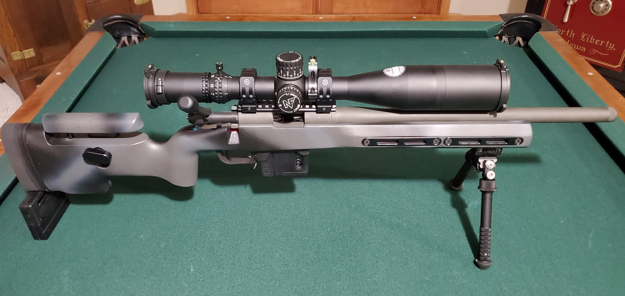

I did almost the exact same thing RN just about a month after you. Read and read then finally joined- and most importantly ordered. My delivery date is first week of Sept. Just about everything else has been delivered (glass, rings, ammo, etc.). I've enjoyed reading this thread very much and have learned a lot and enjoyed looking at the pics of rifles and targets !
Ditto... and I received this earlier this month. I've been out-of-state but had opportunity to zero while visiting brother-in law in Colorado. Used 1st 9 rounds to dial in. This 1 inch blue dot caught the next 11 rounds. Only at 25yds but very promising.
50m
Ammo# ShotsE-EC-C (inches)MOADHH - Mean
SK+ Standard Plus1020.860.60025984251.0484770774.57
Pistol Match Special1020.50.58608661421.0237206236.85
Midas+ 11_265557022351015.060.37191338580.64962309993.88
Midas+ 11_265557022351019.520.5475039370.95632805465.08
Midas+ 13_265557025461015.060.37191338580.64962309994.32
Midas+ 13_265557025461018.080.49081102360.85730223968.52
Center-X 3_235557017331014.640.35537795280.62074057052.7
Center-X 3_235557017331020.30.57821259841.0099670387.49
Center-X 3_235557017331016.560.43096850390.75277499054.85
Center-X 4_245555012821020.560.58844881891.0278466995.05
Center-X 4_245555012821014.70.35774015750.62486664614.09
Center-X 4_245555012821015.340.38293700790.66887811945.45
100m
SK+ Standard Plus1040.521.3742755911.20022726219.92
Pistol Match Special1050.221.7561653541.53375170810.46
Midas+ 11_265557022351031.31.0112834650.88320711779.1
Midas+ 11_265557022351047.441.6467165351.43816428913.56
Midas+ 13_265557025461027.60.86561417320.755986452710.16
Midas+ 13_265557025461032.541.0601023620.925843232519
Center-X 3_235557017331026.260.81285826770.70991194156.16
Center-X 3_235557017331040.961.3915984251.21535620517.86
Center-X 3_235557017331030.580.98293700790.85845066410.64
Center-X 4_245555012821036.381.2112834651.05787765210.35
Center-X 4_245555012821028.020.88214960630.77042771739.67
Center-X 4_245555012821025.880.79789763780.696846035411.39
Can you break this down a bit more. I'm confused about how they measure and what the abbreviations mean. I'm guessing E-E is edge to edge and C-C is center to center. If so, how are they measuring MOA? And what does DHH mean?
littlepod
Looks like this is the ammo for your gun:
I ended up with the Center-X 4_24555501282. It slightly beat out overall the 733.
50m Average MOA 0.7944941995 with a DHH of 5.013333333
vs
50m Average MOA 0.7738638214 with a DHH of 4.863333333.
They only measure Edge to Edge, I did the conversion to C-C by doing "{value} / 25.4 - 0.221". I also calculated the MOA for 50m and 100, for 50m = "{value}/( 1.093613 * (1.047/2)) "
Their terminology -
Sample of one of the ammo -
That's a SWEET looking rifle! Looks to be a tack-driver also. Congratulations!
