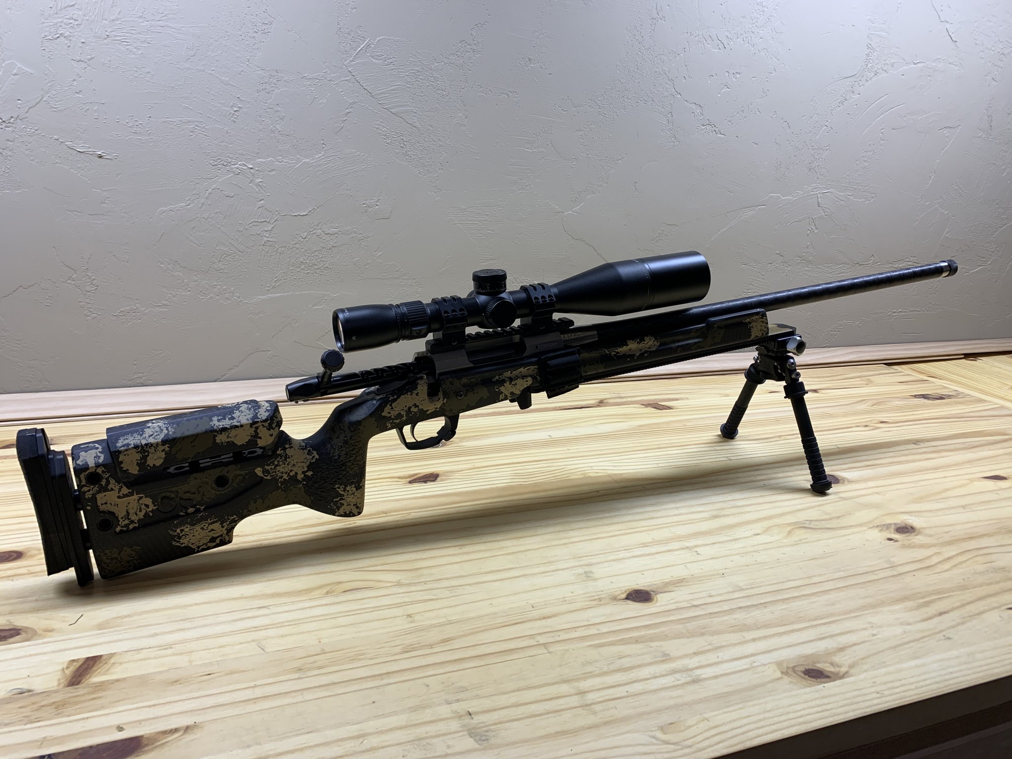

Anybody with a Manners TCS.
Is there an ever so slight upward angle on the A419 rail in the last 2 1/2" past the end of the stock. Mine has it, doesn't affect use of rail, just wondering if it's design or mine took a hit and tweaked it. Cross section of rail is thin at that point.
Reactions: MPrimo
If I remove the rail, its straight. The bottom of my TCS isn't straight. There's a 1/16 inch gap or so in the end when I'm putting it back on, but it tightens up just fine.
If you mean there's a slight but abrupt change where the rail is unsupported, no it probably got tweaked.

That describes the situation exactly. No damage to rail, will have to be wary about running bipod at tip.

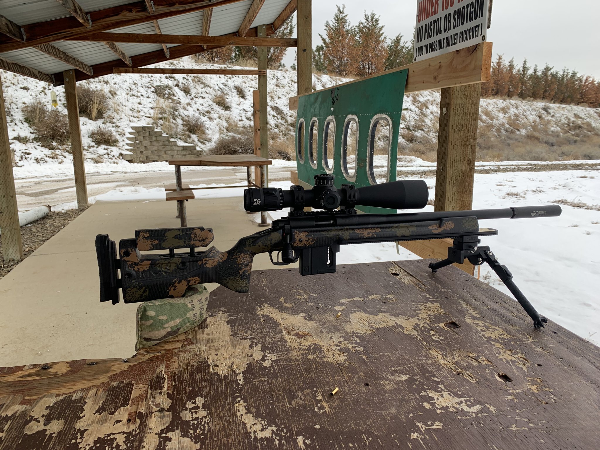

Is anyone having problems with Vudoo mags in TCS stocks? Mine sit really low and cause feeding issues.
Do you have a gunsmith near you that knows what he’s doing? If so, I may have him weld a little bead on the mag catch and file it down to get the mags to sit higher. That’s what I did to my AI AX chassis to fix my issues
i don’t have anyone close. I don’t necessarily want to mod a 1500$ stock either. Makes it hard to switch around or sell later if I want. If push comes to shove, I’ll put it back in my foundation. That one didn’t have problems.
It’s a mini chassis so there shouldn’t be an issue. Have used my Vudoo in at least 4 Manners with mini chassis and they feed perfectly.
Is it just one mag or all of them?
Worse case senerio, buy just a replacement mag catch (Manners will hopefully give you one after you explain the situation) and have that one modded, then you can return the stock to factory configuration if plans change.
I got mine in a TCS and it feeds fine out of all of my plastic mags I did order it from manners to use with a Vudoo action so it might have a longer mag catch than normal.
I believe all that does is effect the ejection port and bolt release placement. All my mini chassis are for centerfire rifles and the mags run fine also.
I have three plastic mags, and two TCS. All mags and both TCS the mag is loose. I only tried feeding with the one the Vudoo is installed in, but the other TCS is just as loose.
There can be variations in actions that affect feeding height and require different mag catches, even though all the mini chassis are the same. My PRS-TCS needed a shorter mag catch for most AICS mags in centerfire, and I had to get a longer catch for the Xylo/Vudoo combo.
I must be the luckiest bastard around as everything feeds from all my mini chassis stocks. Centerfire AICS and rimfire. LOL Have had multiple Rem 700, Surgeon, Bighorn TL3(.308 and .223 bolt heads) and Vudoo in mini chassis and all feed great.
it's cause you're a jersey shooter. didn't you know they hand pick and QC every little piece of gear you get :ROFLMAO::ROFLMAO::ROFLMAO:
My aluminum mags fed well from the Xylo, but the poly mags would not feed the last 2 rounds given how low the mag sat and the spring not pushing the round far enough on the last 2 rounds.
I ended up also getting a teensy bit higher mag latch for the Xylo just to have it work always.
