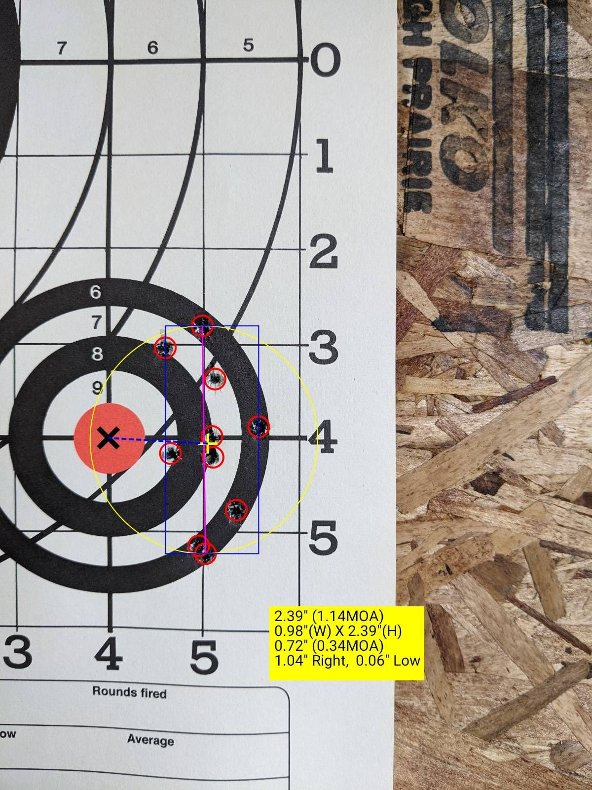

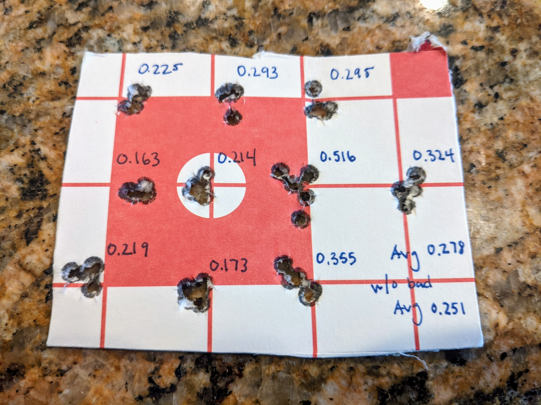

Went out to the range today to confirm dope and take time on paper. Also took time to do all the proper natural point of aim, follow through etc to try to get a decent set of 50yd groups. The freshly cleaned and lubed 360 felt great. Really smooth feeding and shot well. The one larger group, I rushed since they were going to call cease fire for target change and I wanted to fit the group in.
I checked my kestrel and dope out to 200 and it is within .05mils which is good. Slight left to right wind. Kestel called for 7.34mils and I dialed 7.3mil.
My 24xx lot shoots well enough for me to use until it's done. Chronoing at 1055. 2mils to 103yds, 7.3 mils to 200 yds. 50yd zero.
There are some very nice groups on the 50 yard target above.
On the one that measures 0.219" on the bottom left corner, how can a group be smaller than .22" when there's clearly paper showing between the two widest apart bullet holes?

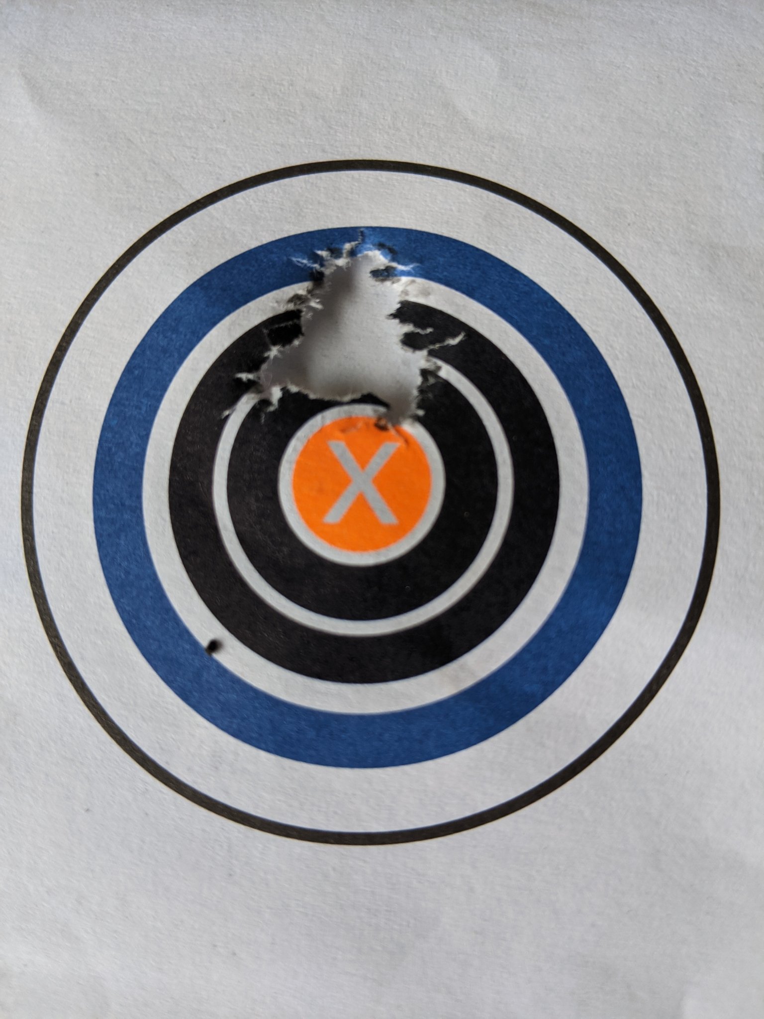

Good catch! I remeasured it and it's .449. It looks like I quickly measured top/bottom instead of that diagonal which is larger. The group should've been .228, and not .219.

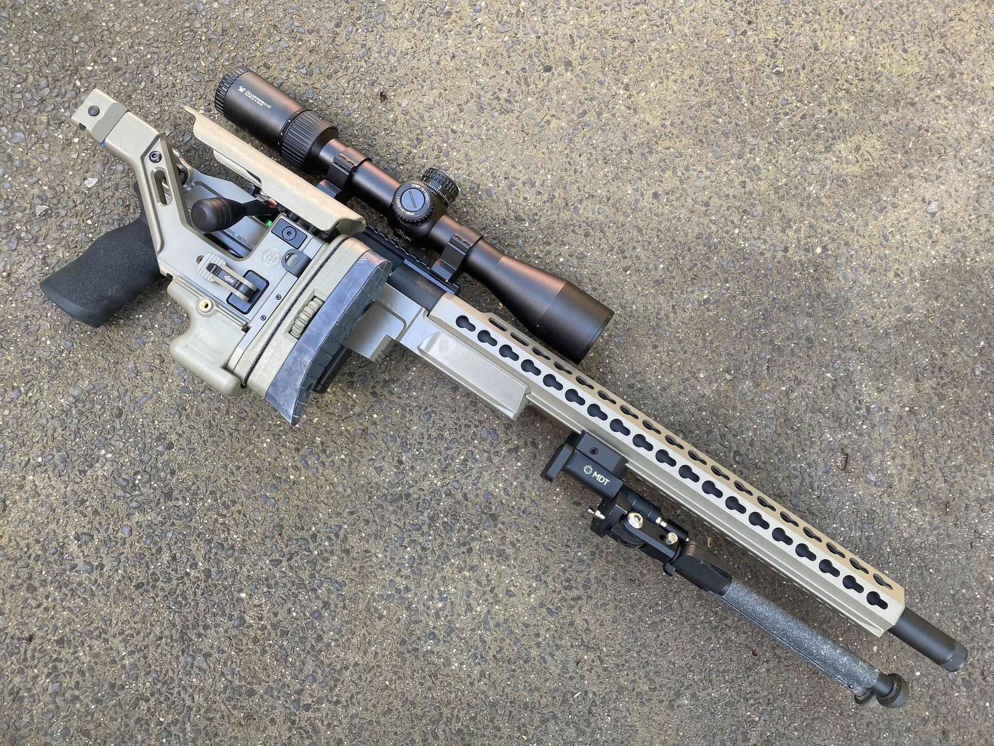

Finally solved my magazine issues with my Gen 2. I have been using the plastic mags in a MPA Hybrid Chassis. I have had issues with the plastic magazines if bumped even just a little, which can be problematic on the clock when the rifle is resting on a bag. Push the bag there is normally a jam. My chassis has an adjustable mag latch and I could never find the sweet spot that would use both metal and plastic mags. I added a second and third metal magazine to the mix and decided to set it up for the metal mags only. MPA makes small plastic inserts for their chassis to fine tune the fit. It slides in the chassis above the mag latch. I got the metal magazines to fit perfectly, (at the perfect plastic mag setting the metal ones would not click in) with the bolt just missing the top of the mag. I took this configuration to the range yesterday and I literally could not make it misfeed. I shot several mags on bipod and rear bag, no problems. I then shot several pulling very hard to the rear on the mag, bipod, shoulder and left hand pulling hard on the mag, still perfect. Then I shot several holding the rifle up by the mag, hand cupped underneath supporting the weight of the rifle, again no issues. Then I put the rifle on a bag on a rooftop prop and pushed hard against the bag, still perfect. If you have a MPA Chassis and are having trouble I suggest you order the little plastic blocks from MPA and see if they work for you with the proper mag latch adjustment. I used blue loctite to help keep the plastic piece in place.
I had to use Gorilla Glue. Even basic "Super Glue" wasn't enough to keep the plastic block in place on mine longer than a single range session with multiple magazine changes.

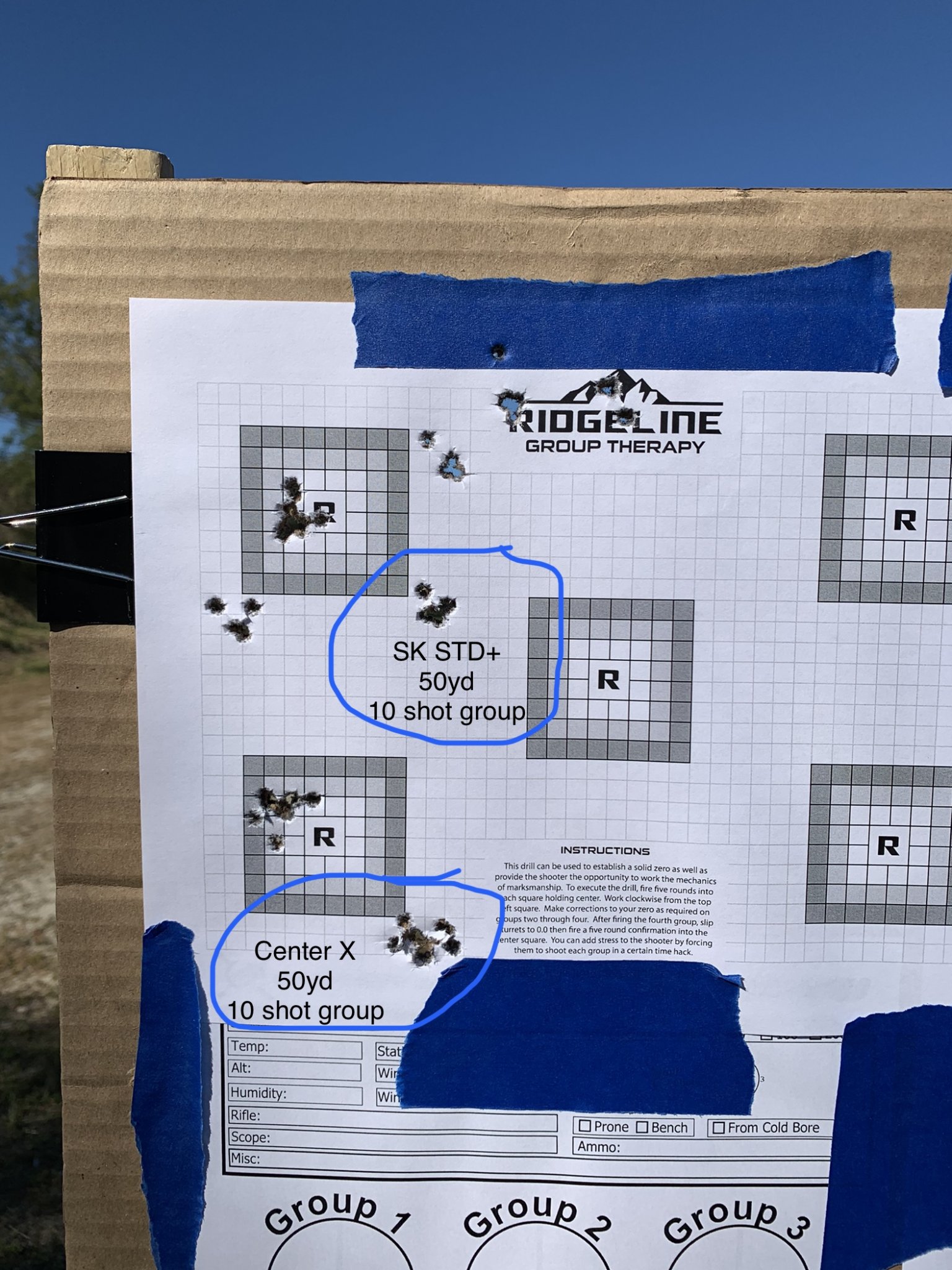

Prone 22” MTU V22 360 10-shot groups with Center X and SK STD+. For consistency, initial 10 shot groups are on the top left corner and followed by the test groups on the respective bottom right corners.
I’ll happily continue buying SK STD+ for this.

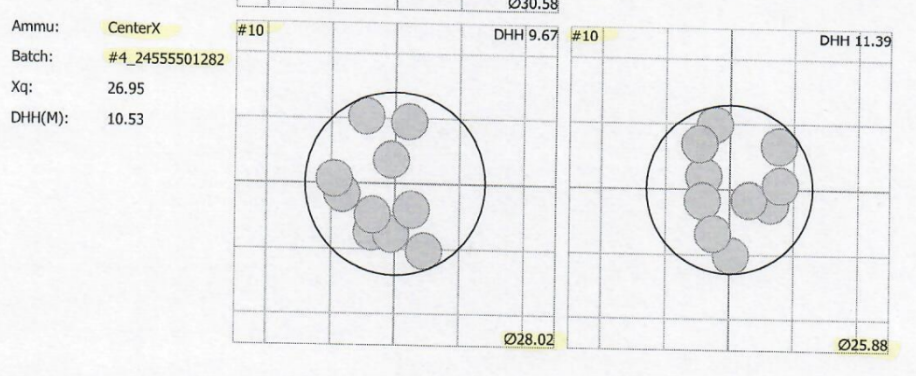

Sent my Vudoo to the lapua test center in Arizona. Took right at two weeks to get results. Results came on Friday, with top two lots picked (he only had one case of the best lot - and I had suggested I would buy two). Responded that I would take two, and to use good shooting inc for the seller. By Wednesday of the following week (5 days after testing) I had two cases delivered to my house. The action made it back in Friday (7 days after testing completed). Devan (the guy at the test center) answered a lot of questions along the way, and was very helpful.
I cleaned the action, remounted my scope, and shot the rifle in a local NRL22 match yesterday. Took about 15 rounds to really tighten things up, and another 15 to confirm dope. I still struggle some times with the bolt being very hard to close using the metal 15 round magazine. I need to tinker with the mag catch today, and to install the mag blocks (MPA hybrid chassis).
Here are the 50 meter and 100 meter results from my testing. The rifle has a 22” MTU barrel, and it has over 2,000 rounds when I sent it for testing.
Just thought that someone else might benefit from seeing what you get.

Probably not substantially better, but that is a subjective assessment. I could have sent the current center X to the test center, and asked for a baseline using that. But I didn’t think to.
There are a few interesting things with the results that were sent to me. One was that the worst lot of Center X was remarkably worse compared to the “best.” The image below is 100 meter groups. I’m sure most guys will be “yeah, duh! Anyone knows that!” But this was done in a very controlled environment, removing as many factors as possible.
I don’t have enough of the “old” lots to do a real world comparison. I was able to shoot 3/4” groups (5 shots, max center to center measurement) at 100 yards. But I never tried to shoot a group with 10 shots. So I do believe the new lots are more consistently accurate. I have not found a good conversion to change a 26mm group at 100m to MOA at 100 yards. Anyone - please share the math there to get a good compassion. And that 26mm is outer diameter - not center to center.
And quite honestly, I used this service to buy enough ammo to shoot competitions for well over a year. That alone was worth it for me. 😀

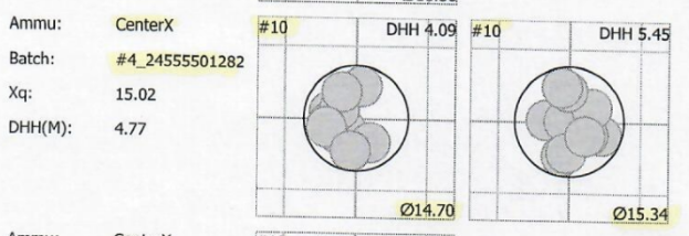

Thanks - so for the two 10 shot groups above, the average was 29.8mm edge to edge at 100m.
Converting to inches at 100 yards -
29.8mm/25.4mm/in = 1.17 in (edge to edge)
to get CTC, subtract 0.223 in
1.17 in - 0.223 in = 0.950 in (10 shot group, CTC, @100 meters)
converting inches at 100m to inches at 100 yards - multiply by 0.9144
0.950 * 0.9144 = 0.87 in @100yards for 10 rounds, CTC
Am I blown away by the results - not really. Was hoping to see something closer to 1/2”, but I really have no comparison.

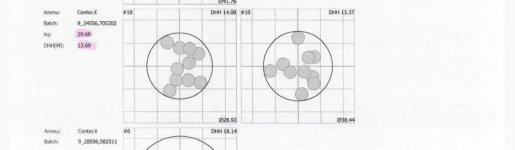

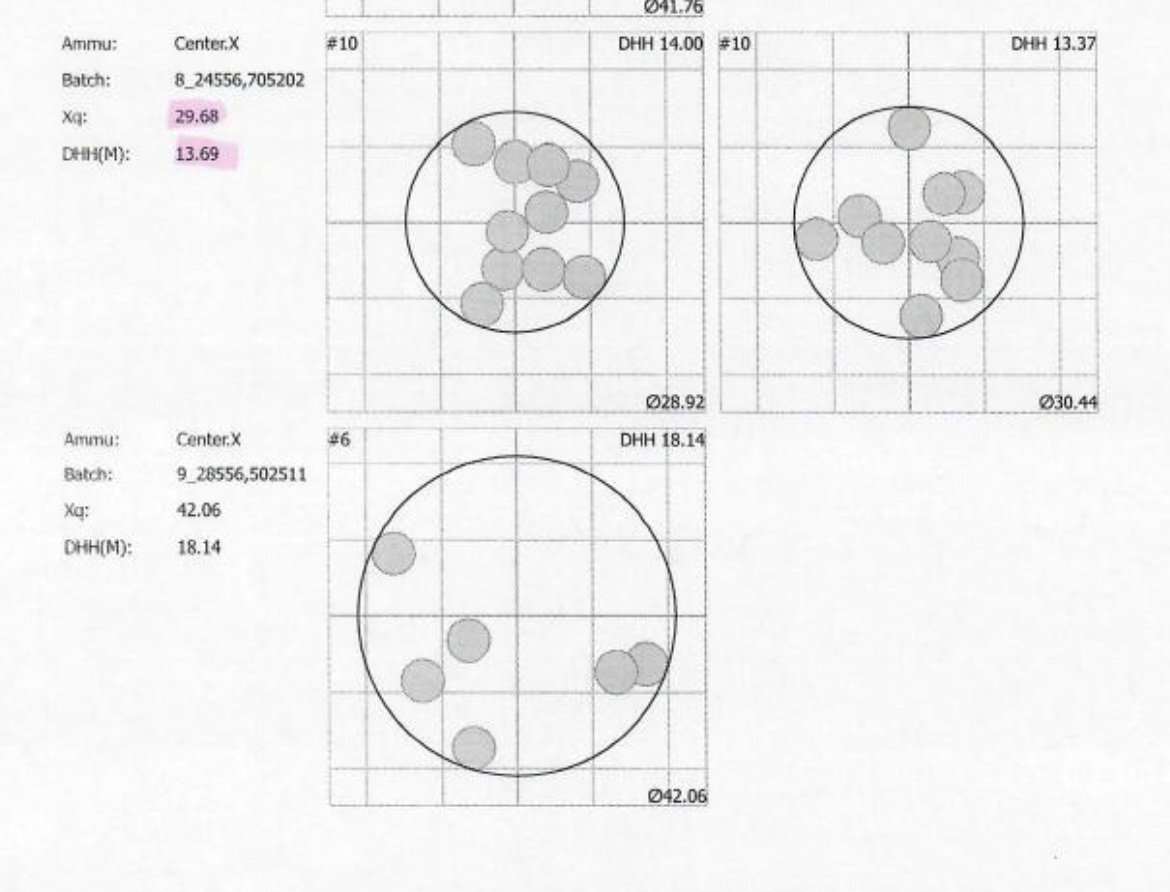

Lapua Test Center results for a V22 22LR Gen3 22" MTU-V barrel and Bix'nAndy 2-stage TacSport Pro trigger if that matters for Lapua Test Center testing.

Can someone interpret the results for me so I understand what I'm looking at. I get the gist and you can see by just looking at the groups. But I'd like to know what all the abbreviations mean and how they relate to how we normally talk here on the hide. For example, they measure edge to edge rather than center to center, etc.
An edited picture with arrows and explanations for this caveman please. 🥸
Thanks littlepod, here is a link to the manual for the insomniacs in the crowd.
In it I found the answer(sort of) to my one remaining question. The bar graphs on the right of some of the pages are the 'ring value distribution'. I assume that would be the rings of an established and sanctioned target, likely popular in Germany/Europe. Can anybody share some light on that one?
I'd also be interested in opinions on the usefulness/utility of DHH. It seems to me to be pretty irrelevant. I use distance to center of each shot and standard deviation of same. In order to be anywhere near competitive my system has to shoot such that the average distance to center plus two SD's stays inside my 10 ring. This is not a common occurrence for me.
Reactions: Jefe's Dope
@Taqwin
I do not know. I purchased the barreled action from Altus and they did not specify.
@littlepod
The comments were from the tester. My favorite is ES (Extreme Spread) Accuracy, that is specifying a circle of a given diameter around the AP and keeping all the shots, either using best edge scoring, center of the bullet hole or worst edge scoring within/on the circle. However, the Lapua Test Center only does ES Precision Testing but that is the next best test to ES Accuracy Testing. I purchased a case of the preferred X-Act with goal of consistently shooting 0.3 milrad groups at 200yd with various support systems, bipod and tactical rear bag on bench, small tripod with ball head on bench, large tripod on ground, etc.
As I understand it, Lapua manufactures a lot of 22LR ammunition and then tests it. Those lots with the most consistency are sold as X-Act, next consistency Midas and least consistency Center-X. It would be interesting to know what statistical measures are used but variance in muzzle velocity must be one. The head stamp is the same for Center-X, Midas and X-Act. Since there are no environmental effects at my range for the times I shoot, accuracy comes down to variance in muzzle velocity and marksmanship.
My opinion on DHH is that it tells you how big the average shift is between shots. I could see that being useful in a benchrest match to make subtle hold corrections. When I look at my 100 yard groups, you can assume that the shots “walked” a certain direction as they were fired. I looked at that manual, and the software is capable of printing the order of the shots, but I suspect it would make the graph too busy, and not helpful for most.

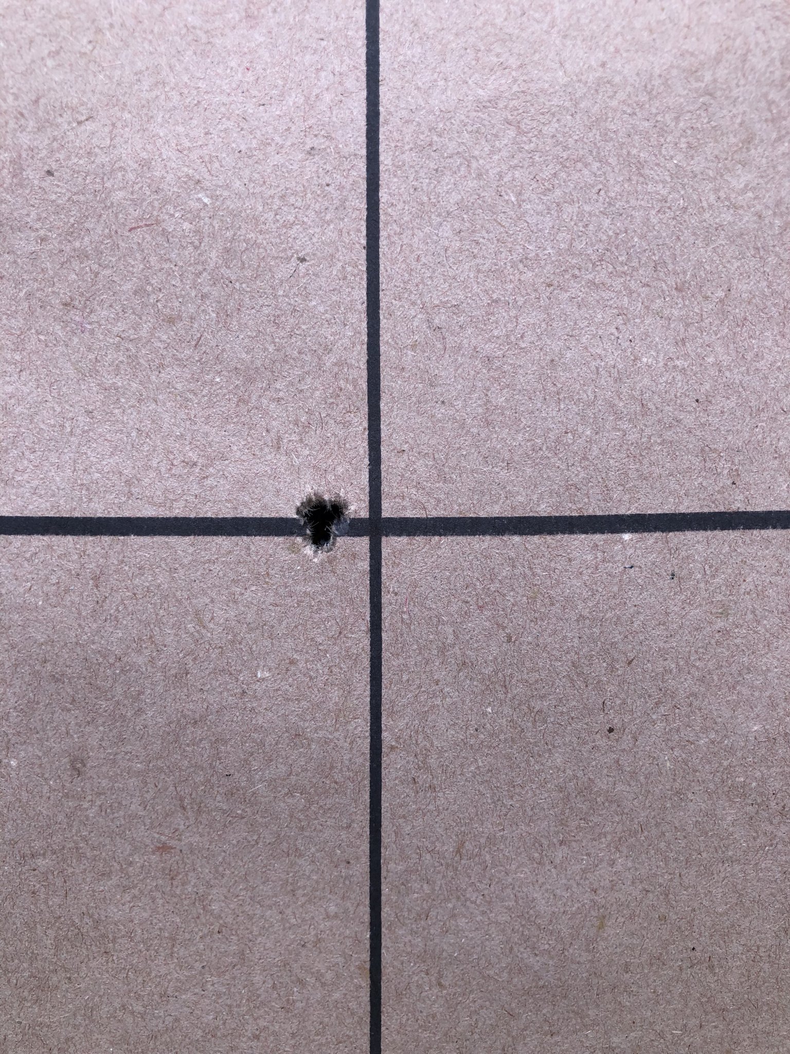

Hey all, my Vudoo Three60 has a liking for RWS R50. Is there a different follower that suits the RWS bullet shape? I have the red follower now and it feeds 90% of the time but I get a few feeding issues. Just seems to be a bit more picky with feed angle in the mag then SK.
I'd have never thought a mag fed rimfire would be capable of shoot groups in the .1s and .2s at 50m with consistency until I got this rig. Its crazy good. MB, you did good work mate. Thanks :)
