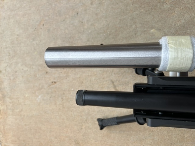

I was unfamiliar with the Pro-X tuner so I called and spoke with Mike to see which bushing I'd need to tune to the Purdy 9th harmonic. I have the tuner enroute to JElrod to fit to my Shilen. I also have a Harrels to compare with. As an aside, I have been messing with chamber specs. I found that the "semi-auto match" Bentz chamber that Manson makes has virtually the same dimensions as the 52D. To get the 52D specs I have in my other barrel I just had him cut it back to .580 and 2 degree vs 1.5 degree leade. It shoots great and no problems with Eley..

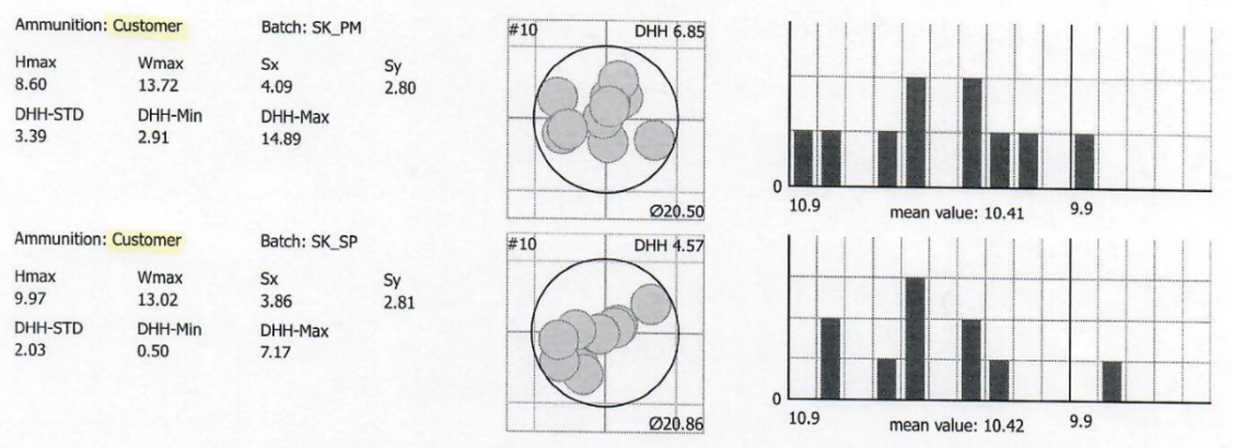

I did the same with SK ammo. I had some that was shooting well and used it to compare against the Center X. Center X was better.
Reactions: Badjujuu

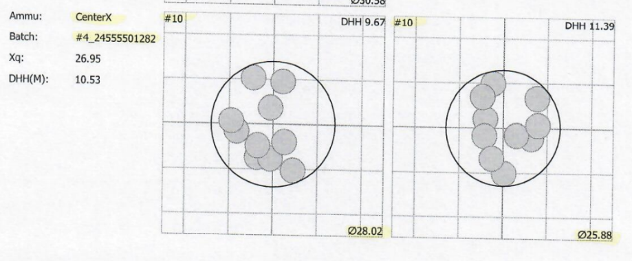

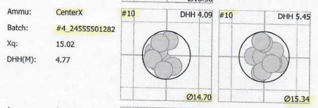

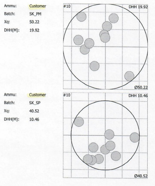

I had tested a lot of SK+ locally and found the best lot, and the same with Pistol Match Special. I sent both along to be tested.

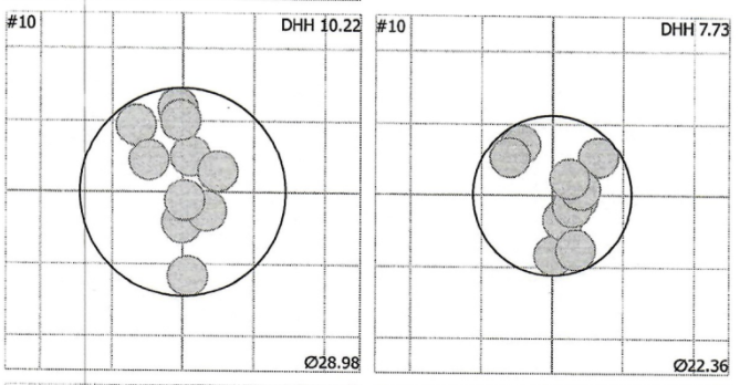

50m
100m
Center-X 50m
100m
I sent this lot with my 360 to see how it compares with their new lots. RIght now this lot shoots the best out of my 360 as well as my Gen 1.2.
My 360 is a 22" Benchmark and my Gen 1.2 is a 18" Ace. My friend built the same exact 360 22" Benchmark rifle and received his a week before me and just got finished testing:
I'll have my 360 results in a week.
Reactions: dano225
@littlepod - are the 100m targets shot at the same time as the 50m targets?
If they are, are the ones you posted from testing in order?
The reason I ask is that I assumed if the bullets fly fairly true the 100m pattern would roughly be a larger version of the 50m pattern, if they are shot from a fixed position.

Yes I believe that's how Lapua tests, at 50/100 at the same time. I expected group patterns to look the same too but they don't.
