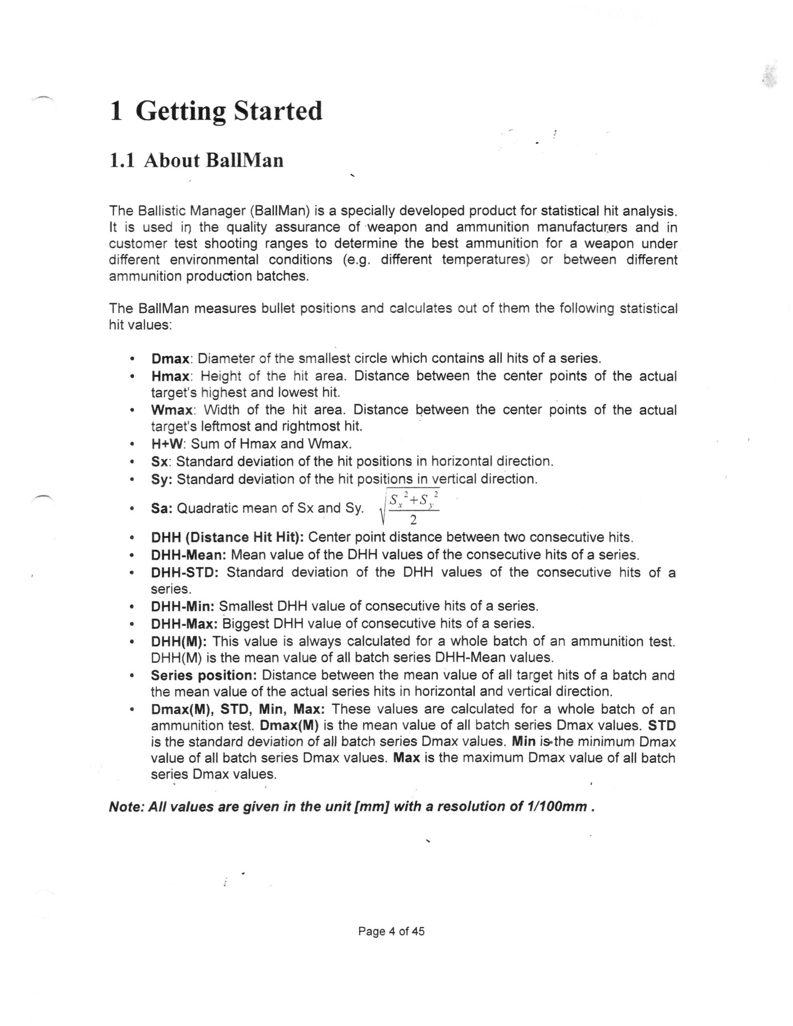

LPTC results for barreled action plus trigger. Vudoo Gen 2 Action, Proof Carbon Fiber Barrel 20", Kukri, 1:16, threaded muzzle, Bix'nAndy 2-Stage TacSport Pro Trigger with ~6 oz second stage pull weight.
Purchased the recommended Midas+ from Capstone, $1792 for the case.
  • Stocker 01-19-22 - CX.pdf
  • Stocker 01-19-22 - Midas.pdf
Reactions: Williwaw
