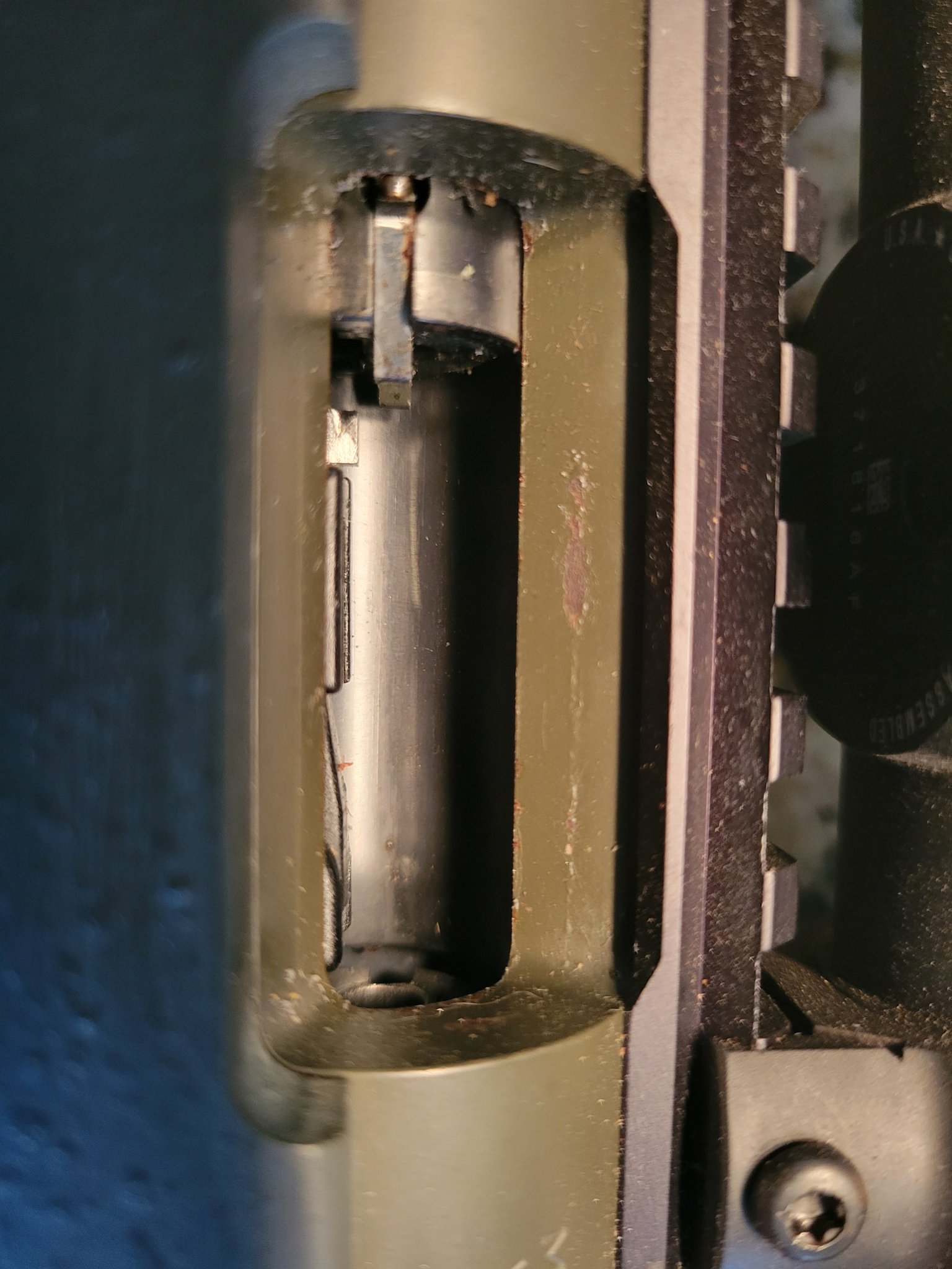

Anyone know how to remove the bolt release from a gen 2? It’s been “sticking” since I’ve had it for a little over a year. I’ve oiled it and worked it both ways and it still sticks open when I release the bolt and I just push the other end to keep it in the closed position. I reckon there is a small burr somewhere and I’d like to disassemble to see but I’ve removed the threaded pin (to keep it secure) but I can’t wiggle the actual release enough to get it out. Any knowledge to point me in the right direction?

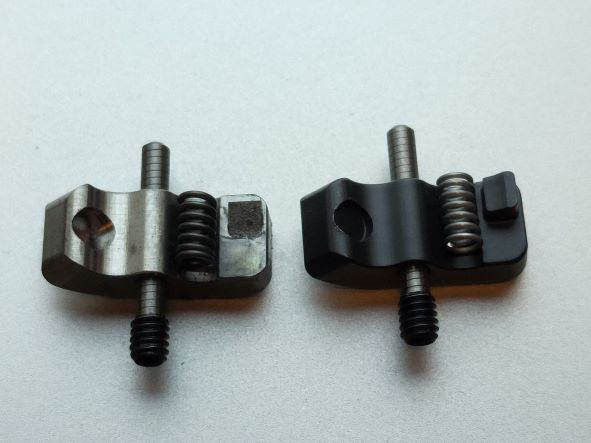

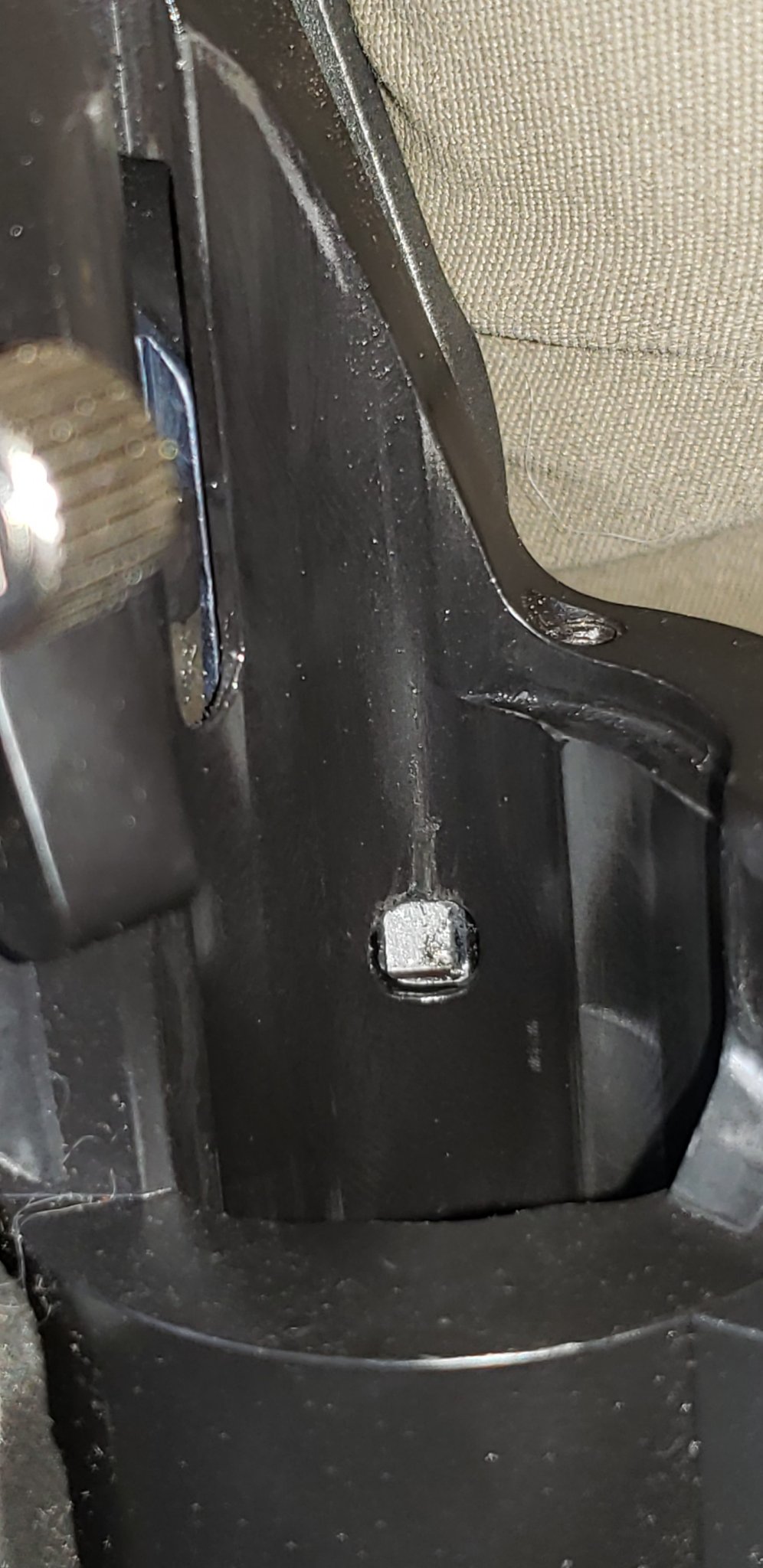

Just took my Vudoo Three60 out of my case after coming back from a match, looks like the bolt stop sheared off?
What's the warranty process like for someone in Canada? Is it possible to just get a bolt stop shipped up and fix it myself or would I have to send the action out? Going to be sending emails out to Vudoo and GBT (Canadian dealer) but since it's Easter weekend I'm not expecting replies until Monday. I have a match in two weeks so I just want to know if I need to spend my weekend sourcing another rifle or if it can be fixed in time. Does anyone know how long the turnaround time is on a fix like this (estimate)?
I don’t know if your new bolt stop arrived but one thing to look out for is a burr on the action on the outside of the hole under the bolt stop lever. When mine broke it caused a burr big enough that I had to send it to a Vudoo approved GS throug GoBig in Sask to have it machined down.
I haven’t had this problem, but in September the bolt stop on my Vudoo 360 sheared off. Vudoo was quick to send out a replacement. I was shooting tonight, and it sheared off again! It’s been 319 rounds since replacement. I’m not working the bolt excessively hard. Has anyone else had this problem?
Happened to me today. Only have about 500 rds through mine. Hopefully they have a replacement out soon before next match this coming weekend.

Update on my bolt stop
Finally arrived in Canada after a month of waiting (thanks USPS) and got it installed. Came in black, might cerakote it in pink to remember the Hi-Lighter days. Easy to install, took 2 minutes and a 1/16 hex key.
Called VGW and there's no update yet on when I can send my action to the Canadian gunsmith for the permanent fix. Won't be sending it out until the season is over so doesn't matter much right now for me. Will be carrying a Hi-Lighter for the remaining season.
