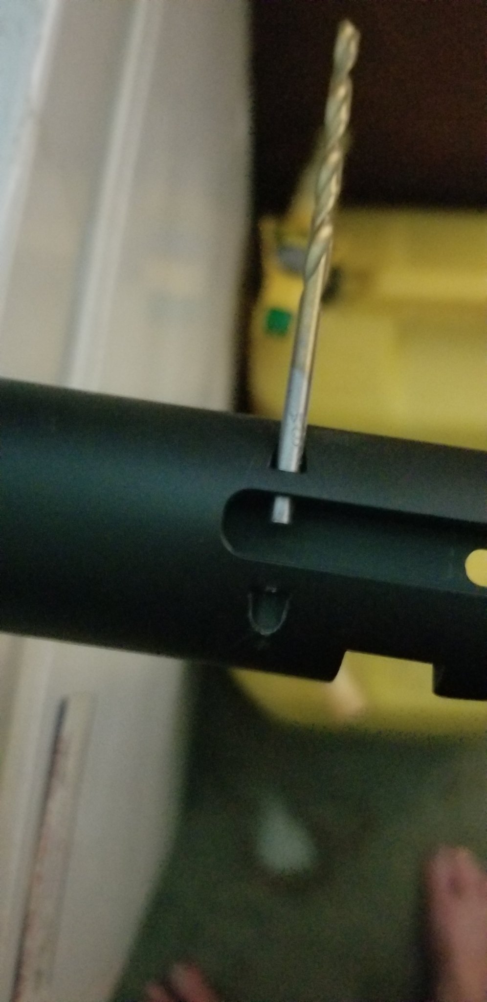

Just got my barreled action back from Jelrod. The one with the test target and went to install my TriggerTech Diamond trigger. There is no way I can get the pins in. I even pulled a pin from mu Rimx to check the fit and the pins measured .1250"" and went in and out, nice snug fit. Trying then in the Vudoo it appears the holes are just too small. I read somewhere another poster found some ..1245" pins. Any ideas? I have some drill bits and they measure .1250. Thinking I can try to polish one down or hand ream the hole though I really don't want.

BFH, they go in damn tight but they go in…

They are SO tight... and my hammer wasn't big enough. I did a heck of a job trying to get my trigger in... doing it a few times though loosens it up but it was a pain. I'm not taking the trigger out ...
My next Vudoo I'm sending Jelrod my trigger to do it.
He had an undersize pin to test. I'm going to try to "slim" it down 1/2 at a time with emery cloth or stone in a drill chuck. I also have some 1/8" drill bits, .1250" I can play with. I one to start but do not want to beat like that with the trigger in. Definitely send Jonathan the trigger. My other idea is to try to hone down a drill bit to get in the holes and clean them. I'm guessing the hole was drilled at .11250" and the ceracote is the problem. Rimx fit was perfect and pulling a pin it is .1250"
More than one way to skin a cat. I have one of those Chinese Ebay drill bit collections from years ago with a dozen or so each size. The 1/8 measures .1250 on the nose. !0 seconds in the drill press and a wet stone, now 1.245 and nice snug fit. I may try to do the pins, but these will work fine after Dremel cutoff and end smoothing. I still don't understand why they come undersized. Just a heads up for others getting acitiions done. There is viceo showing trigger change but that is with an action that already has the pins fitted.
Couldn't get the bolt to close. Didn't realize I needed to move the stop since up til now just shooting the Rimx.. Thankfully, a quick text to JElrod and he got me straightened out. Chambered an Eley and the unfired round ejected. I wasn't sure it would since the Ultimate reamer is so tight.

I have to give a big shout out to TriggerTech and Trent. I got an email response today, yes Sunday indicating that they don't supply trigger pins so i guess they came with the action which if so is surprising that at some point weren't checked. I should hear back from Vudoo this week. I mentioned to Trent that the safety wasn't operating properly. He recommended I check the chassis. Pulled the barreled action, worked as is should. Looks like I need to remove some material from the chassis, MPA HS3.

I don't think any of my after market triggers came with pins, you reuse the ones that the action comes with.

You're right. I was just reaching out. I was just surprised that pins provided wouldn't fit the action. I did some serious hammering, got in a little bit but decided there was no way I wanted to hammer like that with the trigger in place. Triggertech directions say, "gently tap", which was all I had to do when I put the pins in the Rimx. I even pulled one in hopes it was smaller, but it also measured .1250. After honing the 1/8", .1250" drill bit to .1245" the fit was snug,.

Wait, did you reuse the pins that came with the action originally, or did I assume that by mistake? If you reused the pins, do they go back in the action ok, then get hard to "tap in" when they got to the trigger housing?
The pins that would not go in were the ones supplied with the action which I sent to my gunsmith for barreling. I did not send them with the action. They had never been installed. Jelrod said he used some undersized pins from a Remington 700 to use his trigger for test firing. The pins I ended up ;using, I fabrdicated from 1/8" .1250" drill bits that I honed to 1.245".

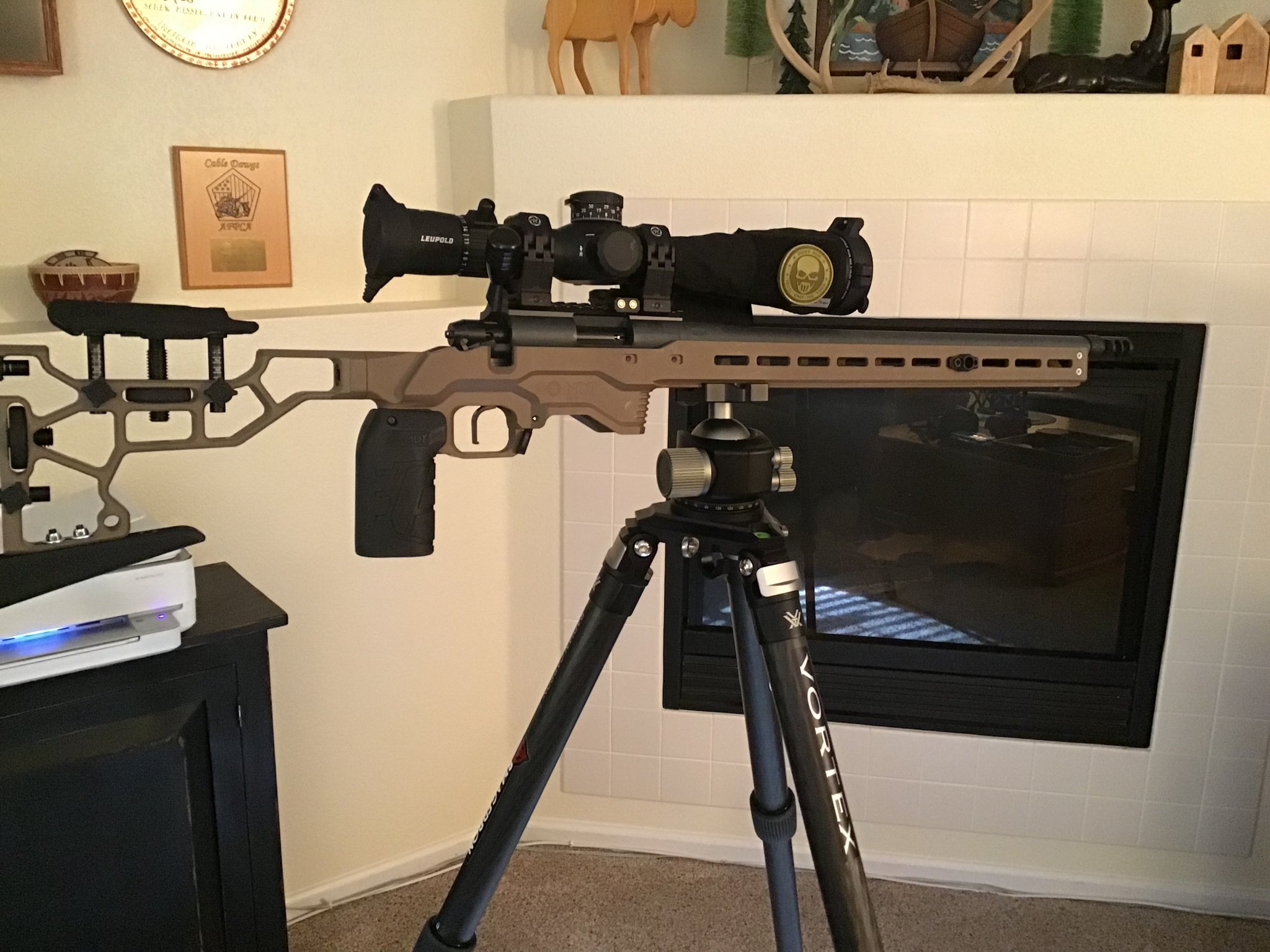

6gunner, I’m waiting for the gen2 acc to come out in a couple months for my vudoo 22” barreled action. Yours looks like the 20” version but how does that 20” balance? I’m also going to use a mark5 unless leupold comes out with something new this fall/winter. Thinking the 5x25. What rings/height sis you go with? Thanks
Reactions: 6gunner
Bayou, it’s a 20” Kukri profile. I have the weights but I haven’t installed them yet. The gun is rear heavy.
The rings are 1.42” high M10 American Rifle Company rings. I like them high cause I have a big ass Charlie Brown head.
Reactions: Williwaw
Thanks, I will be doing the measurements when I get the glass as I have a peanut noggin lol.
Reactions: 6gunner
