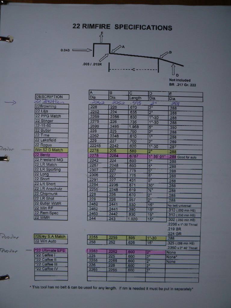

Since rim thickness dictates chamber depth for headspacing, but has nothing to do with the shape of the chamber or the leade angle. I guess they are referring to the chamber depth rather than the chambers design.
Here is a list of common .22 rimfire chambers.
TKH
TKH
I read something somewhere that says Vudoo chambers are cut like the Winchester 52 chamber. However, I cannot remember where I read that.
When I looked at the chart that you provided and compared that to Vudoo's statement about the bullet just touching the lands, that makes sense.
