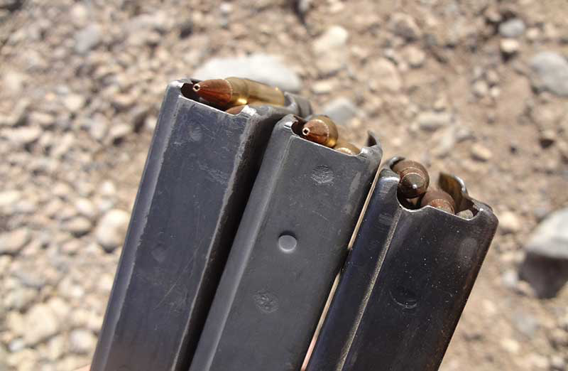

Did anyone see the new for '23 magazines on FaceBook?
Do they remind you of anything?
5,10, and 15 round

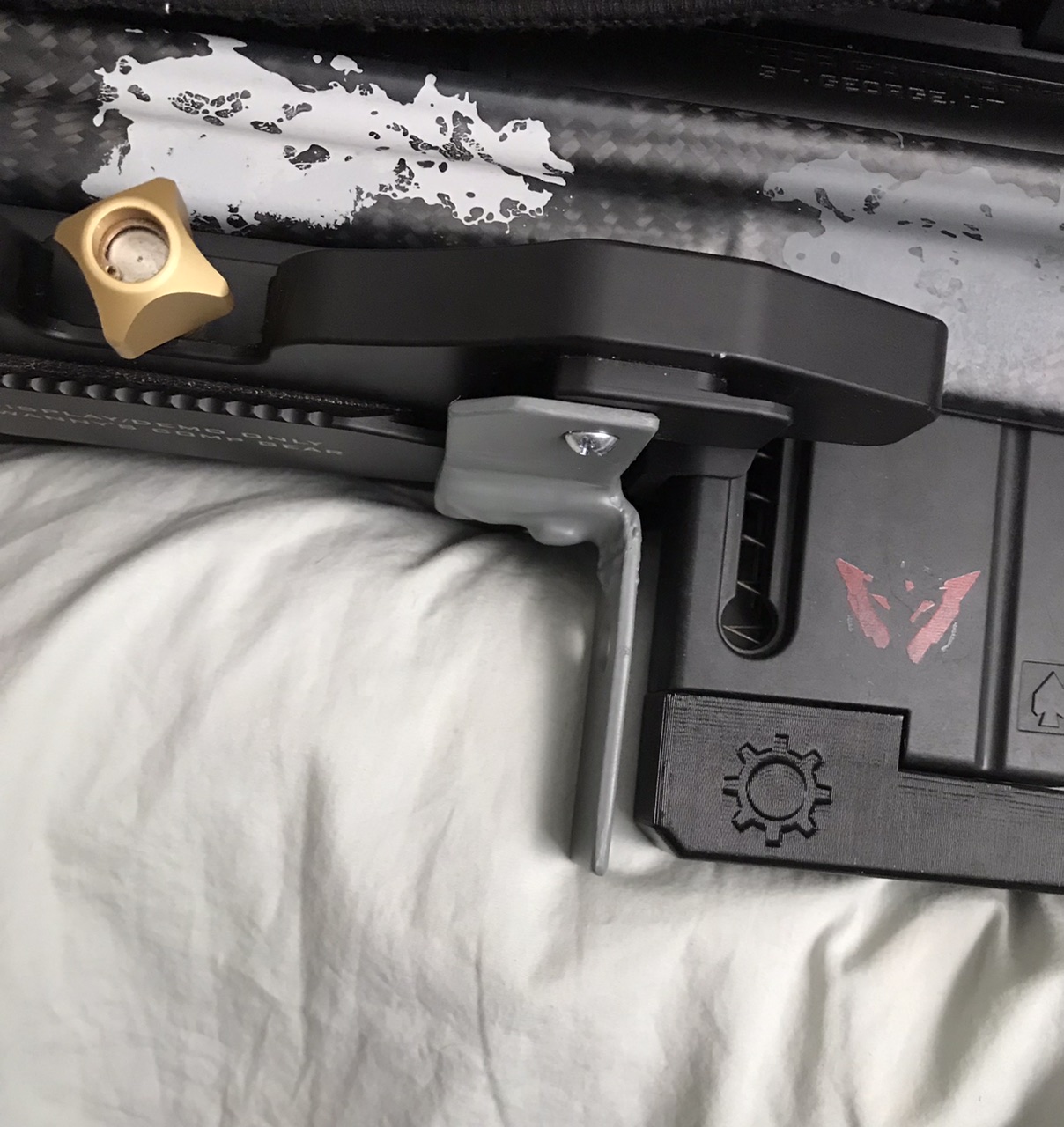

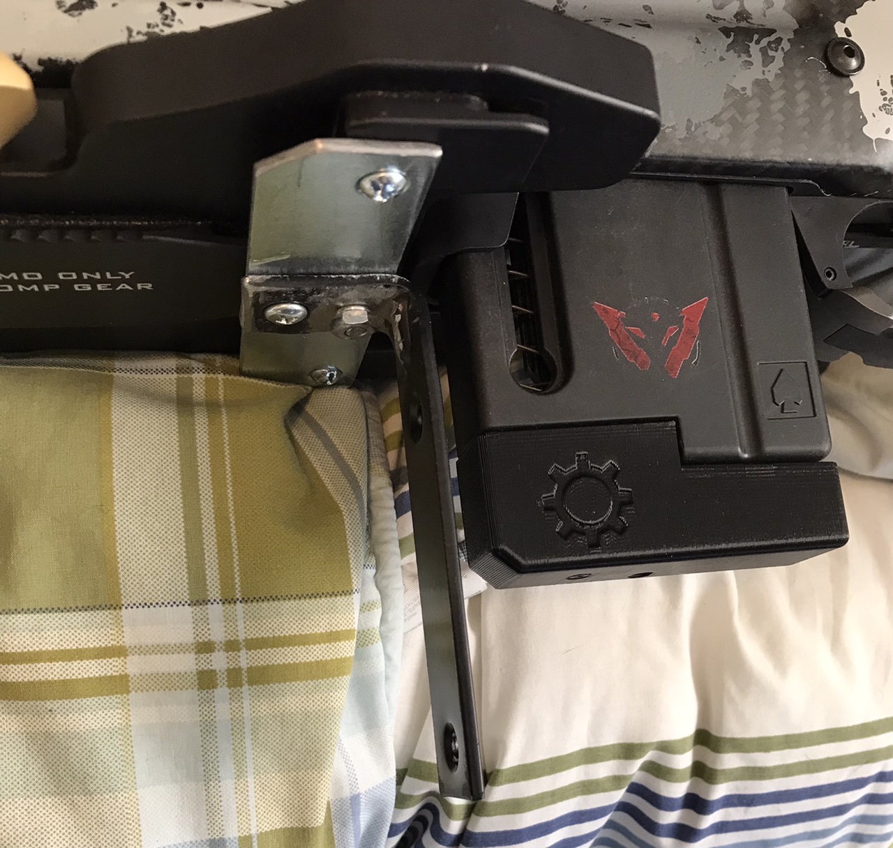

I made my own mag protector on my plate. This is mid production.
And this is done. Cost about $7 with two pieces from Lowes and some screws, JB weld and paint. Not pretty but works.

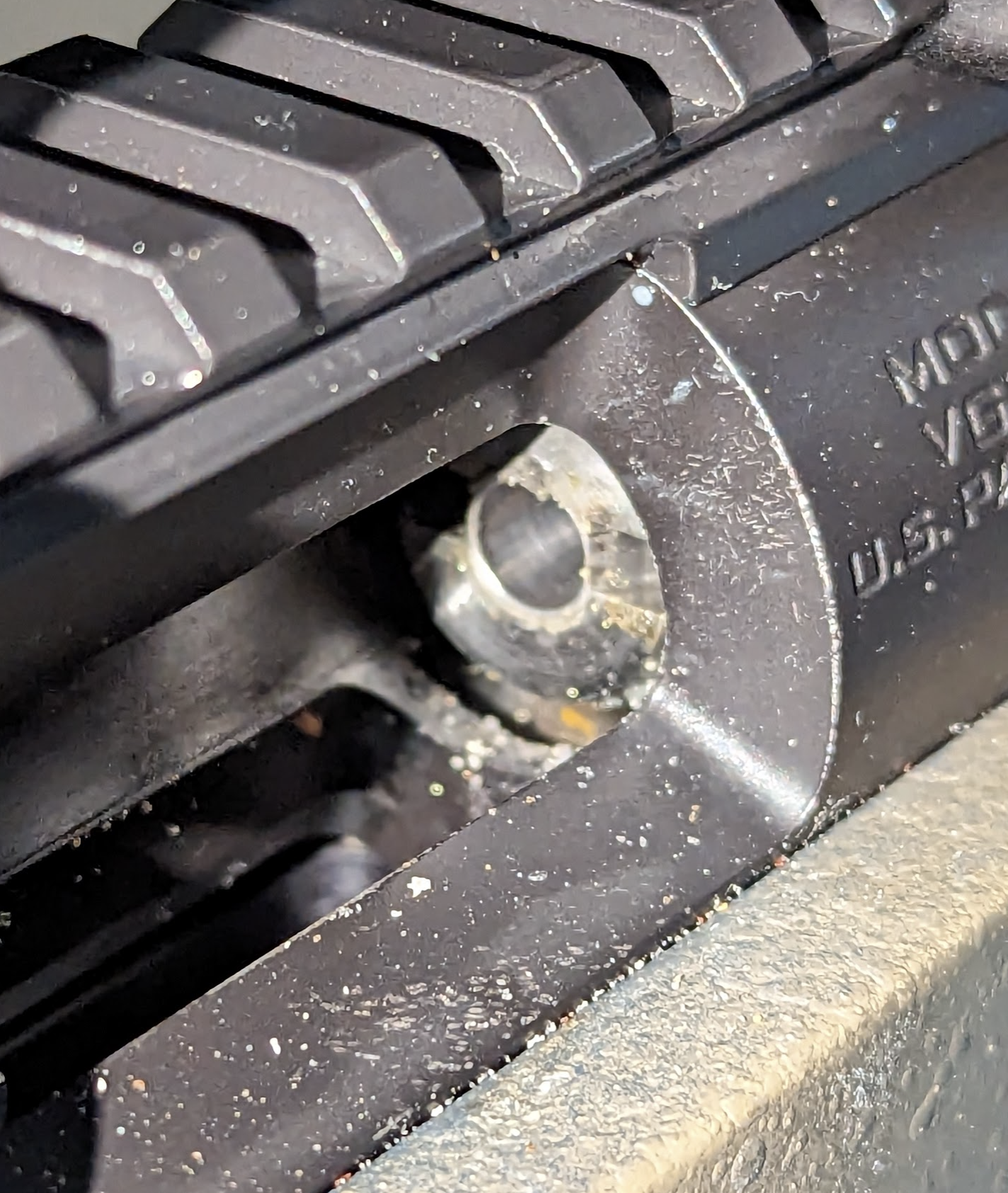

I had a piece of velcro on my mags to keep it rock solid and then found out that the little piece of velcro was causing some wax/lead to slightly shave everytime it went into the chamber. I removed the velcro, and now it's pristine. I've been shaving wax/lead for the past 6 months... maybe that's why my groups weren't as superb as possible.
Here's my breach face now after 350 rounds of Eley and Lapua -
Notice zero lower lip on the breach face of wax/lead build up. To get this done, basically I had the mag pushed up all the way, adjustable mag latch, and didn't do any sort of velcro fore or aft. For my XLR it has an adjustable mag latch. For the Hawkins M5 DBM on my McMillan it has the extended latch.
I only noticed this because I got a new McMillan/Hawkins combo from Vudoo and was like why is my breach face so clean, my XLR always has this slight build up...
