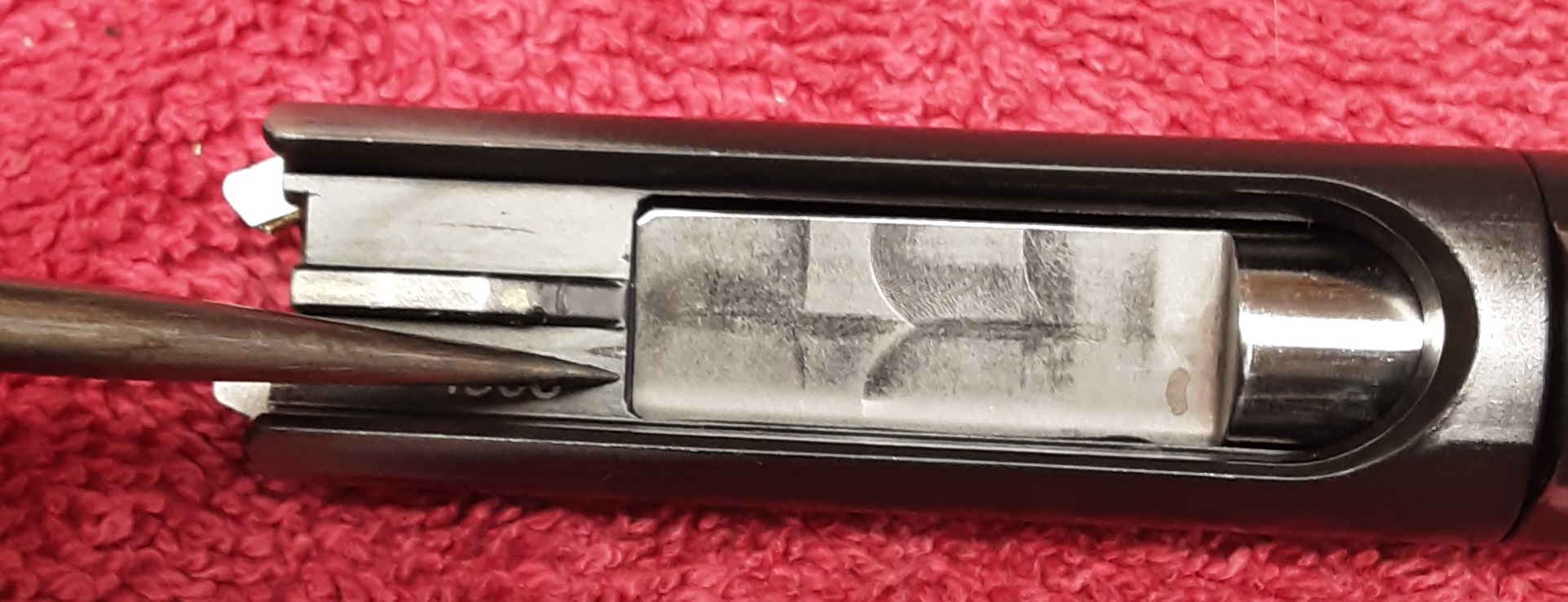

I'll try to keep this to a short book length. I have a gen 2 Vudoo for about 3 years now and approximately 10k rounds thru. I decided to disassemble the bolt for proactive cleaning. Did not take a picture of firing pin set, didn't think I needed to I just followed Vudoo's YouTube video.
After reassembly according to video, rifle would not fire period.
Upon searching this forum I see there is a little more to setting the stroke of the FP than the video described. But I don't see a set method for this.
Right now I am getting approximately 5 light strikes per 100. Before the cleaning light strikes were NEVER an occurrence with this rifle.
Currently the FP is adjusted so that in the tripped condition the shoulder of the pin just meets the shoulder of the pocket in the nose housing.
Is there a definitive way to set the FP stroke? Some measurement/spacing that will get reliable ignition back.
Called Vudoo on Monday and talked to Greg Roman and we verified that I was setting the stroke of the firing pin correctly. Since I was still experiencing some light strikes (appx 6 out of 100) he speculated the firing pin spring had fatigued slightly and a couple of other details prompted him to send me all the internals for the bolt.

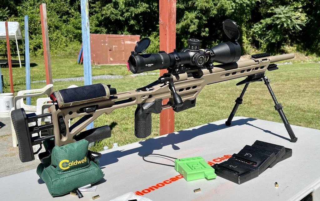

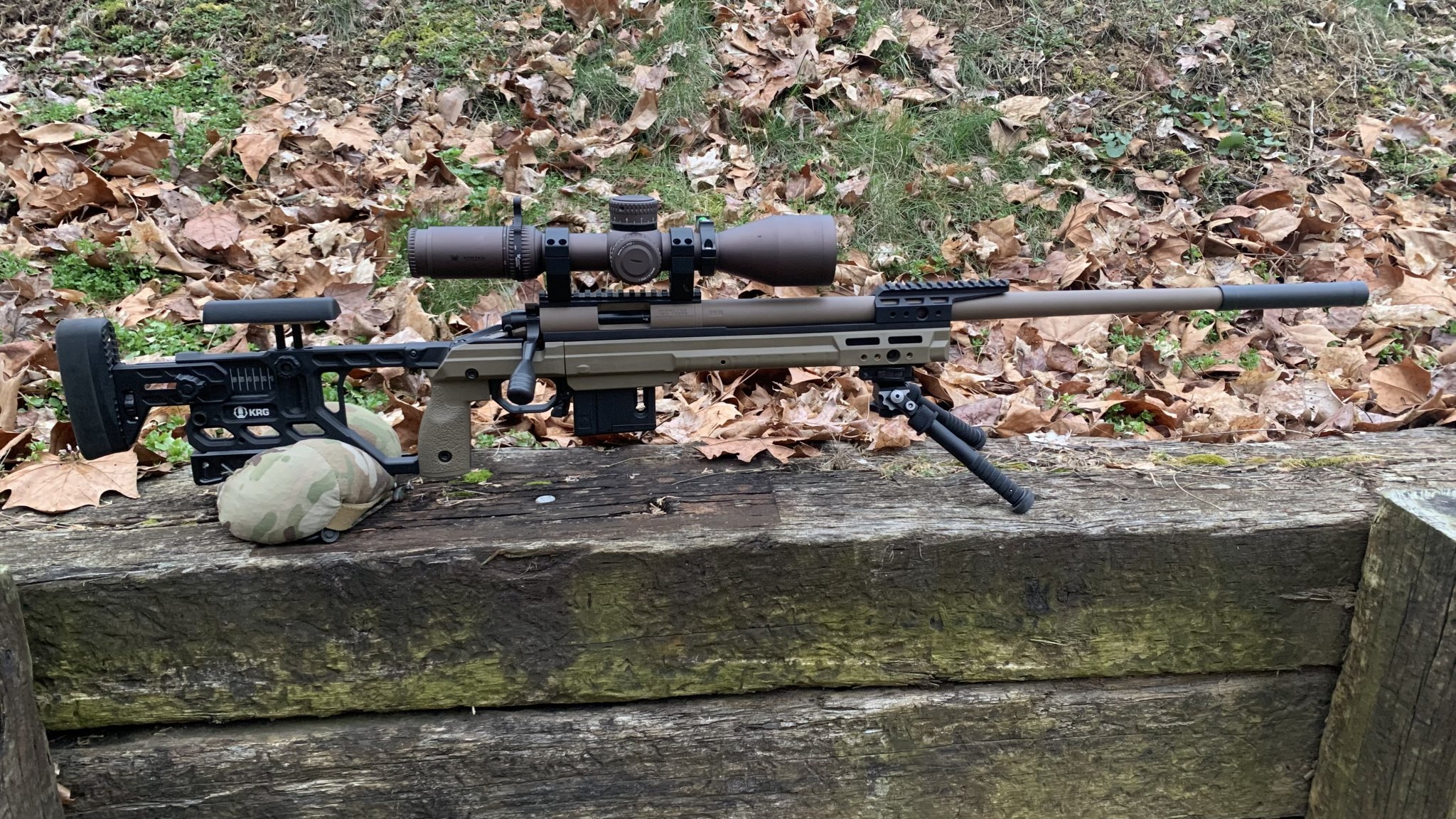

Vudoo 360 with 22" MTU barrel and 60 MOA rail
TriggerTech Single-Stage trigger set to 14 ounces for now. I may go lighter.
Extra large bolt handle knob
Sig rimfire suppressor
KRG W-3 chassis with NV bridge
Atlas PRS bipod
Vortex Razr 4.5-27X scope

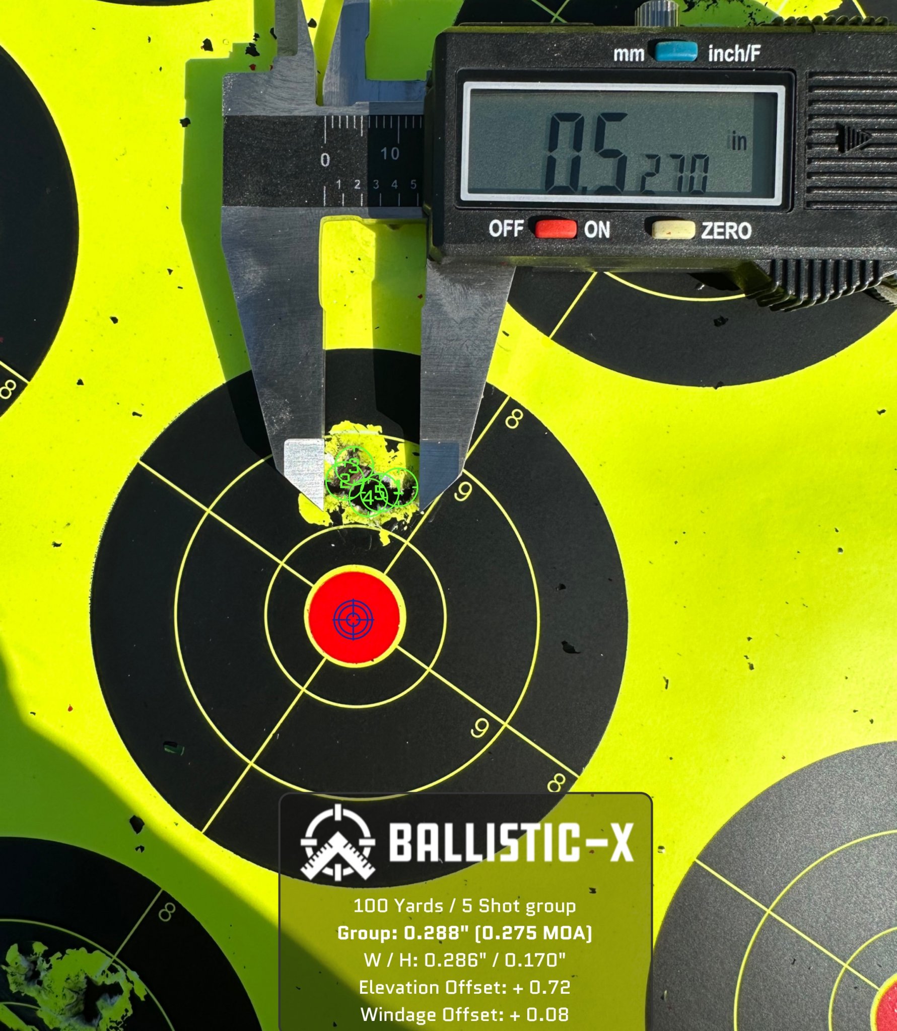

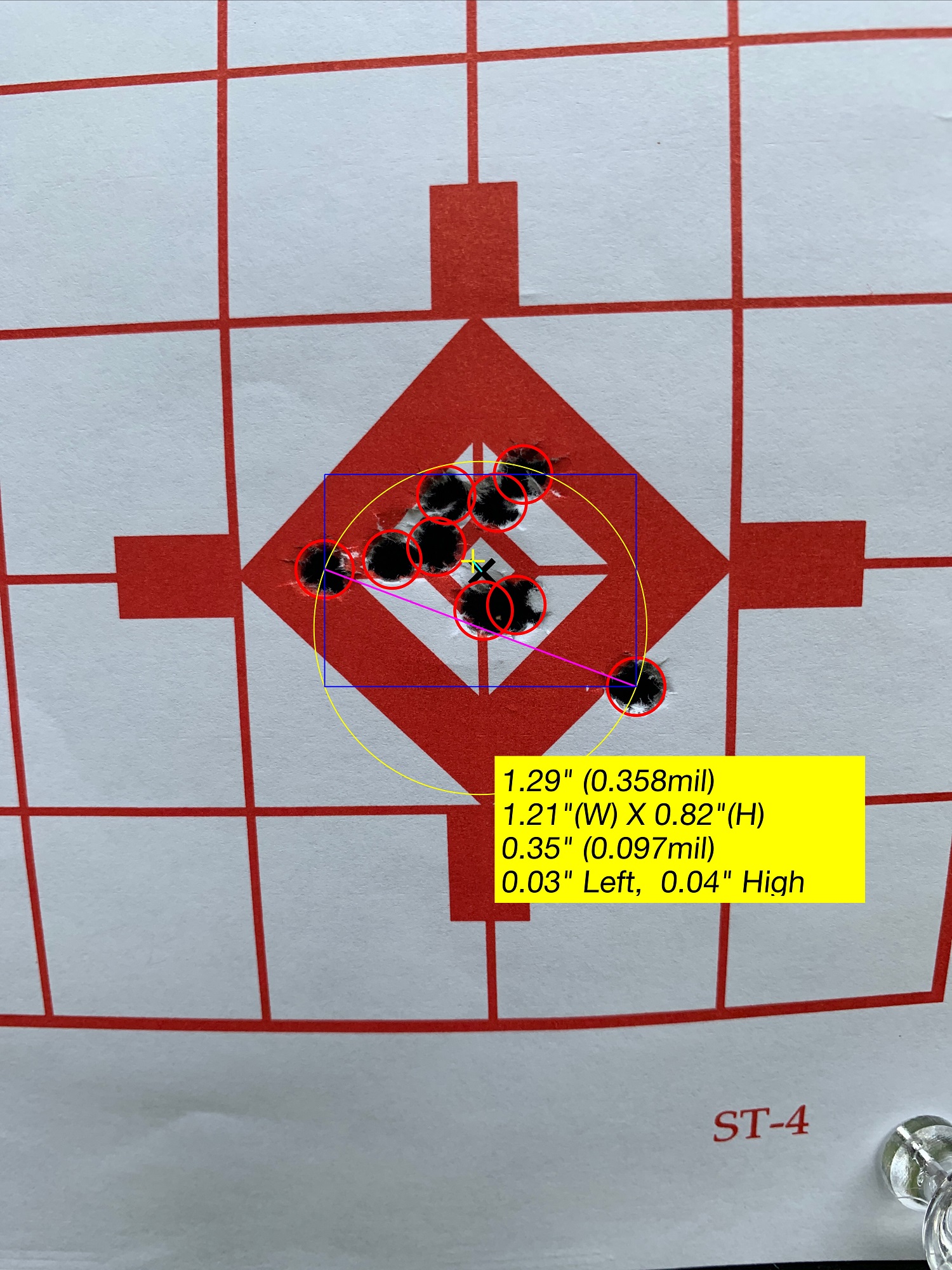

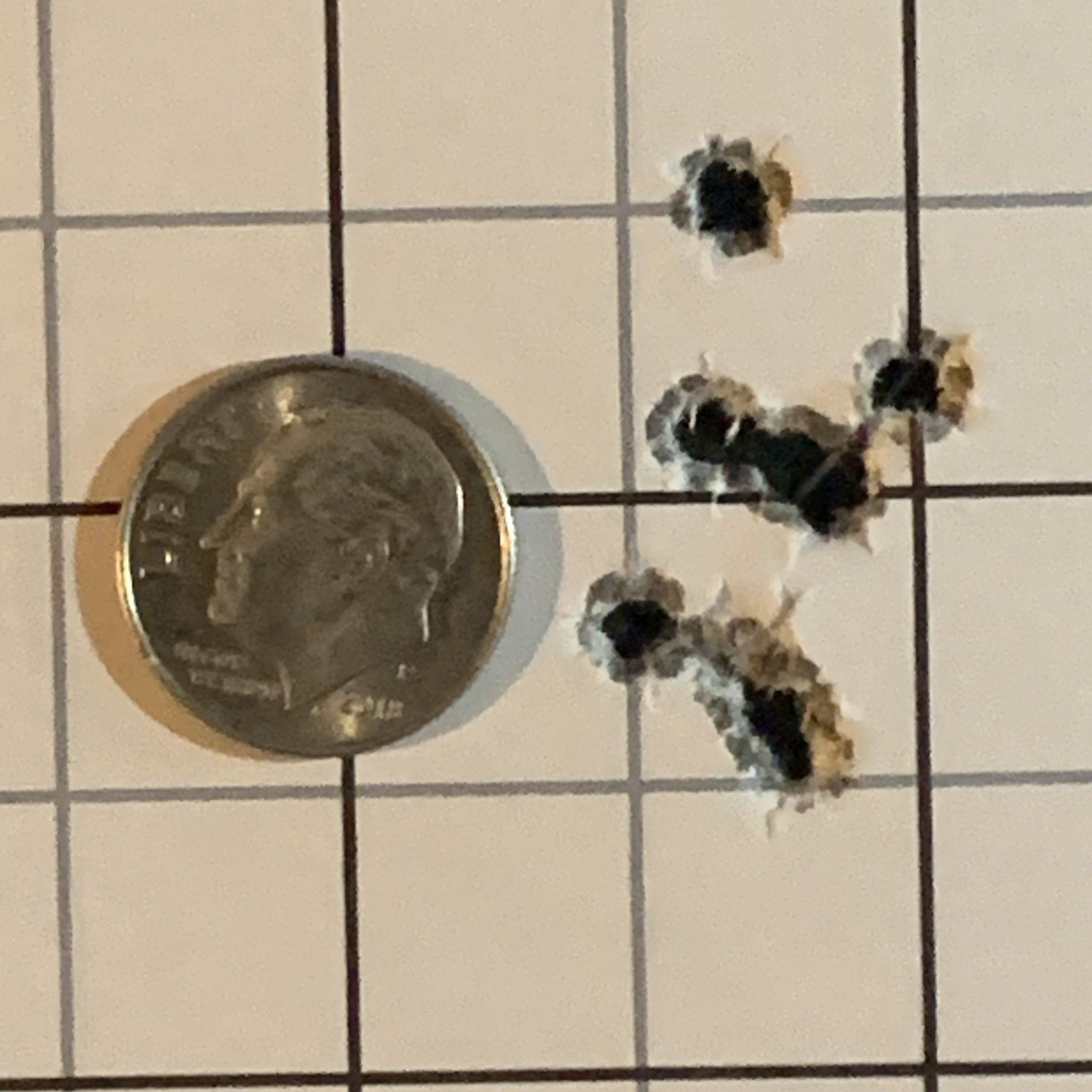

The groups shown below were benched and prone at 50 yards. I'm a little disappointed in the groups size although it's not unexpected. The ammunition used was the Norma (RWS) match target brand. I get great results with that round out of my Anschutz.
For today that's all I wanted to experiment with. The long range plans are to make reservations with the Lapua testing facility and hopefully get some really good ammunition from them.
When I determined that those were the best groups that I was going to get it was time to have some fun.

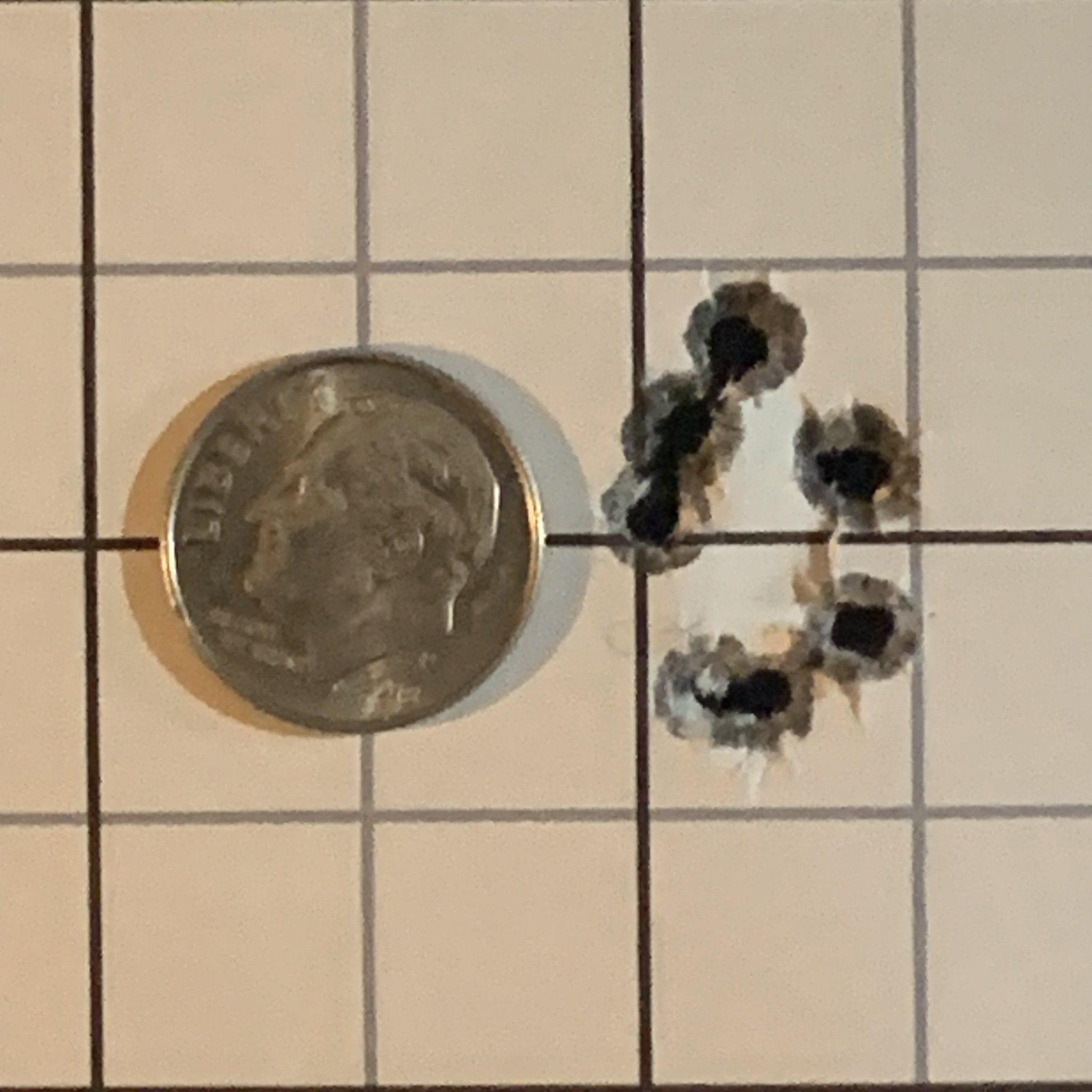

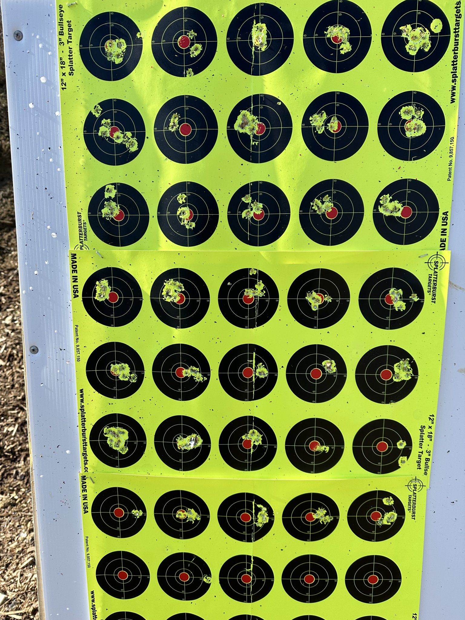

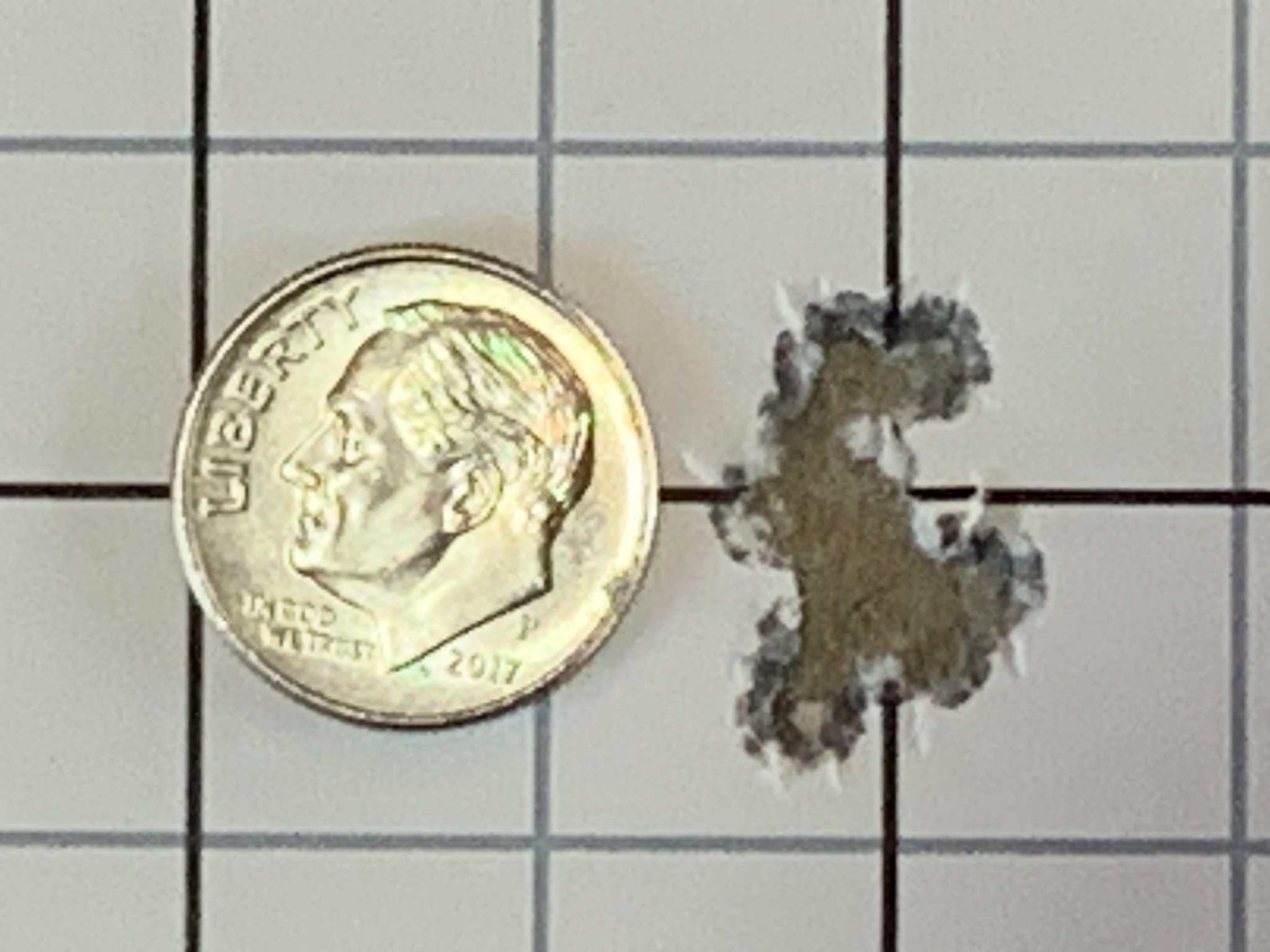

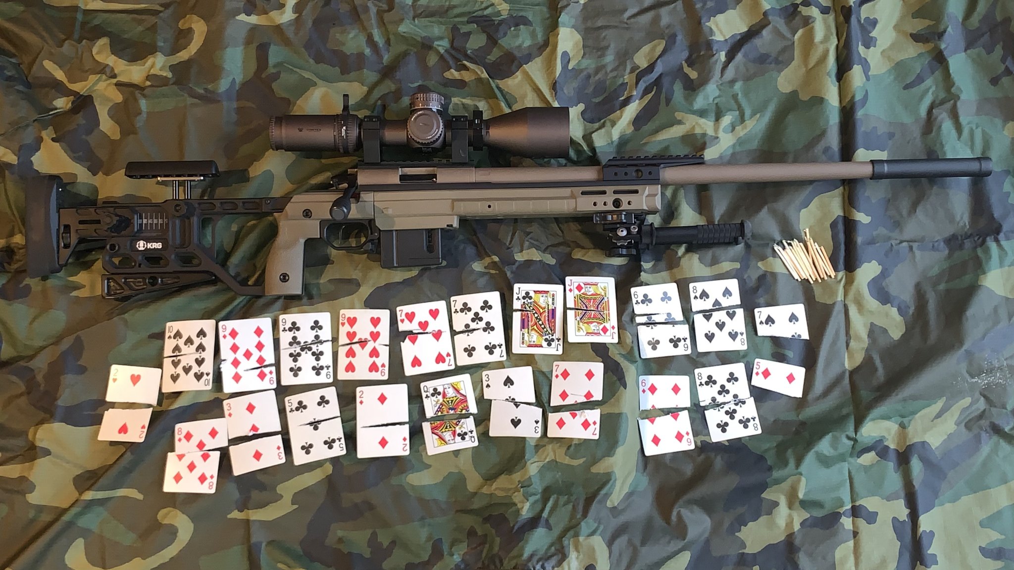

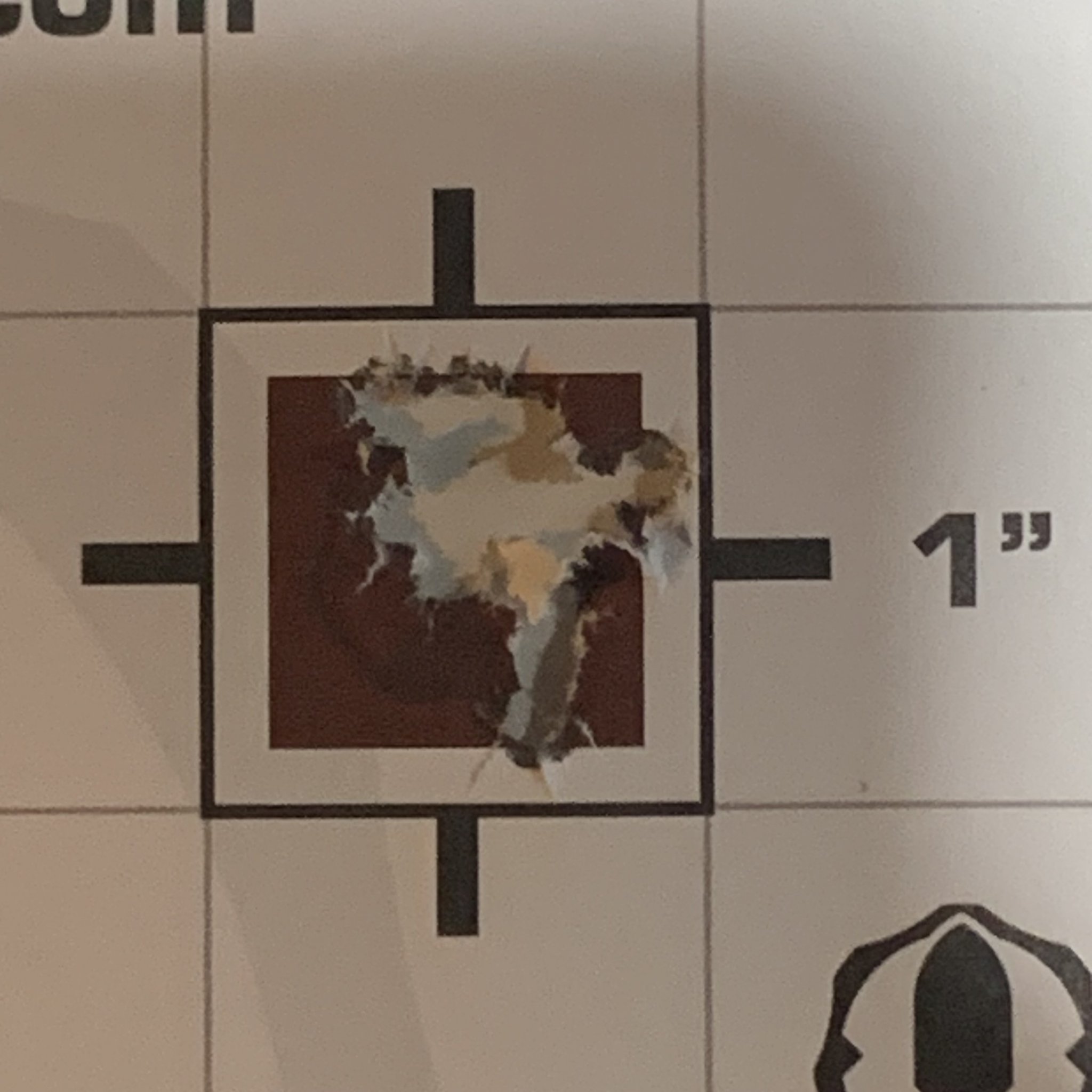

In keeping with the aim-small-shoot-small philosophy I decided to shoot some match sticks and split playing cards at 50 yards. I won't lie, there were a lot of times that I didn't strike the target on the first shot.
Not going to lie this is a cherry picked group but I can't get over how awesome this was to shoot a .29" group at 100 yards. I would have been happy with a sub .3" at 50 but my new vudoo did it at 100 with SK Long Range Match. The other groups of the day were .68"-.87" at 100 with SK LRM and the new Lapua Long Range. The same lot if SK LRM shot .13"-.15" at 50, while the Lapua LR shot .39"-.55" at 50. Needless to say I ordered some more of the SK when I got home from the range
Reactions: Longshot231

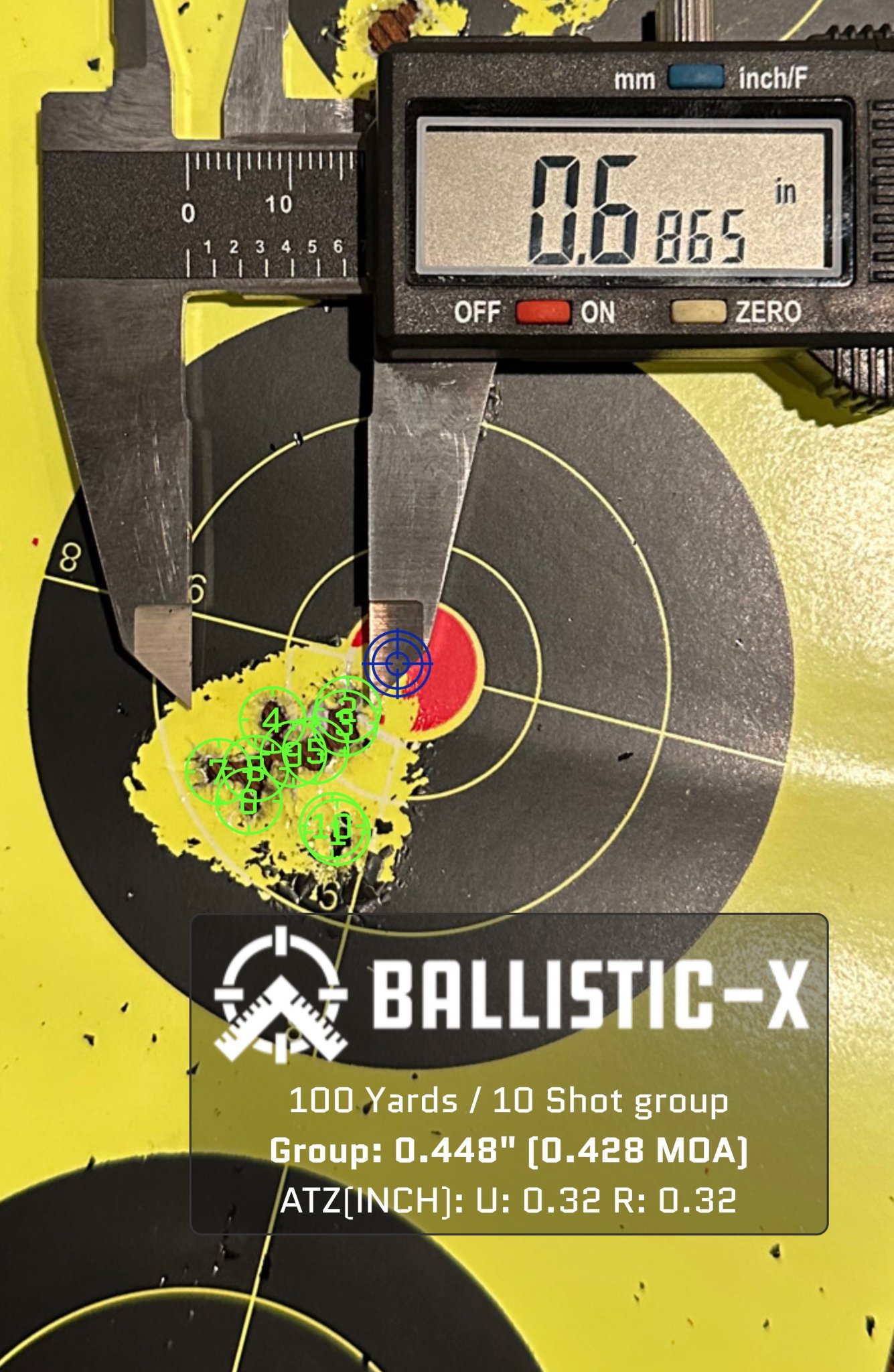

How many shots in that group?

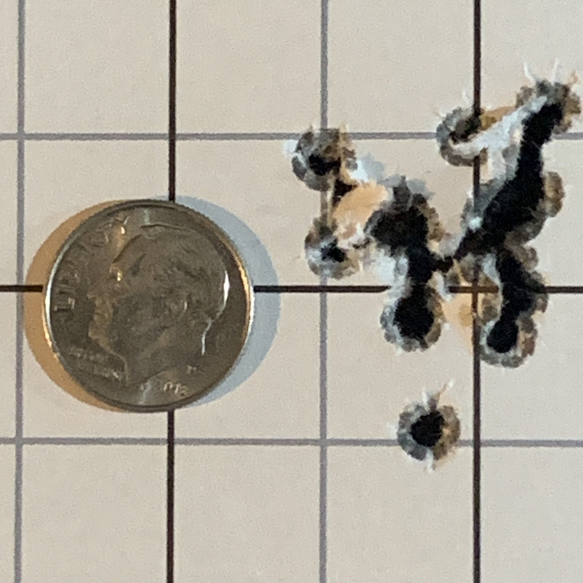

View attachment 8080067View attachment 8080068View attachment 8080069View attachment 8080070View attachment 8080071View attachment 8080072View attachment 8080073
Have you tried it without the can? Obviously better ammo will help the most, but I would test w/o the suppressor also.
No I haven’t but it’s worth considering.
The suppressor is going to have an effect on group size, whether it's negative (most likely) or positive, when you hang something off the muzzle, it's going to have an effect on the harmonics of a barrel. I stopped shooting matches with either of my suppressors on 22RF precision rifles because groups were always a bit larger suppressed.
Your groups with the Norma ammo are what I'd consider typical, based on my experiences with a few different lots of both TAC-22 & Match, on rifles with Krieger, Bartlein, Benchmark, & Shilen barrels. I've yet to change tuner settings with any of the Norma ammo, because it shot larger, more open groups on barrels without tuners, but since it's faster than all the SK & Lapua ammo I have (aside from SK LR Match, which is still a tad slower than Norma), but if I was going to shoot more of the Norma, it would probably pay to experiment with tuning.
Reactions: jbell

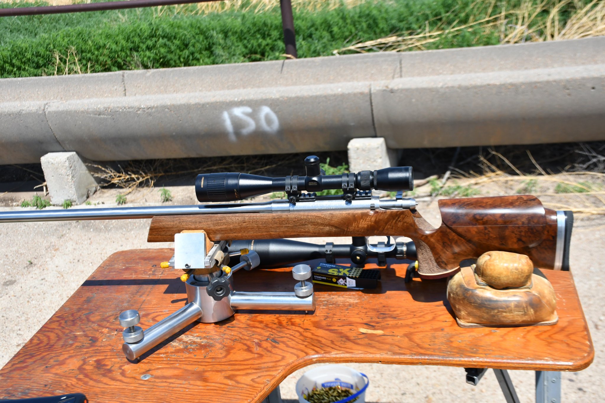

I can totally relate to the ergonomics of shooting benches. The concrete tops of the benches at our club were poured in forms with square, sharp corners, and with concrete mixed with rather coarse sand. I have to put a couple of old bath towels on the rear portion of the bench and/or wear a fairly heavy jacket to protect against 'bench rash' while shooting BR varmint silhouette matches. And the welded metal shooting stools are all different heights, some fairly close to correct, some far too short. Compared to the very nice benches on the 1000yd firing line out at CRC at Byers, Co., which were poured in forms with angled edges and concrete mixed with fine sand and shooting stools with adjustable height...well, there's no comparison. And here at home, I shoot off an old chair out of a local restaurant that's a bit wobbly, behind my homemade portable bench, which isn't nearly as stable as the benches out at CRC (see attached photo). But that's no one's fault but my own - I need to pour a concrete slab with a metal roof for shade, and a good, stable concrete bench, then build myself a comfortable & adjustable shooting stool. The only nice thing about my set up is the home made SS front rest that was one of my first projects after getting a lathe & mill set up in my garage shop - and even that doesn't compare to the extremely nice SEB Neo mini & similar joystick rests available today...

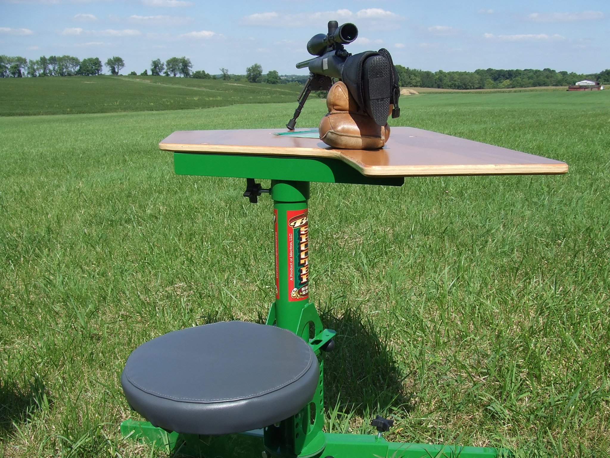

Year's ago I purchased an excellent shooting bench and still have it. IIRC, it was made by a company called "Big Shooter." The bench is a lot to take to the field. It breaks down into three pieces and three separate storage bags. It was built for right handed shooting but I could have assembled it so that the top would be flipped over for left handed shooters.
Anyway, everything about it could be adjusted for the person shooting. It also had legs that you could level the bench on uneven terrain. I would put a circular bubble level in the middle of the table to get the entire assembly level.
Big Shooter seems to be out of business now. However, this company looks like it has a similar product except that I don't think you could level it with adjusting the legs.
I wouldn't sell my bench for anything but there's no room to set it up at the club where I shoot.
https://www.doashootingbench.com/

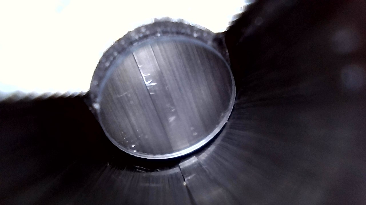

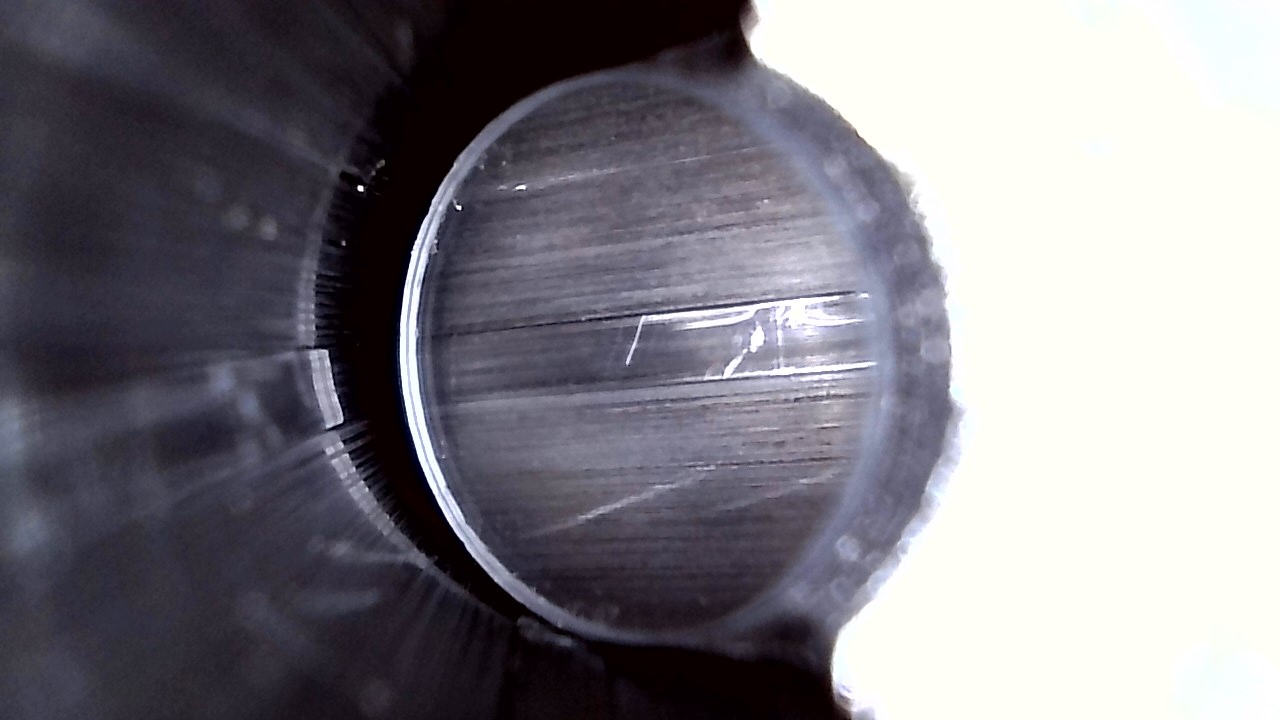

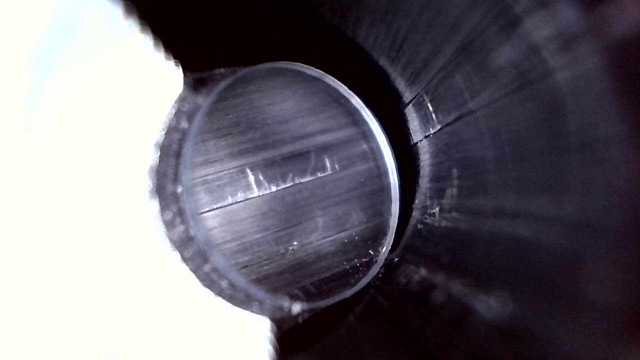

Hey everyone. I'm a relatively new long gun shooter and need your help. Have put around 700 rounds through my 360. It was cleaned about every 200 rounds. It's a 22 MTU in an MDT ACC chassis. I wasn't really happy with the performance as my best was a .45 inch group at 50yds. At 100 yards it would really open up with my best at 1.3 inches. I was using Eley match, Sk rifle match and SK long range match. Using my brother's CZ 457 pro varmint, his best was .47 inches at 50 and at 100 he would stay just under 1 inch. We swapped guns and pretty much the same results.
Something didn't feel right and ended up scoping the barrel. I see a bunch of marks within the 1st 4 inches of the breech. This is my first time scoping a barrel so I'm not sure what I'm looking at but those marks just don't seem right. I don't see those marks in the rest of the barrel. I use a bortech 22RF rod with bore guide and just don't understand if I caused this or not. Is it time for a new barrel?
JeffView attachment 8080941View attachment 8080943View attachment 8080944View attachment 8080945
I have not scoped many barrels so I'm far from an expert but those don't seem right. Honestly I would call Vudoo and send them the pics to see what they say. I've heard their support is good, so it's worth a shot.
I have done extensive testing on 2 of my personal vudoos and both show a 25% accuracy improvement without the can...ymmv
E-mail Vudoo with the photos. I was really impressed with their customer service during the ordering process for my rifle. So you might get a good response and resolution from them.

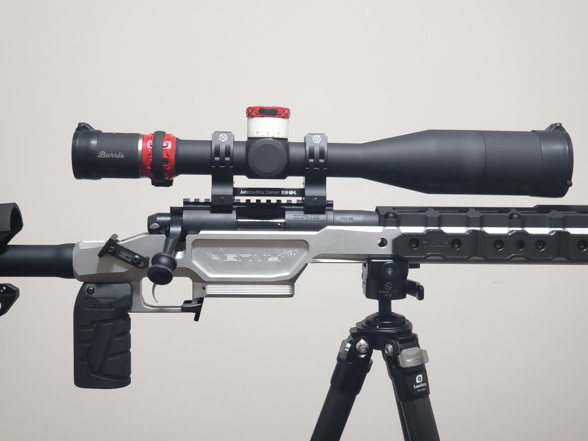

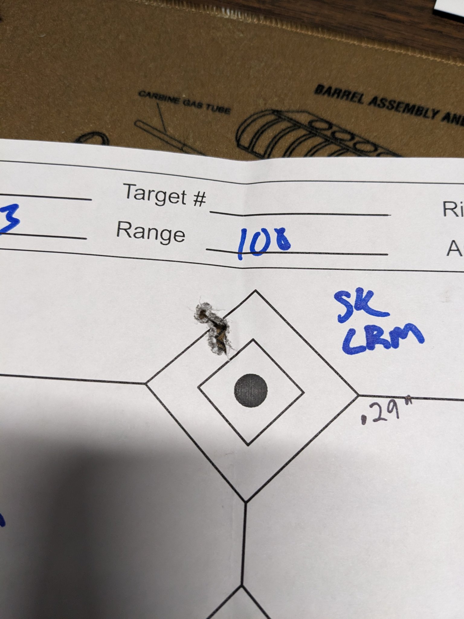

Had my Vudoo for 6 weeks or so and have only run SK Long Range Match & CCI Standard velocity through it thus far. People don’t believe me when I tell them I’m easily agg’ing 1MOA at 100yds - through wind, rain, and snow. Couldn’t be more impressed with how well this thing shoots. Barrel has less than 1k rounds on it. Has an appointment on the books with the Lapua testing center in a couple months… Will be interesting to see if they can match an ammo to tighten things up.
You have the most accurate color, doesn't surprise me at all. I ran a box of CCI-SV through mine, first mag was fine, after that it started getting hard bolt closes on almost every round...that was enough CCI for mine...I'll stick with SK or Lapua.
Sharp looking rig!
I’m about ~400rds of the CCI and so far it holds a decent group…but not enough to have fun printing at 100. (~1.75-2”). Have relegated that ammo for steel plinking.

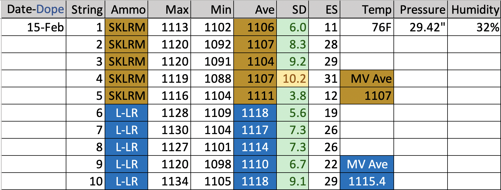

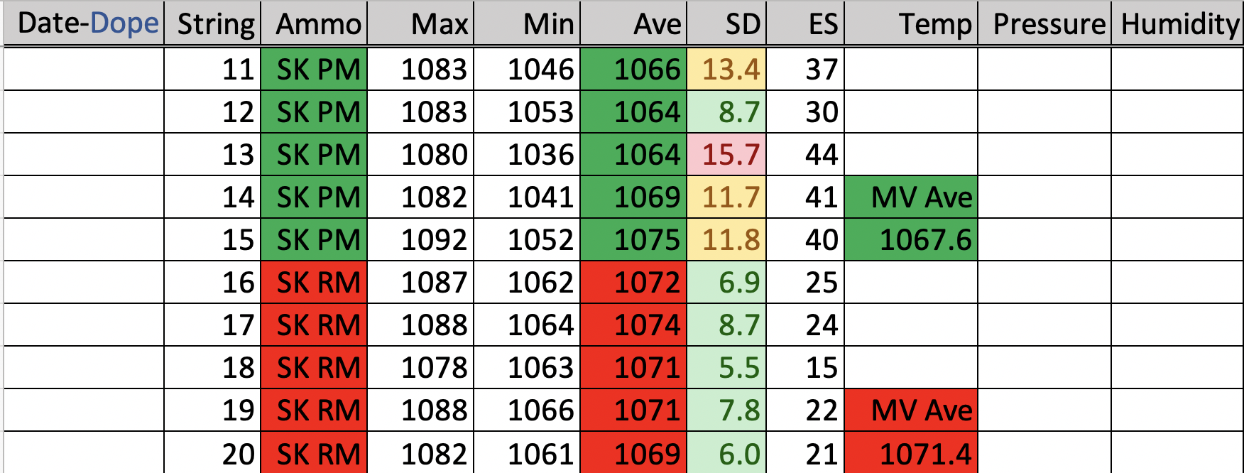

SKLRM is pretty good ammo. I use mostly SKRM and SKPM in mine, but I did grab a couple bricks of the new Lapua Long Range. I've only put one box of that through mine so far, mostly wanted to see what kind of numbers it would put over the Chrono, and it's a little better than SKLRM...is it $5/box better? Not really, but again, I've only run one box so far.
Reactions: Dusty Heaters
The SK long range match and the Lapua long range averaged about the same in my Vudu. I had an exceptional group with the SK of 0.3 at 100 - probably the best group I've ever shot at 100. The Lapua long range definitely was not worth $60 a brick more than the SK for me

I have three bricks of SKRM that are pretty good right now. The first bricks of SKRM were disappointing. I bought a half case of SKPM that is really good, and bought another case of SKPM that is decent, but disappointing compared to the first half case. From the same day as the test data above (SKPM is the second lot):

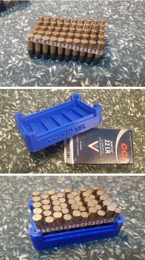

My daughter 3D printed a CCI lifter box for me on her resin printer, not quite as pretty as yours, but it works well.

Per earlier discussions, I went back out to the range and this time took a portable target frame to set up as close to the ground as possible. I shot from the prone position the entire time and got much better groups. Albeit there was still some vertical stringing. That could be me as the bipod kept sliding on the concrete. I will be placing an order for some spiked feet. This is a ten shot group from 50 yards.
View attachment 8083916View attachment 8083917

Have you shot any groups without the can?
Also have a Whiskey-3 on my Vudoo - love it!
Not yet. I’m attached to the suppressor like a baby to his pacifier.
The group in the previous post, 10,161, was shot with the can attached.
I was getting a better shot to hit ratio yesterday with playing cards and matchsticks as targets.
All that was done in a comfortable prone position.
