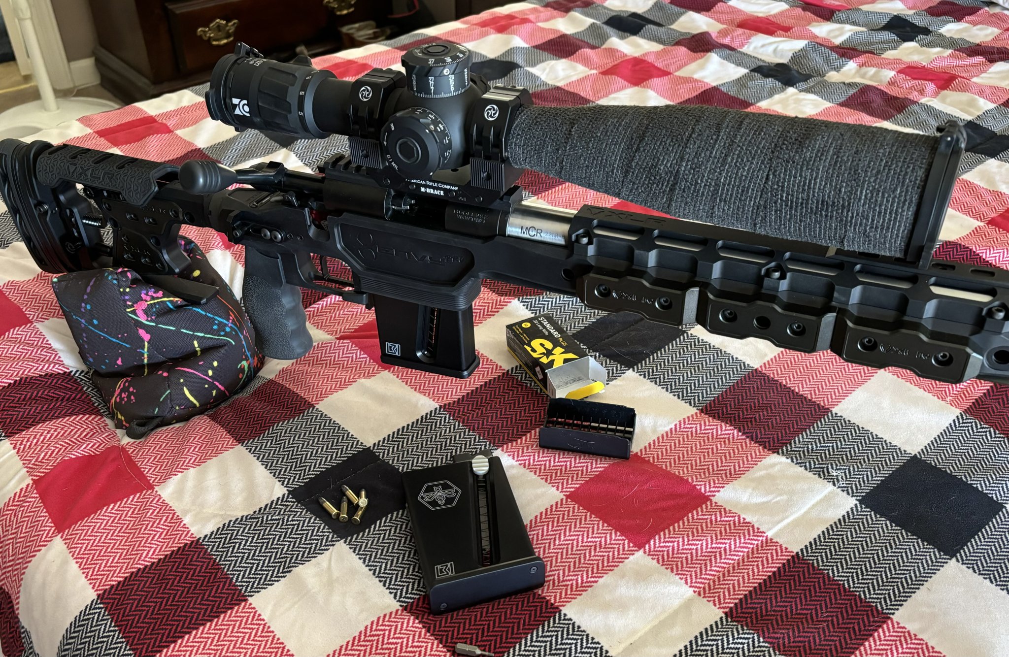

I received my second order and set them up…real simple in an Envy Pro just set them to were they are tight to the bottom of the action and they run flawless and feed straight into the chamber even if I push on the mag.
The only thing I see is is make sure the first round is not nosing down at all…awesome mags!!

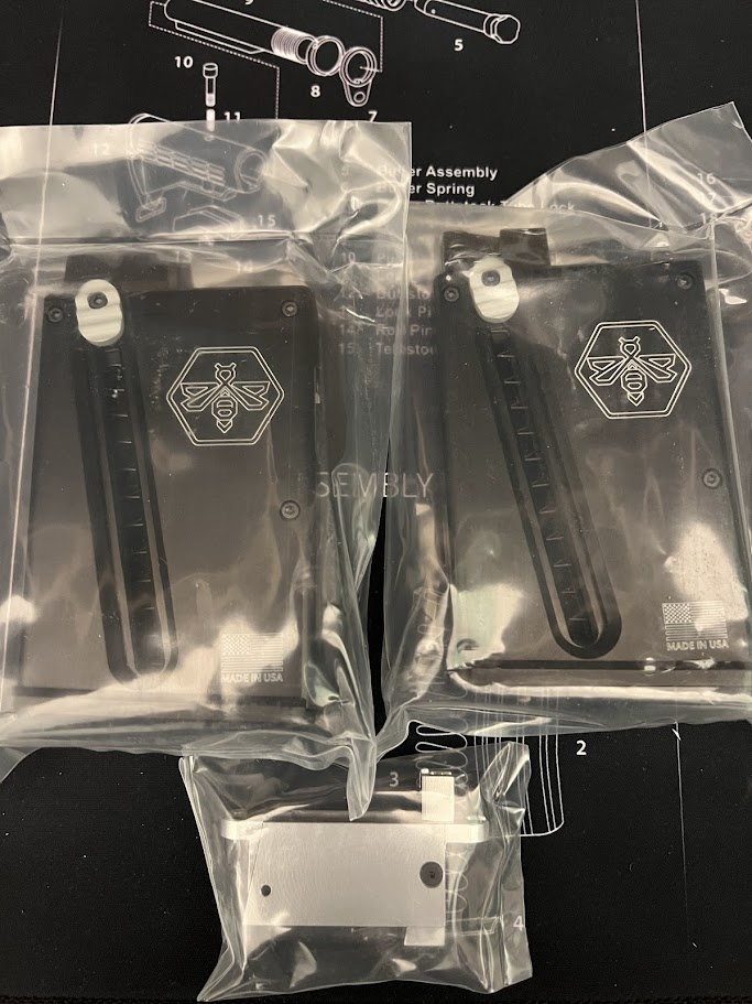

My two L3i Stinger mags showed up yesterday, after getting stuck for a few days in the 'black hole' that the Wichita, Ks. postal hub has turned into. Had an even worse experience with a couple of really nice Unertl scopes that came from a seller in Arizona this past spring - the seller is a stand-up guy, and was on the Scottsdale PO like stink on you-know-what when they didn't show up here. For awhile, it appeared that they'd never left Az., but then we discovered that they were sitting in Wichita, and continued to be hung-up there for another week. I live only 200mi west of Wichita, and am far from the only person who has had issues with that postal hub - our 'local' news comes out of the Wichita TV stations, and there was a story on how screwed-up things are there on the news a few months ago. So when I got my shipping notice last week that originated in Lee's Summit, Mo., I knew that if there was a hold-up, it would come when the package got to Wichita.
Whatever - I wasted no time in getting one of the mags set up to work in my Three-60, which is in a Manners PRS1T with PTG Stealth DBM. I haven't had time to run any rounds out of the mag, but will do so sometime today to check how smoothly they feed and whether I need to raise the mag catch to allow a slight bit of vertical play to avoid dinging the nose of the bullets. I did try the mags in my oldest V22 - a Gen 1 that I've owned since 2017 - that's also in a Manners PRS1T with the same Stealth DBM as the 360 - but it won't latch, and will need to be adjusted to work in that rifle. This could perhaps be because I've got it adjusted to latch up tight in the 360, and if I need to back off how snug I've got it set for, then it might fit fine in the older rifle. Just need time to play with the Stingers...I'm very impressed with the quality and how slick the follower runs.

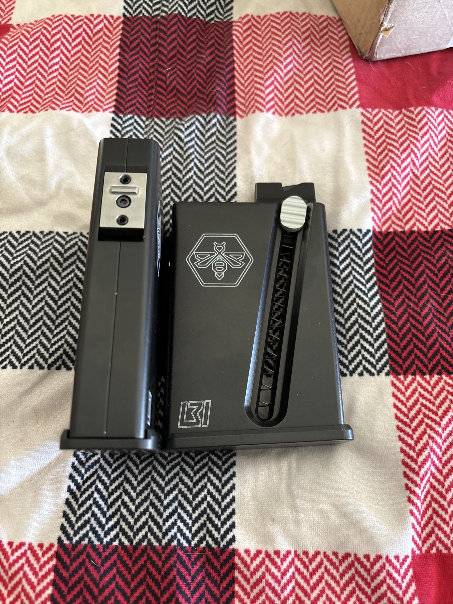

I just got mine yesterday as well. USPS isn't great hear but definitely nothing like what some have experienced.
These mags are super nice and have already started playing with them. I have my 360 in a Manners TCS so no adjustable mag latch. I have noticed what when I get them really snug, the mag release becomes super hard to actuate and drop the mags. I have to rock them around a bit to get them to drop if I get them really snug.
I've since adjusted them so they sit almost exactly like the OE polymer mags and they seems to run great. I've run them with 15 dummy rounds several times with no issues. We'll see how well they work at the range when I get out next.

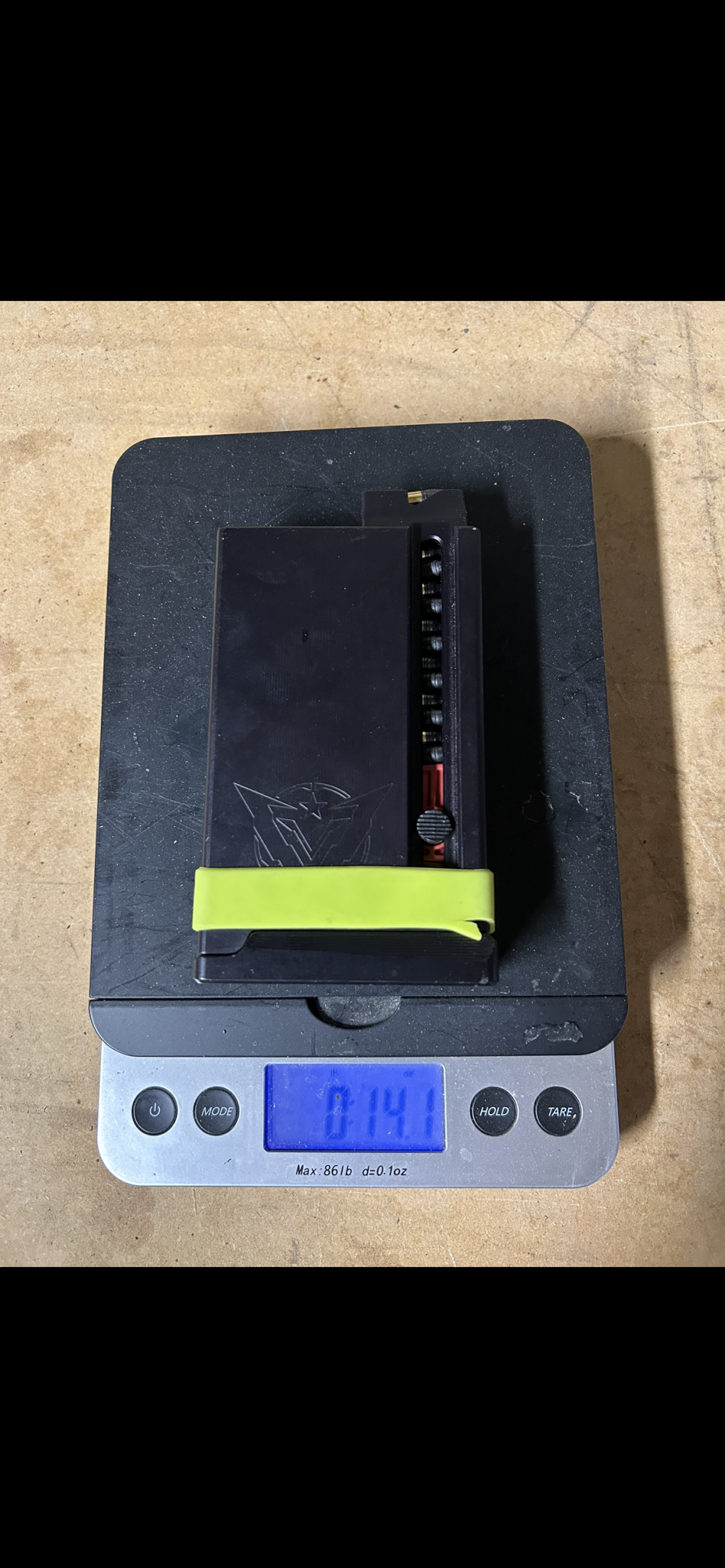

Side note, these are heavy as f*ck. Just over 1 lb not loaded.
It definitely doesn't need to be this heavy, but I can live with it. I also check to see if it changed the balance on my rifle. It shifted the balance point back by like 1/8" which is fine. My main complain is my rifle just jumped a full pound in overall weight. Not a huge deal, but a tad annoying considering I liked where it was at.

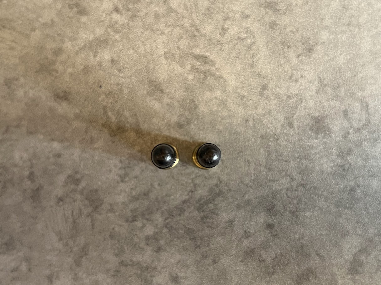

I switched to different ammo yesterday which has a different bullet shape. Again the feel is misleading. I’m smashing the bullet tip even though based on feel it feeds “fine.” You would never know there is an issue if you don’t extract and look. I’ve done all I can adjusting. I’ll revisit the mag again if I ever switch chassis. I’ll stick with the factory plastic mags which work 100%. I just have to take care loading them.

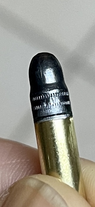

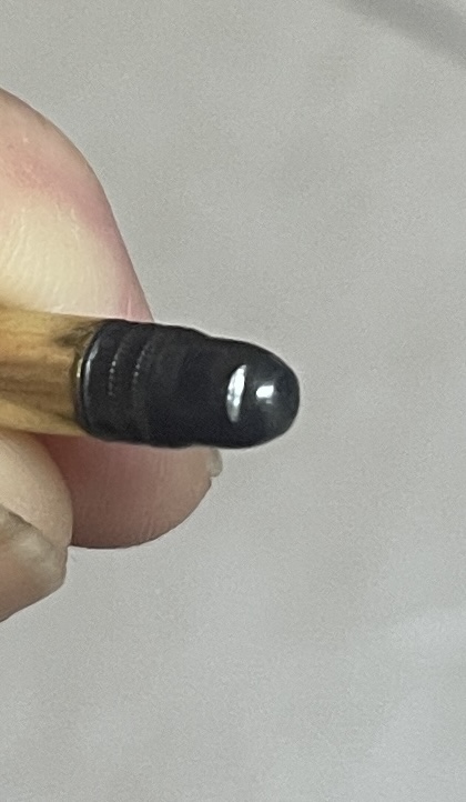

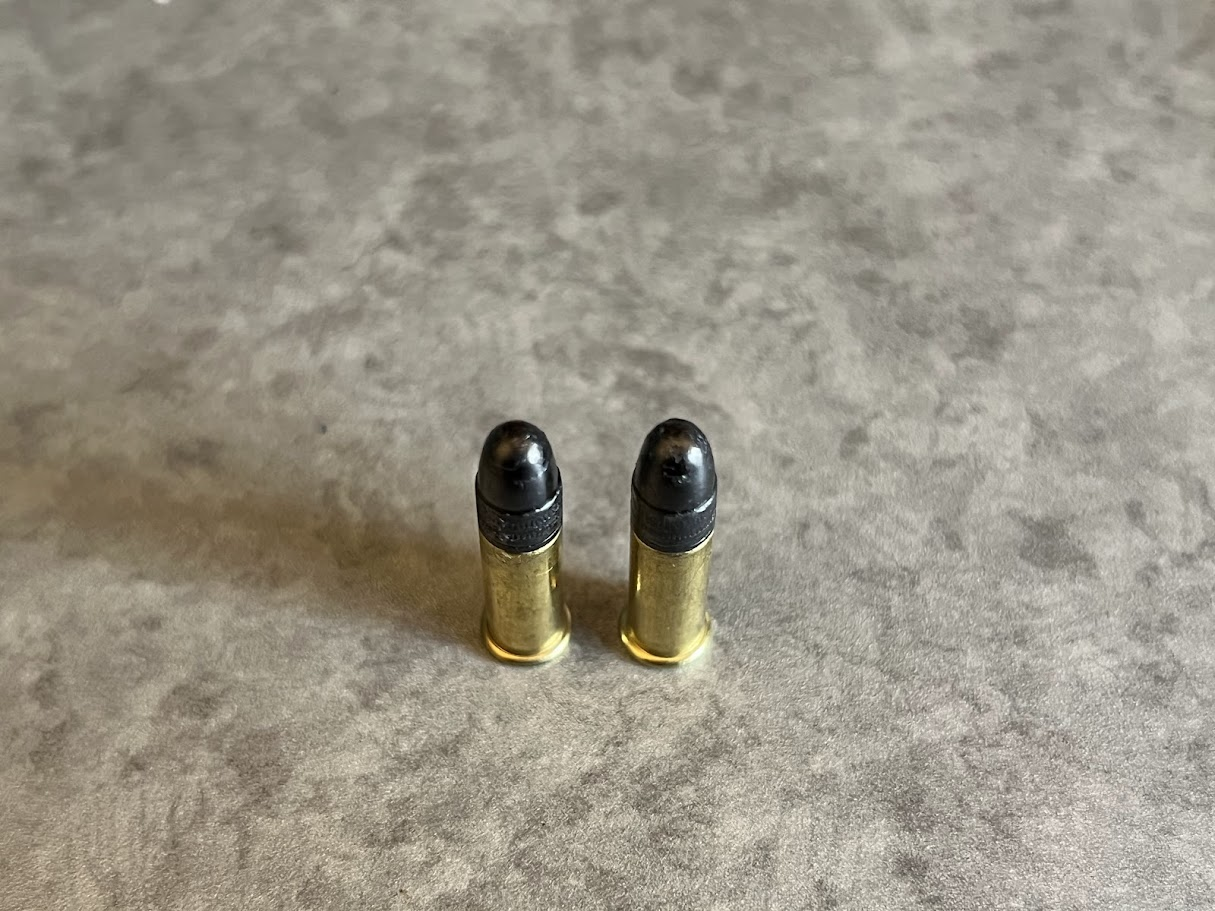

I've had a very different experience so far. I played with the adjustment quite a bit (maybe 20 minutes) the first day trying to get the mags to lock in snuggly. I ended up just setting them up so they seat the same as the OE mags. I saw your post about your bullets getting dinged up so decided to pull my rifle out and tested it today. I've only tested this with SK ammo, but I didn't have any issues with either of my magazines.
The bullet on the right was chambered 3 times and the bullet on the left was never chambered. Aside from the grove marks from the rifling, the bullet looked no different before or after chambering. Sorry the pictures aren't great, but kind of hard to get close details on 22lr. I've had bullet tips get damaged due to poor feeding so I know what to look for. That was mostly in my 10/22, but my Vudoo has done it with the old L3i Elite mags. I have those adjusted really well, but every now and then they don't feed properly.
Anyways, not sure if the different is our setups (V22 360 in Manners TCS w/ Mini Chassis) or the actual magazines, but everyone here should test them out for themselves. I haven't had a chance to really run these heavily or in competition yet as October is super busy both for work and personal life.
If I were to film myself running the bolt in and out and feeding rounds from the mag and post it, I guarantee 100% would comment, “ok what’s the problem?”
Here’s the problem at least with my sample size of one. I have it adjusted the best I can. Any higher up and it won’t even feed. The feed angle is too great. Any lower and it scrapes the 6 oclock part of the band. How it’s adjusted now it’s doing both. Again if I didn’t pay attention I would never known based on feel. Pictures show best sample with the “least” damage.
I did the same and my bullets are fine.
Wow that is really bad. Probably a dumb question, but did you mess with depth adjustment much? I ended up canting mine in at the bottom slightly to get a better release, but wondering if there is any more adjustment there you could mess with.
I’ve done it all. I’ve wasted probably 100+ rounds trying to dial it in. I’m not wasting any more ammo at this point unless I switch stocks. My Curtis conversion uses Vudoo mags so I might mess with that and the Stinger mag.
