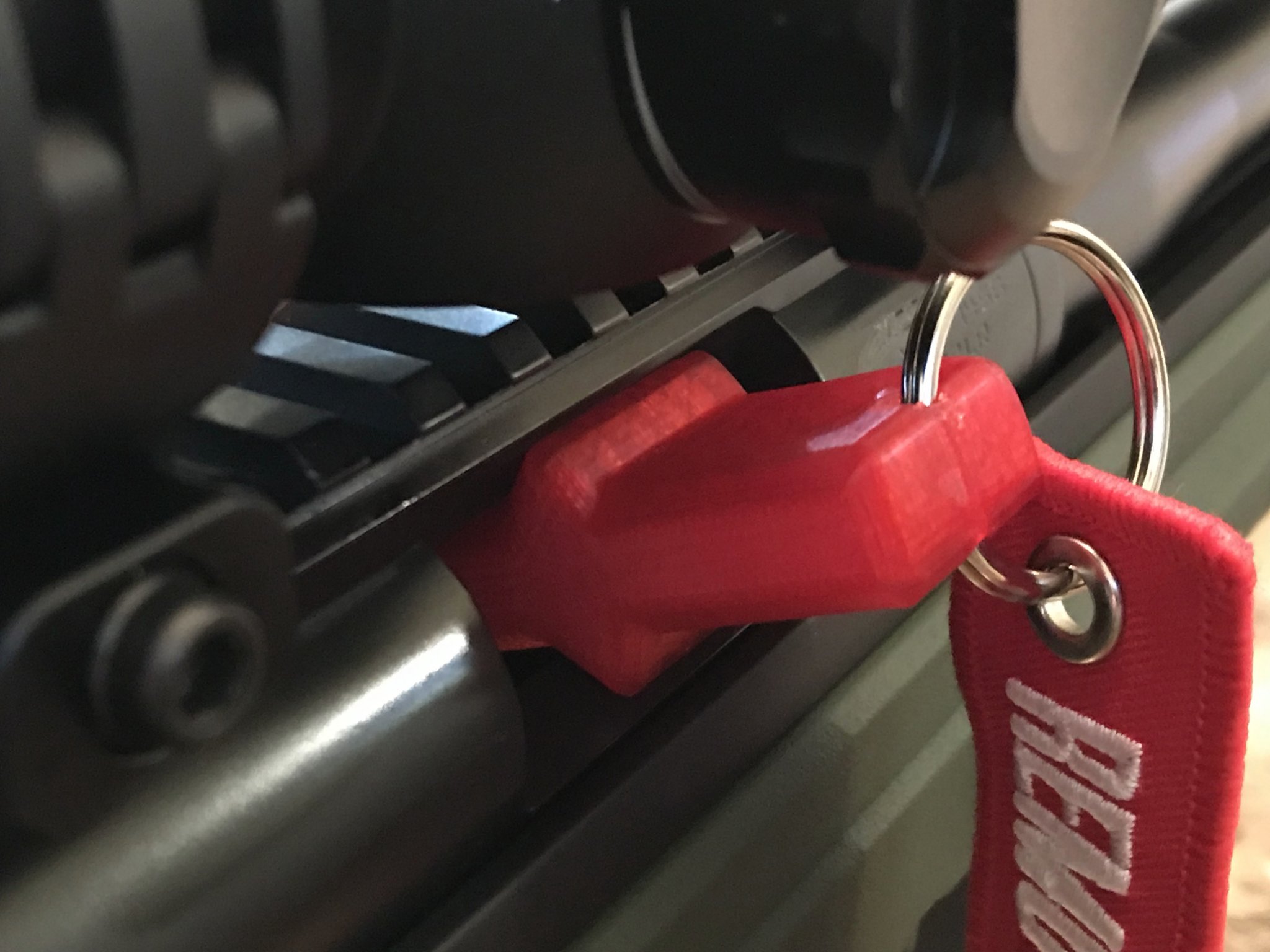

Anyone need stocking stuffers...Vudoo Chamber flag reinvented....
Snaps in will not fall out as you move from firing line to storage.
Keeps magazine from fully seating.
www.yow-tech.com

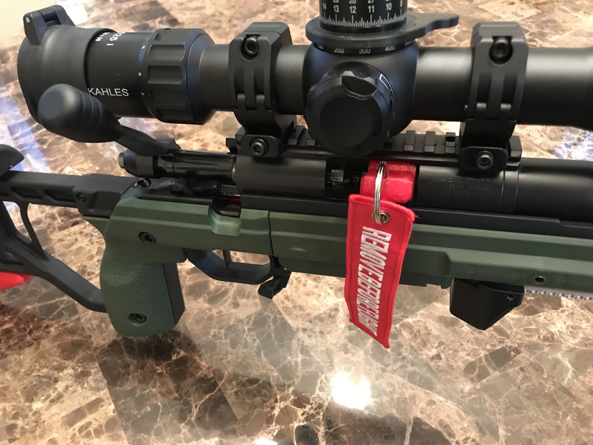

I have one of these and it's incredibly well executed; far better than sticking anything in the chamber. Good job Yowzilla.
