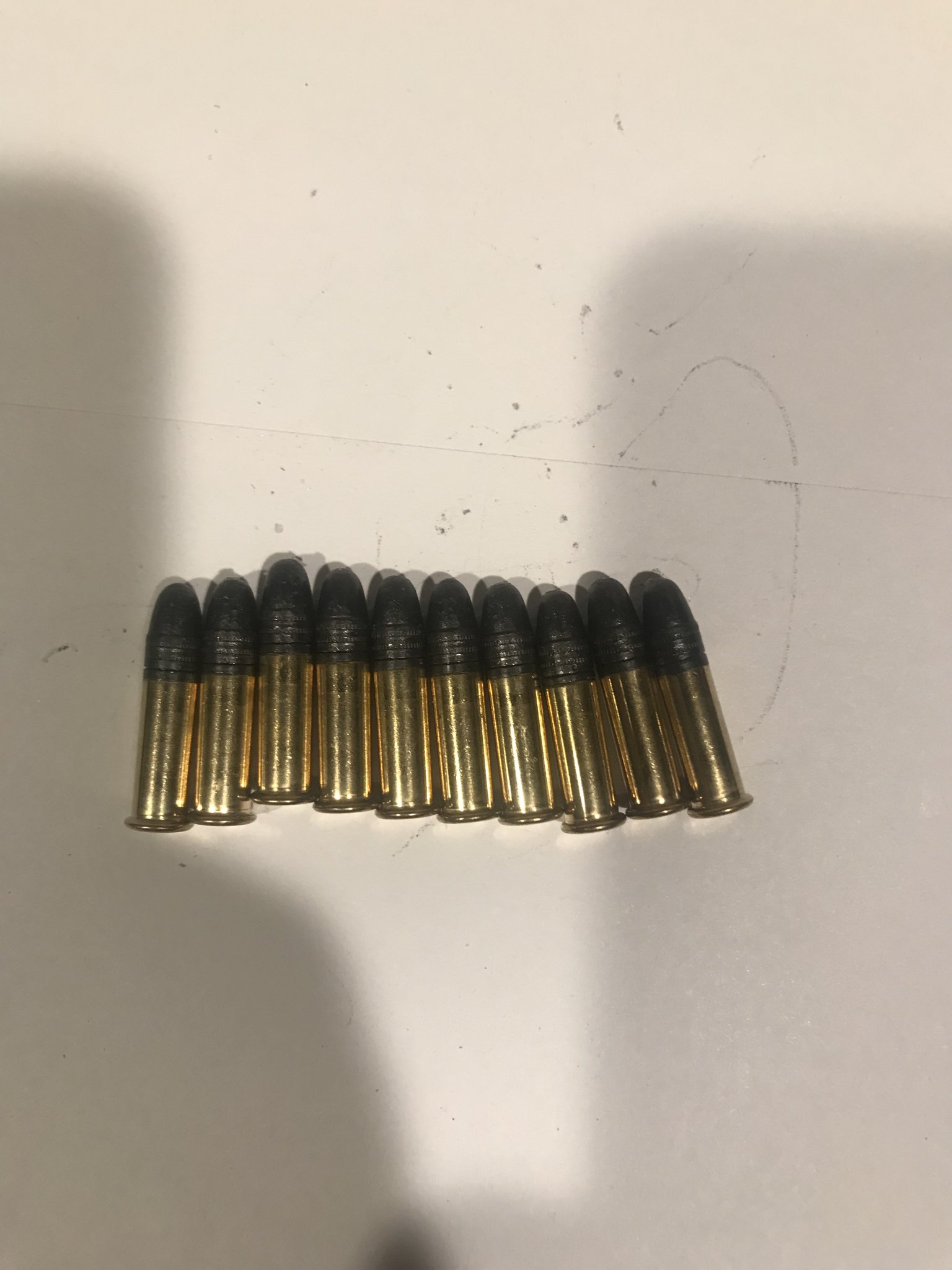

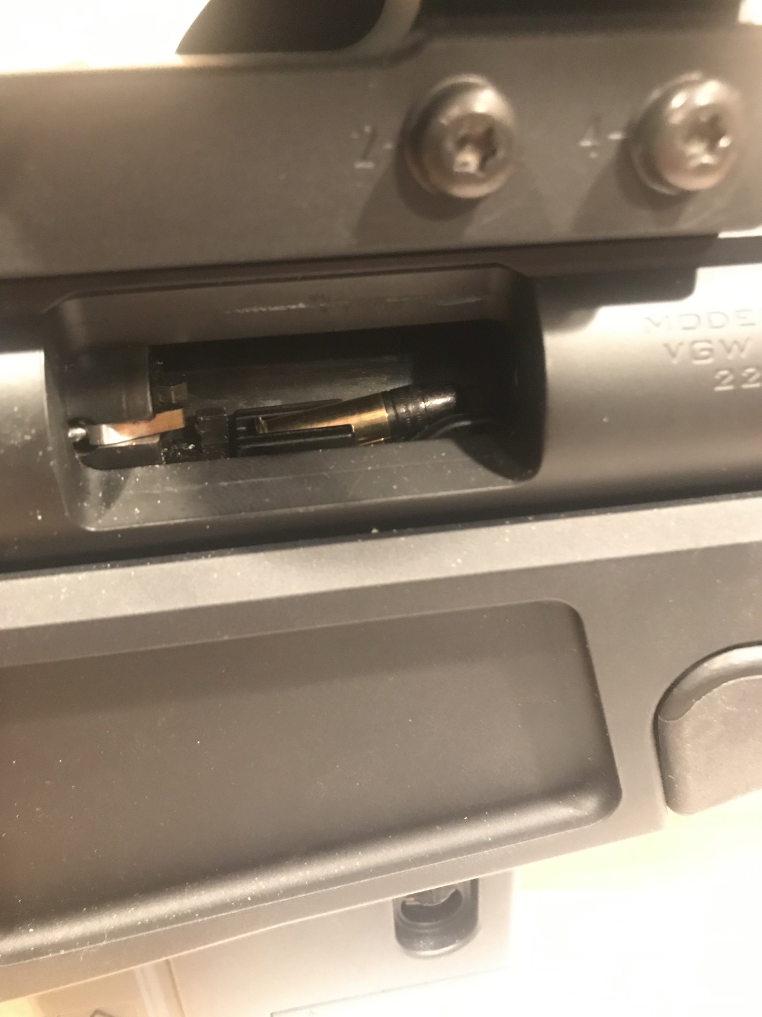

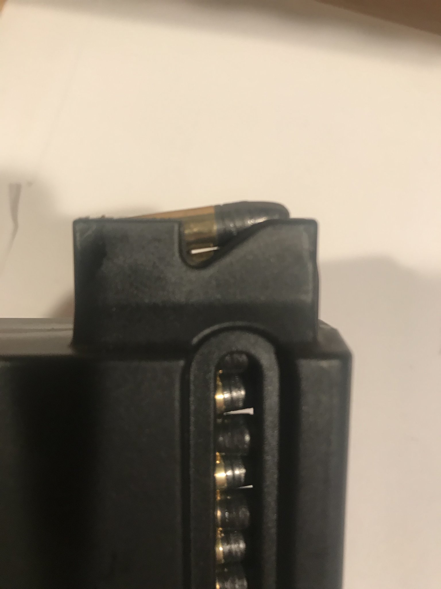

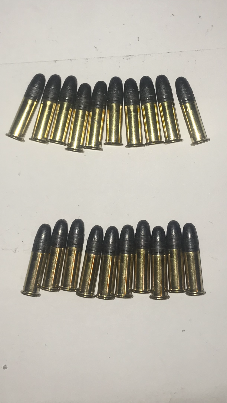

I read the answers, here is what I would do if it were me:
After confirming all the fasteners are tight load up a magazine with 10 rounds and chamber a round as you normally do, extract it and inspect the bullet for signs of damage & repeat for the next few rounds. If no bullet damage is noted go to the range with that same ammo and a few boxes of Lapua Center X (even if you have to order some and wait for it), and bring along everything you need to clean the barrel but don't clean the barrel just yet. Start off with the Wolf that is acting funny, if the results are the same try a magazine or two of 5 rounds, try a different magazine. If a different magazine or a magazine of 5 rounds doesn't help clean the barrel well, however if one of them does help double check the results by re-creating the low rounds and then go back to what fixed it to make sure it is repeatable. If you get to cleaning the barrel change to the Center X, foul the bore with 10-15 rounds and then test it with Center X.
I am recommending Center X because it is the most reliably accurate and consistent rimfire ammo I have ever tested across a wide range of barrels. It may not always be the most razors edge accurate but it is always close. I have never seen a quality custom barrel not shoot Center X well.
First step is finished.
Loaded the same mag with 10 rounds twice.
Loaded the mag in the same order as I laid them out and then reversed the order etc.
Lined them up from #10-1 left to right.
I can’t find any scuffs or markings on either # 1 or #10.
Pics imported last to first ..arrr
Top pic is 10 rd mag loaded to full capacity, 10 rounds.
Next pic is seated mag in chassis
Next pic is both 10 round mags laid out #10-#1 left to right after cycled through action.
Last pic is first 10 round mag out of the wolf Ammo box.
Should get to range this weekend.

View attachment 7034419View attachment 7034420View attachment 7034421View attachment 7034422
Safe to say it is not bullet damage from feeding, not that I really anticipated it with the V22 action and magazine system.

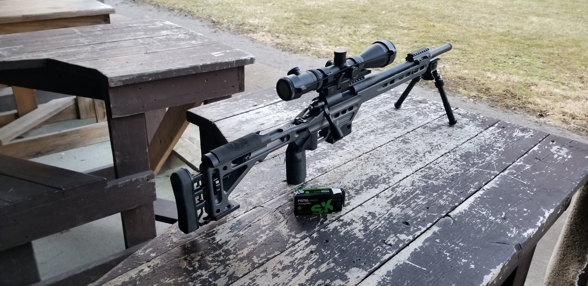

7035491This showed up yesterday?
7035490Just threw a scope on it so I could get a few rounds down the barrel. Probably getting a midas tac.

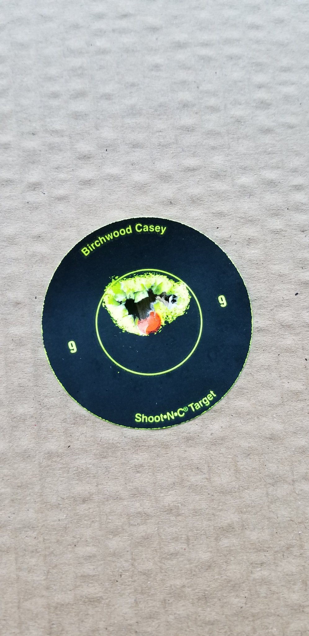

703549912 or 13 round group after sighting in.
First mag fails to feed last round but second mag worked flawlessly. Didn't try the other two yet. It was 37 degrees and sun going down so I was limited on time.

View attachment 7035491This showed up yesterday?
View attachment 7035490Just threw a scope on it so I could get a few rounds down the barrel. Probably getting a midas tac.
View attachment 703549912 or 13 round group after sighting in.
