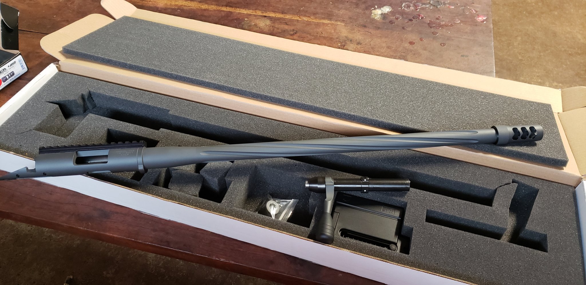

I picked up my Vudoo Thursday & competed today (Saturday) in my local NRL22 match. It has an 18” Kukri Ace barrel, Calvin Elite trigger, Midas Tac 4-16 & Grayboe Ridgeback stock. I placed 4th out of 19 shooters & never came in below 9th previously (with an incostitent FVSR). Shooting SK rifle match, this thing is just consistent & so easy to get on target. I cleaned all prone stages & need to work on my elevated positional shooting; kneeling, sitting & off obstacles.
7041408
I am beyond happy with my new Vudoo! Thank you to everyone at VGW for an outstanding rifle.
