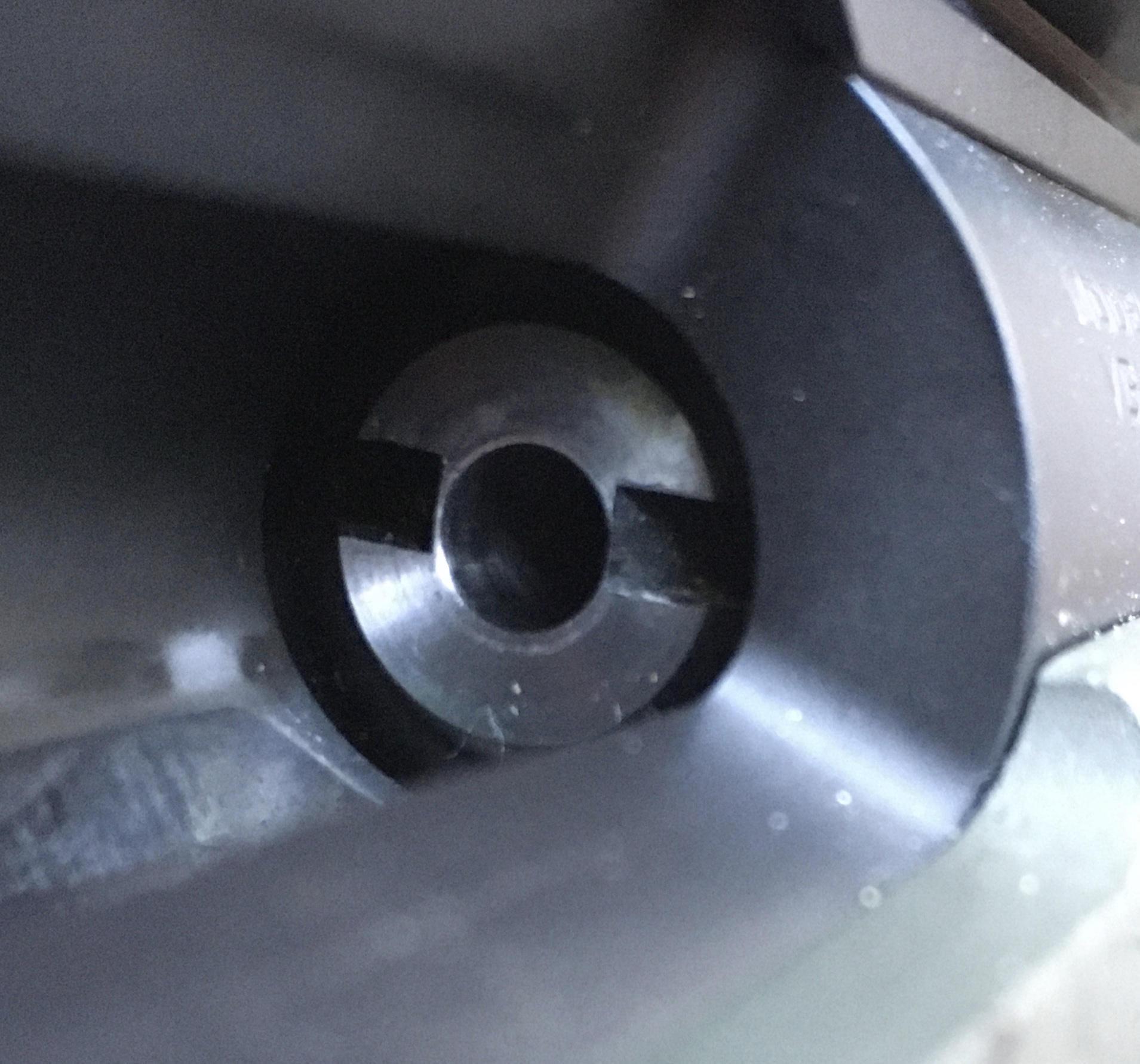

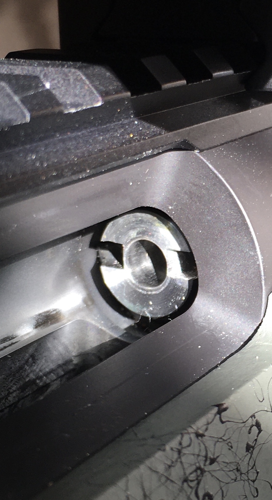

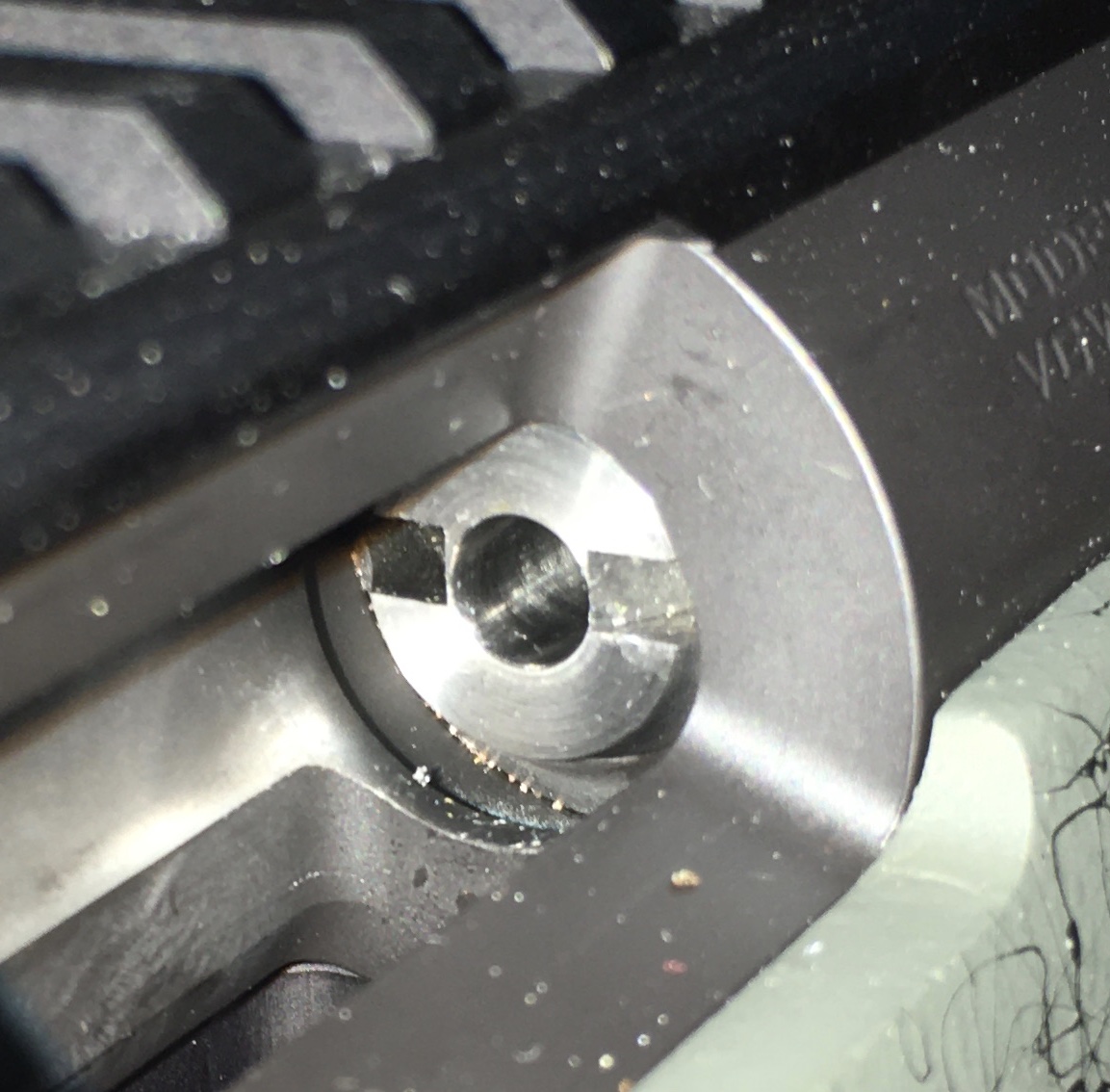

A good friend bought his V-22 bbl'd action from Altus a few months ago, and his has the first of the 2nd version breech I'd seen. My 2nd & 3rd bbl'd actions had the 1st version hybrid coned breeches, and I've had no issues with them, nor do I anticipate having any. But I think that if I were to send one of mine with flat breech back to VGW to have it coned, I'd go with the 2nd version. It just looks more robust to me.
