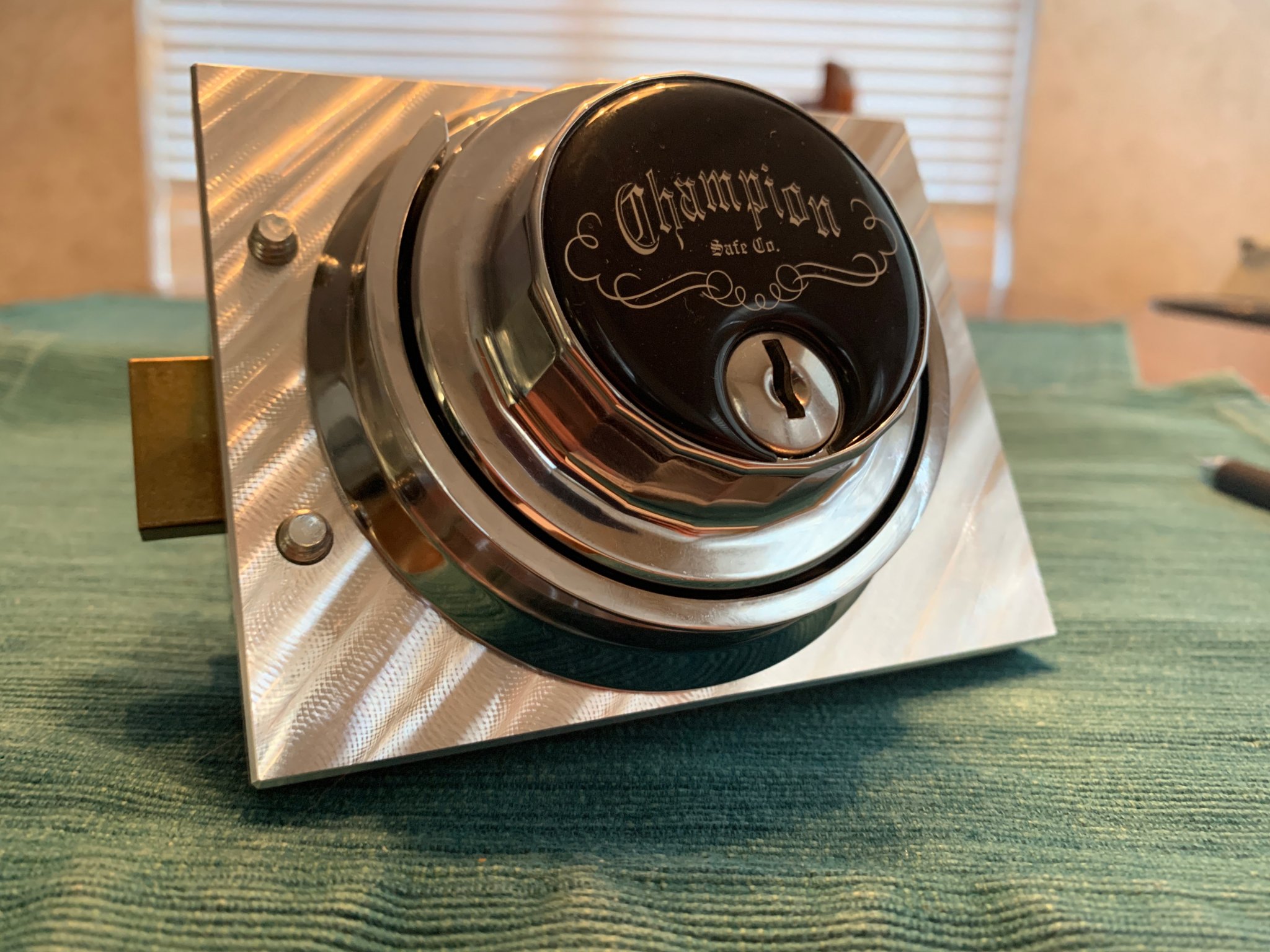

MIghty Bites FTW! Love'em! There's something just hypnotic about clean tool paths. Looks more like a facing op than a pocket.
I am playing with safe cracking (freaking hard!) and whipped up a quick mount yesterday for an old lock. Went a little unconventional on the facing since it was just for me.
Anyways, keep the machining pics coming!

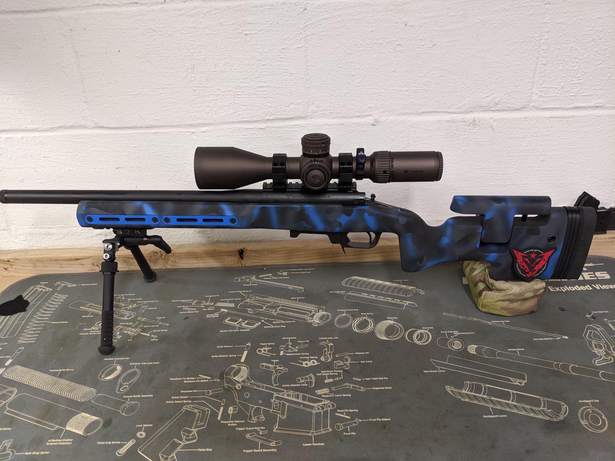

Hello Everyone, I am a relatively new Vudoo owner, I have the Ridgeback with 18" Kukri Barrel and I also have the new MDT ACC chassis with a 22" Kukri Barrel. Just curious as to what glass everyone is running? I currently have Vortex Razor Gen 2's 4.5x27x56 and I am wondering if there are advantages to a NF ATACR?
Nice rifle. You will love it.
As to scope, if you can't do it with the Razor you won't be able to do it with the ATACR. That Razor will do all you need.

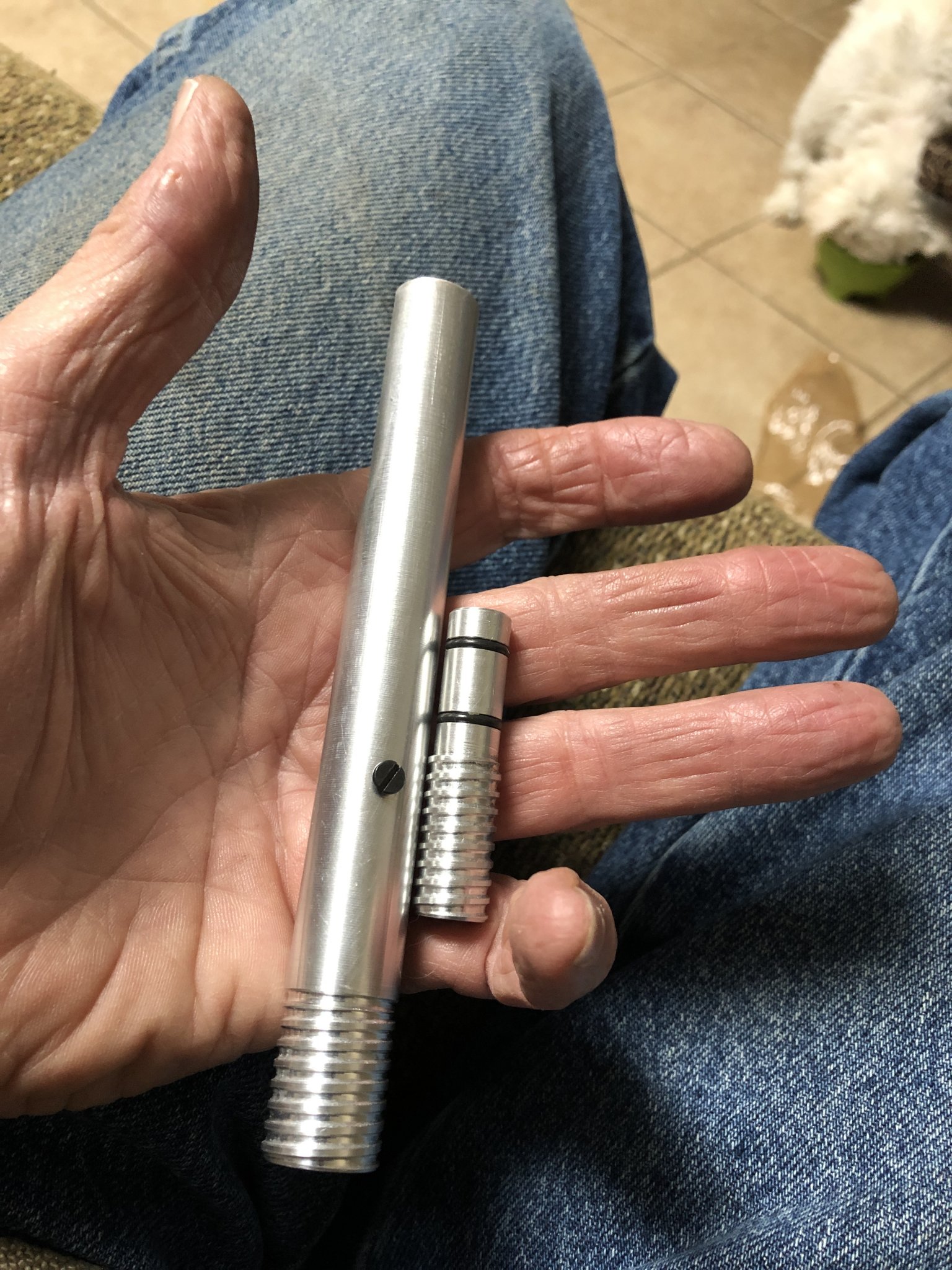

Im about to order a Vudoo bore guide. It does not appear my .22 cal Tipton carbon fiber rod will work. What cleaning rod is everyone using for their Vudoo's? Adapter? Length?
If I remember right it will take anything under .187. At least I think that’s what my bore guide said. .17 cal carbon fiber rod is what I’ve been using with the adapter for a 22 jag. Somebody please correct me if I’m wrong.
To add to the cleaning rod discussion, I have a 17 - 20 cal. Montana extreme with 5-40 threads. Fits great, but the adapter that gets me to the 22 jag is 8-32. This will not fit through the insert in my Vudoo bore guide. I have to leave the insert out.
Can anyone tell me where I can get a 5-40 thread 22 jag that fits through the insert? Or, even a new rod and the matching jags? Or, is there a place where all this has been discussed already?
Justin
Reactions: Drewdemon
For rimfire cleaning in general I prefer a Dewey 20cal rod in a 22lr and I turn down the thread adapter to just over 0.200” so I can then attach the jag for the VFG cleaning felts. It does a great job for me. I use this with my VGW V-22 bore guide and the insert.
