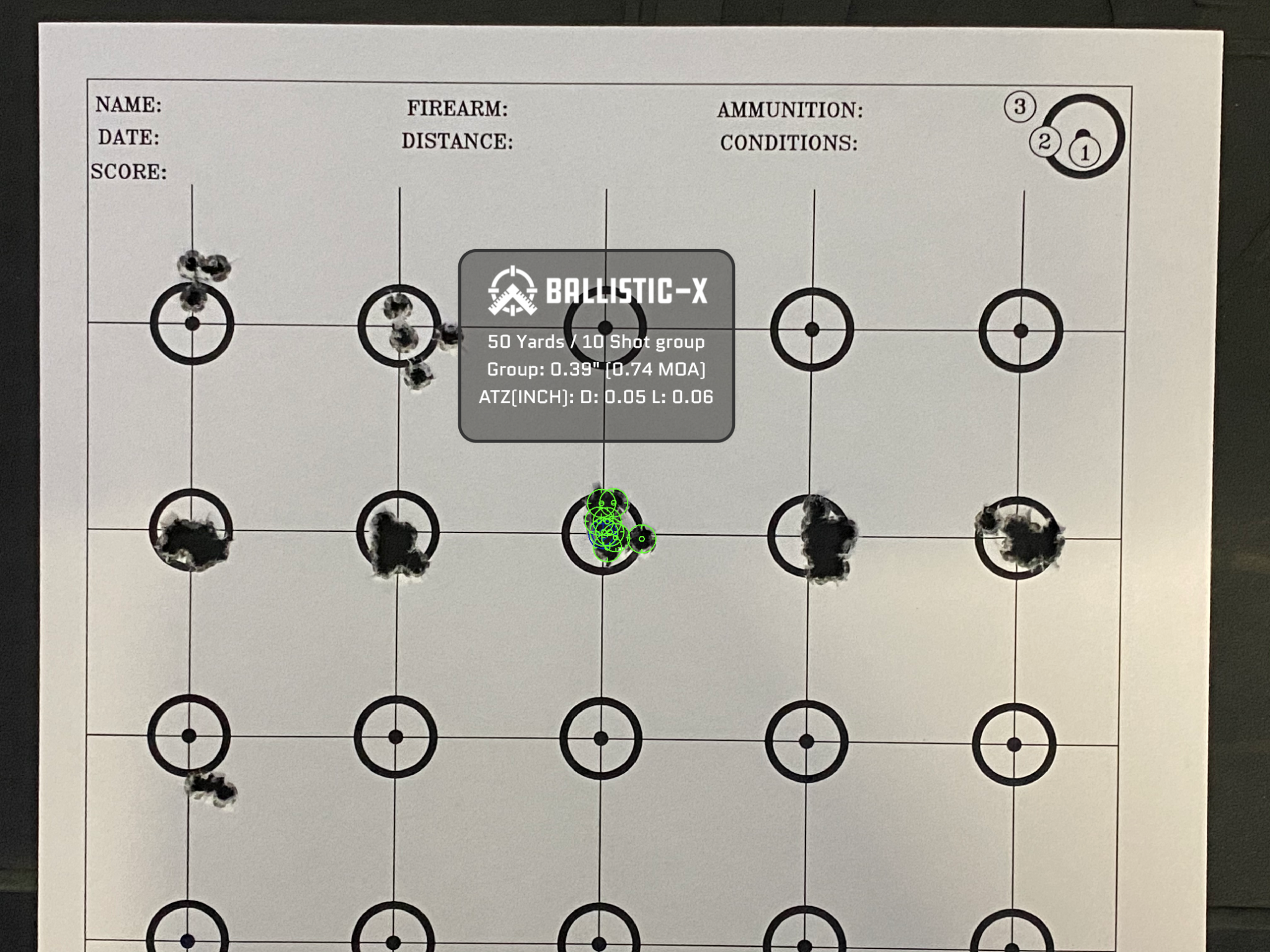

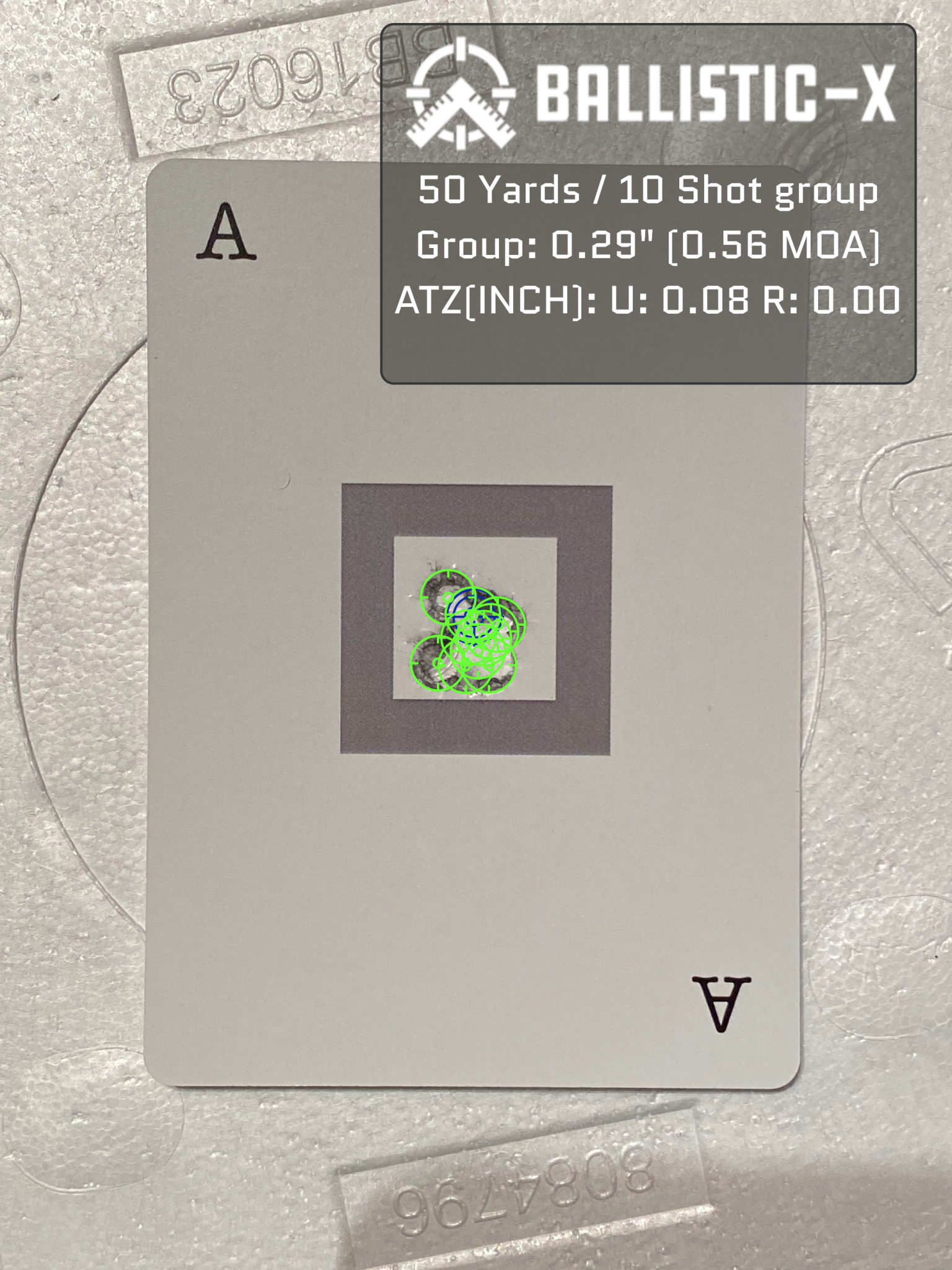

Just a quick trip to the 50 yard indoor range to get my new Nightforce 7-35 sighted in. Shot a few ten shot groups with Center-X. I can’t get over how awesome the Vudoo is. Really looking forward to those aluminum magazines next year!

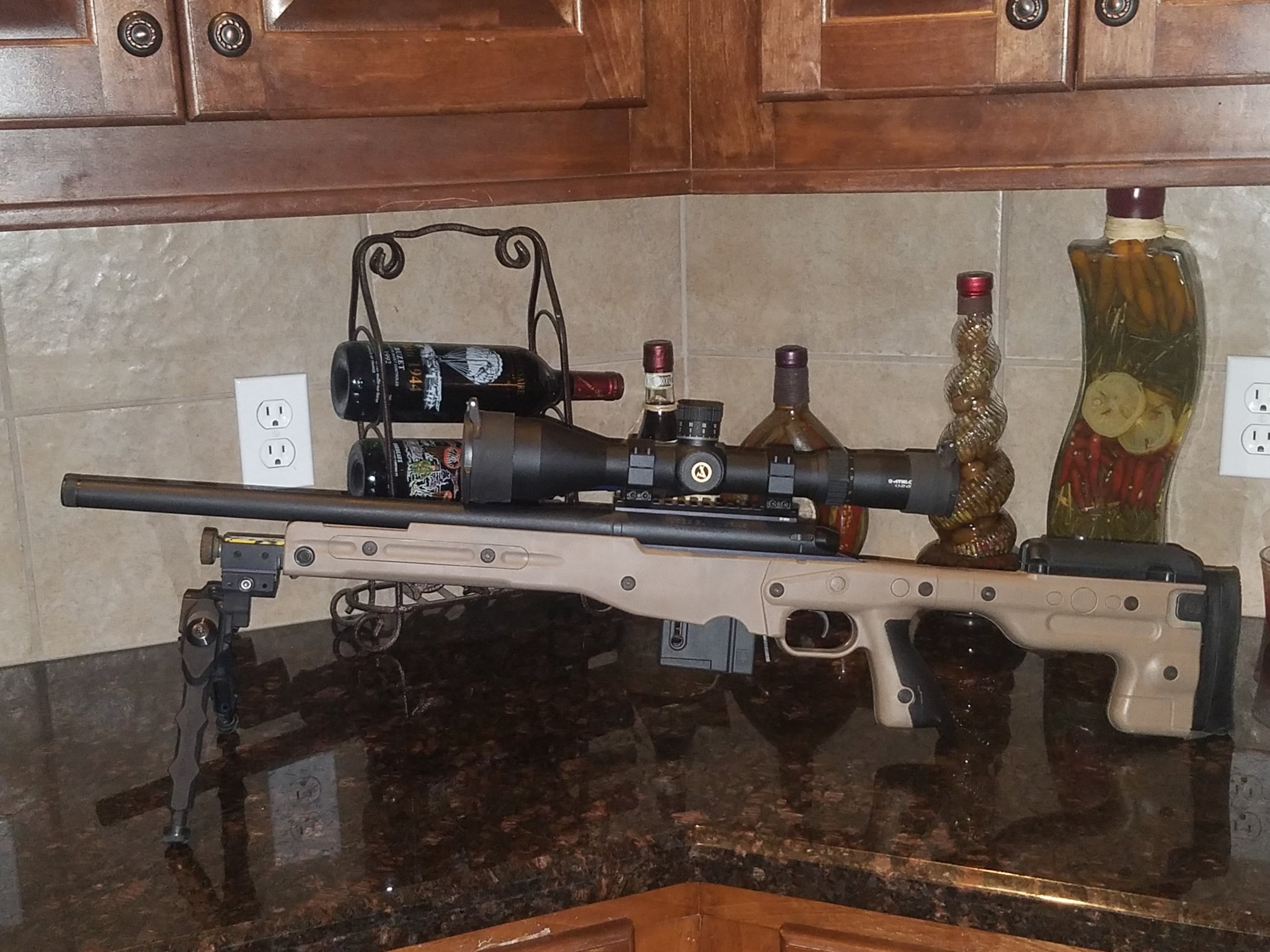

I may have missed it somewhere in the 86 pages of this thread, but I have a question regarding stocks for the V-22. We all know that the action will drop into a Rem 700 footprint action. My question has to do with the placement of the side bolt release.
Is the side bolt release located 'high enough' in the receiver so that a stock inletted for a 700 - McMillan, Manners, Greyboe, etc, does not need additional inletting or relief so the bolt release will clear and not interfere with the stock?
I have a Grayboe and a MPA for the Vudoo neither have any issues with the bolt release, it drops right in to both. The only issue, and it is cosmetic is the ejection port is longer than what is needed for the Vudoo.
