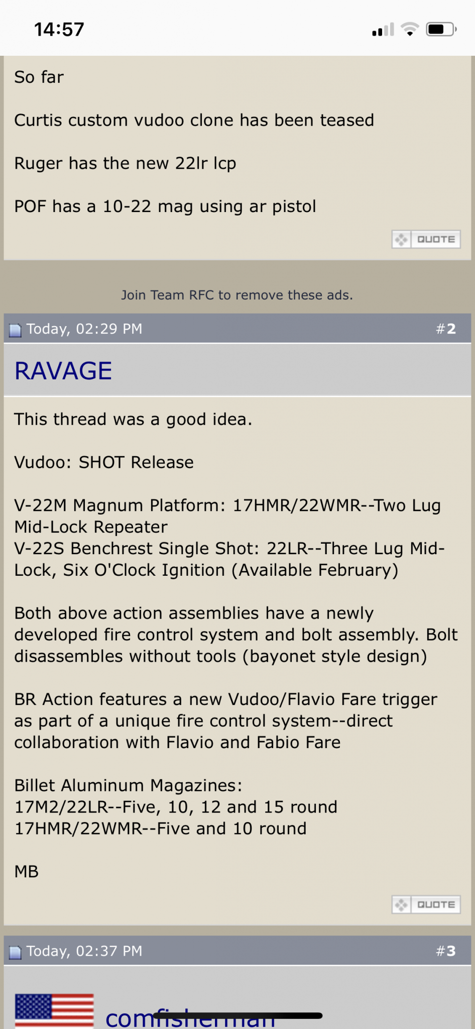

Yessir, the V-22M, "M" is for Magnum, 17HMR/22WMR is done and available to order around SHOT Show timeframe. It's in the new Gen 2 action format with the new fire control, new bolt assembly (disassembles without tools) and our machined billet magazine in five and 10 round capacities.
The V-22S Benchrest action is also done and available in February. Three lug, mid-lock, six o'clock ignition only available for 22LR.
MB

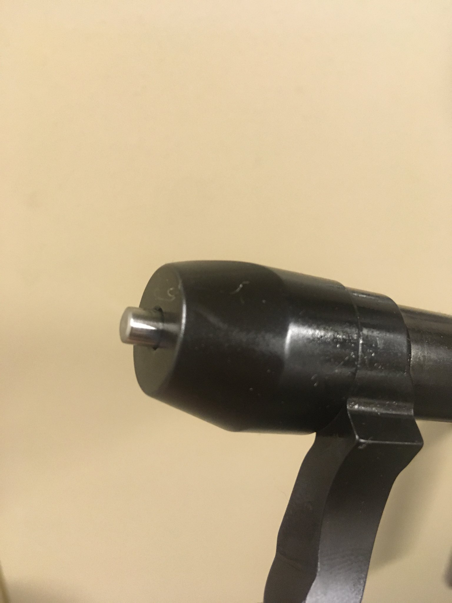

Are all the bolt going forward going to look like this?
Yes, the V-22M (Gen 2) and V-22S (Gen 3) will look like that. The difference is the presence of a hole in the firing pin where it protrudes through the shroud that serves to accept the take-down pin used to disassemble the bolt. We're shipping Gen 2 fire controls as pictured that lack the take-down hole because they're in bolt assemblies (Gen 1) that lack the bayonet features for disassembly.
The Gen 2 and Gen 3 bolt assemblies have locking lugs on the shroud (in place of the threads) and bolt nose (in place of the pins). The purely cylindrical features on the shroud and bolt nose fit precisely into the bolt body to create superior concentric alignment. For the bolt nose, the very slight fore and aft thrust is eliminated; this thrust being present due to tolerancing for pin to groove fit in the Gen 1 convention of attaching the bolt nose to bolt body.
These features, along with an Anti-Rotation feature (present in both the Gen 2 and Gen 3 receivers) that doesn't allow the bolt nose to turn slightly about its axis while lifting the bolt handle all work in conjunction with the features in the Gen 2 Fire Control. At the same time, the vertical sear in the Vudoo/Flavio trigger used in the V-22S allows the bolt to remain "relaxed" while cocked and the result is a drag free, very efficient and repeatable creation of energy in the fire control. In concert, all this led to lowering the spring rate which, in turn, lowers bolt lift resistance (important in a three lug system) but effectively indents the case rim, time after time.
