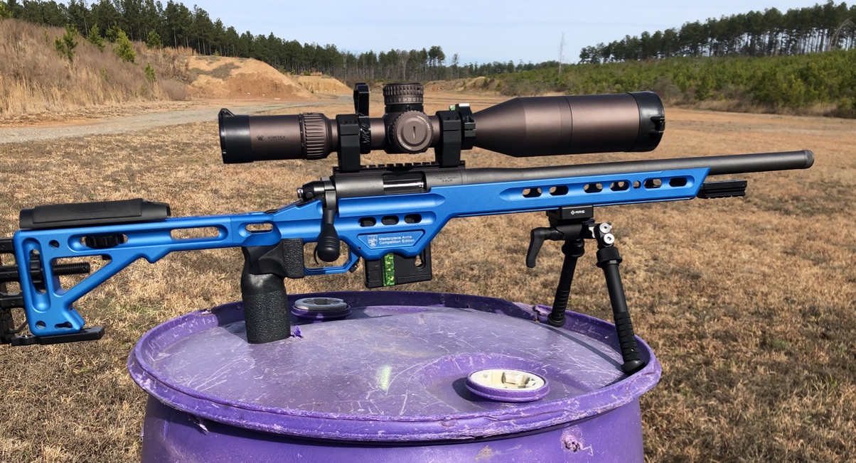

I am considering ordering a similar color setup. Would you mind posting a pic of yours?
Here's the repost of earlier crappy image. It's rained off&on all week, and. with the leaves off the trees, didn't want to do photos in back yard lest new-ish neighbors get weirded out. Anyway, here's a half-decent photo:
  • 20" Ace barrel, Kukri contour
  • Melonited action, Cerakoted barreled action (Cobalt)
  • 30MOA rail
  • Timney Calvin Elite trigger (single-stage)
  • MPA BA Comp chassis (NRA Blue)
  • Vortex Razor 4.5-27x56 Gen-2 w/sunshade, 1.26" PMR rings
  • Atlas BT65-NC CAL bipod with RRS BTC-Pro ARCA clamp
