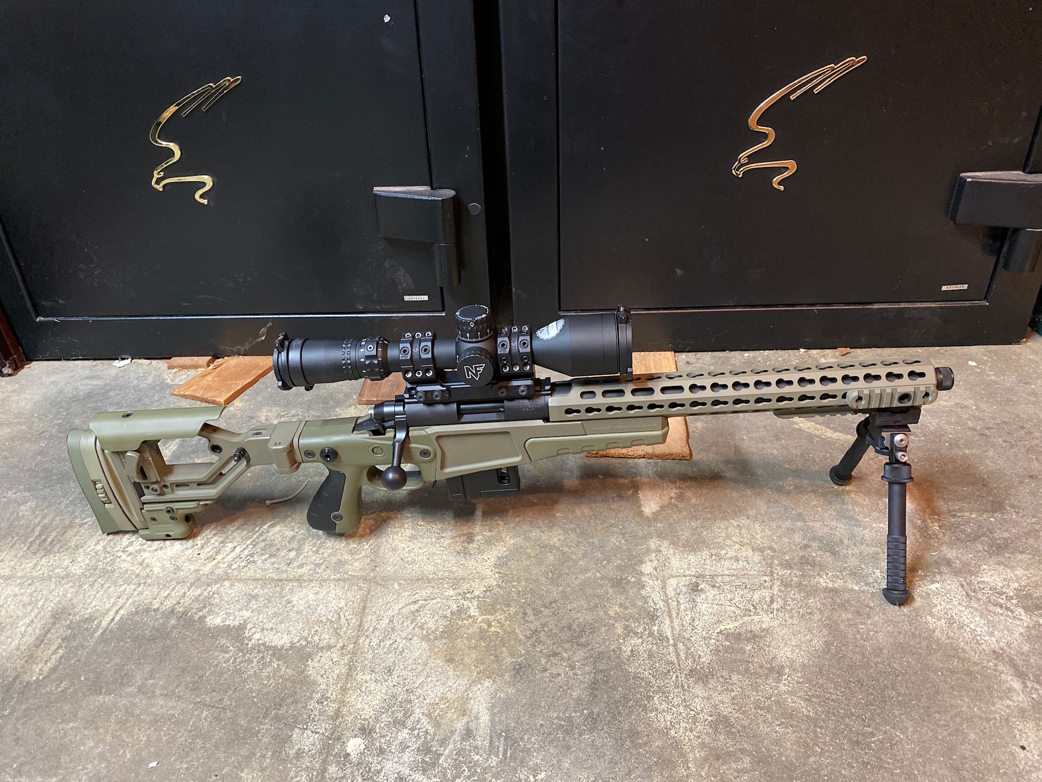

Put her together and off to the range. Here's my report:
Awesome ...
Scope is only OK but I'll pull a Razor off a big gun this week.
Stock is going to Stock Doc for an adjustable cheek piece. Trigger is a two stage Calvin Elite ... also just OK. I will play with adjustments this week.
I am more impressed with the feel of quality and comfort (familiarity) of the feel compared to centerfires than I am with the actual performance. I shot SK Standard and Match. Actually shot the Standard better. I didn't measure groups but easy one hole at 50 and one inch at 100 if the wind stayed down. It was 30 degrees today but I'm kinda used to that.

What barrel profile is it?
Yes on all counts! BTR with 30mm tube. Clicks are mushy. Edges of glass not great and not as bright/clear as some other scopes. For the money its a home run ... I have another on my Kidd/McRee 10/22 and it certainly works. The Vudoo deserves better is really what I was implying. I like my Gen 2 Razors ... maybe I'll move one over on a trial basis.

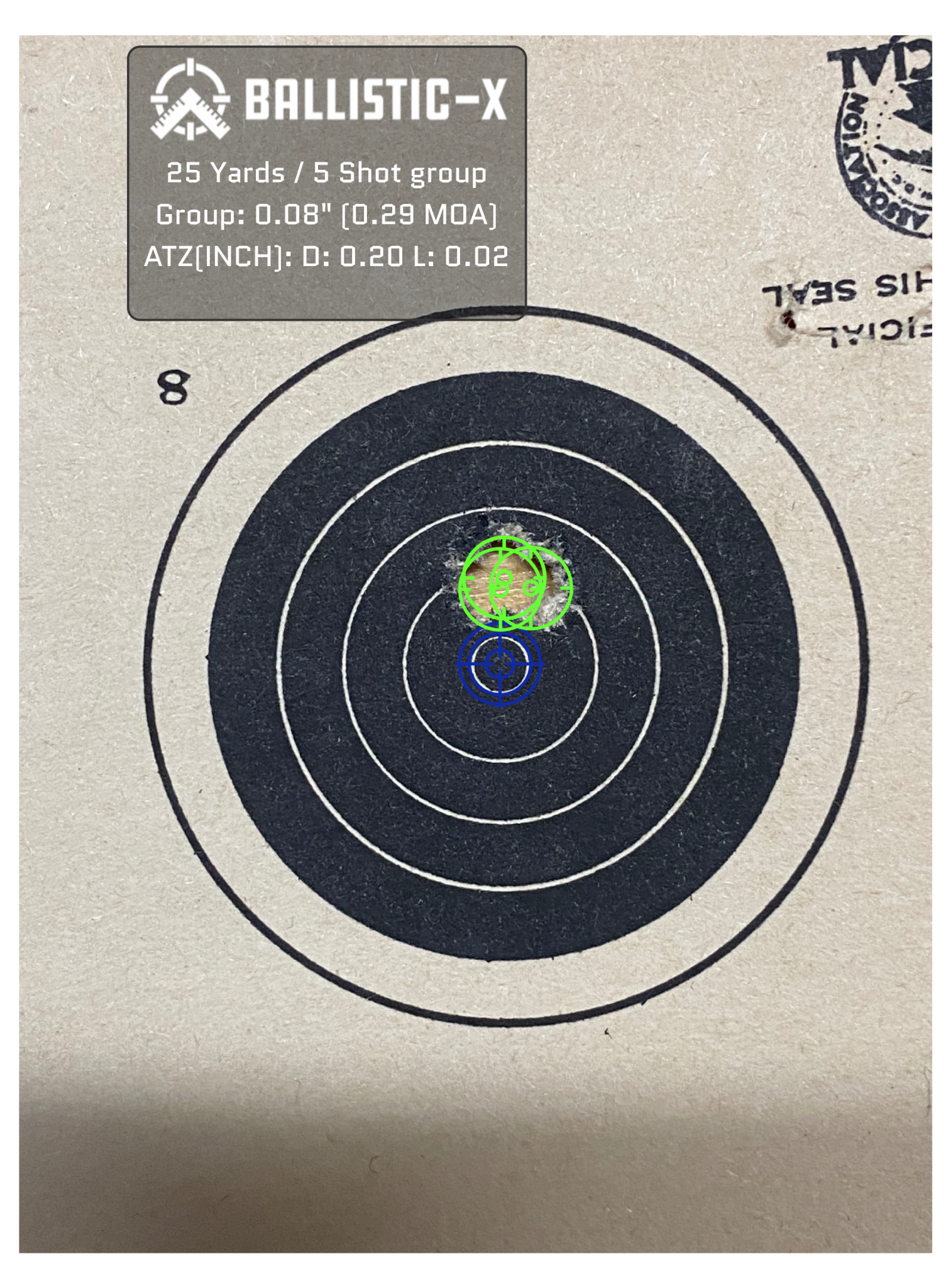

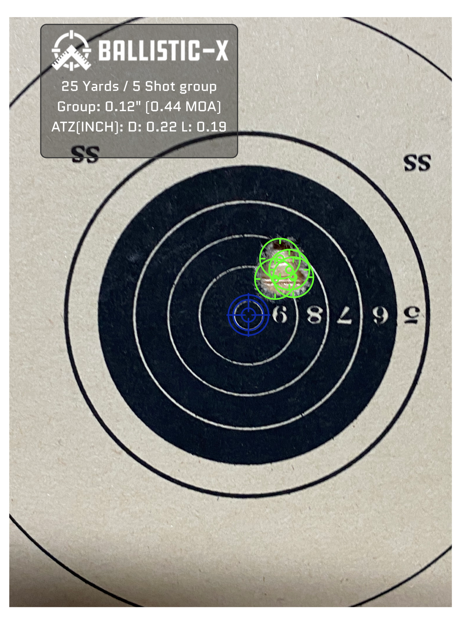

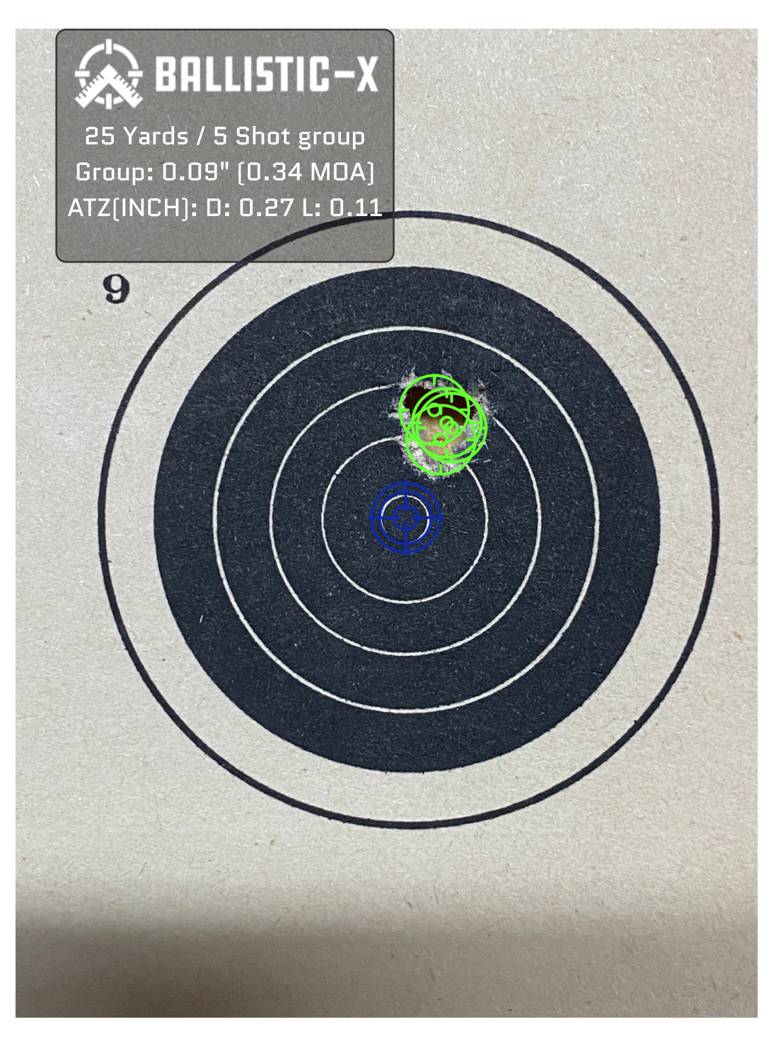

I got out with my Vudoo for the first time today. The range I went to has 25 and 50 yard firing points but if someone is at 25 the 50 can’t be used. I was stuck at 25 for the duration. I was shooting FGMM. Here are a few of my groups.
