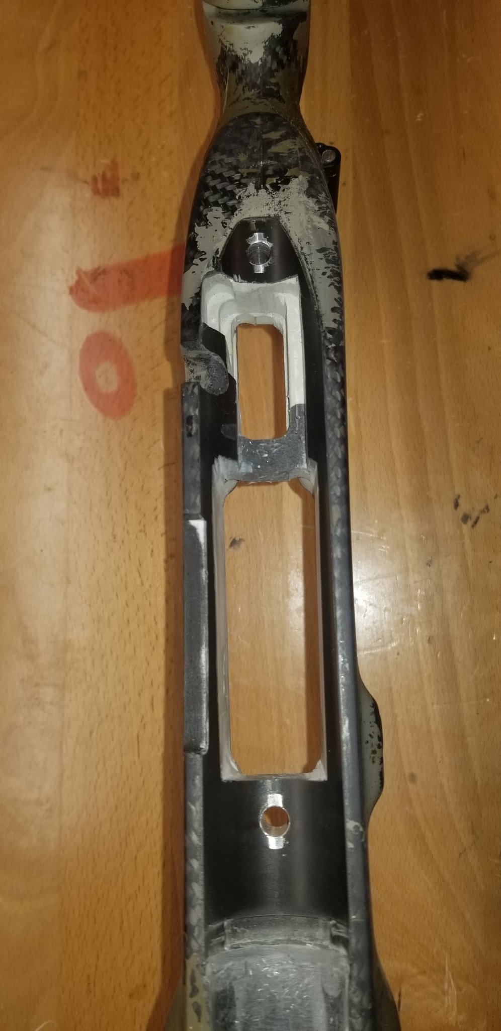

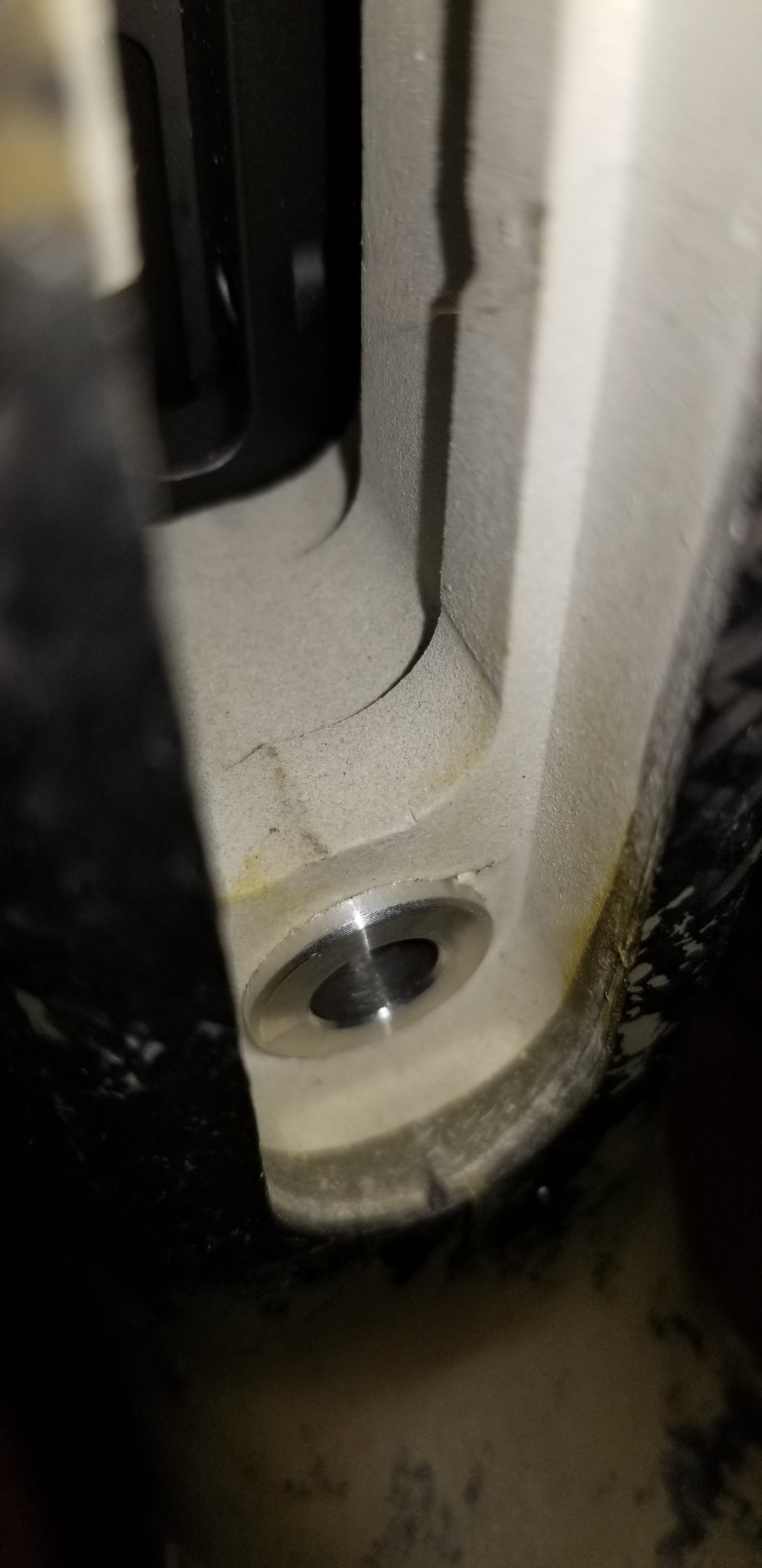

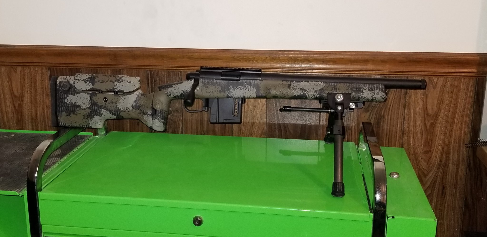

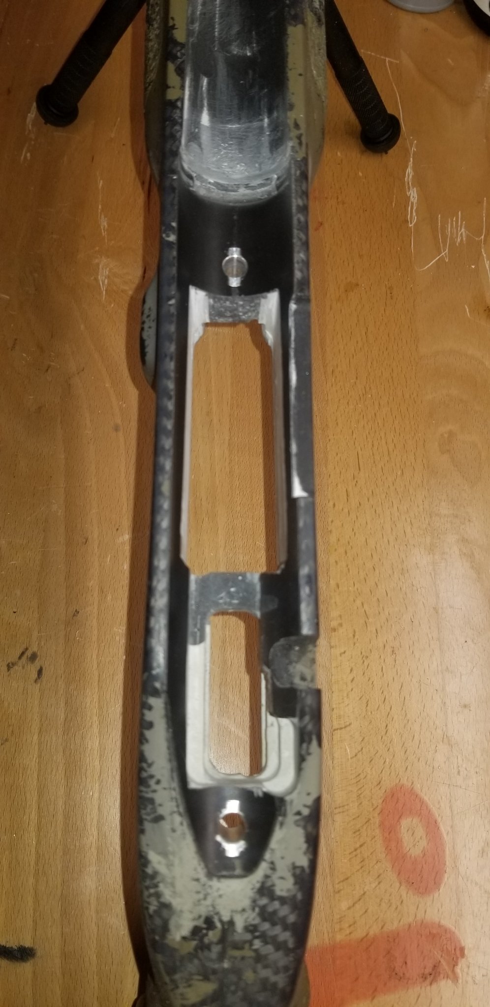

Got it bedded yesterday and cleaned up this morning, it's not perfect but it should do the job. Throwing a Jewell in there until my other trigger arrives, I have to say it's nice having a regular size magazine and good trigger options. Hopefully I can take a long lunch and head to the range this week to see how it shoots.
Have you shot it before bedding the gun? I'd be interested to know if there's any accuracy difference before and after.
No, I had to bed the action and get the pillars bonded because the inlet wasn't right. The barreled action just rocked even when tightened down. The pillar is the correct length for it to feed from the magazine.

She is looking mighty sexy!
Thanks, I'm pretty happy with the way it is turning out. I haven't used a traditional stock for a build in a long time because I hate bedding them lol.

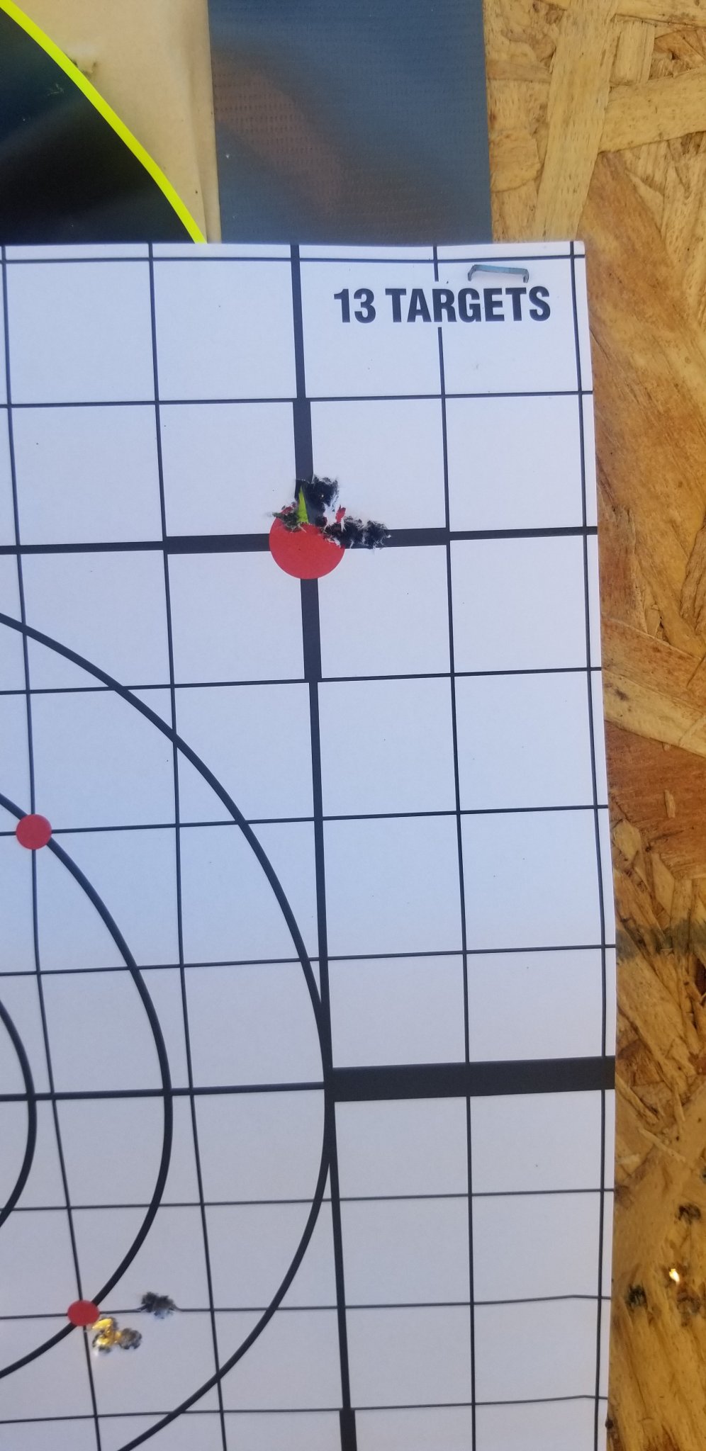

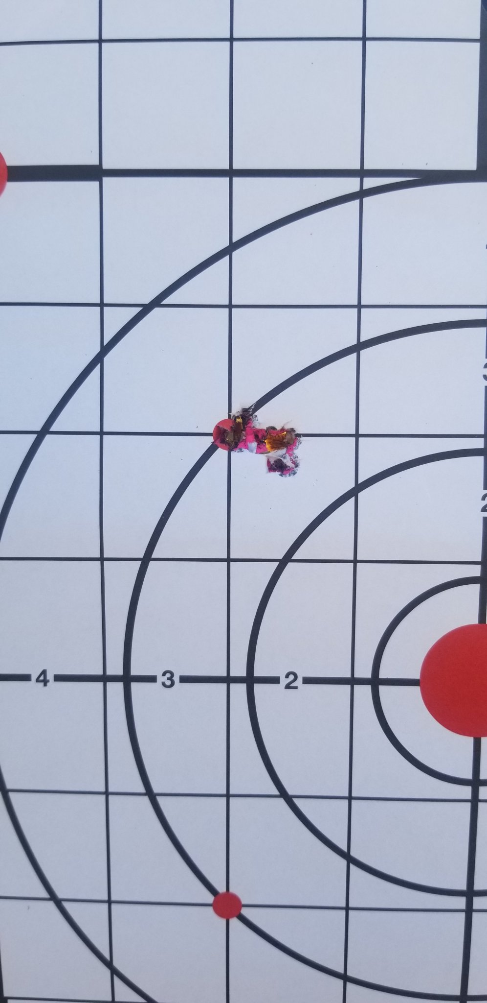

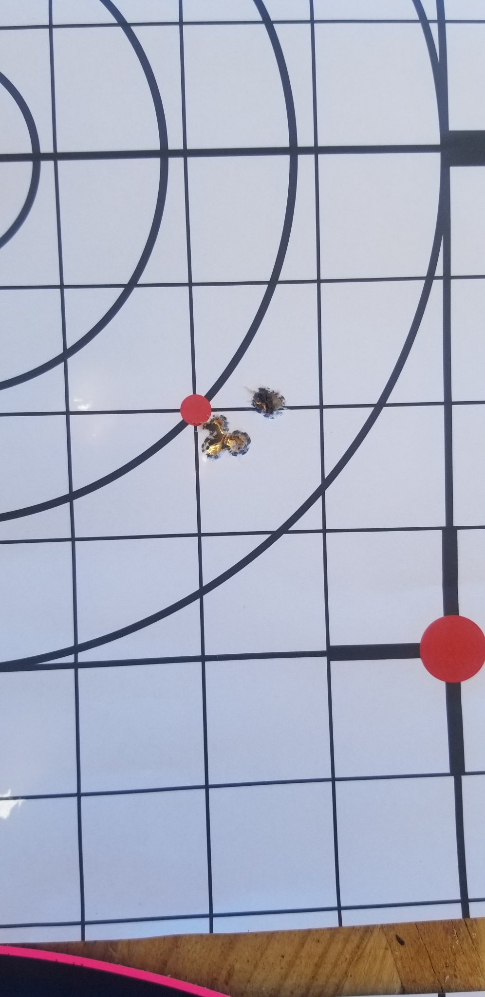

Finally got some decent weather to go to the range. Put about 100 rounds through it and it shot good. I am shooting some decent groups but fuck it up with one shot as usual. These are at 50 yards with sk rifle match, definitely room for improvement on my part but I've only shot twice this winter between work and the weather.
