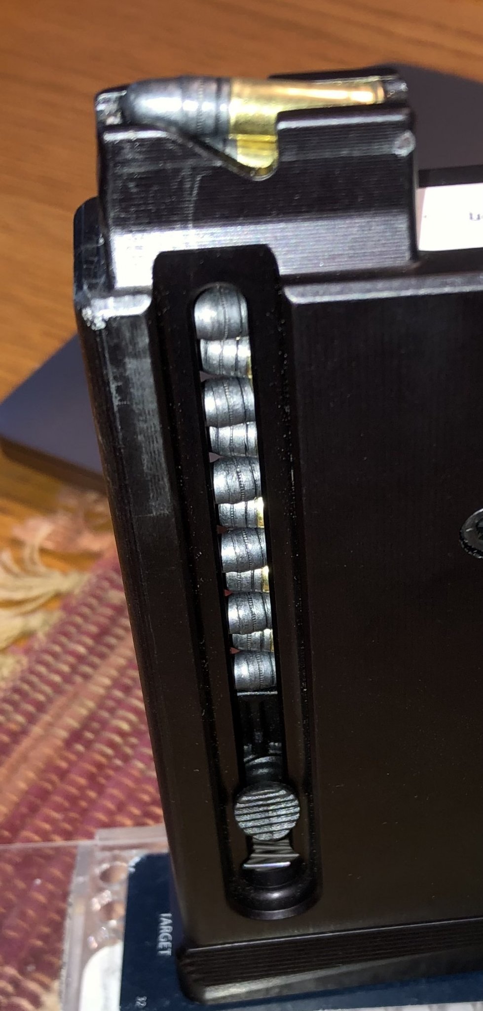

Is the Vudoo feed system fussy? Well yeah, compared to lesser rifles. How about compared to a RimX? Pfft. The most common RimX misfeed I experience is with a RimX 5-round extension in place with the standard spring... cartridges seem more prone to go nose up as the bolt closes, the rim doesn't go under the extractor, bolt pushes round into chamber which then has to be dug out with a fingernail stronger than mine or some kind of tool I see a lot of RimX guys stick to the side of their rifle.
* This is a now-discontinued 15-round magazine. The 10-round mags don't show the staggered offset as clearly, but it's easily visible if one looks.
