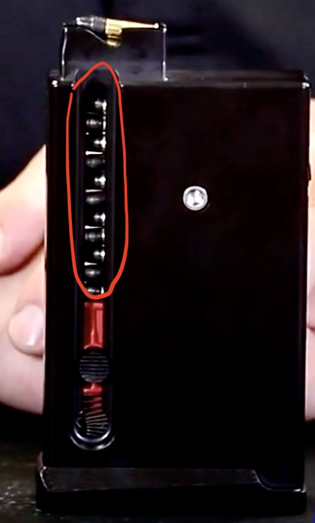

Four-year, gen-1 Vudoo owner here (MPA BA Comp chassis). I have several 3-round polymer and (no longer available) 1st-gen 15-round aluminum mags, all of which feed fine EXCEPT when they're not loaded correctly. The 15-rounders are much more prone to loading error. I submit that what many call "rimlock" - and indeed the failure to feed feels exactly like rimlock - is actually mis-orientation of the round in the cartridge stack. Since I realized what I need to look for, my misfeed count has dropped to near zero.
OP, if you have not watched Paul Parrot's magazine-loading video on Youtube, do so. Toward the end, he comments on how the top cartridge in the magazine stack might stick in a flat orientation, instead of nose-up, and this will cause a misfeed. This is, of course - since Paul is one of the Vudoo founders - correct insofar as he goes.
But in my experience it is possible to, in essence, push that "flat" round down into the stack and load cartridges on top of it. Everything feeds fine until that "flat" round comes up, and then... misfeed.
How to tell if a "flat" round is in the stack? Look at the blurry photo (screen capture from the video). The cartridge column is circled in red. Notice how the bullets are staggered in the stack, with the long axis of each round oriented left-right-left-etc. In my experience, if I load one of my mags - especially the 15-rounders - and see the long axes of two consecutive rounds pointed in the same direction, I will have a jam when those rounds reach firing position. Sometimes I can tap the mag as Paul describes and get the stack oriented correctly; sometimes I have to pull rounds out and reinsert them.
I'm not going to say this description is 100% certain to help with rimlock-like misfeeds. I will say 100% it's pretty much eliminated misfeeds for me, even with my notoriously-cantankerous 15-round aluminum mags.
