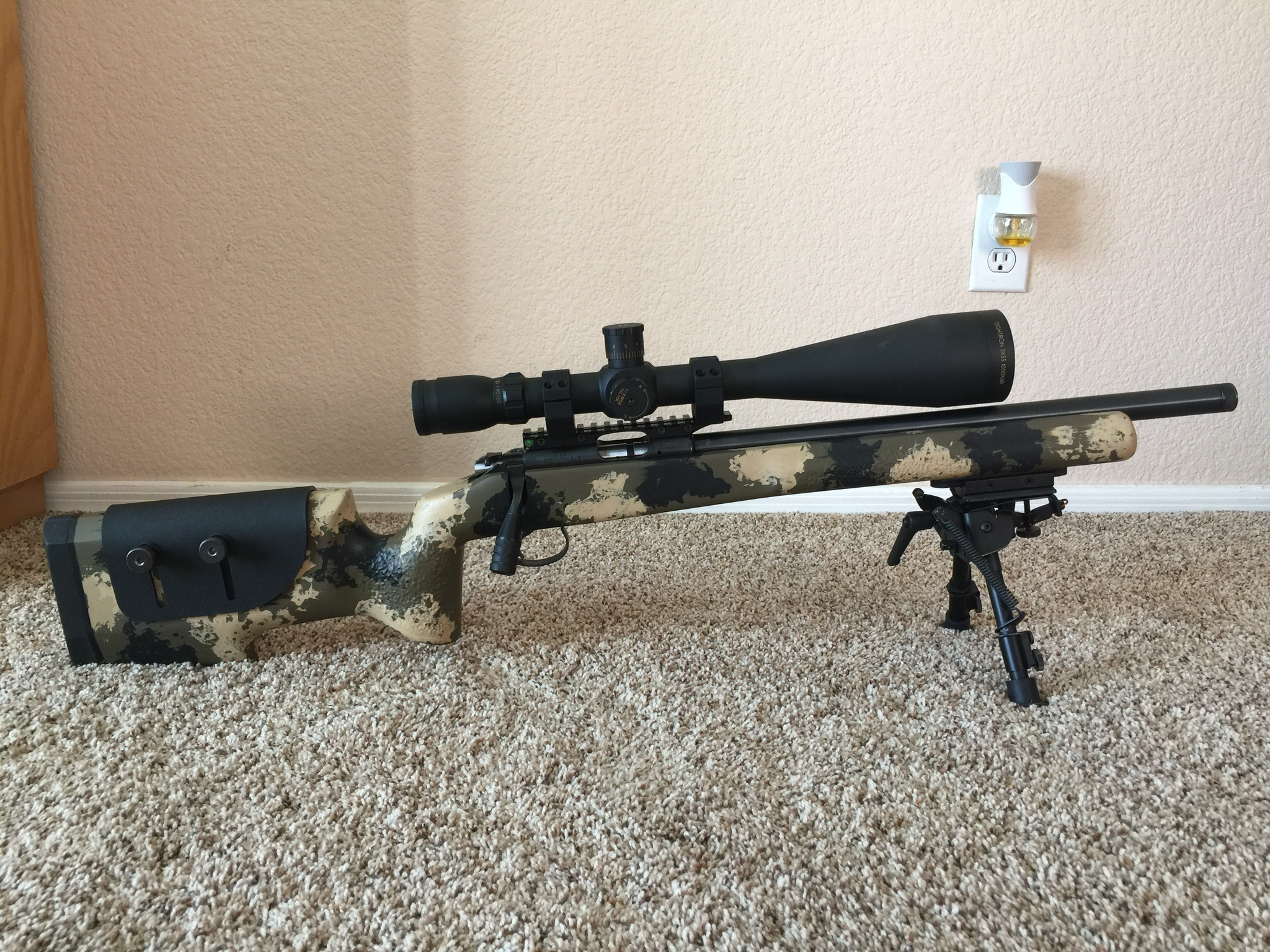

I got my Sightron SIII 10-50x60 mounted I used a Area 419 15 MOA Base and Vortex medium precision rings and just enough clearance. I was able to focus down to 10yards today with it but only got to shoot out to 100 yards.
I really like this Sightron ??
B505A297-075A-4B0D-ABCC-853FBCBB2B37.jpeg25 Yards40335C9A-4984-44EE-A083-1A9622C6F99C.jpeg100 yards69C506A6-0A92-42E9-BCEC-C0C388616E03.jpeg50 yards
