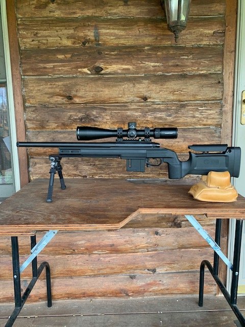

I have an 18" Kukri barrel and a KRG Bravo chassis. I like that the magazine release is outside the trigger guard. It has an adjustable comb and length of pull. I have a Calvin Elite set at 1#. I am very happy with my Vudoo. :)
Reactions: shoot4fun and JKW70
