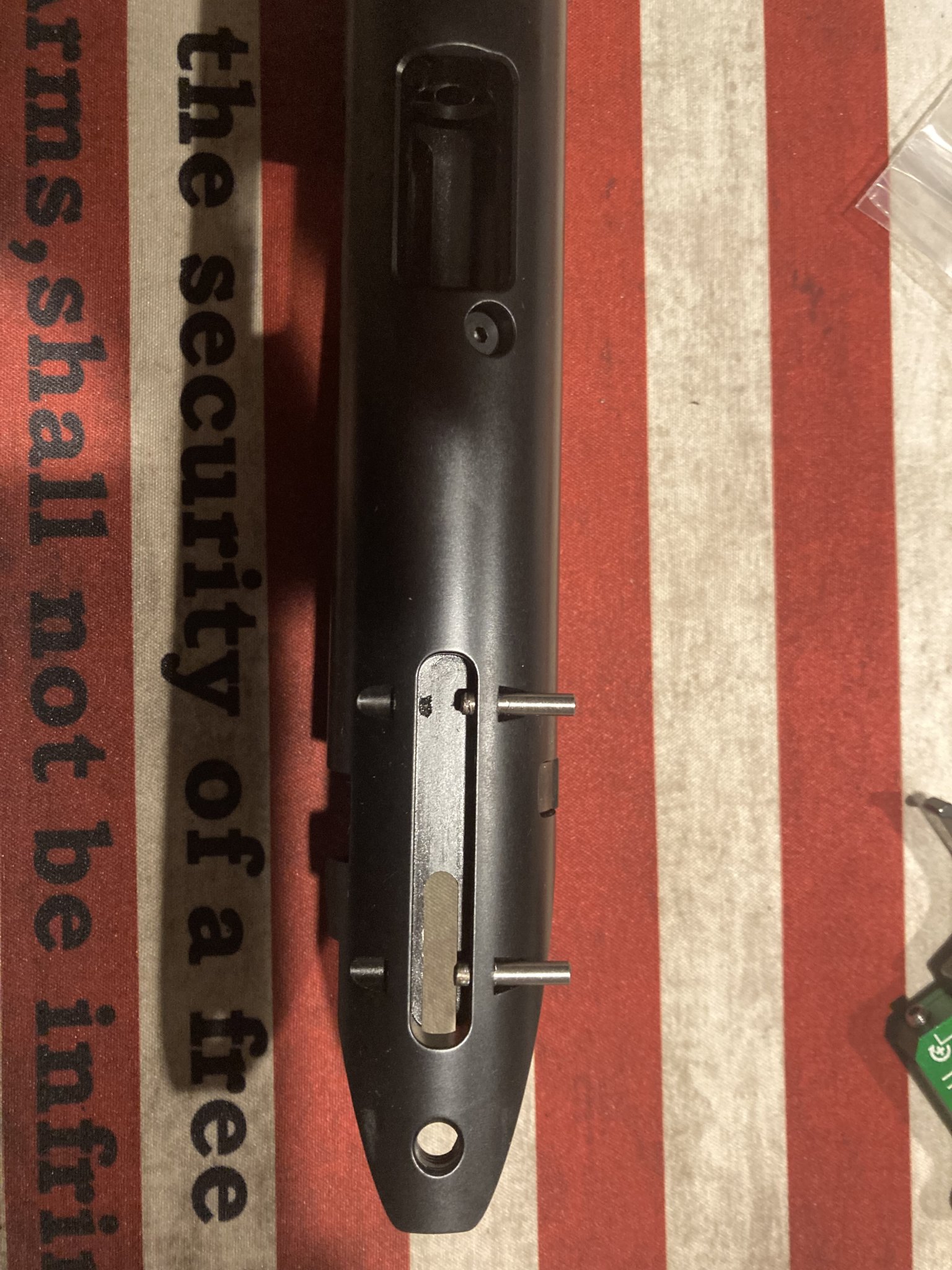

    I’ve searched and read what I could find, but I’m still left with a couple of questions regarding trigger install on a Vudoo V22 360:
    • Are the trigger pin holes directional? (and if so how are directions identified? i.e. is “right” the ejection port side? or…?)
    • Are the trigger pins supplied with a barreled action tapered, and therefore also directional? Or just a slight chamfer on the end that’s supposed to go in first?
    I read where the pins are supposed to “slide in”, at least to the trigger assembly, after which you are supposed to tap them the rest of the way in. Mine most-definitely do not “slide in”. I was able to get them barely started with hand pressure: front from the ejection port (“right…?”) side, and rear from the other (“left…?”) side, after which I had to drive them with a brass punch and hammer. I’m hoping I didn’t do something backwards and screw something up.
    All of the V-22’s I have owned and installed triggers in (which is 5 or 6 at this point) the pins are tight as a mother fucker! Support the action well and get a BFH
    Second this. The reason I ordered my current Vudoo with the trigger installed rather than mess with it myself after how tight the pins were on the first.

    ungodly freaking tight.....like not even correct tight...
    I hesitate to say “like not even correct tight”, only because they do fit in there and do not push out any material (pushing material out would fall under that category). However they are very difficult to install, I am guessing that the action is drilled to less than 0.001” over the pin OD or maybe even to the pin OD but then the creakote is applied and that is the reason they are so tight. Personally I don’t see a reason for such a tight fit as it doesn’t hold the trigger any tighter in the action / in alignment (that is ultimately dictated by the trigger mfg and how they size the holes in the side plates of the trigger), & the pins can’t really fall out with the rifle installed in most chassis / stocks. Maybe @RAVAGE88 can comment as I am sure it is intentional.
    I pulled my Trigger Tech Diamond out of my V22 and swapped it out for my B14 R unit. They were both a tight fit but were certainly
    doable if you kept the pins square to the hole axis and lined up with the trigger unit. I think a small chamfer would have gone a long way to ease the installation problem. There is no reason that you cant add a chamfer to aid with the initial hole alignment.
    I just installed a TT Diamond in my new 360 barreled action today. The pins were definitely a bit of a tight fit but went in just fine with a little patience and using both roll pin starters and slave pins to keep things lined up front and back. Having everything properly aligned makes it go a lot more smoothly
    I suspect that at the first sign of any problem, I pushed a pin through each hole of the trigger and then the BA to make certain
    that there were no manufacturing issues. After I was satisfied that things worked as individual parts, l I knew that I simply had to
    line things up. It will give you peace of mind.....
    I certainly don’t think there is a manufacturing problem with the fit, they are just tight. Like I said over 5-6 V-22‘s spanning all of the generations have been consistently tight.

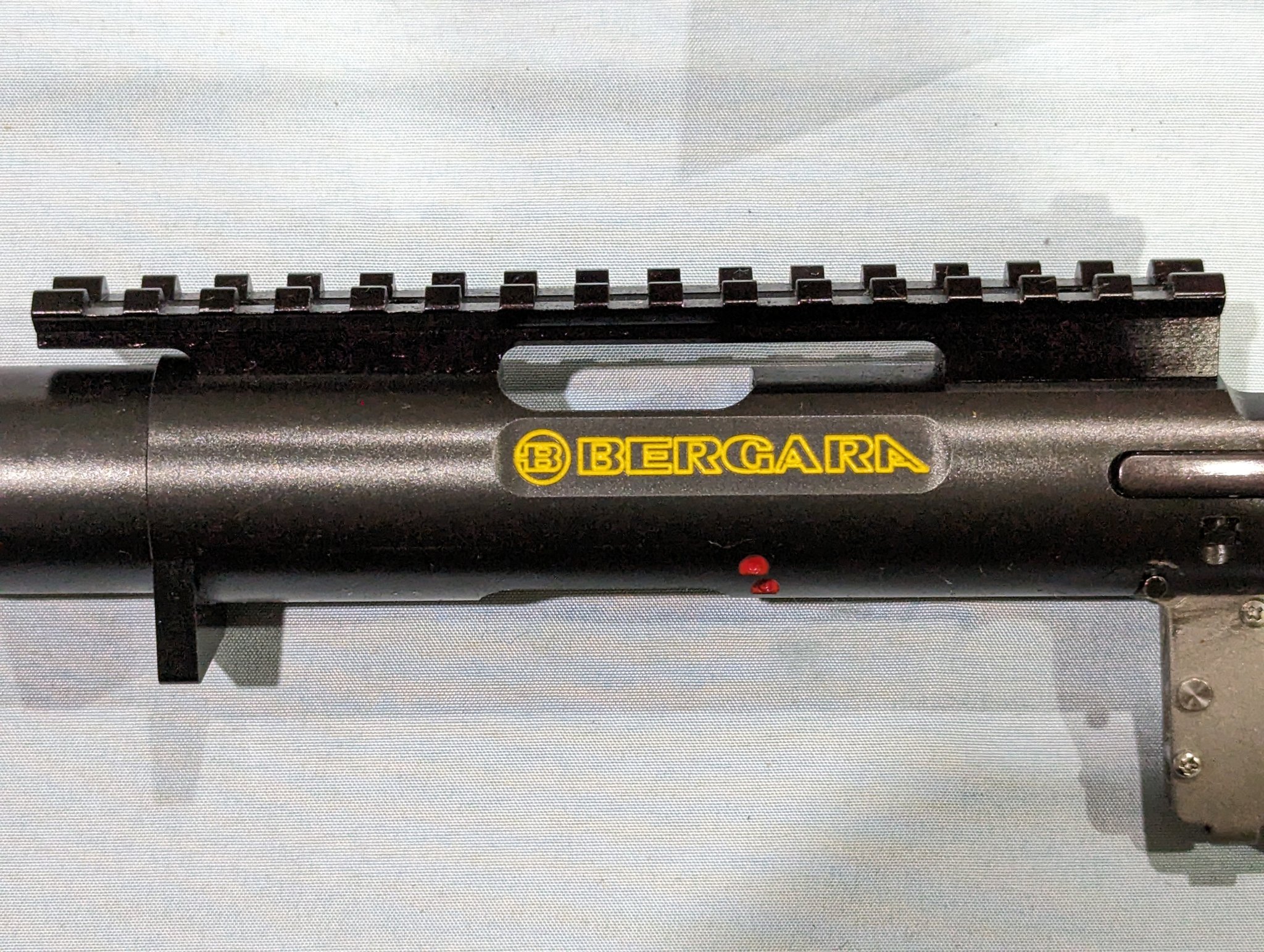

    The B14R does use pins that have a head's on them and the receiver does have flats machined into the left side but I believe that is
    purely to ease assembly. The flat surface make pin insertion easy. Try and insert the pin on the right hand side. The rounded surface with
    no clear cut hole can be done but it is a PITA! If you lose or replace the Bergara trigger pins that have heads on them, just get some regular,
    straight, headless 700 trigger pins and move on. I have never done it, and cant really imagine why I would want to, but you could probably
    substitute roll pins for solid trigger pins.
