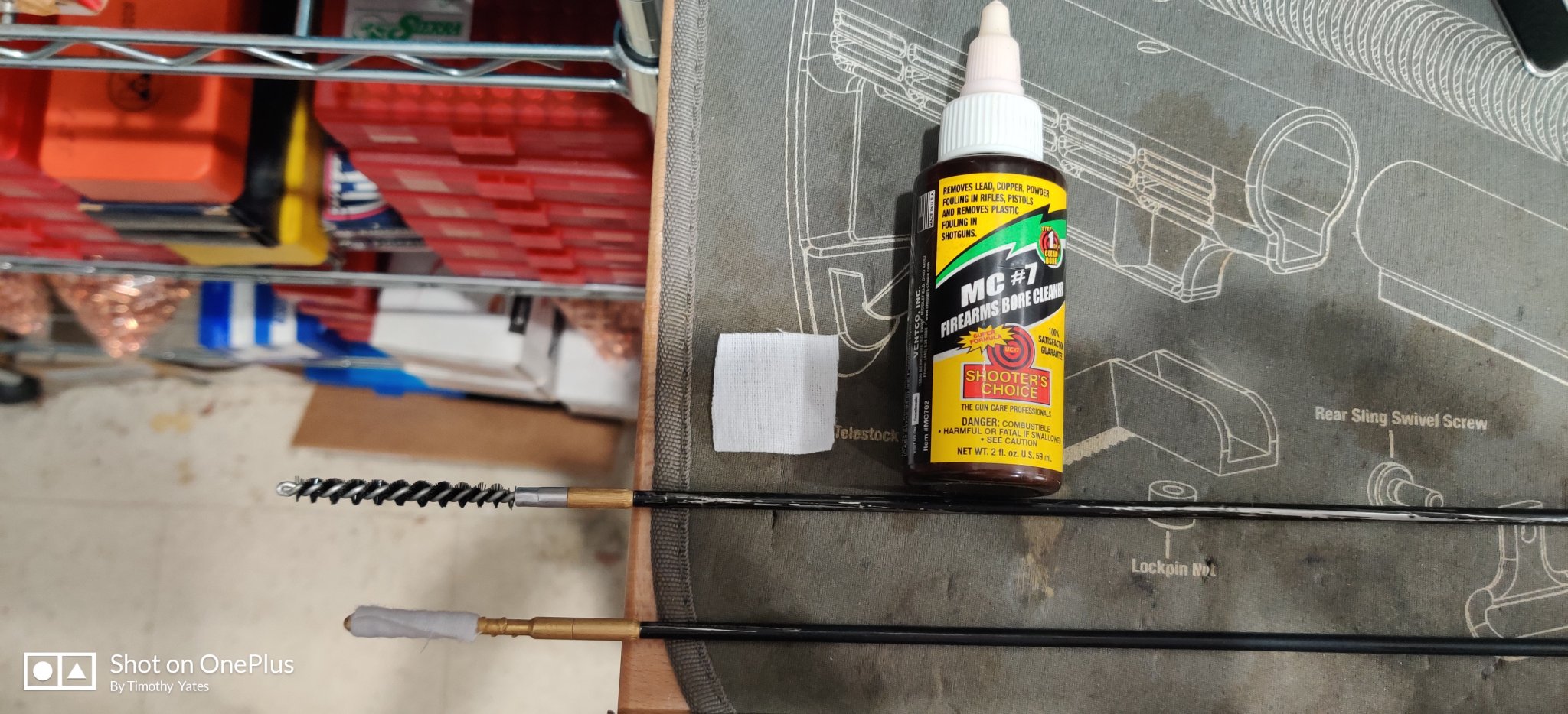

    I use these items for cleaning my 22 rimfire barrels. I also say why above.

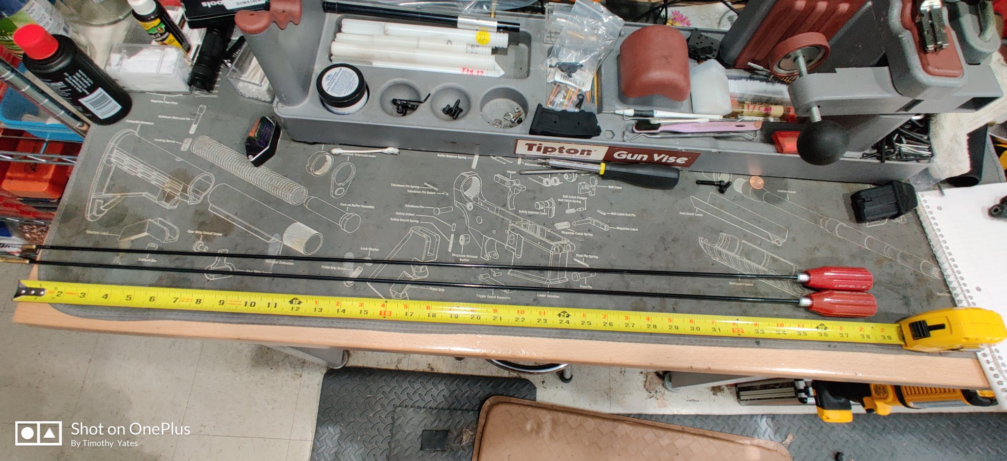

    36" 17 cal Dewey coated rod. If you get a shorter rod and someday have a 28" barrel rifle you may not have enough rod if you use a bore guide. This is a Dewey model 17C-36.

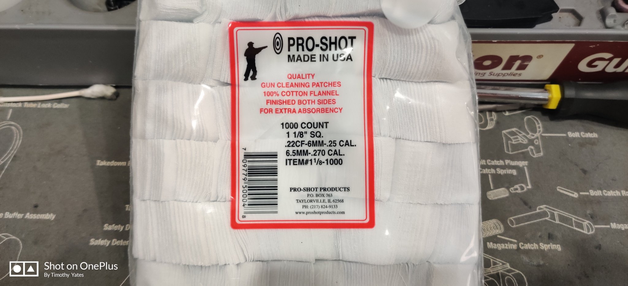

    For patches I have been using these Pro-Shot patches for a long time and they work perfect around the Parker Hale jag. Next size down works great for a 17 rimfire, I have those too.

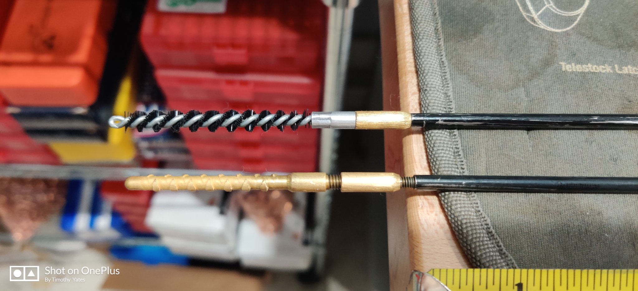

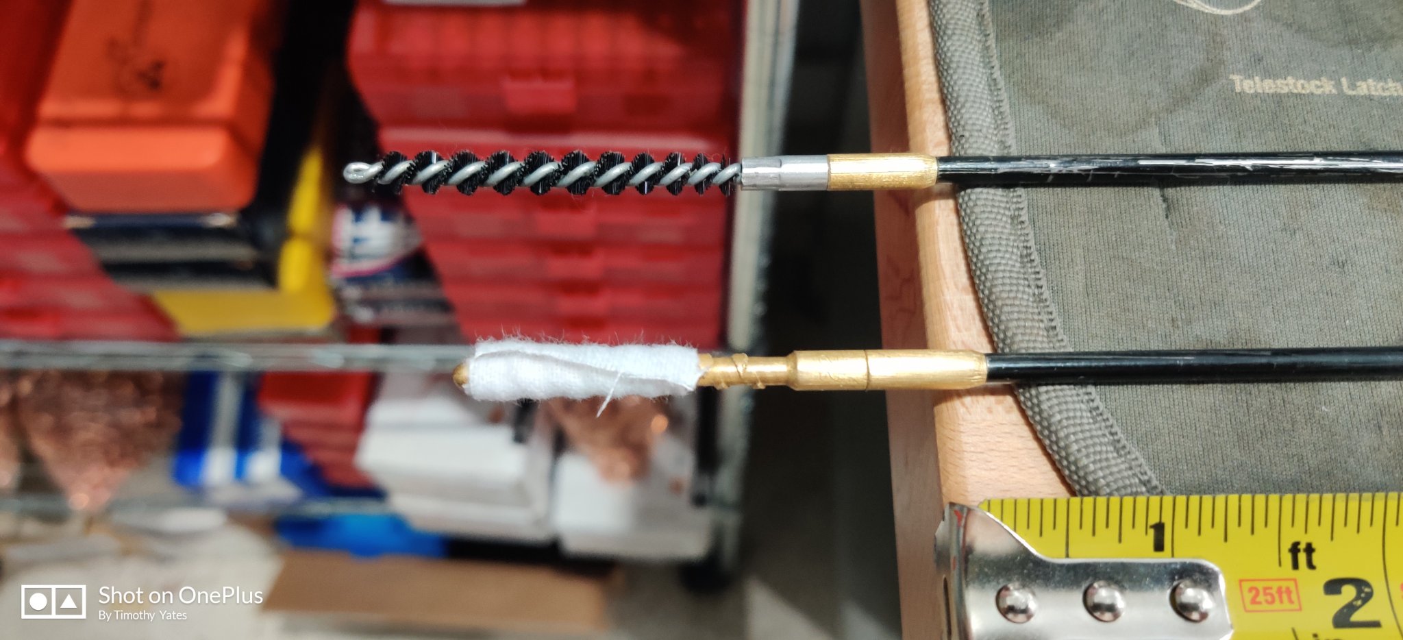

    Jags, I have tried several throughout the years and have settled on Parker Hale as the best for me. With the patches wrapped correctly it makes for a tight fit. This particular nylon brush is made my Tipton, IMO it doesn't do a lot of cleaning but I believe it's a little more aggressive than the patch alone plus it shouldn't disrupt your seasoning in the barrel like a bronze brush will. It is good for attempting to remove a carbon ring because you can easily reverse the direction while in the chamber, something that is hard to do with a bronze brush. More on that carbon ring at the end.

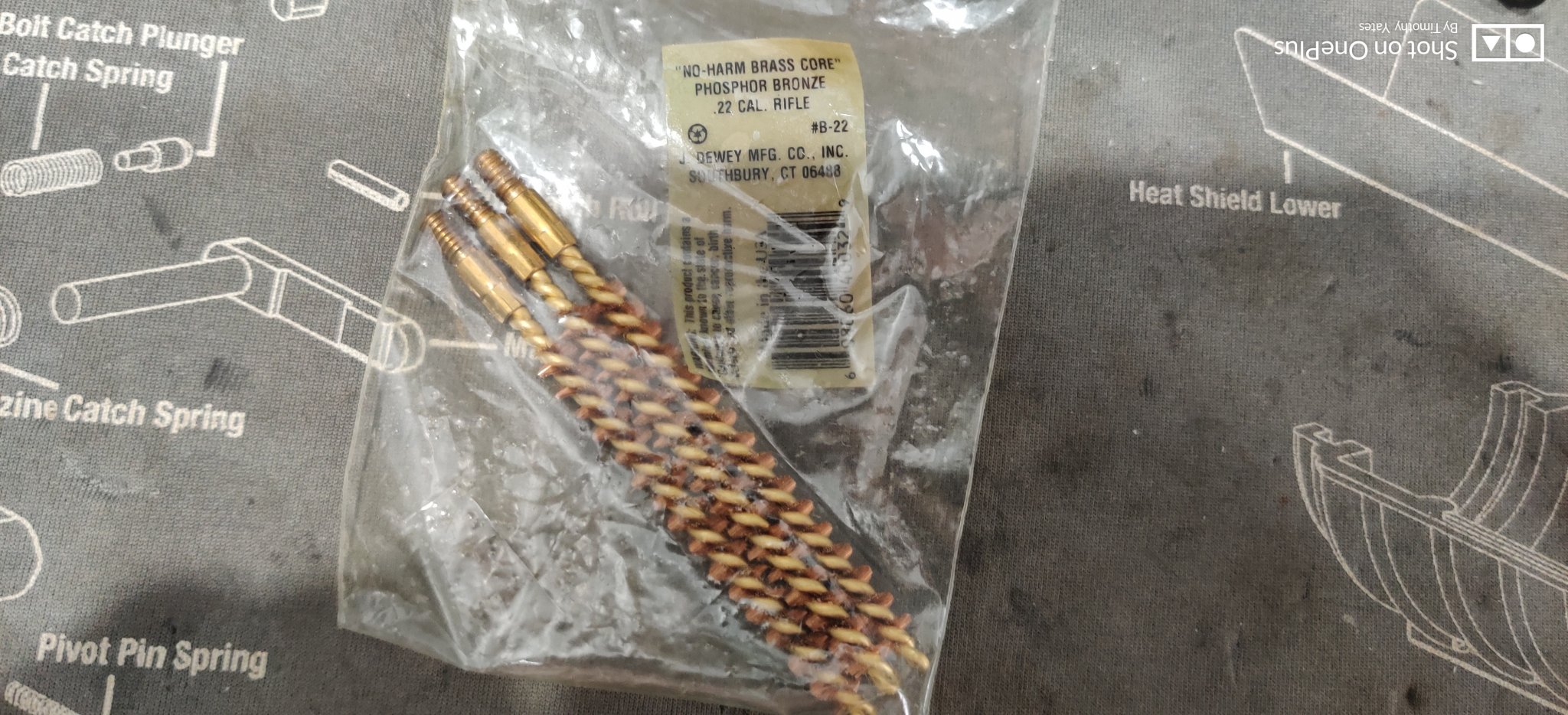

    These Dewey bronze brushes are the only ones I ever use. They do wear down so I buy a pack of them at a time.

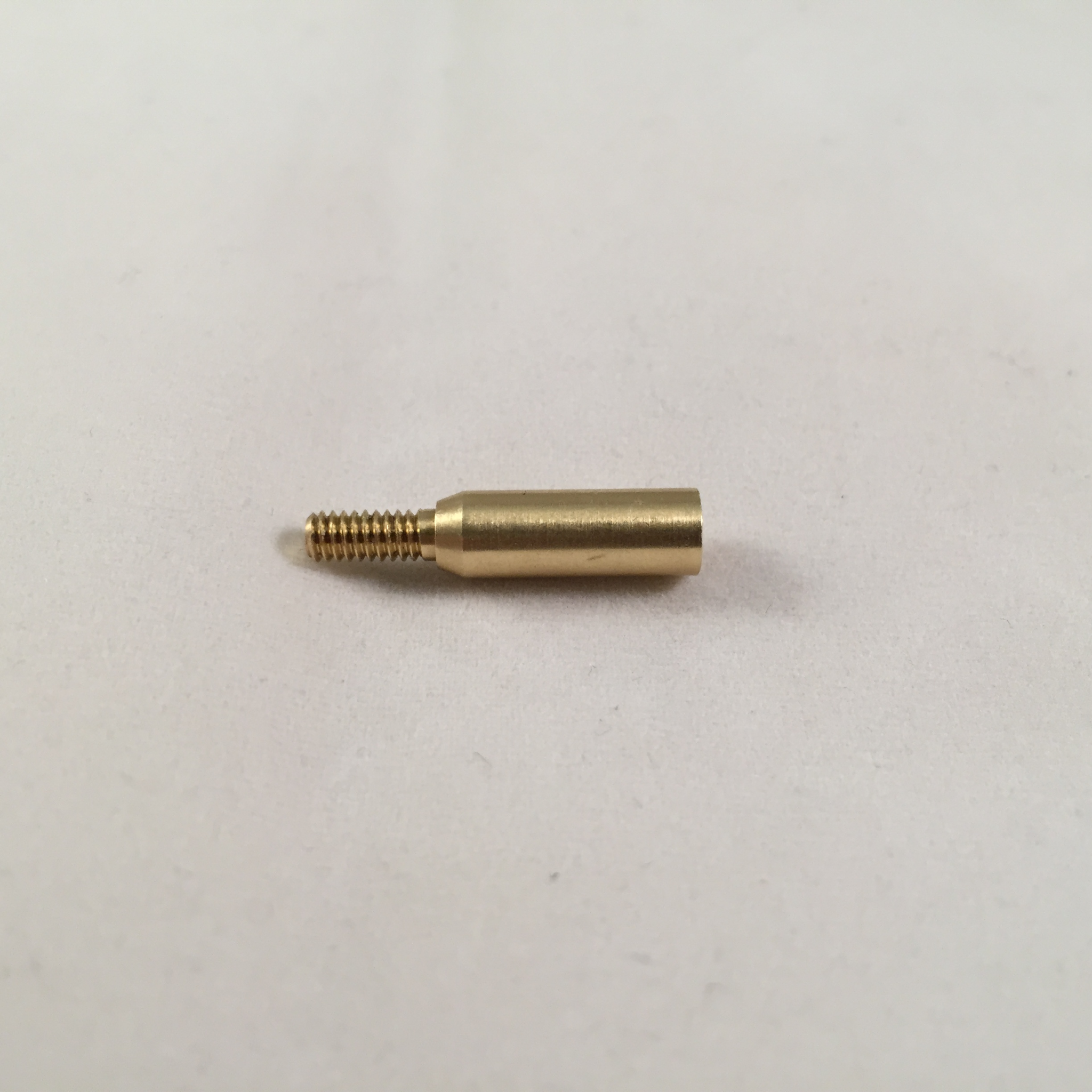

    An adapter is needed to convert the 17 cal to 22 cal attachments. This is a 17A adapter found on Dewey website.
    There's probably thousands of cleaning solutions on the market. I prefer a 50/50 mix of Kroil and Shooters Choice MC #7.

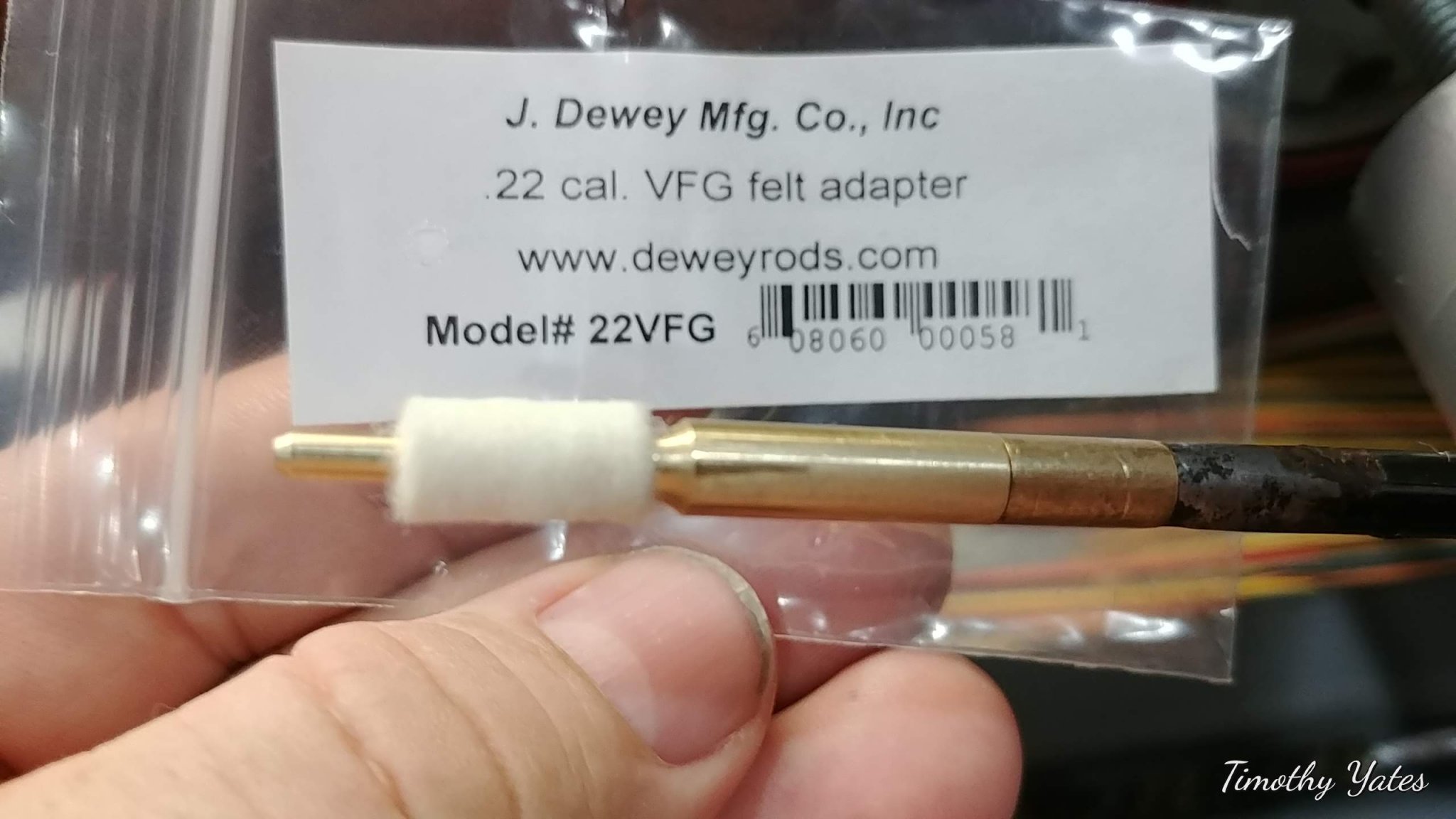

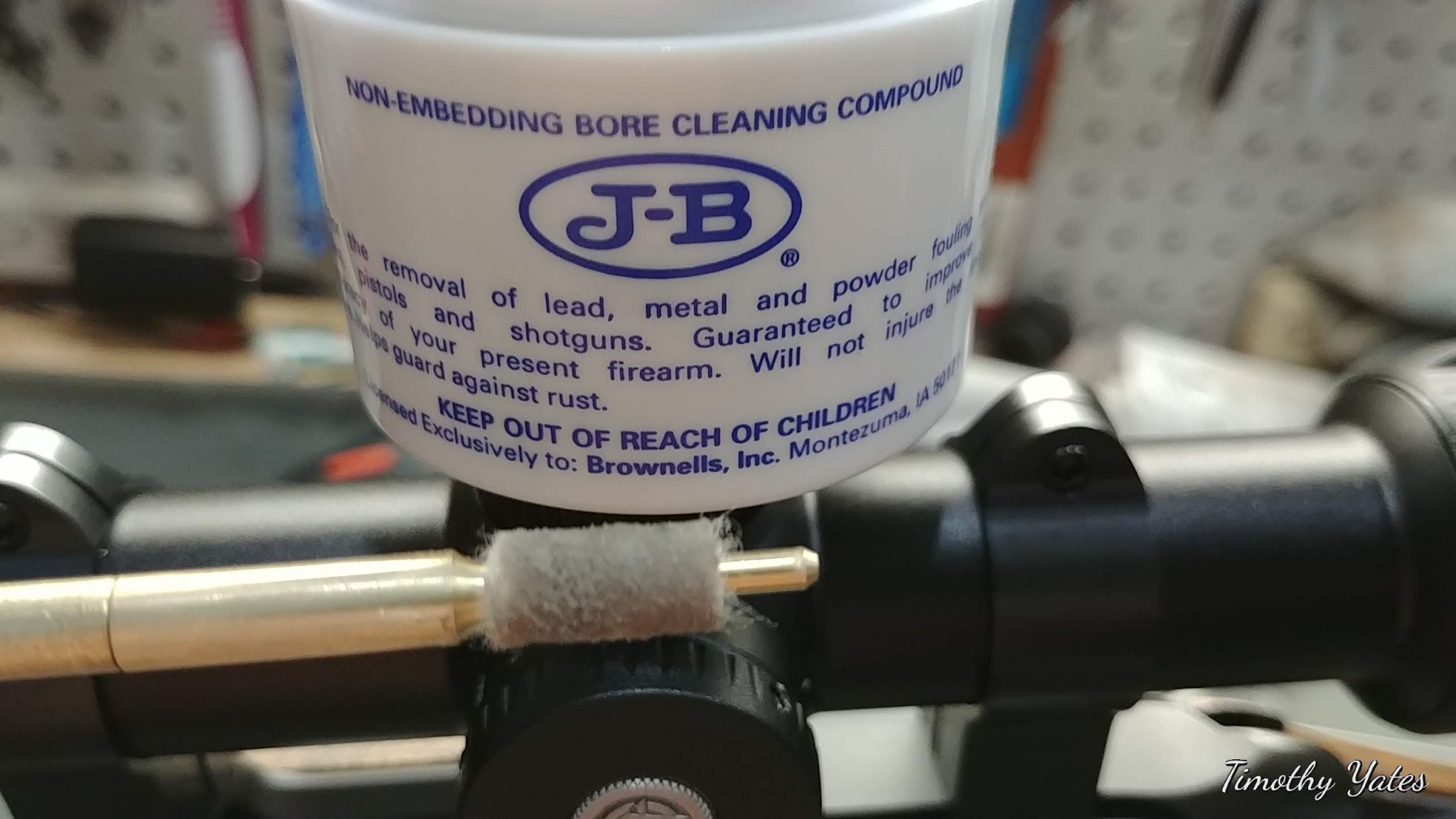

    For quick removal of a heavily built up carbon ring I use this. You can push the JB into the felt and saturate it. Some will wipe off but most will remain for a good cleaning. I use a really old 22 cal rod for this step. If you use your 17 cal rod and this VFG felt adapter you will need another adapter called a 22A from Dewey website.

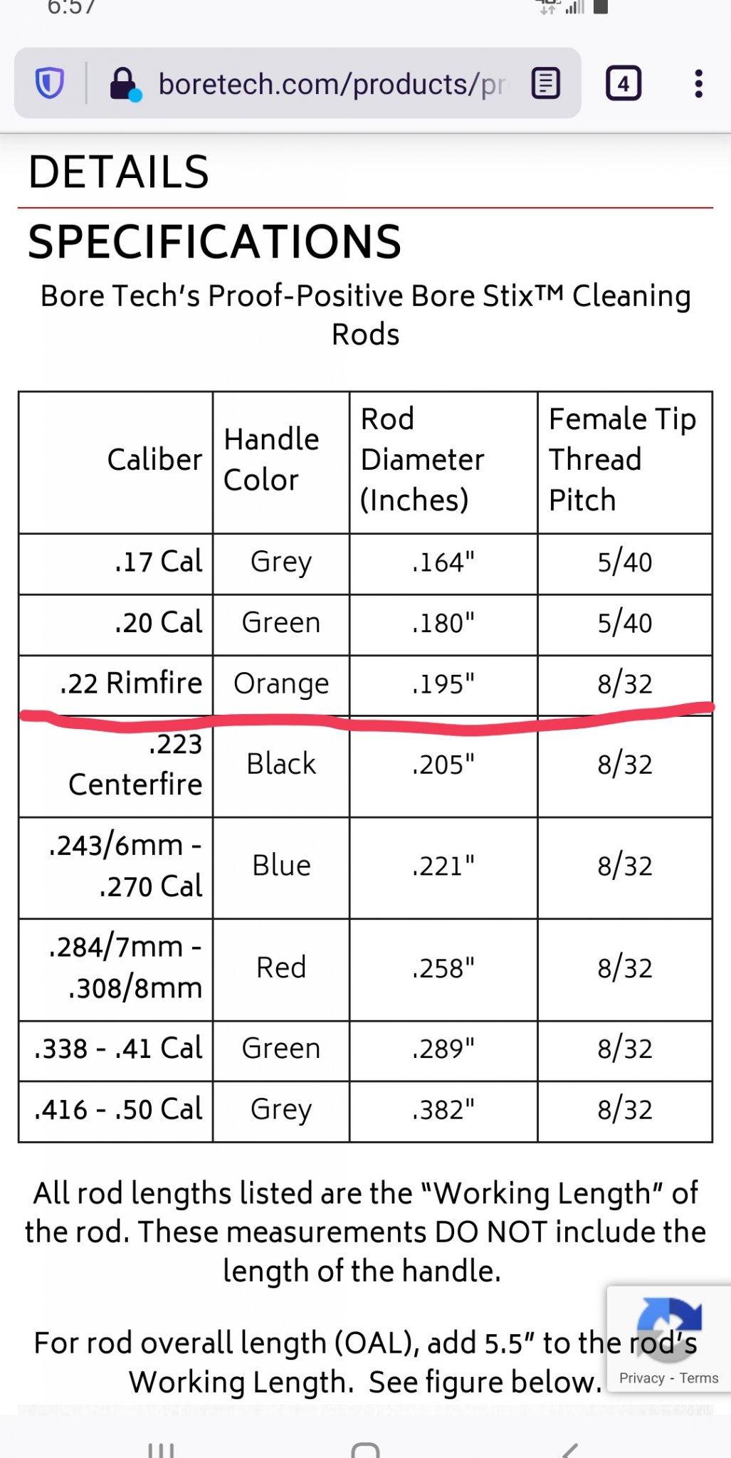

    So to clarify;
    Orange handle 22cal rimfire rod has a 8/32 thread which will work with all standard 22cal brushes and jags.
    Not to argue with you but trying to help clarify, this is straight from boretechs website. Orange handle 22RF rod has 8-32 threads. Therefore no adapter needed for the 22RF jags..
    Sorry Dude, and thanks for circling back on this....totally my mistake. I was replying on-the-fly and my head was in a couple places at once.
    You, and the website are correct, Orange Handle 22 Cal Rod has 8-32 threads.

    I went thru this same confusion with which Boretech rod to get with the aluminum bore guide which has the smaller seperate bushing when I got my first Vudoo a year ago. Looking forward to the 2nd any day now!
    Dewey 22 cal coated rod is 0.212 dia.-won't work in match barrels like Vudoo, Anshcutz, CZ etc.
    Dewey 22 cal uncoated stainless rod is 0.205 dia.
    Bore Tech 22 cal coated rod is 0.195 dia.
