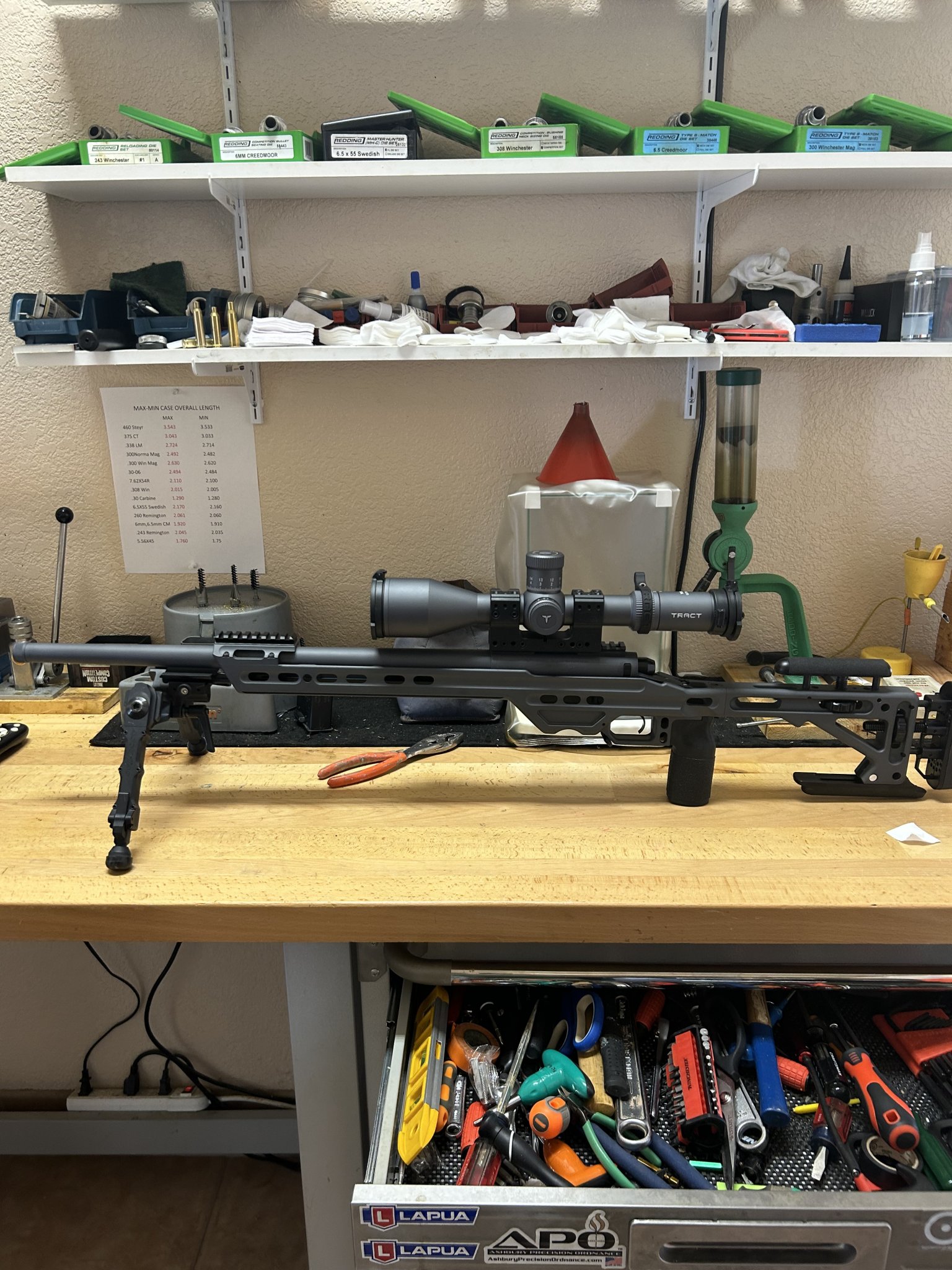

My Vudoo has the following
MPA chassis
22in MTU
30 moa rail
Tract Toric 4.4-30x56
