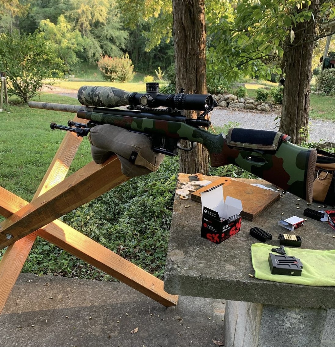

Two RimX rifles, TS Customs smithed the one in the McMillan stock. 18,000+ rounds Bartlien Barrel. Second pic RimX, AI AT-X AICS 2500 rounds, TS Customs spun up a 2nd Bartlien, barrel vice and a torque wrench it was off to the the races. Both feed flawlessly and are exceptionally accurate.

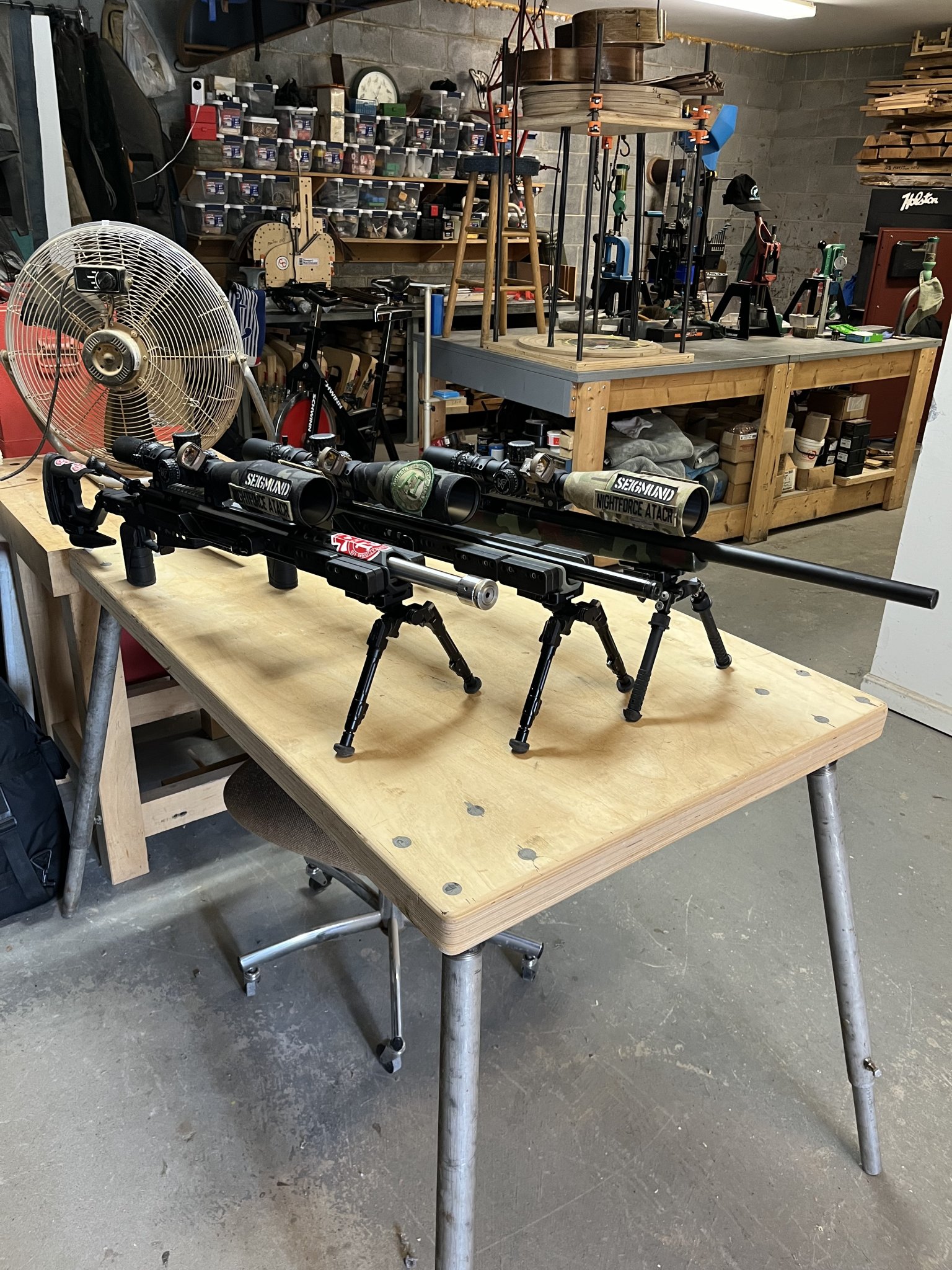

I own 4 custom Rimfire builds ( I have owned way more than that. ). MCR and Rachel Precision. 2 of them are Gen 1 Vudoos, 1 ModX and 1 40X Conversion. All of them are 100% reliable and I can extract a live round from all chambers.
Barrels are Muller Works, Brux and Kreiger. I prefer the Brux and Kreiger cut rifle barrels. I have found them to be les picky with ammo over the Mule Works Button rifled barrels.
