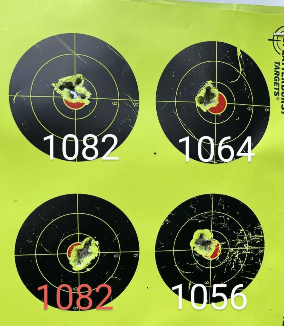

    I had my mags filed down slightly at the lip to not get any catches on the Eley ammo. I am not sure if it was necessary or not, but I figure I might as well get prepared. I also had Vudoo send me the Eley followers but I didn't use them because I heard the Eley followers don't work with Lapua ammo, and I wanted to be able to swap between the two ammo.
    I cleaned my rifle as I was lot testing, and I've only ever shot Lapua ammo. I fouled the barrel with some old Eley Target since it uses the same Lube and then started my test with Eley Match.
    Eley Match 1082 Vel - 20 round chrono
    AVG 1106
    SD 5.8
    ES 17
    Eley Match 1064 Vel - 20 round chrono
    AVG 1104
    SD 7.4
    ES 34
    Eley Match 1056 Vel - 20 round chrono
    AVG 1093
    SD 7
    ES 26

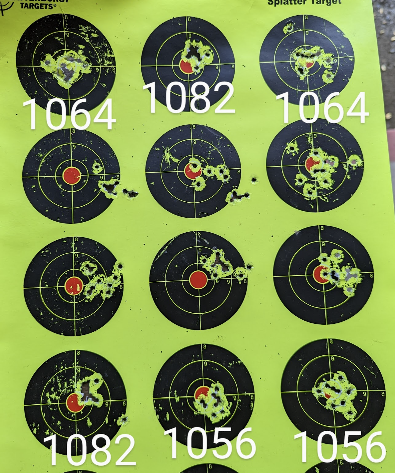

    50/100 yard groups. Ignore the other groups as I was sharing a paper with another person testing.
    The 1056 and 1064 lots shot well at 50yds, but the 1082 lot did the worse at 50. At 100 though the 1082 did significantly better. All groups are 10 shots.
    I wonder if the velocities at 1105+ are causing some of the transonic stability at 50 yards, but at 100 things get better. The 1056 lot that shot with the average of 1093 seemed to be well rounded.
    120 rounds fired today without any major issues feeding. My breach face was clean so no lead was being scraped. I had 4 instances out of the 120 rounds that I had a harder bolt close, like there were more bullet being jammed into the lands. Never really had that with any of my Lapua ammo so that might be a small concern, and doesn't have anything to do with feed angle. If I cycle the bolt harder/faster I could probably not notice it.
    Not sure which lot to go with, either the 1082 one or the 1056 one.
    Ran out of time testing, and not sure if I need to change my tuner either... it's tuned for my Lapua ammo, and looking at the groups at 100 for 1082, seemed to be pretty decent there.
    Based on what I see, I'd go with the 1082.
    I got my Vudoo in and have been shooting it some. Extremely happy with it. I've been shooting Eley club without any issues at all.
    1082 looked great at 100y, but those 50y groups are concerning. The 1056 lot 50yd group was fantastic.
    I might see if I can possibly tune the 1082 lot to get it to shoot better.

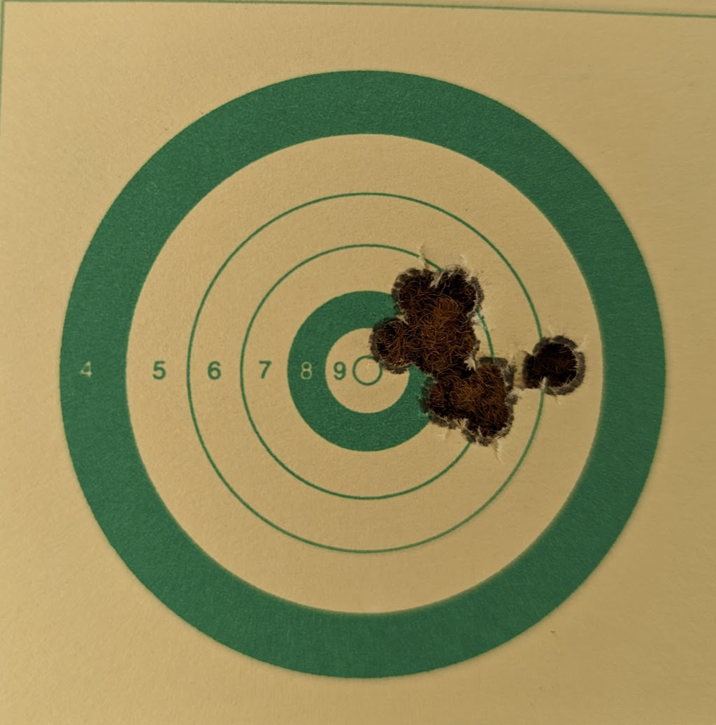

    Some updates - did some tuning today, as the Eley ammo shoots quite a bit faster than my Lapua so I wanted to do a fresh tune. During the 200 rounds I shot, I had 2 light strikes, and 3 misfeeds. 1 was a rimlock issue that was my fault, and the other 2 the round spiked up out of the magazine and hit the top of the barrel face. I'm not sure what causes that specifically, I guess it didn't quite snap under the extractor/ejector claws and was just being pushed maybe?
    While diagnosing light strikes, I also noticed that my Vudoo does NOT extract live Eley ammo. I had one ammo that after 2 strikes, still didn't go off, and I had to get a little allen wrench and get it out. I then rotated the round and put it back into the chamber and it fired. I put a fresh round in and just tried to extract it, and it didn't work. Grabbed a Lapua Center-X round and it had no issue extracting it live.
    So reliability wise, I'm not quite there yet on trusting it for an important match.
    It sure shoots well though.
    Here's tuning with the Hopewell method. Eley Match 1104 AVG, STD of 6, ES of 30 (over the course of 100 rounds)
    Verified at 104 yards, 10 rounds:
    Light strikes and ejection issues points to head spacing. The Eley rim is thinner than Lapua and RWS. If you set head spacing strictly for Eley, bolt closure often becomes hard on Lapua. If your bolt closes easily and smoothly on Lapua you'll probably have light strikes and ejection issues with Eley. Head spacing can be set to accommodate all three ammo brands. I'm not sure how Vudoo sets head spacing as some will shoot and feed all three ammo brands without issues but some won't!
