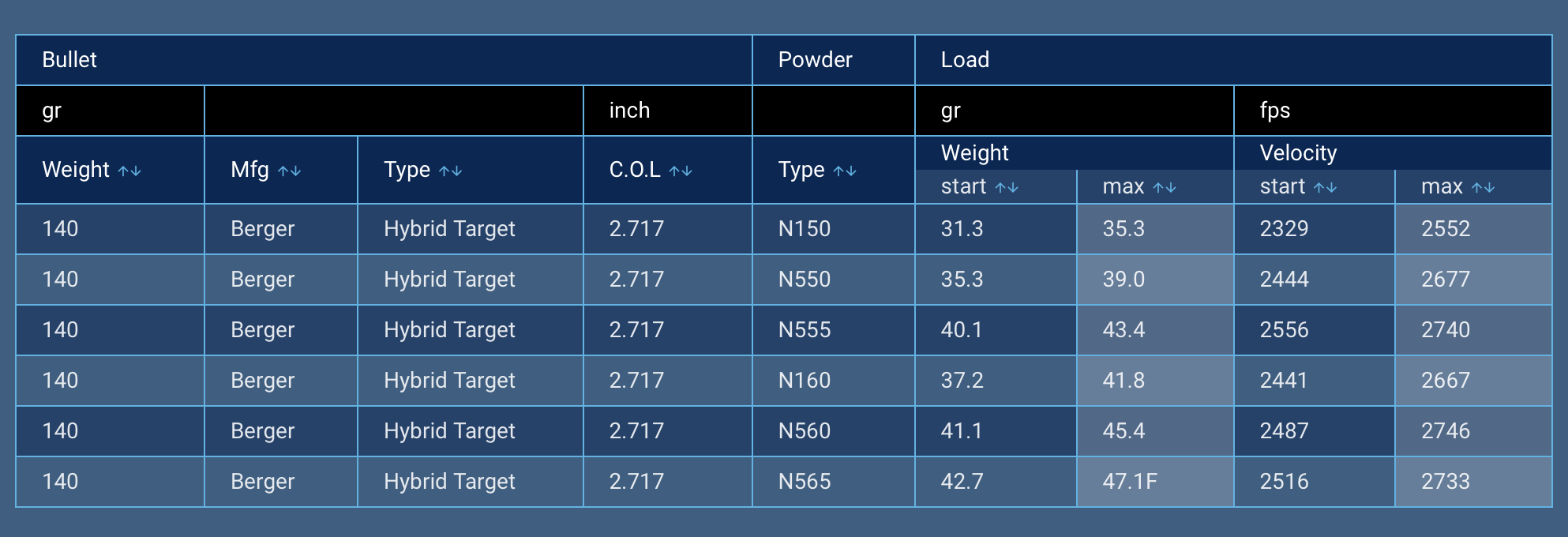

RL 16 has priced it's self out of my limited income. So I'm looking for an something to take it's place in my 6 & 6.5 CM's . The only data other that that published by VVN , is by Lyman, and they only list VVN 550.
So , has anyone tried either of these powders in the two rounds listed ?
N550 and N555 are quite far apart at burning rate. i would not use N550 in CreedMoor.

''possible powder'' and ''best suitable powder'' are 2 different things. and i talked about that.
if you have N550 and N555 for 140gr CreedMoor available, everybody would choose N555.

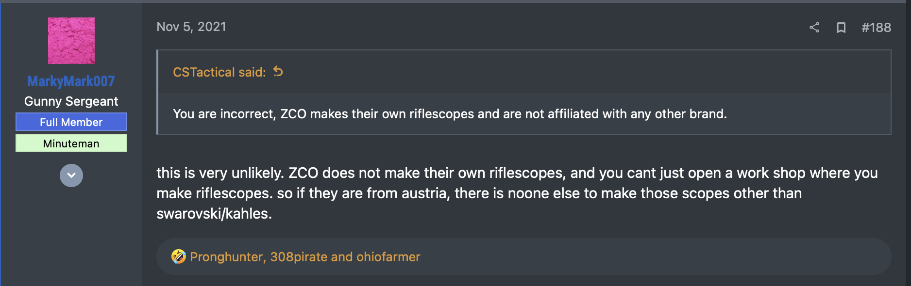

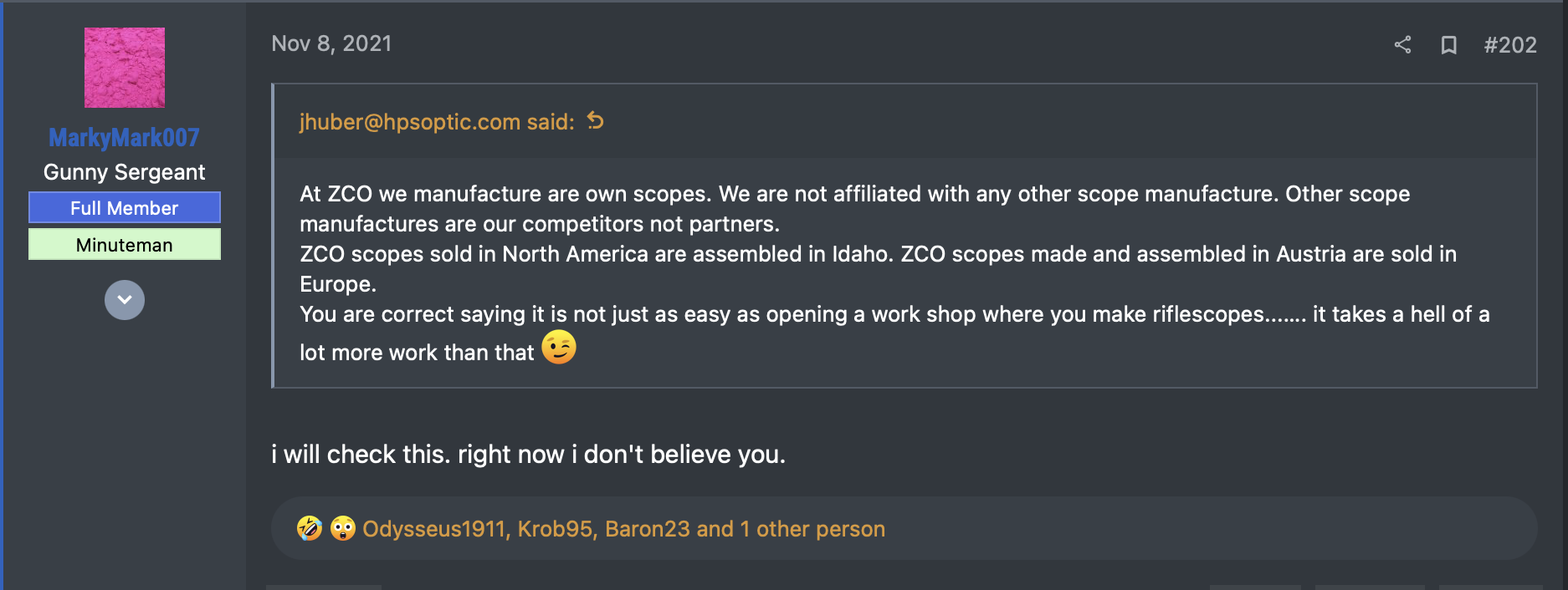

Everyone here remembers your posts before you jumped on the AB train. Everyone remembers when you told ZCO where they do and don't have facilities. Everyone remembers you telling Bartlein what they do and don't do with their barrels and such. Everyone watched you incorrectly use data on primer seaters to say which tools were good and not.
It's pretty entertaining. Just need to make sure anyone who hasn't seen your posts doesn't actually think you are providing good info.
