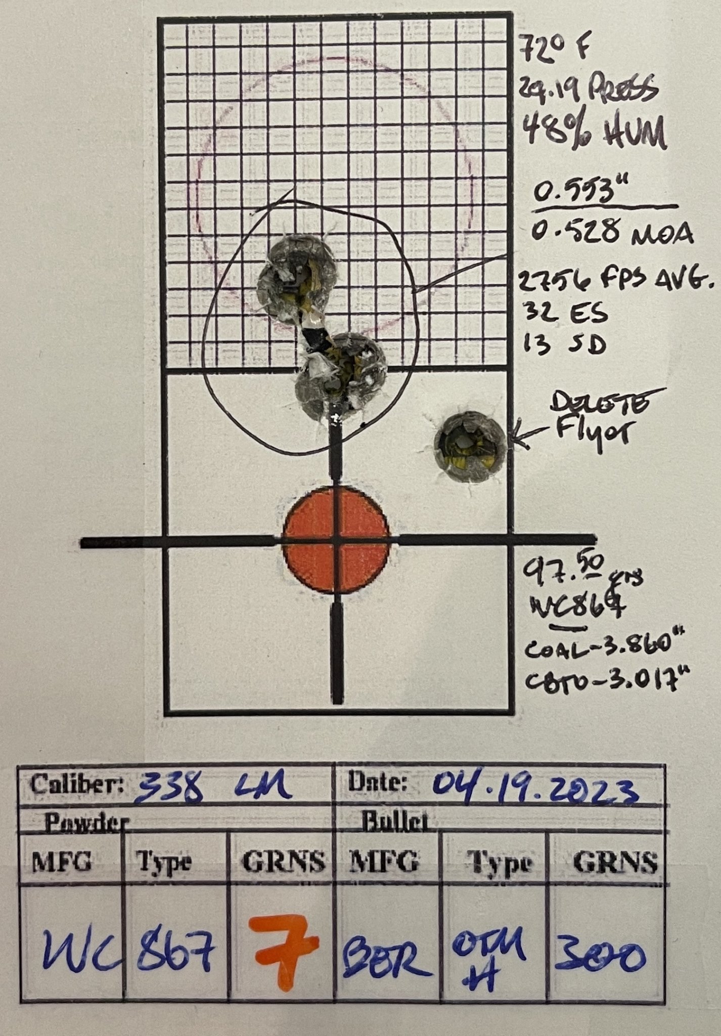

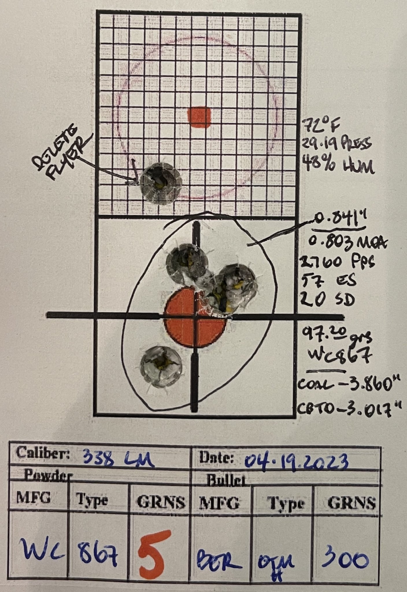

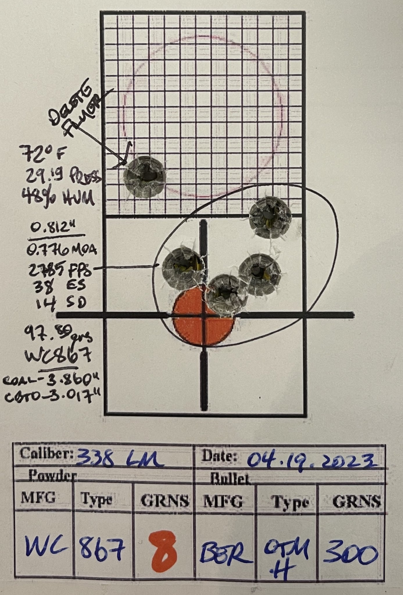

I decided to conduct a calculated and highly controlled experiement with this powder and just thought I’d reach out and share my results with this thusfar…
Im doing this in separate sessions because the nearest range is 1.5 hours from my house. The first goal was to load single rounds to gauge speed and pressure. I ran a quickload simulation using H1000 as a measuring stick and the results were definitely slower than H1000. That said I now had data to go on and I used Quickload again and a little knowledge of slower burning powders to compare against those results. What I found was that Retumbo seemed to be a lot closer to what I experienced as far as speed goes.
Today I took that knowledge and stepped up the loads and received great results. One rifle seemed to be about 80fps slower from the QL simulation and the other was 40-60fps slower from the QL simulation. I was able to get the speeds close to my desired range of between 2700-2800fps. The top load I had was 2664 against a projected 2700 which is a lot better from where I started this experiment. Furthermore, I did a 5 shot group at the start of this test just to get a taste of wheather or not they’ll perform and those were shooting sub MOA at 100yds with an ES of 27fps and SD of 11fps... So there’s definitely an indication of this working out nicely.
The next step is to do a load development with the last two loads and step up another 2.5grs in half grain steps. Lord willing, I’ll find an accuracy node within that range. This will be a 7 shot Load development with 5 shot groups which should deliver sufficient data to find an accuracy node with sufficient speed behind it to stay super sonic out to 1750yds.
Reactions: knuckleballz
Update...
On Sunday, I ran the next test of a 7 ladder step load development with 5 shot groups. The results were awesome!!! As expected, the rifles showed us what they like. Also, the ES and SD numbers were low and speeds reached and exceeded the desired 2700ish without any signs of pressure. I'm excited to report that this powder works and works well. I still have some fine tuning to do with seating depth but at this stage, I was able to put together some decent groups at 100 Yards. The next step is going to be loading the best ones that shot well and seeing if they repeat and then rock and roll from there!
Reactions: Evlshnngns
Okay! My apologies for not updating everyone in a bit. I have ran a couple more tests with great results!!
After the last test, I was able to find decent speeds safely. The next test after that I made up some 5 Shot loads. I did 7 steps going up in 0.3gr steps upto 97.80. Yesterday I went out to the range and am happy to report that I hit an accuracy node from 97.20 to 97.80. I know that I clearly pulled a shot in every grouping and am still getting used to the rifle but am very content with the results knowing that this powder is definitely working as I imagined it would. Enclosed are the targets from those loads.
I'm definitely going to load up more of the middle load and confirm accuracy at 100 and then stretch them to 500 and 1000yds and ultimately the goal is to shoot at 1 mile and beyond with this but I'm taking baby steps along the way. Ill update what that looks like when I get a chance to get to those ranges.
I hope this can help someone who might be where I was and is on the fence. As always, I proceed with extreme caution and measure everything multiple times over to the point where its annoying but worth it for safety purposes.

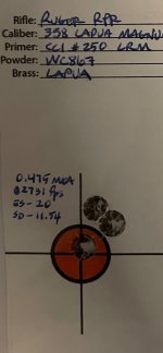

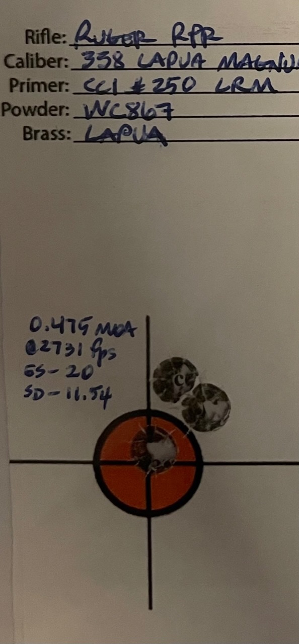

I’ve got this rifle shooting a consistent at .5 MOA or better with my hand loads running WC867 powder. Also, the ES and SD are low too.
This load is..
3.017 CBTO | 3.860 COAL
(FYI.. I single feed these as they’re not mag tolerant)
97.50grs WC867
Lapua Brass
CCI #250 LRM Primers
