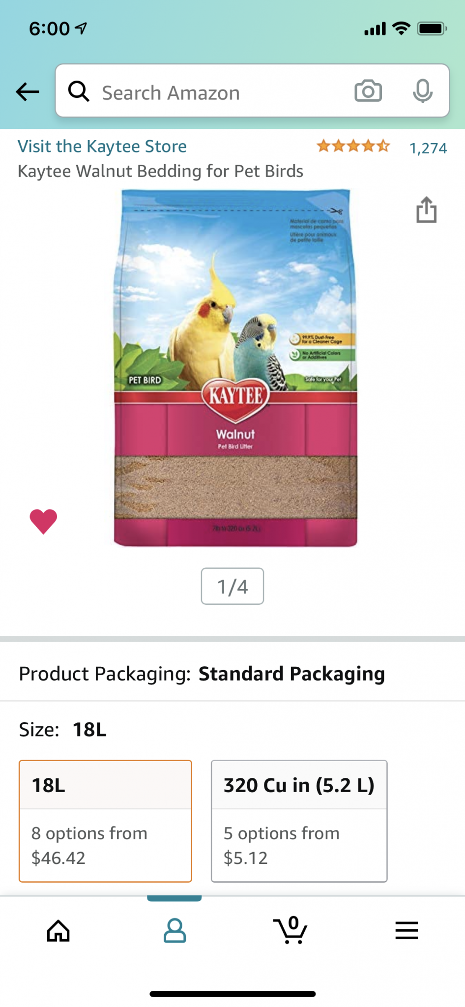

So I’m in need of replacing my walnut media and I’m tired of paying stupid prices for Dillon or Lyman etc. I’ve found walnut media at places like Home Depot and harbor freight but unsure of which size to order. Any help would be appreciate or also other sources of media.

12-20 is the grind for walnut sold as media...and....wait for it...lizard cages. Same stuff, MUCH less $$.
This is what I have had great success with.
