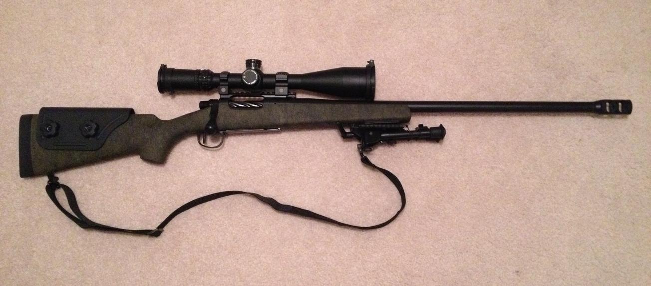

Call Moon at Crescent Customs. He has access to the new EH Manners stocks, one of which I would choose, and did choose, for an all-around rifle build. Ask him what he thinks of the Xtreme Ti actions, as he has built a number of them now, and also my choice for an all-around rifle. Maybe try a No. 4 contour at 21" of rifling, maybe a .298 or .299 bore.
9.5 Lbs with bi-pod and 30P-1. Much less without them:
