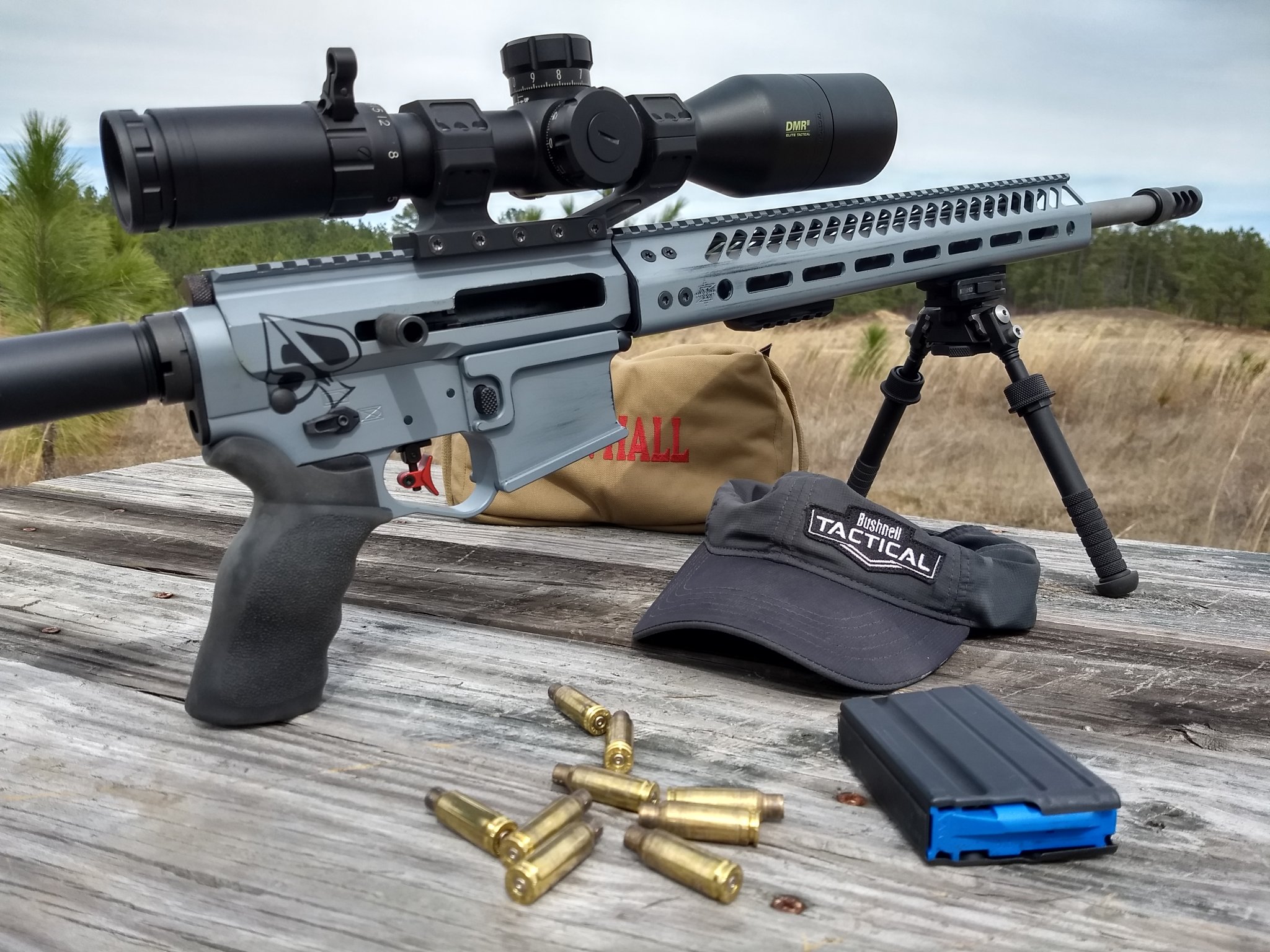

    20". Specialized Dynamics in Arizona makes tack drivers. Got one last year for gas gun matches.
