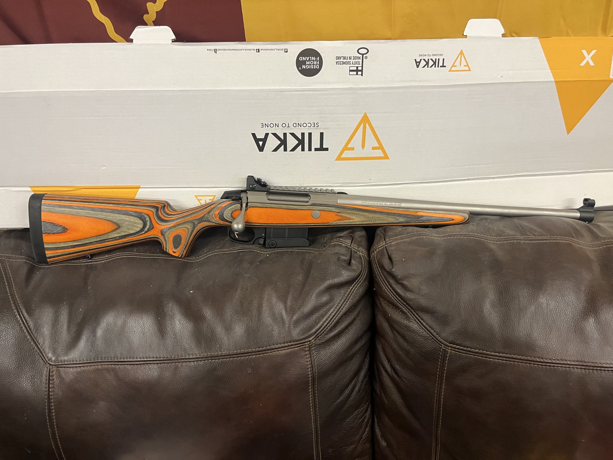

Yes, I’ve read the Arctic is too expensive, a rip-off, and too heavy, etc. but I want one nonetheless. Uncle Sam has given me some of my money back and I’m going to use it to scratch this itch. My dilemma after finally admitting this problem is I cannot decide between 308 and 6.5 Creedmore as it pertains to this particular rifle. I have several other rifles in. 308 and like them but no rifles chambered for the 6.5. The better accuracy and less recoil appeals to me. However, the Canadian Rangers version is in 308 making that combination a classic. Does anyone with an arctic in 308 regret not getting the 6.5, or vice versa? Thank you for your time.

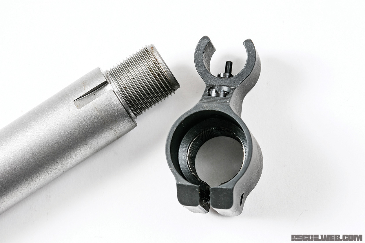

I’ll check mine tonight, but I’m pretty sure it’s threaded 5/8x24 and the front sights threads on and then u lock it down, but I could be wrong on that.
Reactions: Im2bent
Wonder how hard it would be to set that sight back on the barrel a bit? Any clue how the sight indexes?
Paraphrased from the manual- Screws onto the muzzle thread until bottomed, then back out until the guiding screw can go into the slot.
So you should be able to have a good smith cut the threads back and extend the notch, but it’s an added expense to run a brake or can.

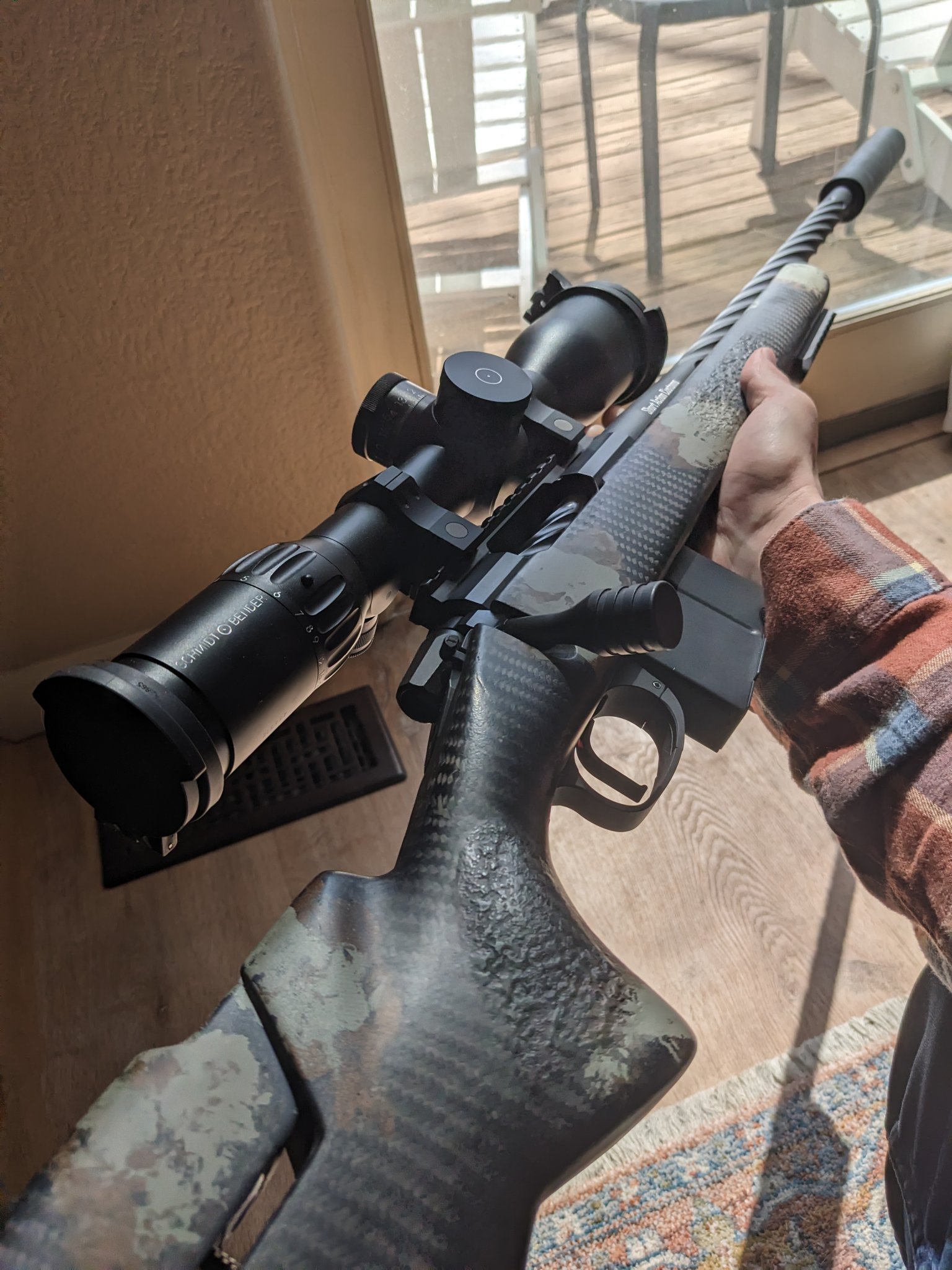

Here is my version inspired by the Arctic.
Those rifles are bad mfers. I came this close to getting one in 308, but decided it was a better idea to have SAC build me one to my specs for 3x the cost. I have issues.
I chose 308 because I think it hits harder 250 and in, which is my chosen range limit for the platform. No question 6.5 would be better if you want more range.
Is that a Terminus Zeus action?

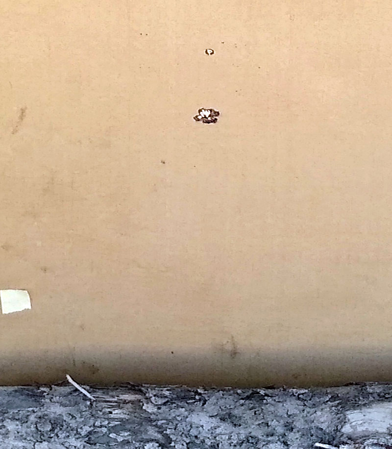

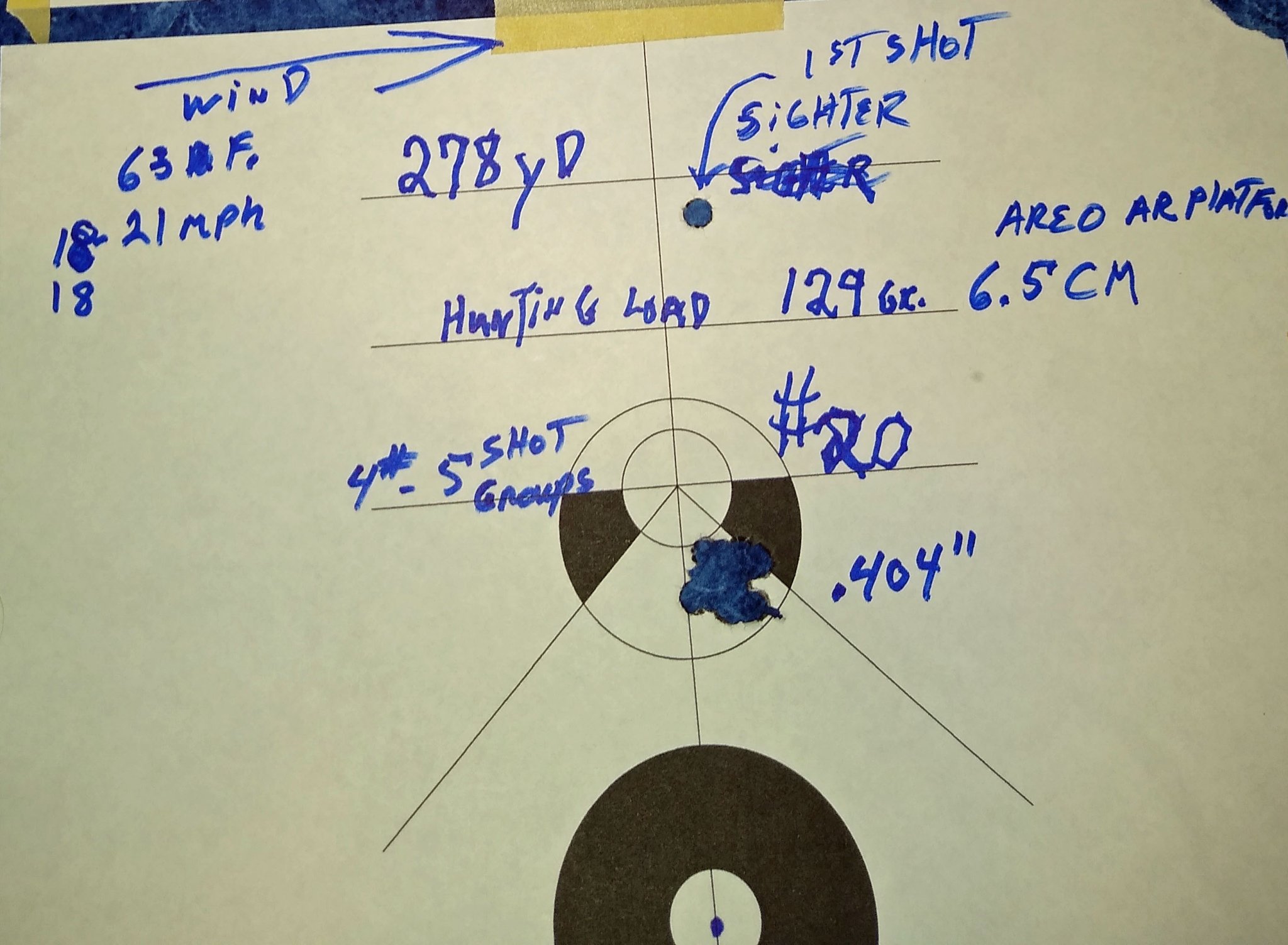

Ah Gay as in Delightful accuracy ,from a Hunting bullet no less . I'll leave the secret trouser trout handshake too the rest of you ;)
That's #20 into .404 under 2 minutes .
