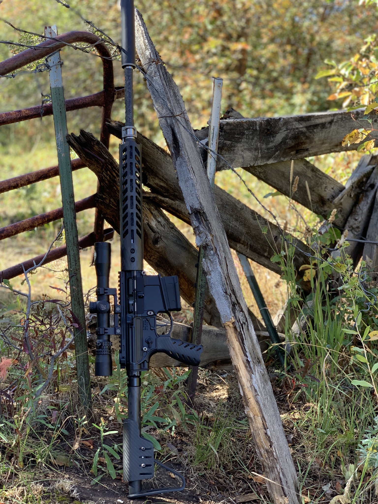

Built mine out a few years ago. Goal was to get under 7 lbs but it ended up being a couple ounces over. At the time the lightest receivers were 2A arms and F1. I used the F1 and my buddy built out his with 2A. I used a 16 inch Faxon gunner lite. Midwest handguard. I’ve been very happy with mine, holds MOA out to 400. Buddy wasn’t as happy with his and switched to a Proof 20in barrel which helped. Calvin Elite triggers on both.

I built a light weight AR308 using 2aArmament Xanthos receiver set, 2aArmament Ti GB, 2aArmament Ti RBCG, 2aArmament Ti TD pine, 20”Proof barrel, V7 Ti small bits, JP SCS, NF scope and mount, and SiCo Harvester30 silencer. Came to about 9lbs with scope and silencer

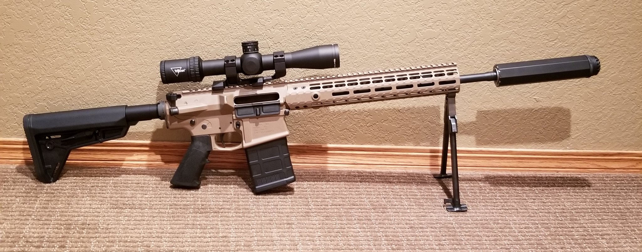

I did this.
Aero M5E1 upper and handgaurd
FAXON 6.5 16" big gunner barrel
JP detent adjustable gas block
JP LMOS carrier and HP bolt
Aero carbine buffer lower
Radian raptor Lt charging handle
JP SCS
Magpul SL stock and K grip
Geissele G2S.
I ended up a little over 7lbs dry no optic. If you use a regular M5 upper/handgaurd rather than the E1 upper and handgaurd it will save another 1/2 lb. A SLR sentry 7 detent block will also save a little weight over the JP AGB
Runs pretty well after dialing in gas, doesnt shoot as great as I want it to but is is making good groups with good ammo, hovering over MOA consistently and I've shot it to 650yds successfully.
